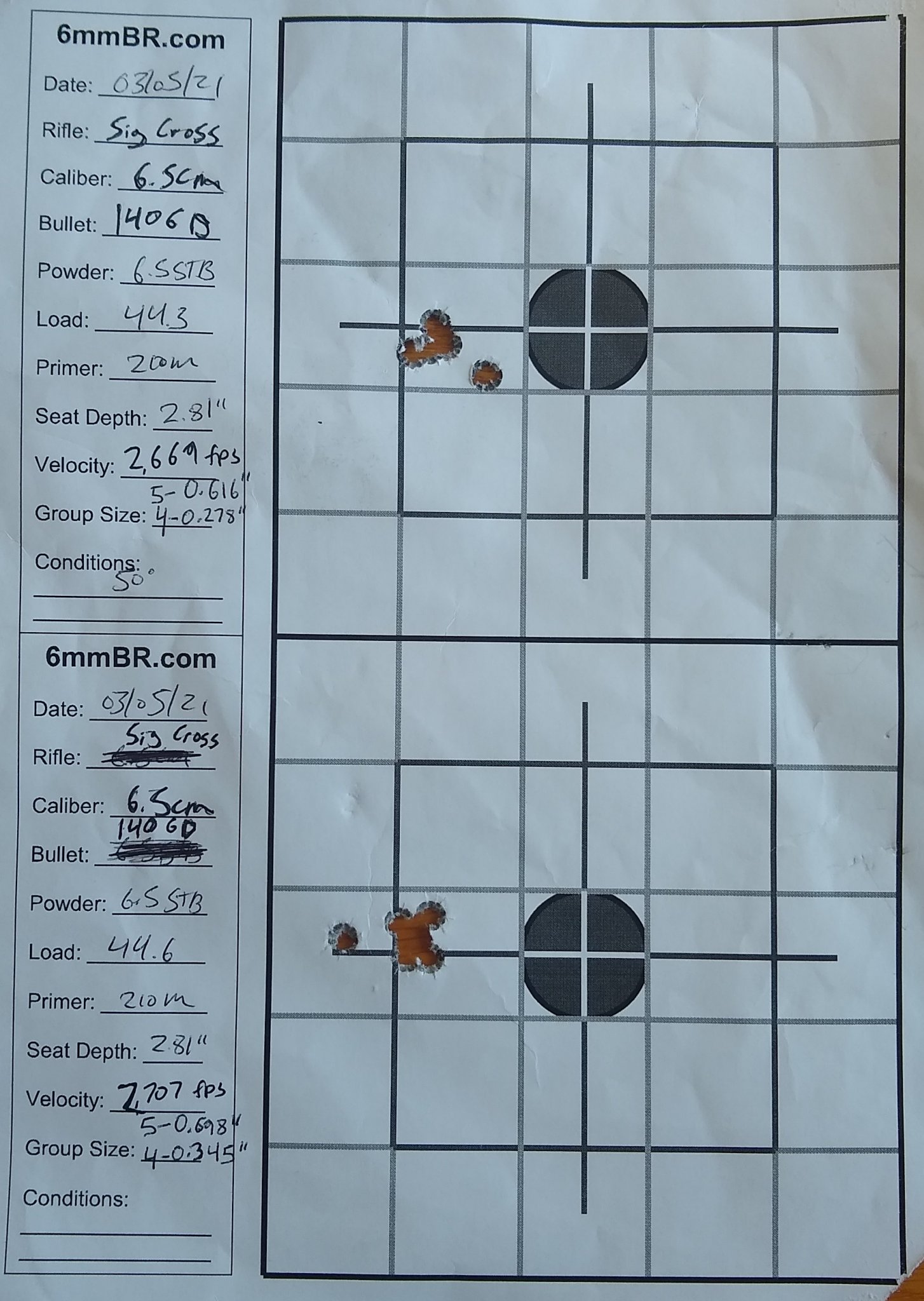

So far I've found a few good loads with 140gr Gold Dots, they just seem to want to shoot in this rifle.
That's honestly about as well as I can do with a light-ish rifle off a bipod with any consistency (the fliers in the top targets probably weren't the rifle).

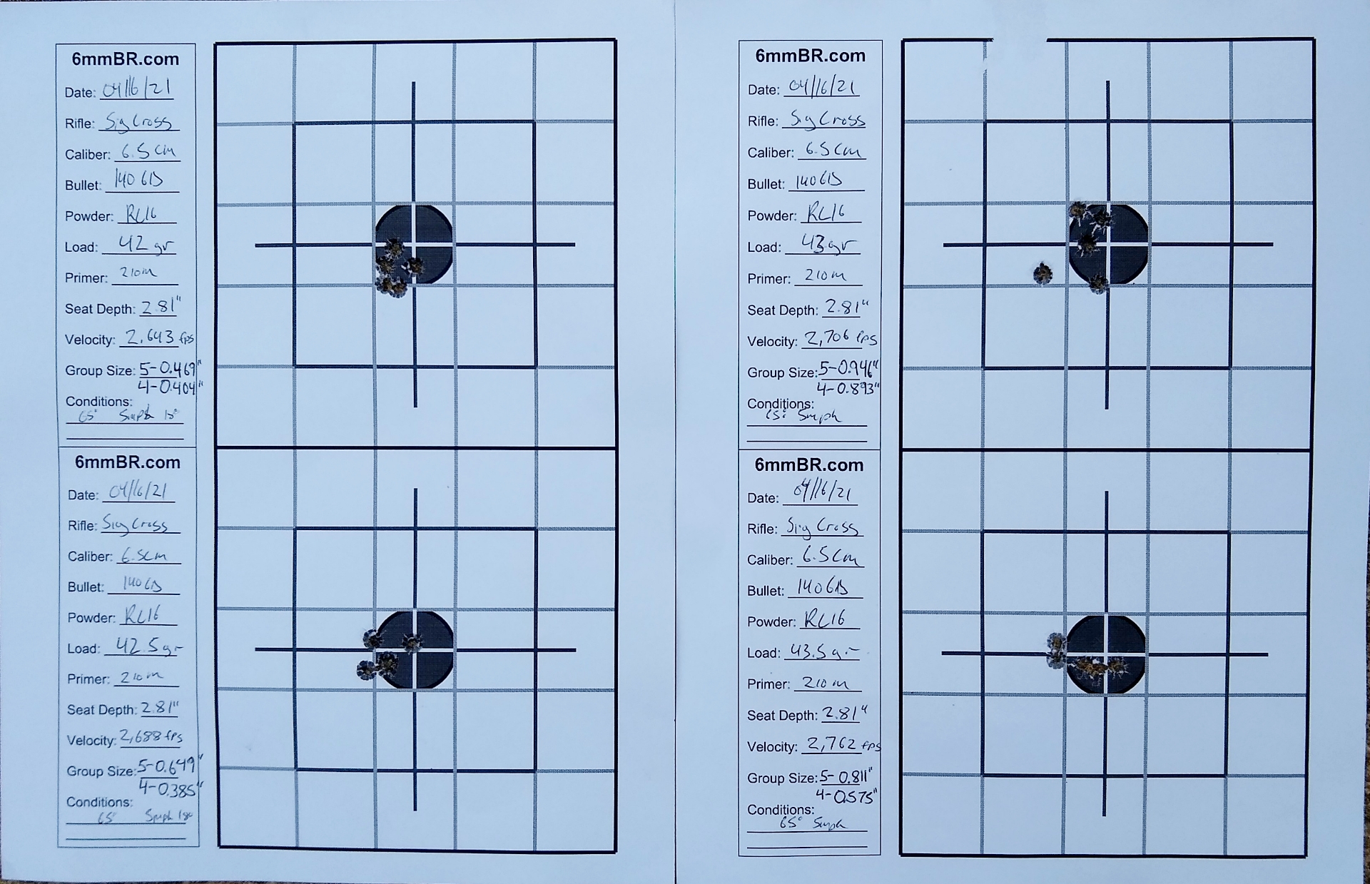

I did get my box, so yesterday was the last range trip before I have to strip everything off and send it in.
Those are good groups, thanks for posting the RL 16 loads. Looks like .5 gr is good for about 44fps. So my 41.5 gr estimated at 2600 fps is pretty close.
