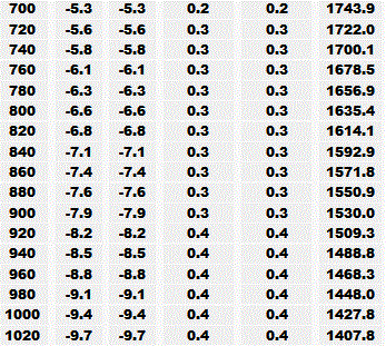

I used the jbmballistics calculator and accounting for the target being at 1020 yards (range finder) with a 12 deg incline, I dialed 9.7 mils of elevation. Working that backwards, I get a velocity of 2600 fps (as shown below).
View attachment 7628779View attachment 7628775
Thank you sir. I'm trying to see if it will make power factor for Nrl hunter series. A 140 has to go 2715 fps. I'll have to shoot 147s I believe.

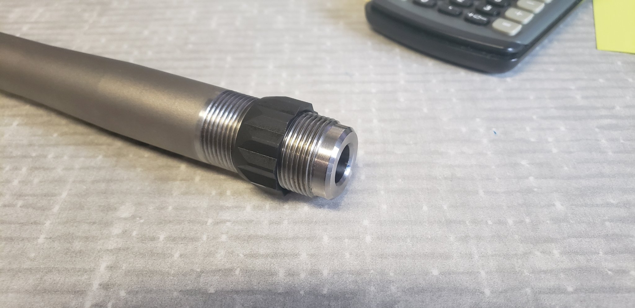

I'm also curious to know what the base thread is
I don't understand how you could remove the barrel extension from the system, it's set up very similar to an AR. Or are you saying you could keep the same barrel extension and headspace a barrel to shoulder directly up to the extension?
Does anyone know if the barrel threads are a common pattern? Would be neat if you could take Savage or Remage prefits and swap them into your existing barrel extension.
Major diameter on the threads is 1". I forget the pitch. The diameter to use it as a shouldered barrel is 1.100". That's enough of a shoulder for non mag calibers. If I recall correctly you cannot go over the 1.1" diameter as you need that as your max to clear anything inside the handguard fitting wise.
I don't have a picture of the guy laying around at this time but I can post a picture of it. The barrel is cfw and in green.
16 threads per inch.
Reactions: Gtscotty
Thank you, Sir! I was checking that out but more curious about our short barrels.
