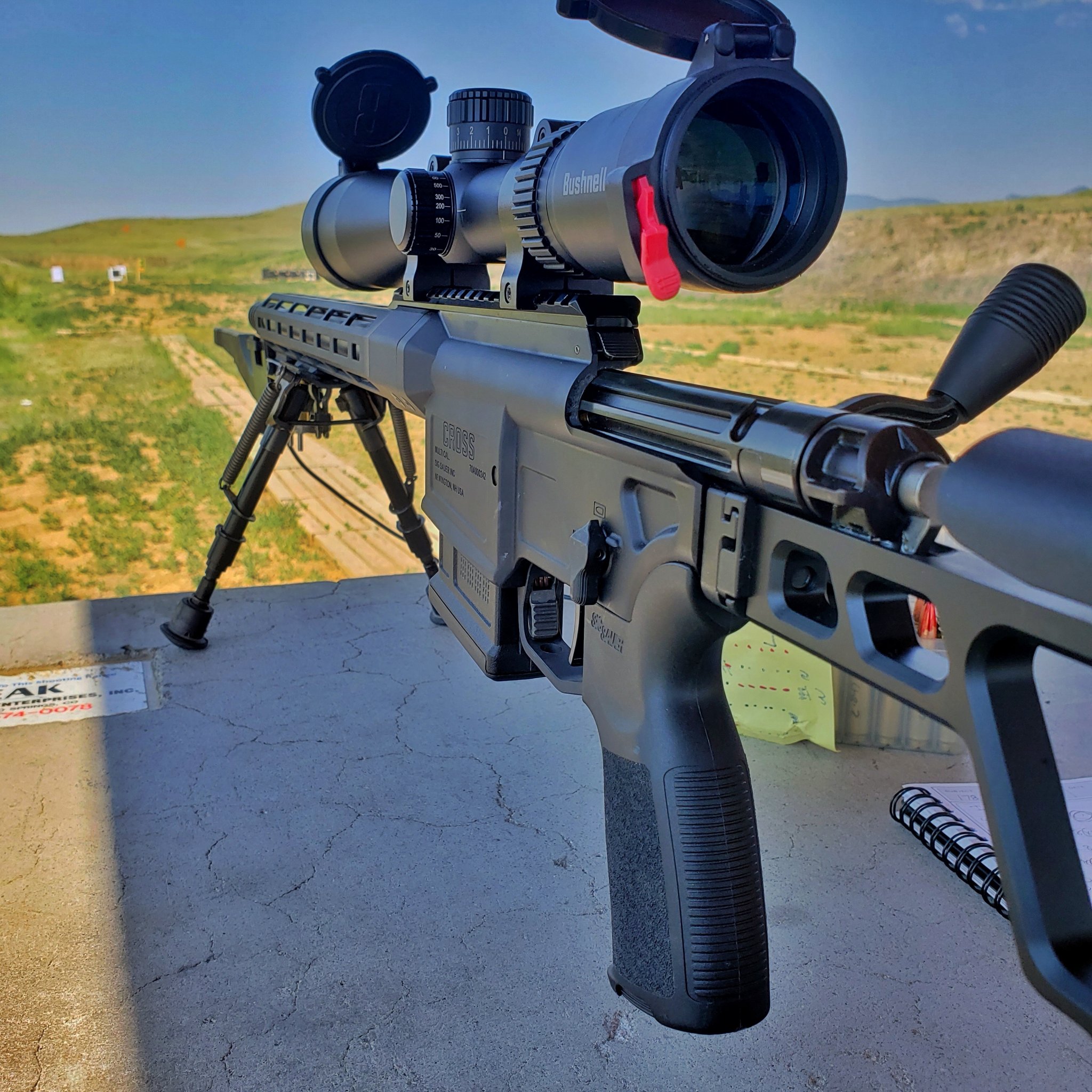

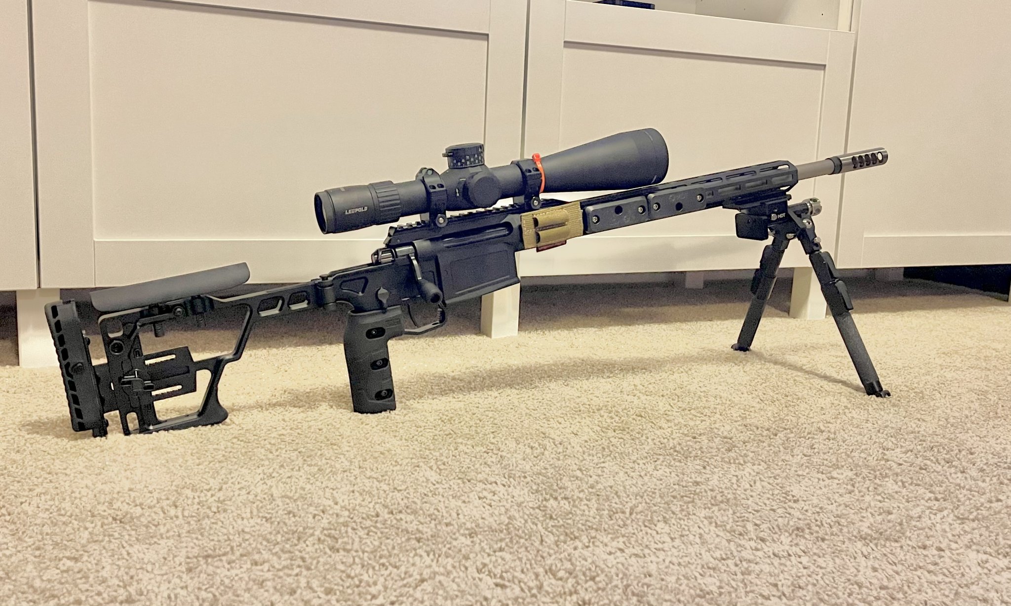

Happy 6.5 day. I just received my cross.
Has anyone had issues loading the hand guard with weight? Worried adding too much weight will put too much pressure on the barrel extension. For the wondering minds, I’m trying to add as much weight as possible to shoot it at local matches.

See post #1351, the conclusion is the hand guard attaches to the receiver, page 86 shows the assembly. So the weight should not be on the barrel extension.
A couple of pounds on the hand guard shouldn’t be an issue. I don’t think I would add ten pounds. If you have the weights farther back, be careful that the screws don’t contact the barrel taper.

Nice setup...(y)
How would your rate the rifle in this configuration?
Is there any way to add an aftermarket bag rider?

I just picked it up, so it is unfired. Therefore I couldn’t tell you. I’m going to load some ammo today for it though.
as far as bag rider I haven’t been able to find any aftermarket parts yet. That would be really nice to add weight to the rear.

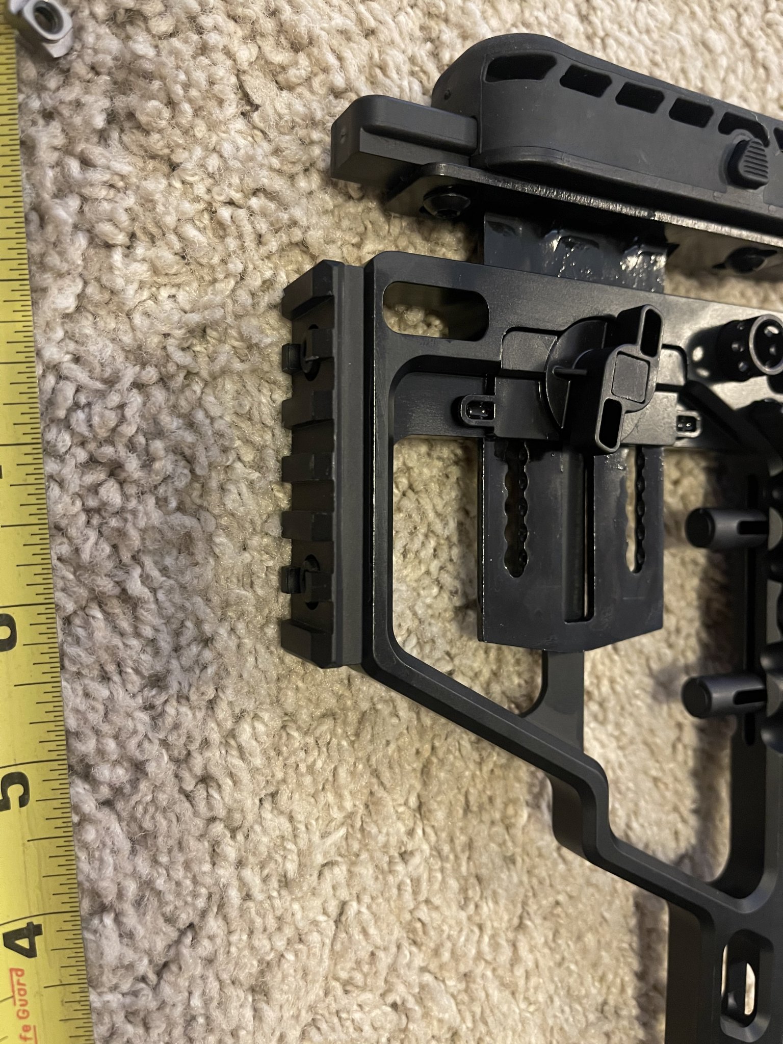

On the bag rider, they do make some that can attach to a picatinny rail. Accu-shot makes a picatinny mount for the cross butt stock. The link shows a bag rider that connects to picatinny.
Bag Rider

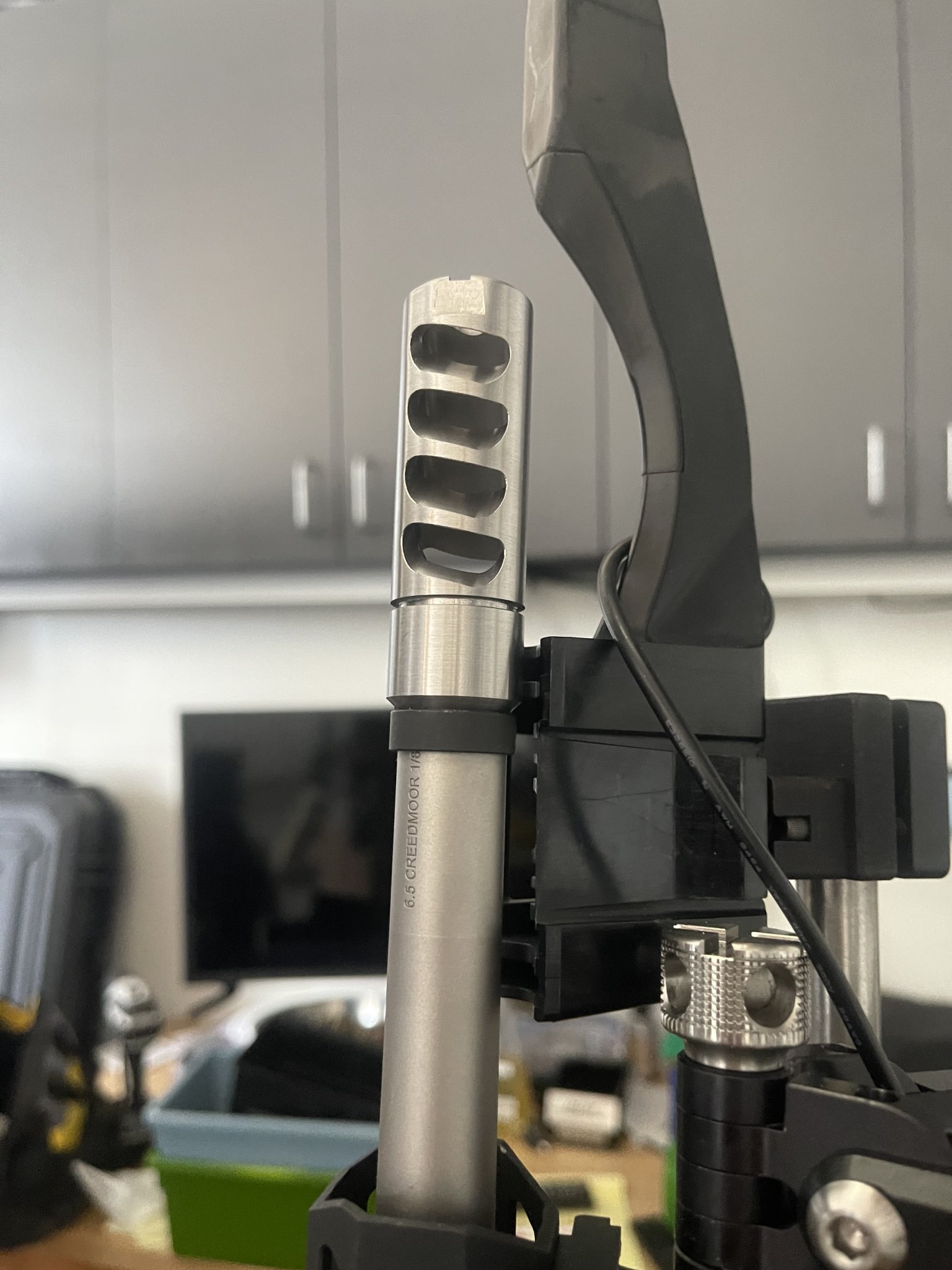

Has anybody put a muzzle brake on there cross yet? Today I tried a pva jet last and the accuracy went to shit from 3/8 to 1.5 at 100yds. Tried taking it off went right back to shooting 3/8. Checked the brake to make sure the bullets weren’t making contact with it and there not. Anybody Elise having this problem?
I went with a MBM beast II. 4 port just to add weight.

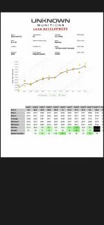

Picked up a 308 a week ago and finally got to shoot it. Awesome fps for a 308 in 16 inches.
The fps increase between charges of IMR 4064 starting at 44 and going through 45.5 showed consistent increases despite 92 degree weather. No jumps in fps or other signs of pressure.
I got a 178 BTHP going 2665 for a 5 shot average with an SD of 11 and an ES of 23.
Of course recoil is manageable and the trigger is better than a lot out there, yet still behind the likes of Trigger Tech a little.
130 Barnes SOST ammo got me to 3035 fps for a 5 shot average.
This is my new everything rifle and I can wait for Sig to offer up some more parts and barrel options...and the Fury!

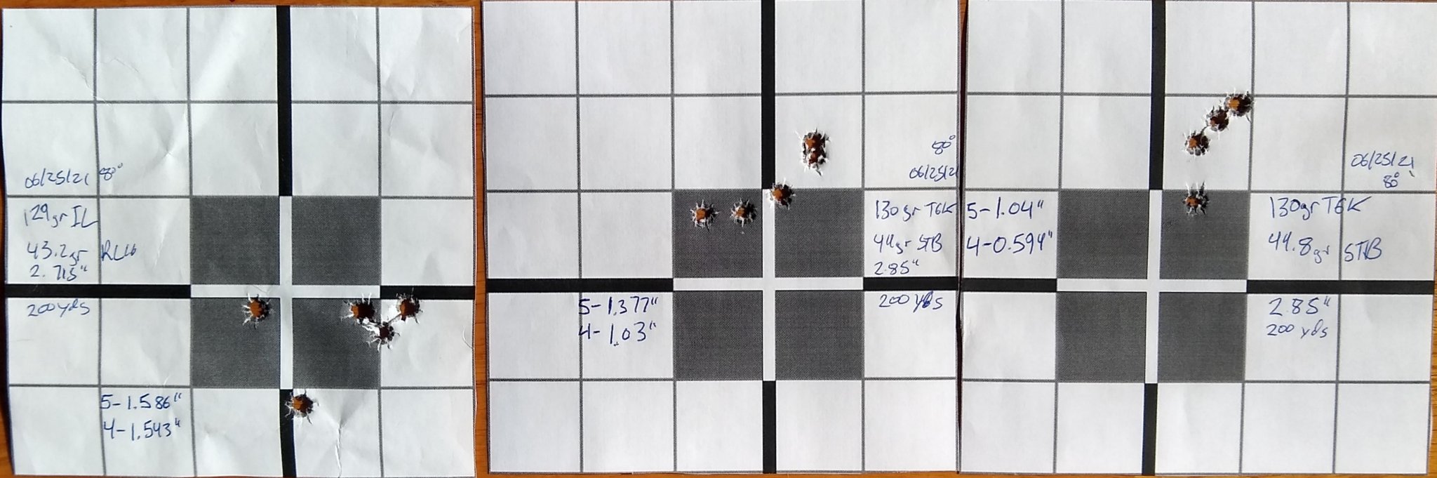

Few quick picks, did the sight in and Sig recommended break in(yeah, yeah) Only shot some SB 140 FMJ, actually squeaked out a 5 shot 1" group with that mess and some old 120 amax load was .75. I just loaded some Hornady 140 BTHP with Staball, will see when I can. Not sure if the follower is a Cross specific one or a new feature overall with the Magpul AICS mags? No feed issue with either or the actual AI metal ones. Scope is a NF SHV 3.5-10, didn't want too much weight on it and it's the best I could think of. I am glad I went with the Leupold AR mount as it places the scope at the right height for me. No cycling issues, all feed, fired and ejected 100%.

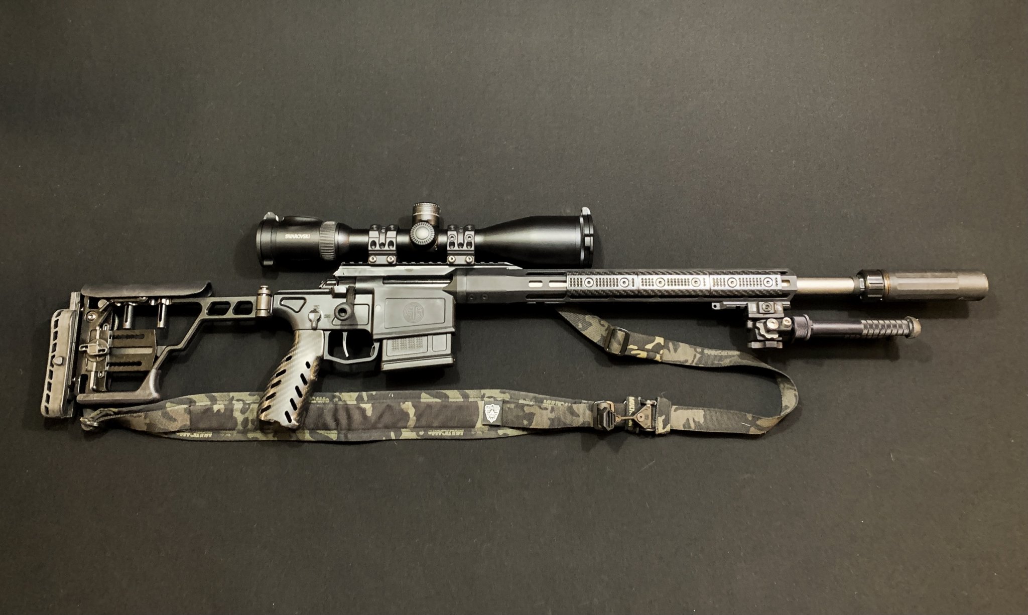

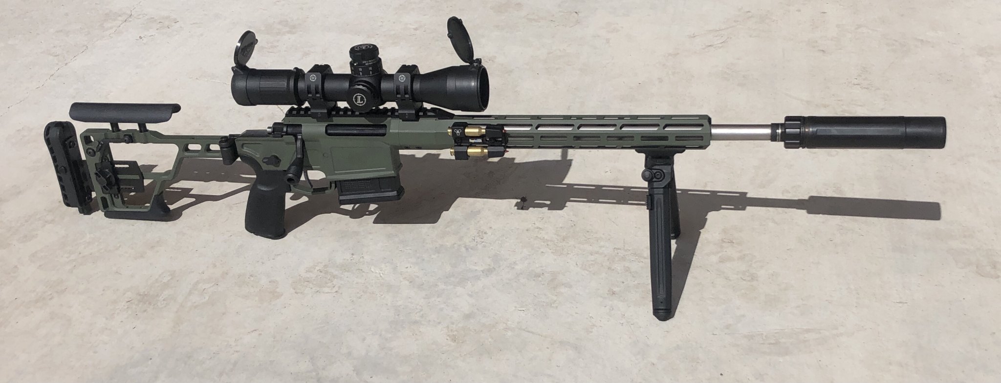

After around a years wait, finally got mine...it’ll be my primary whitetail rifle.
Used my Cabelas points for the rifle itself, so that cost me almost nothing out of pocket.
18” Sig Cross in 6.5 Creedmoor
SLR carbon fiber rail panels
Smoke Composites carbon fiber grip
Atlas BT46-LW17 bipod
FCD msq-h sling mount
Ferro concepts multicam black slingster
No quarter tactical sling silencer
Dead air brake
Dead Air Sandman K (will probably run the S most of the time)
Spuhr SR-3000 rings
Swarovski z8i 2.3-18x56 scope
Swarovski ballistic turret flex
I’m going to see how the factory barrel shoots before pulling the trigger on a 16” Bartlein/Tooley barrel, although another 2” lopped off the OAL would sure be nice for tree stand hunting. Cerakote is the last thing to figure out, considering going with an old school m81 woodland camo scheme.

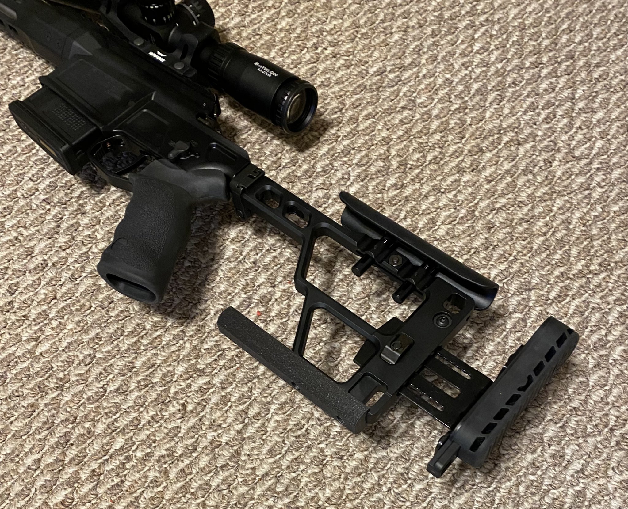

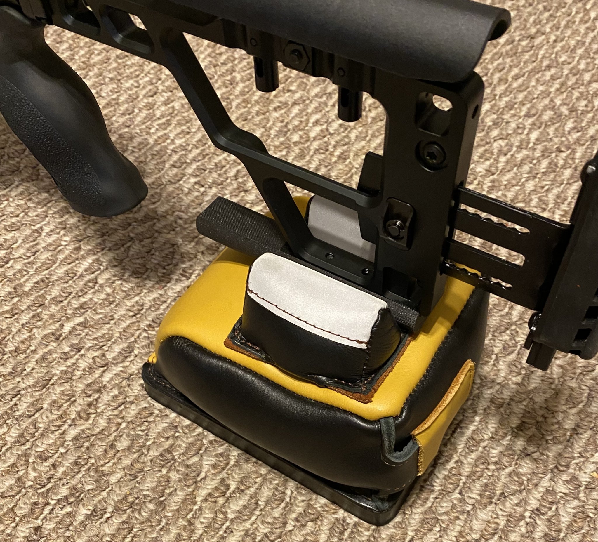

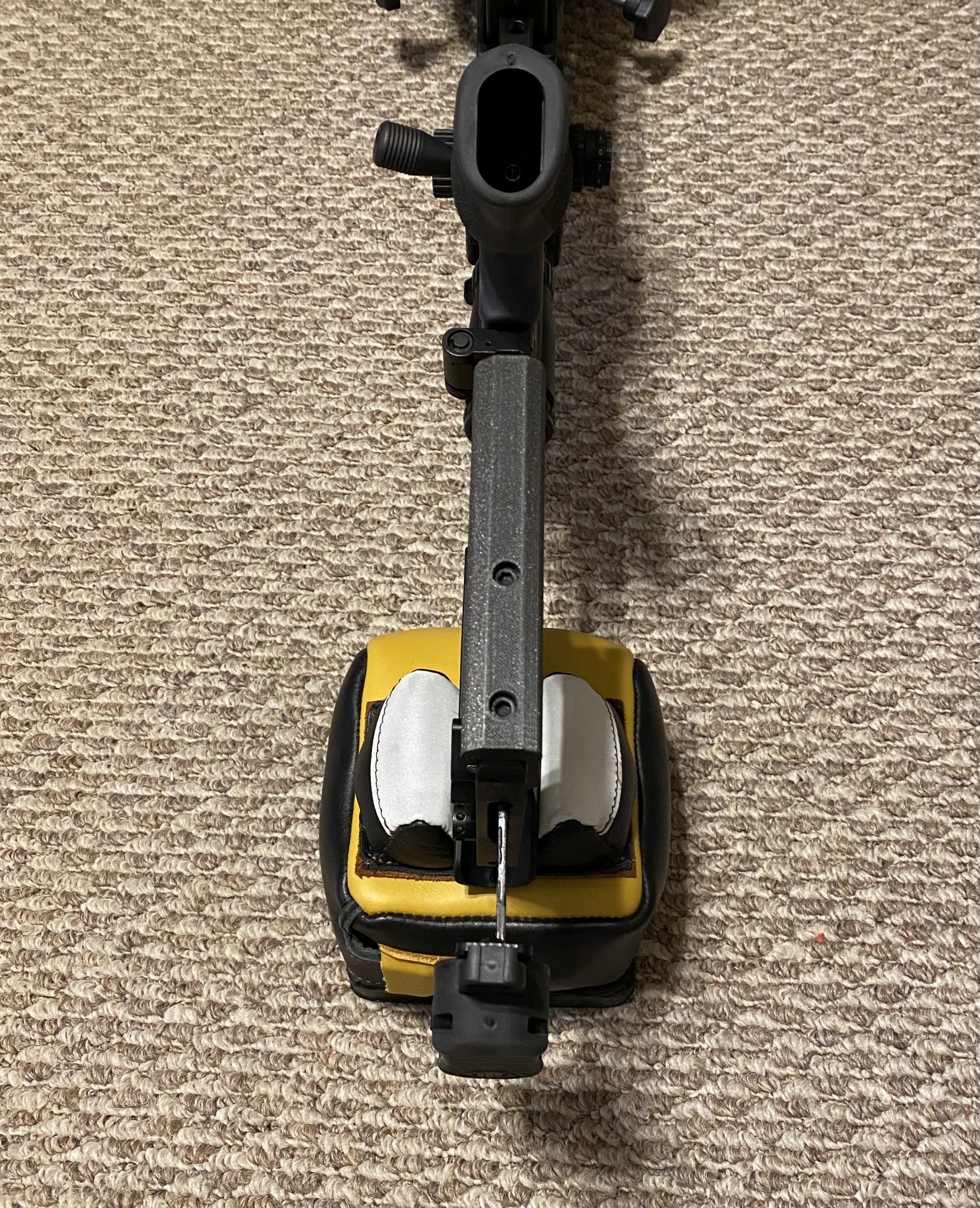

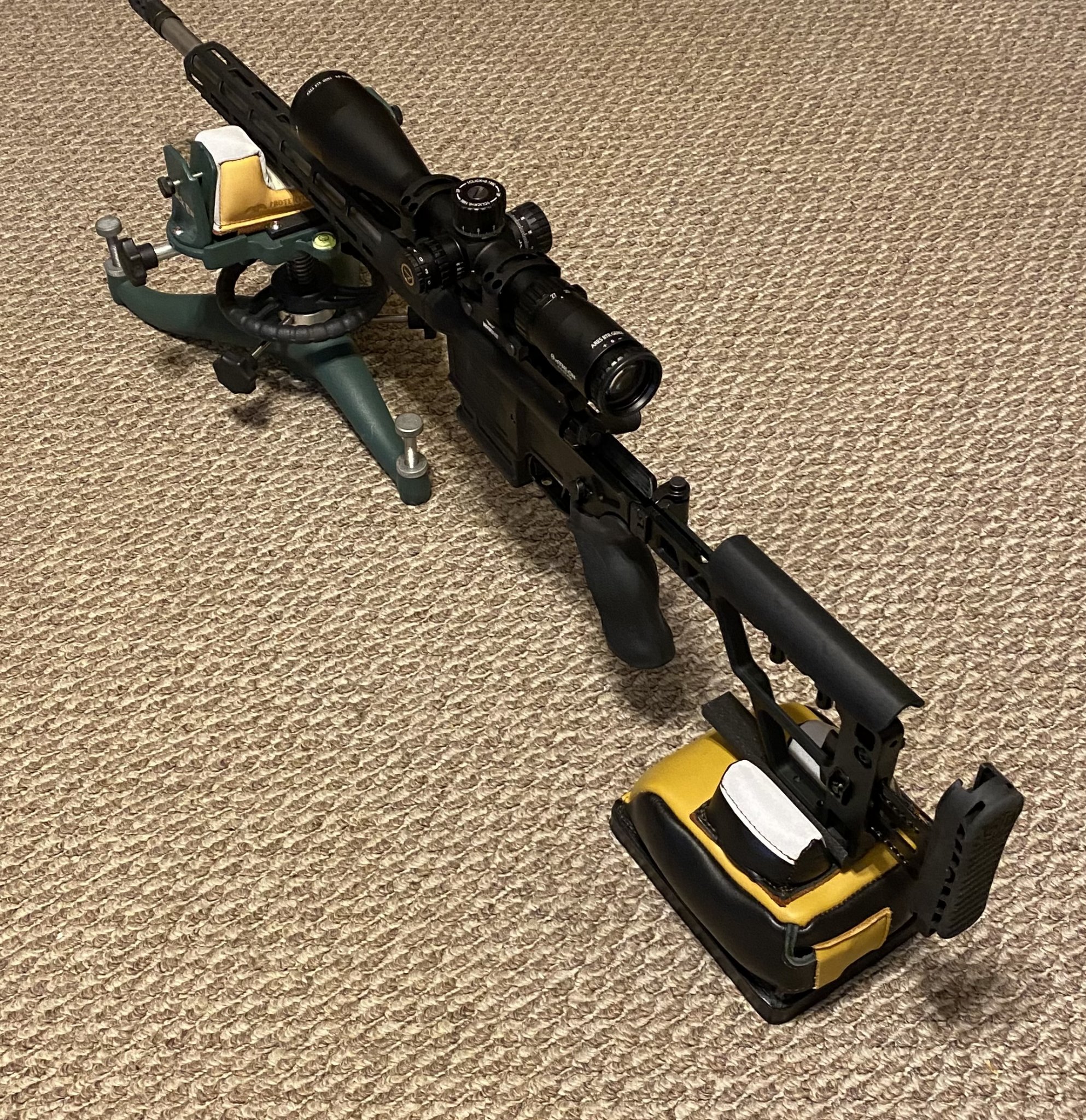

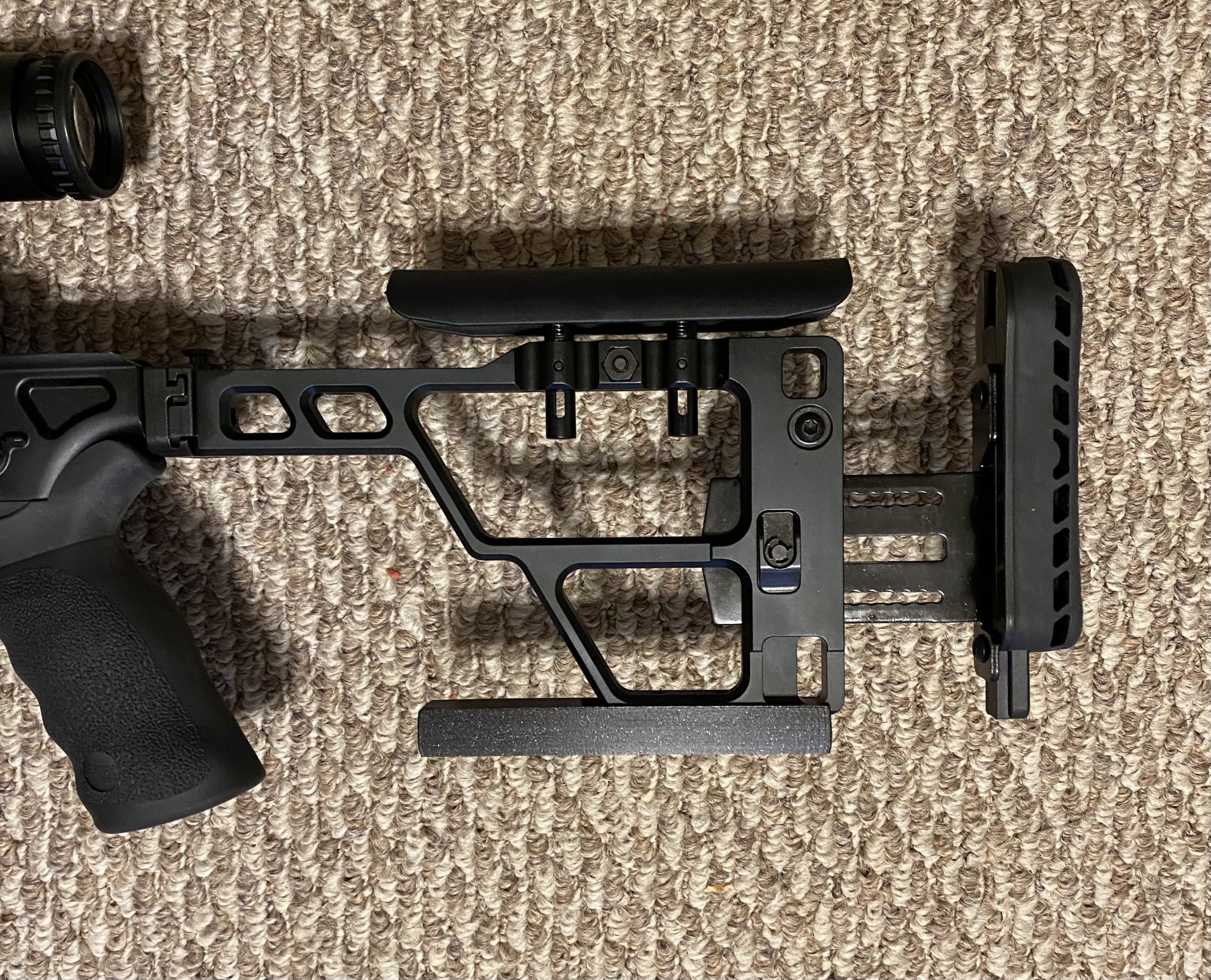

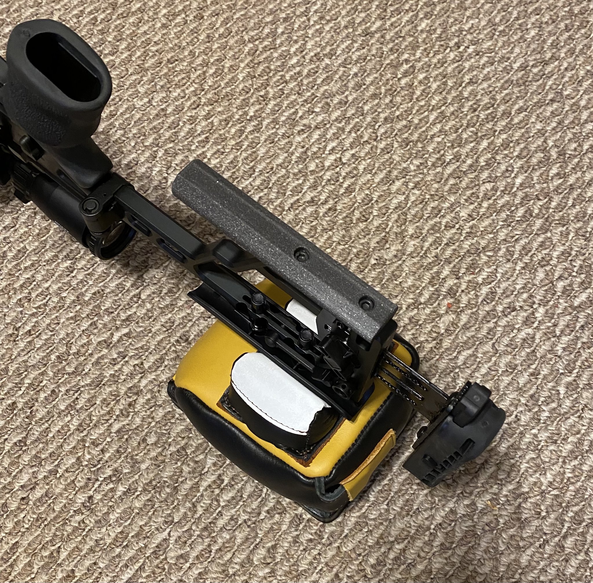

Since no one that I am aware of currently makes an aftermarket bag rider for this rifle. I decided to model up a prototype in solidworks and 3D print one. It bolted right up using the stock screws and worked flawless. Clearance for the screw heads was a bit tight with my printer but not bad. Might make a few small tweaks in the near future, but its made form standard PLA and is very light if thats a concern. Very sold with full infill in the print. If anyone would like the .STL file to print on their own I would be happy to send.
Nice. I would like one.

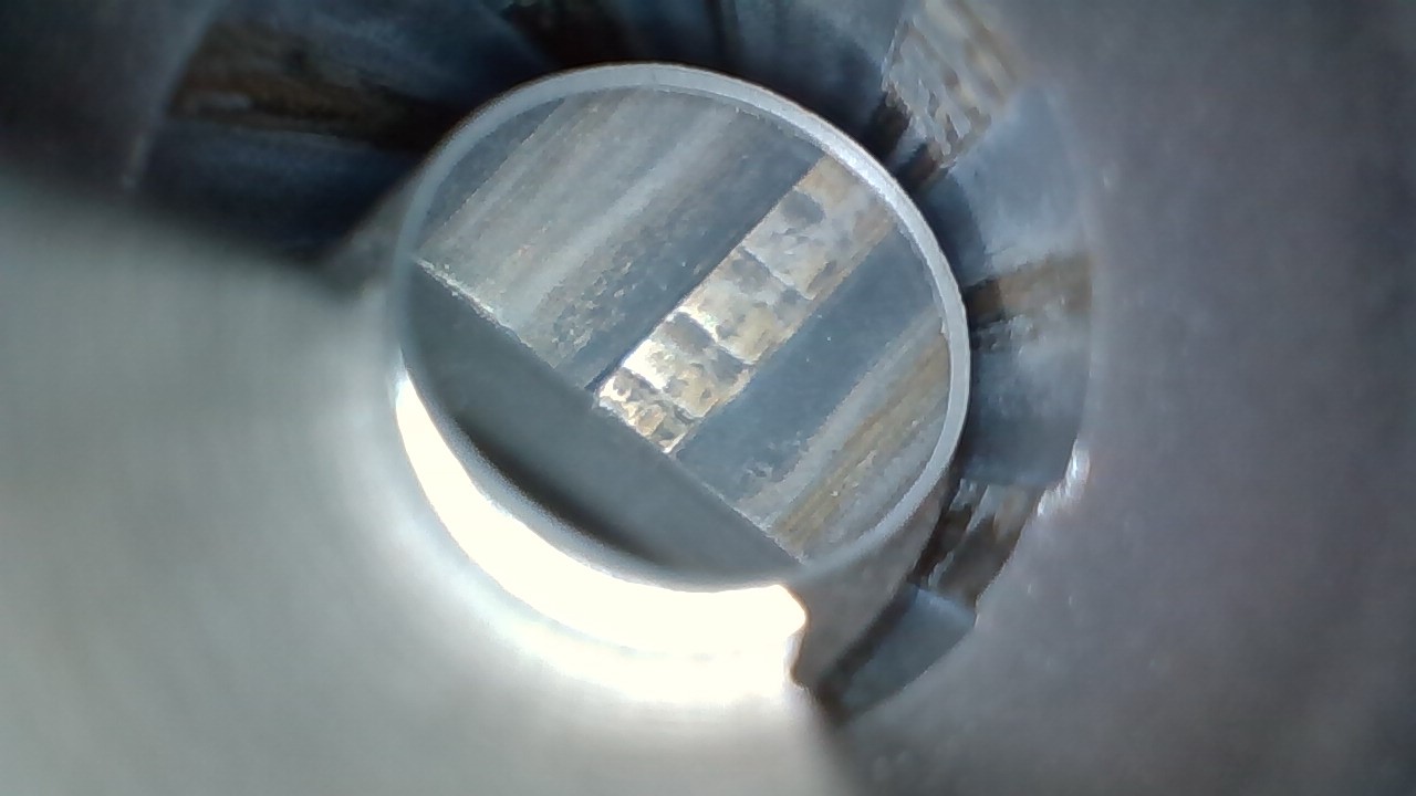

Has anyone else borescoped their barrel? Mine is kind of scary at the muzzle.
It's a 6.5 and shoots riight at 1 MOA with Prime, which is usually a 1/2 MOA load in other guns for me. Bigger issue I've noticed is that it pulls about 2 MOA high when it gets hot.
