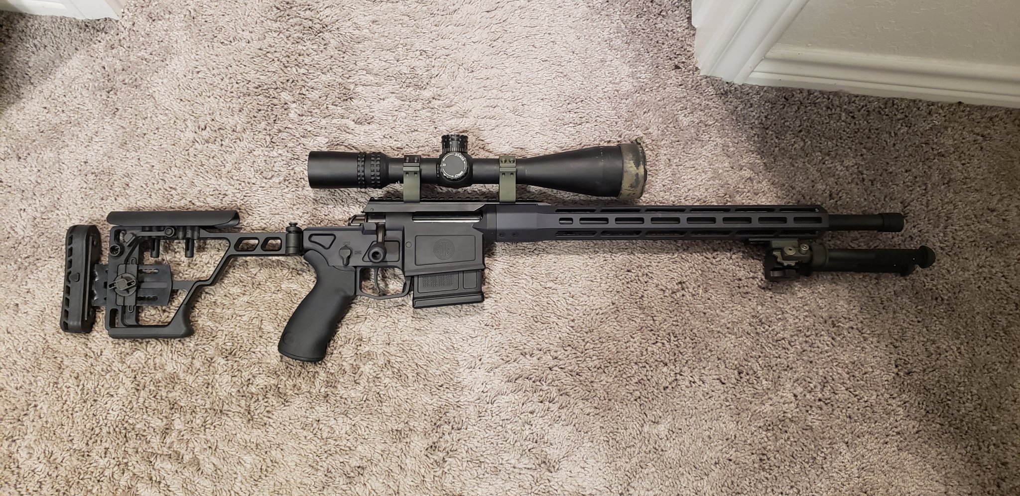

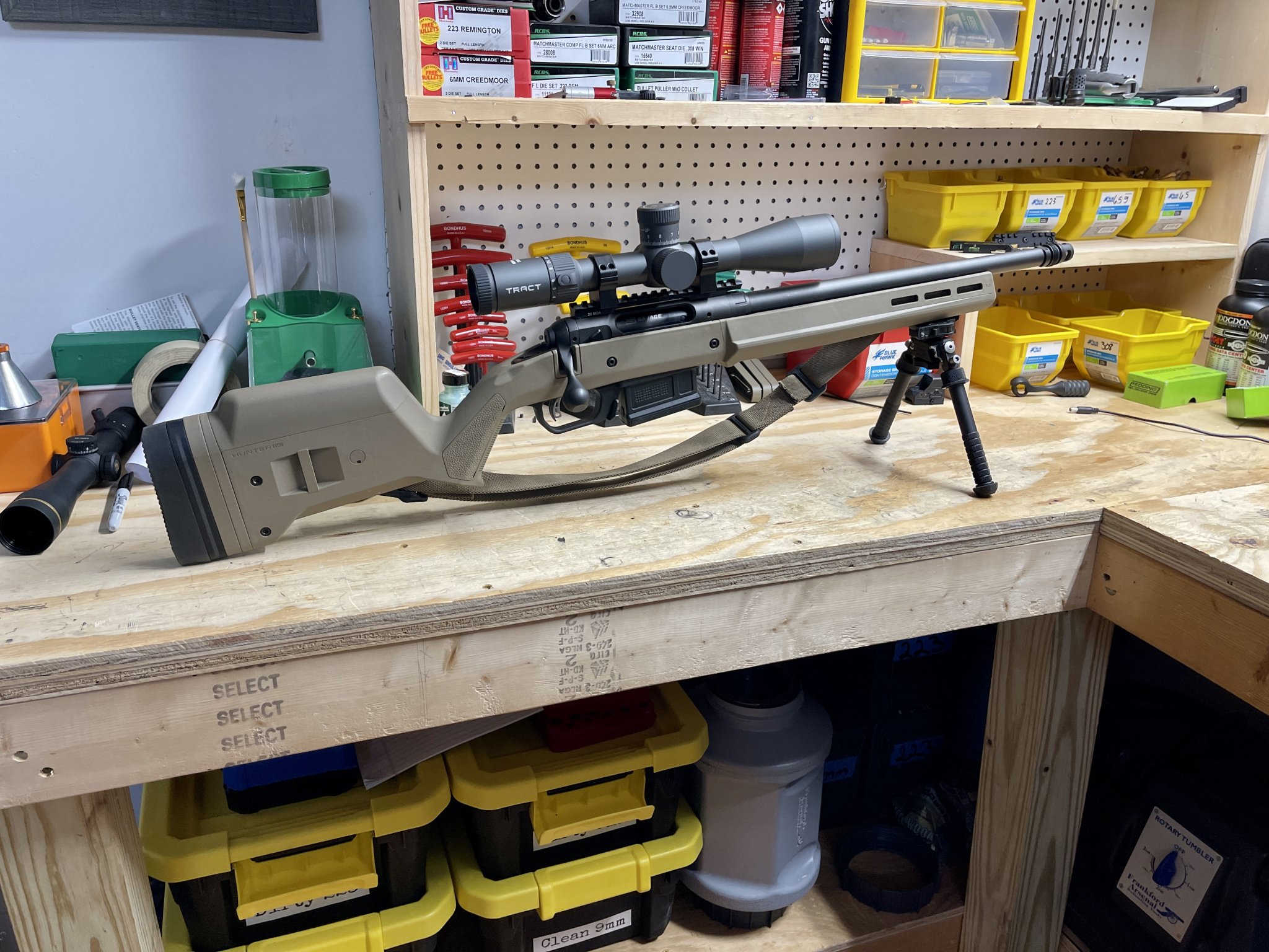

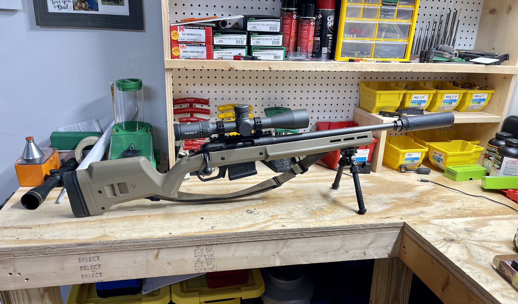

Has the sig cross made anyone else LOVE short rifles?
I just had a 18” savage cut down to 16” and threw a tract hunter scope on it.
View attachment 8125055View attachment 8125056

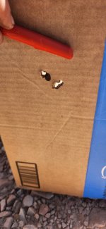

Well, we got rained out, so I don’t have pretty groups to share (targets ripped), so we’ll have to wait another week here.
I did notice that Norma shoots at least as well as Hornady, which was not the situation with the stock Sig barrel.
More important for me than the absolute precision is that the barrel does not walk under long strings of fire, unlike the Sig.

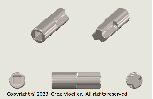

Hey folks - Who would be interested in purchasing an action wrench for the SIG Cross?
I am talking about an honest to goodness tool, not an OUT OF STOCK fantasy that SIG or taconesports.com advertises for $175+. After days of trying to enjoy the "multi-caliber" concept that attracted me to the SIG Cross (see thread here), I have reached a point where I am ready to do something. Not to brag, but rather to establish my street creds ... I have three degress from decent schools (Mechanical Engineering BS from WPI, Engineering Mechanics MS from Virgina Tech, MBA from MIT) and have 30 years of experience including ~15 years of prototype development for the military (some for SOCOM).
Right now, I am getting the tools designed and a price quote for a limited manufacturing run, e.g. 6-24 pieces. The price will be below $175 and the tool will make a lot more sense than what I have seen available.
Any takers? If your would consider buying one, please like this post and I will use that to gauge interest.
Update (3/17/2023).
Please see the initial design concept below. My thought is to build a tool that leverages what many of us already have in our toolboxes where possible. The action wrench depicted in the image below would fit on the end of a 1/2" socket extension and torque wrench. The person using this tool would need a method to secure the gunbarrel (preventing it from rotating), such as a bench vise with soft jaws or a barrel vise.
Update (3/28/2023):
We are going to take measurements at the end of this week and get a prototype 3D printed to check fitment before doing detailed manufacturing drawings. If you would like one of these tools, please like this post and I will reach out to you directly. We can define pricing once we get a quote from a machine shop.
Comments and suggestions are welcome.

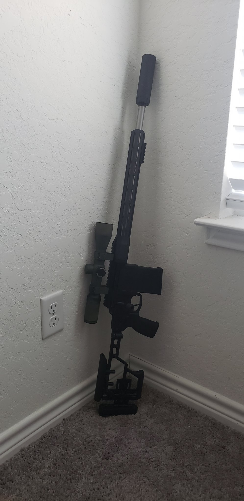

Been fairly happy with my sig cross it will be turned into a 22 creed for coyote and deer once my reamer arrives. The barrel has been my biggest complaint. It took 250 ish rounds before it started shooting consistently and I tore it down and retorqued every as well. I've got 800 ish rounds down it. (6.5 Creedmoor) 2 deer and couple of matchs. The POI shift from load to load is horrendous and can't fiqure out why it would shift .7- 1.0 mills even with the same charge and different projectile. I know it's harmonics just odd its such a huge drift. It does shoot well but gotta keep it in its happy node.

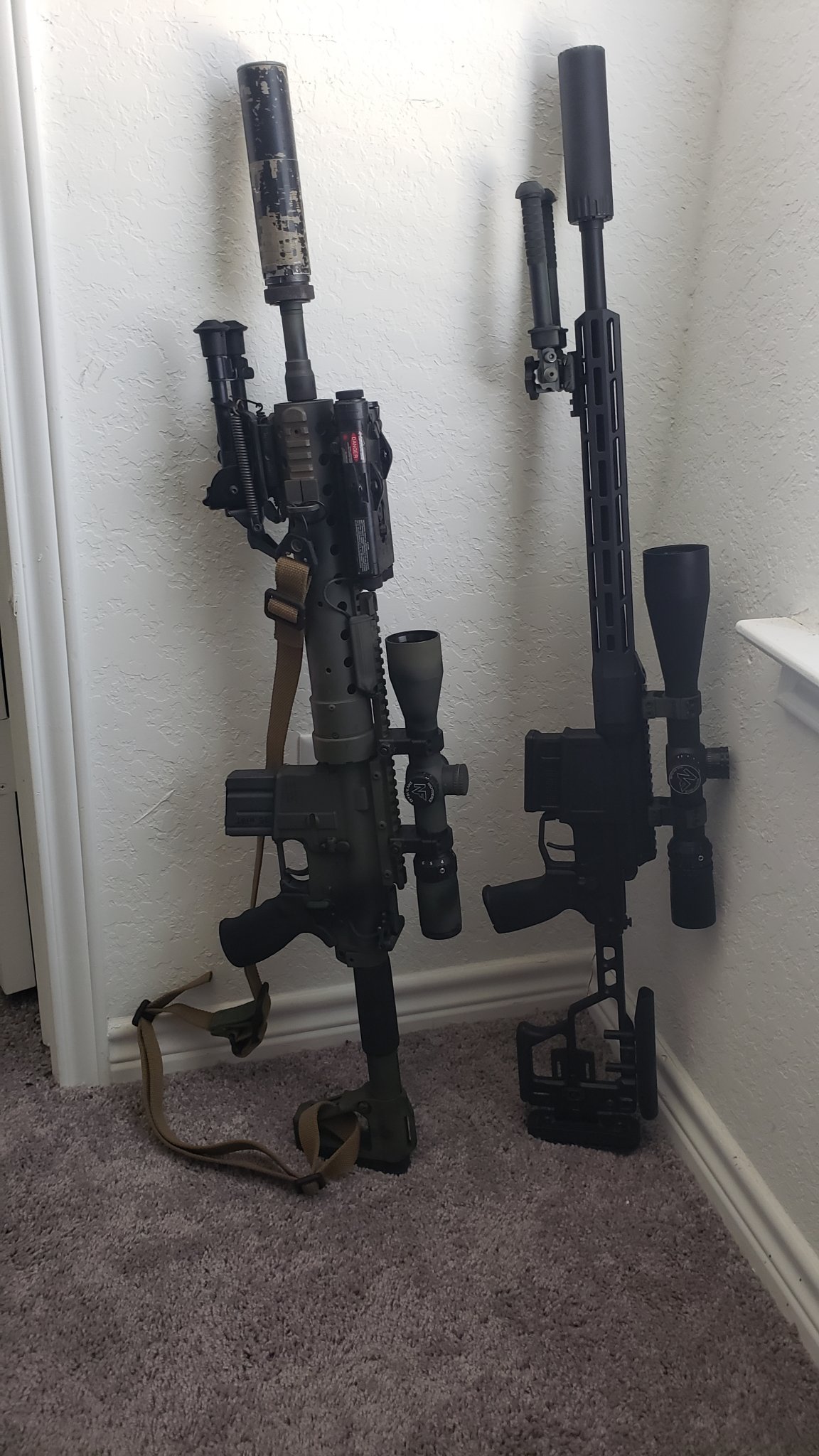

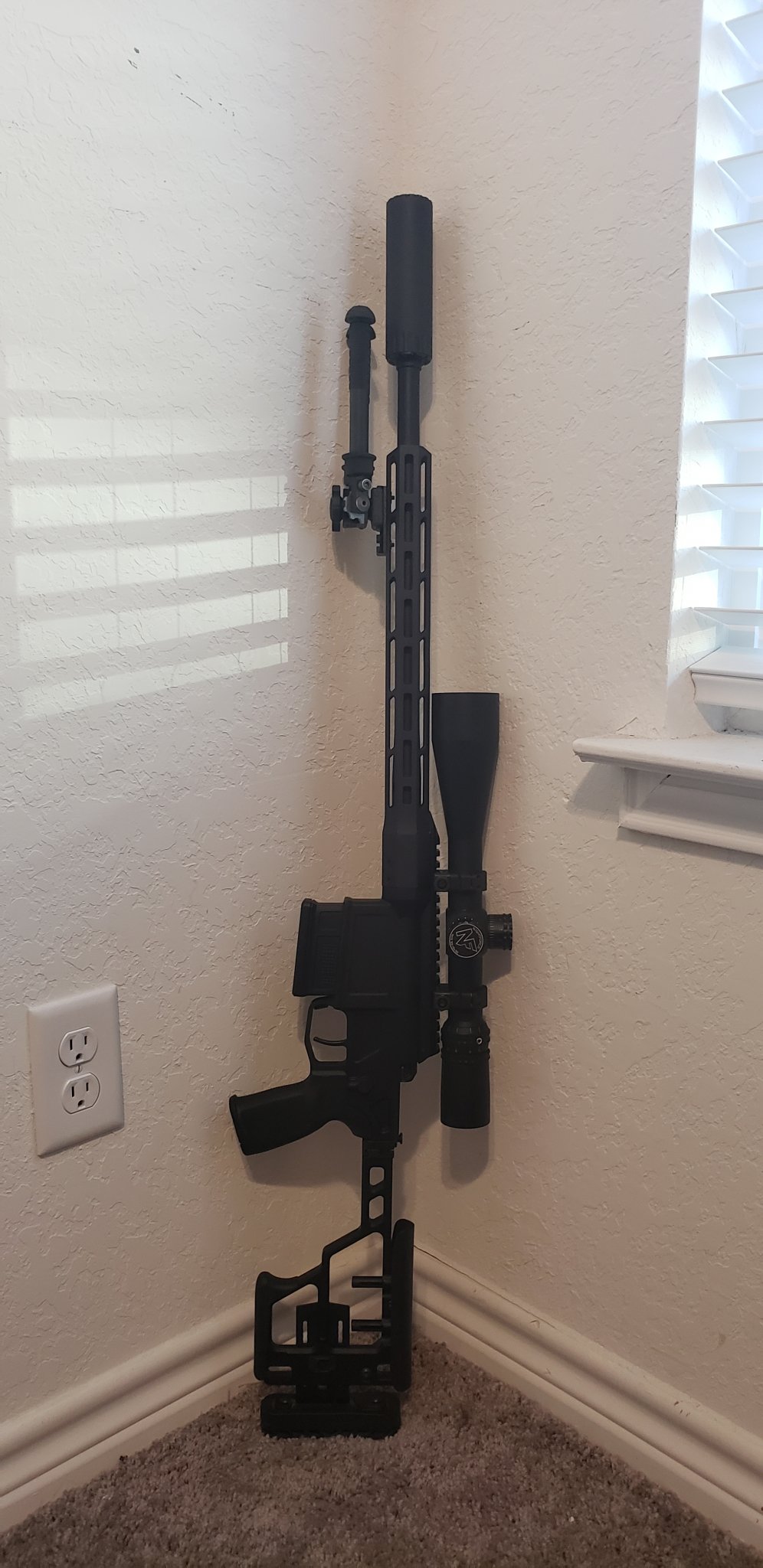

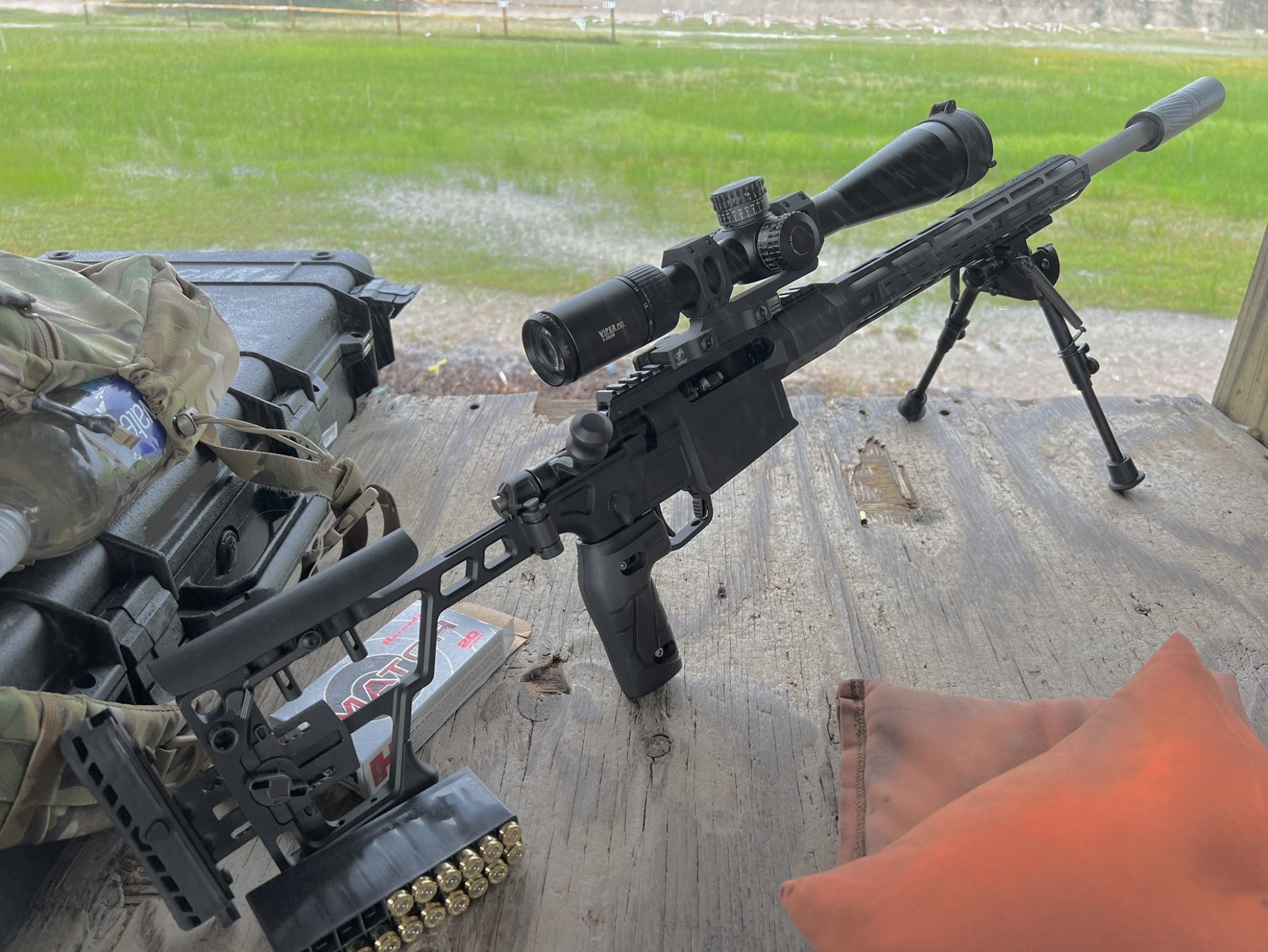

Finally back in the Cross club. I had a 2020 in 6.5 Creed that was a pretty good rifle. Let it go for something else and moved on. I wasn't ever really impressed with the accuracy in that one, but to be fair I had it when the options for off the shelf ammo were very limited and very expensive.
I've kinda come full circle and took a long look at what I wanted from a hunting rifle and found this one locally.
After playing with some different optic/ring setups I've finalized on an NXS 3-15x50 in Vortex rings. I've tried out an SHV 3-10 and Razor 5-20 as well. The nxs kind of fell between them and is going to work for me for a while. Later on down the road I may try out a VX5/6 or a Razor LHT.

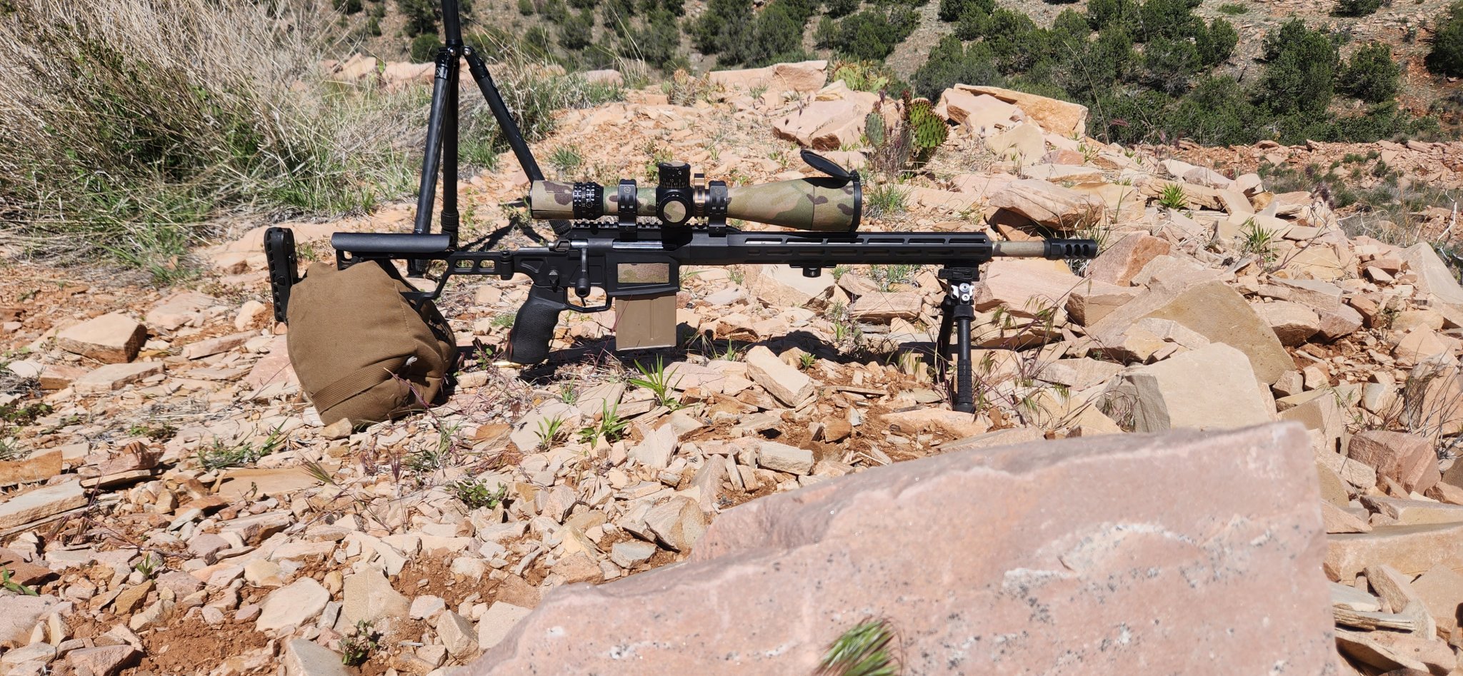

I wasn’t about to read 54 pages but q came after the McMillan Alias .so the bashing was pretty funny a few years ago.
I’m happy with my cross but I wish sig would actually release the barrel change kit and release a 6.5 prc
