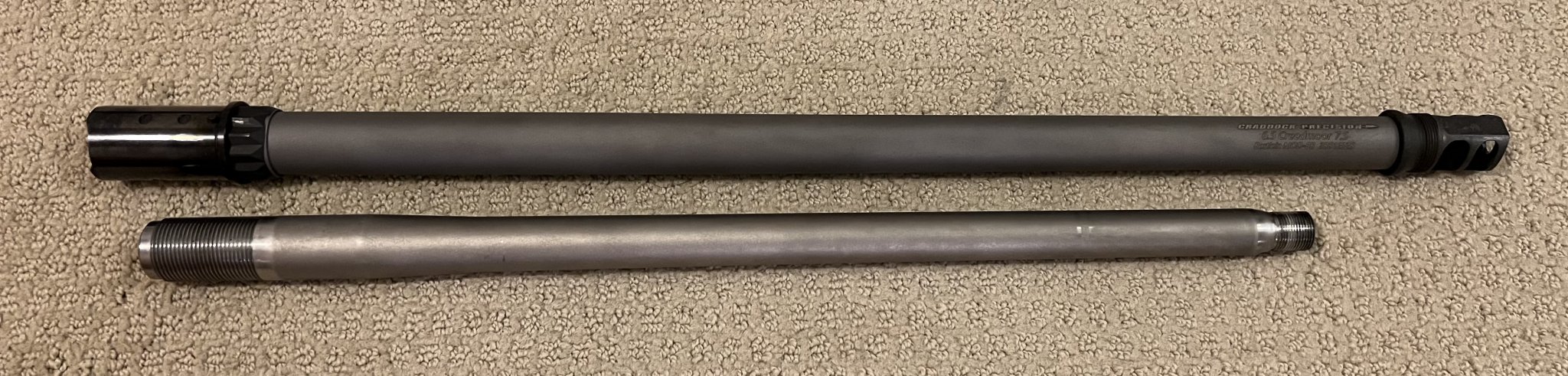

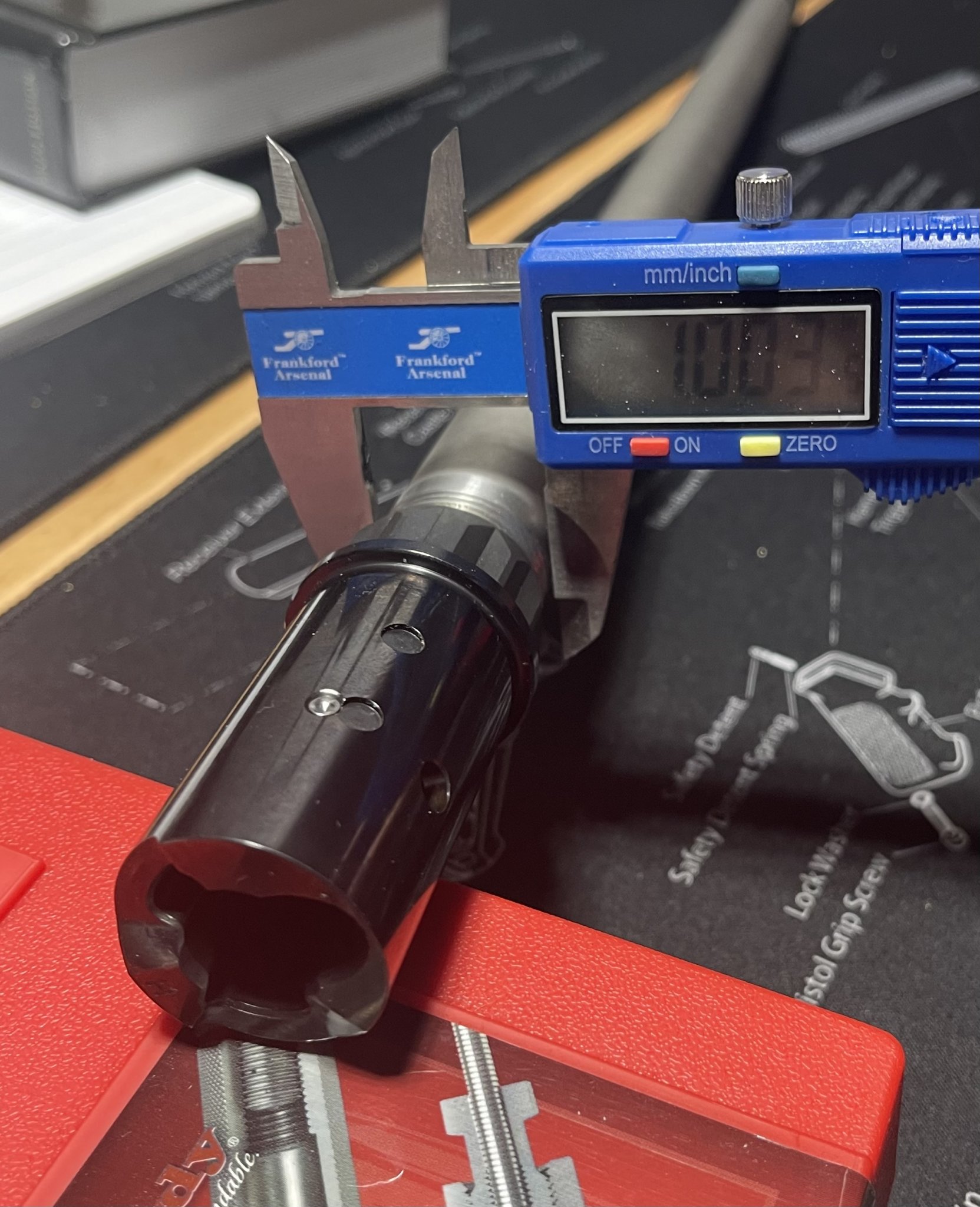

I don't have calipers. I was hoping someone with a factory 6.5 barrel may have already measured and could provide some feedback. I'd appreciate it!
I can get that measurement for you later since I have a spare barrel laying in the bench.
Can you measure your barrel diameter right next to where the thread starts?
1.00”

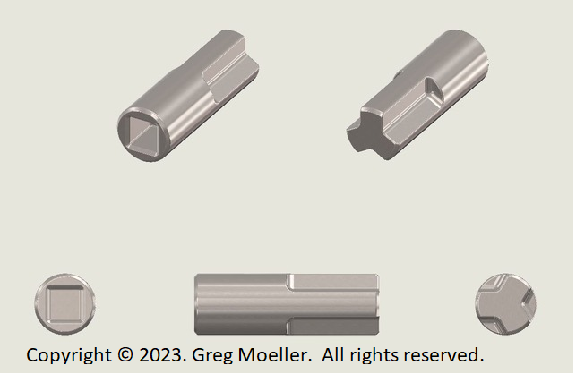

Hey folks - Who would be interested in purchasing an action wrench for the SIG Cross?
I am talking about an honest to goodness tool, not an OUT OF STOCK fantasy that SIG or taconesports.com advertises for $175+. After days of trying to enjoy the "multi-caliber" concept that attracted me to the SIG Cross (see thread here), I have reached a point where I am ready to do something. Not to brag, but rather to establish my street creds ... I have three degress from decent schools (Mechanical Engineering BS from WPI, Engineering Mechanics MS from Virgina Tech, MBA from MIT) and have 30 years of experience including ~15 years of prototype development for the military (some for SOCOM).
Right now, I am getting the tools designed and a price quote for a limited manufacturing run, e.g. 6-24 pieces. The price will be below $175 and the tool will make a lot more sense than what I have seen available.
Any takers? If your would consider buying one, please like this post and I will use that to gauge interest.
Update (3/17/2023).
Please see the initial design concept below. My thought is to build a tool that leverages what many of us already have in our toolboxes where possible. The action wrench depicted in the image below would fit on the end of a 1/2" socket extension and torque wrench. The person using this tool would need a method to secure the gunbarrel (preventing it from rotating), such as a bench vise with soft jaws or a barrel vise.
Update (3/28/2023):
We are going to take measurements at the end of this week and get a prototype 3D printed to check fitment before doing detailed manufacturing drawings. If you would like one of these tools, please like this post and I will reach out to you directly. We can define pricing once we get a quote from a machine shop.
Comments and suggestions are welcome.

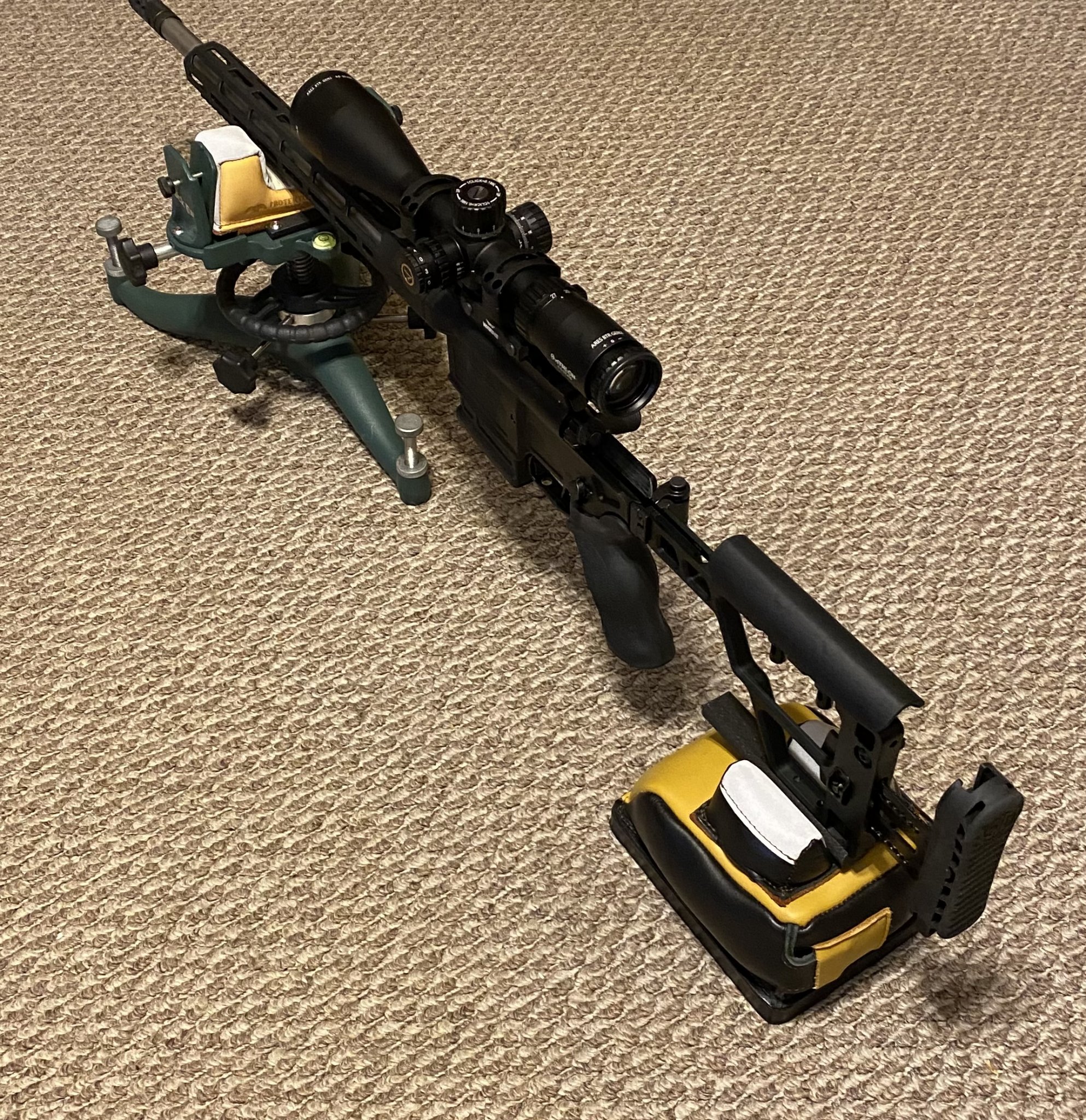

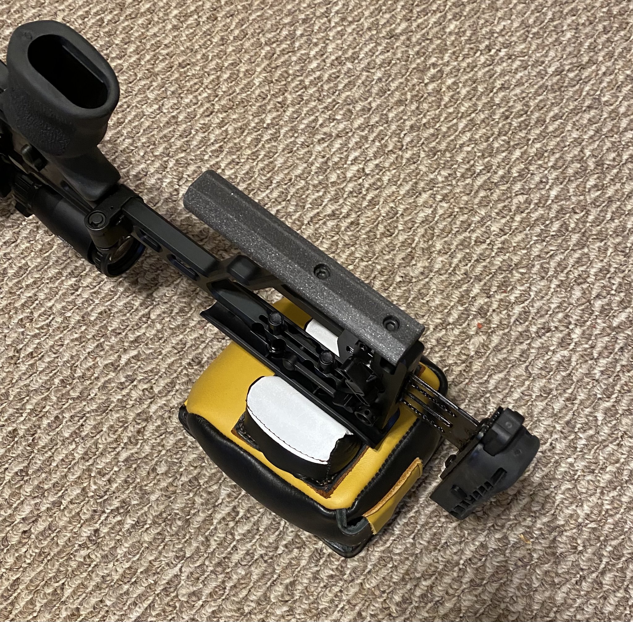

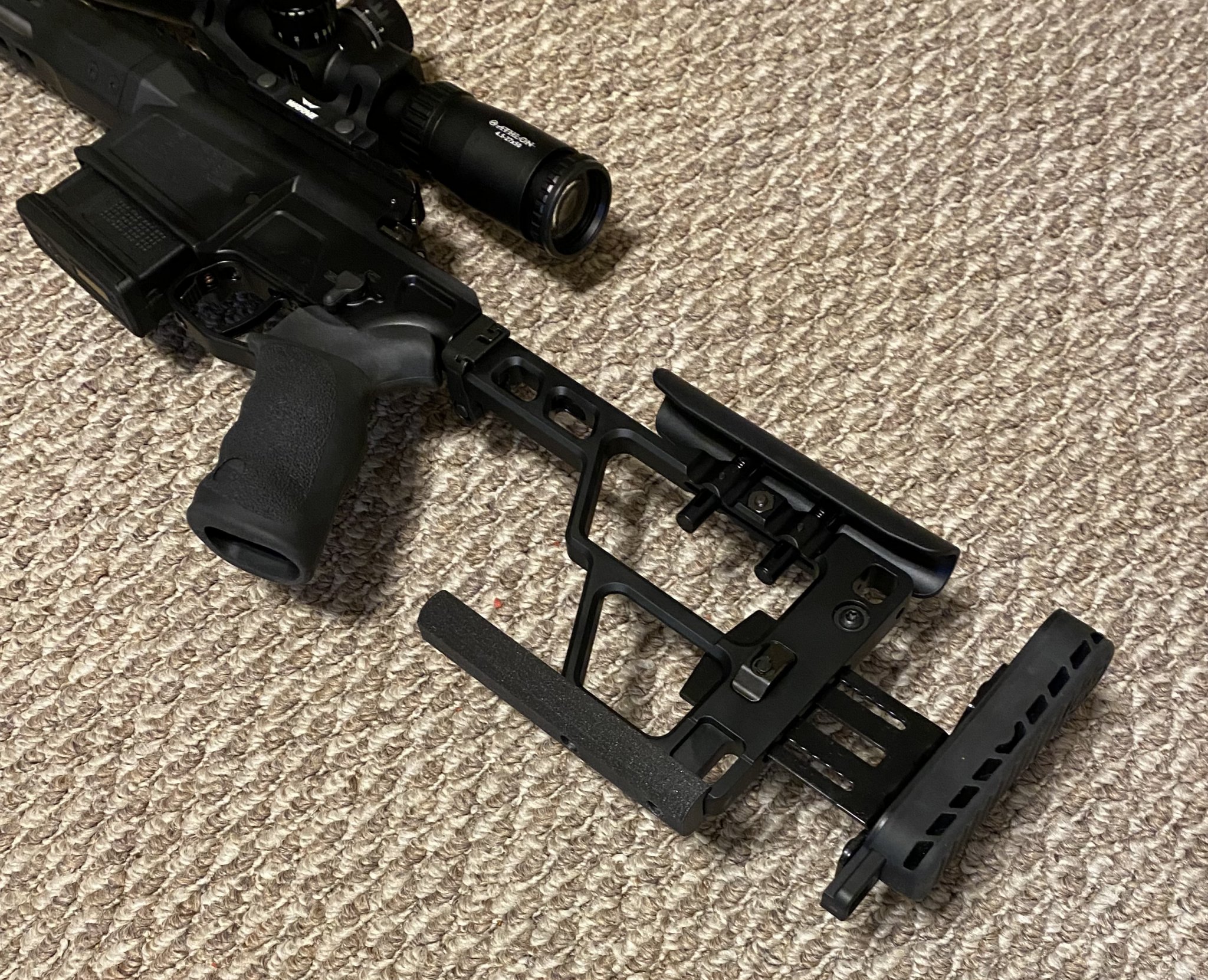

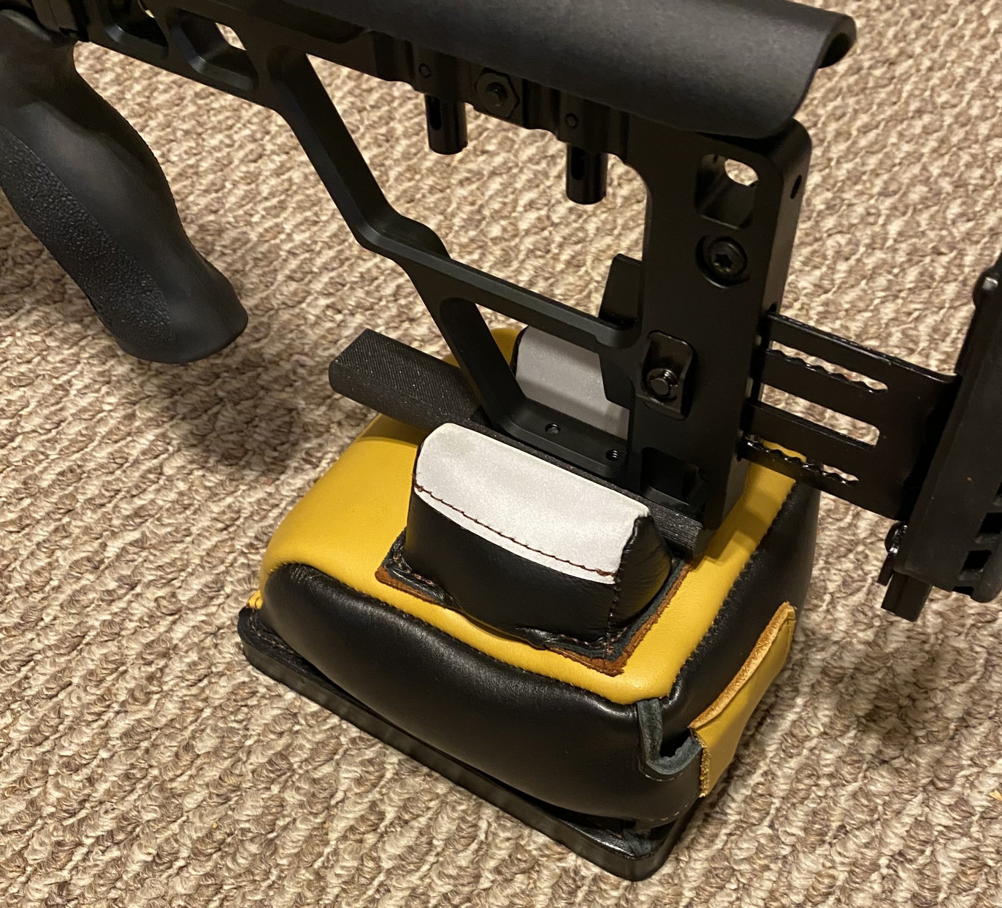

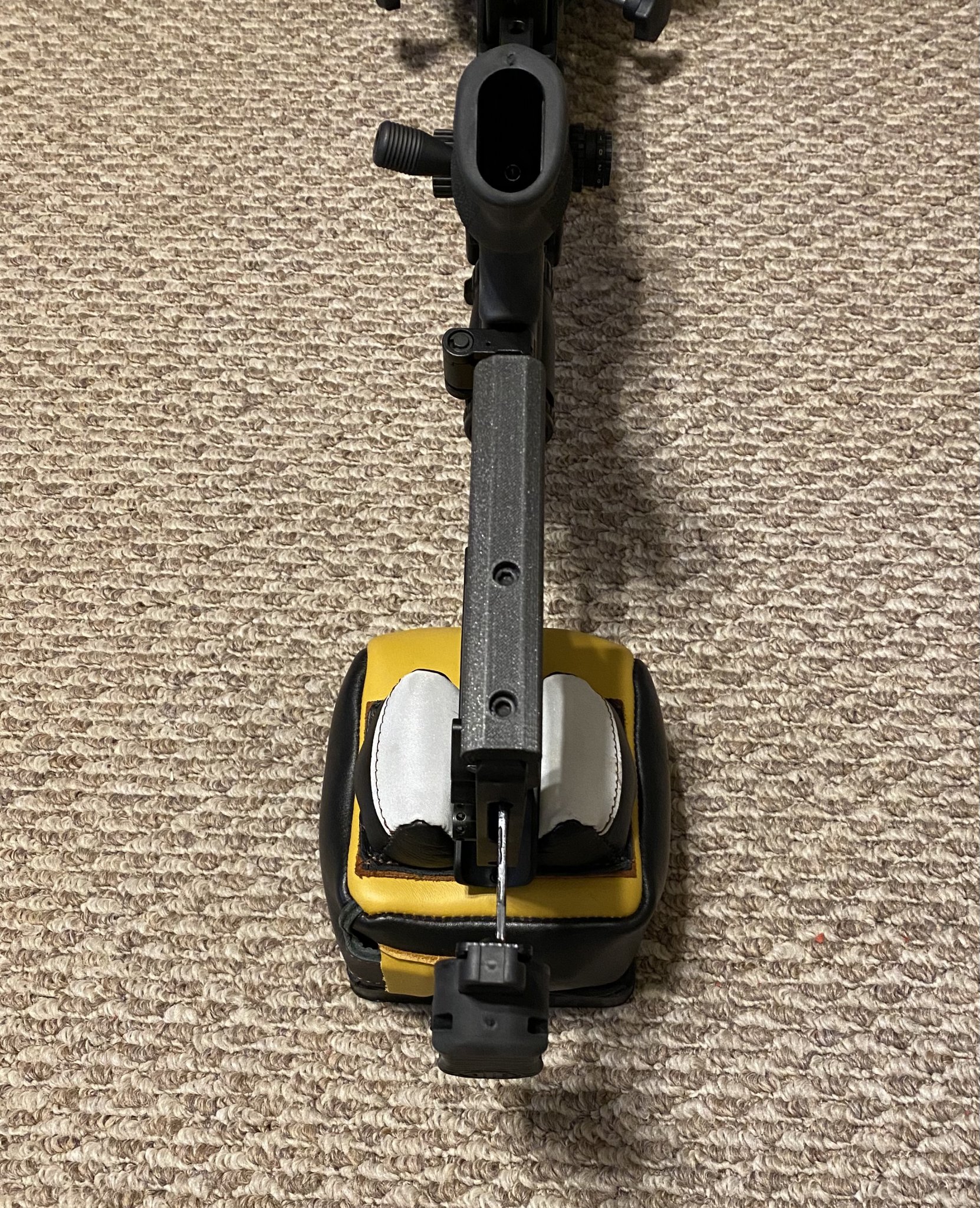

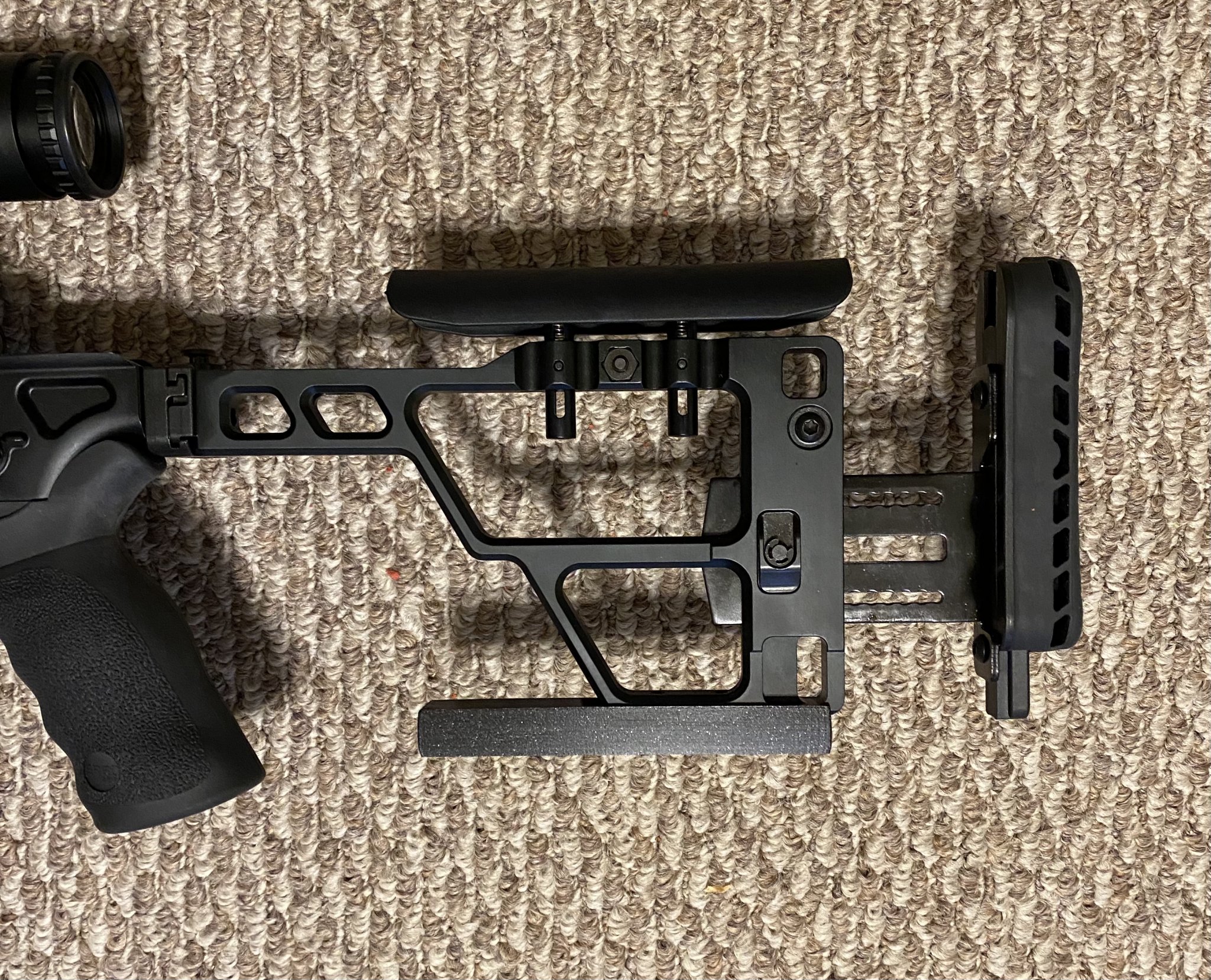

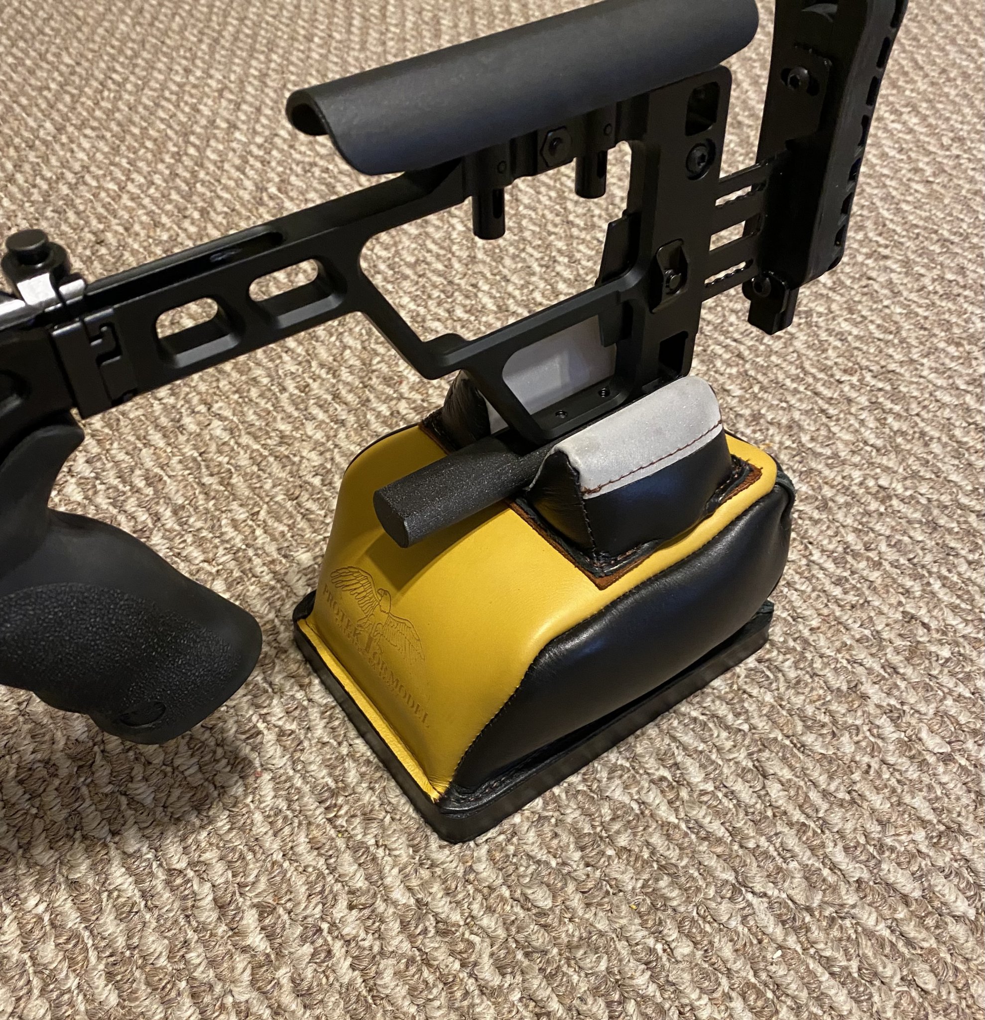

Since no one that I am aware of currently makes an aftermarket bag rider for this rifle. I decided to model up a prototype in solidworks and 3D print one. It bolted right up using the stock screws and worked flawless. Clearance for the screw heads was a bit tight with my printer but not bad. Might make a few small tweaks in the near future, but its made form standard PLA and is very light if thats a concern. Very sold with full infill in the print. If anyone would like the .STL file to print on their own I would be happy to send.

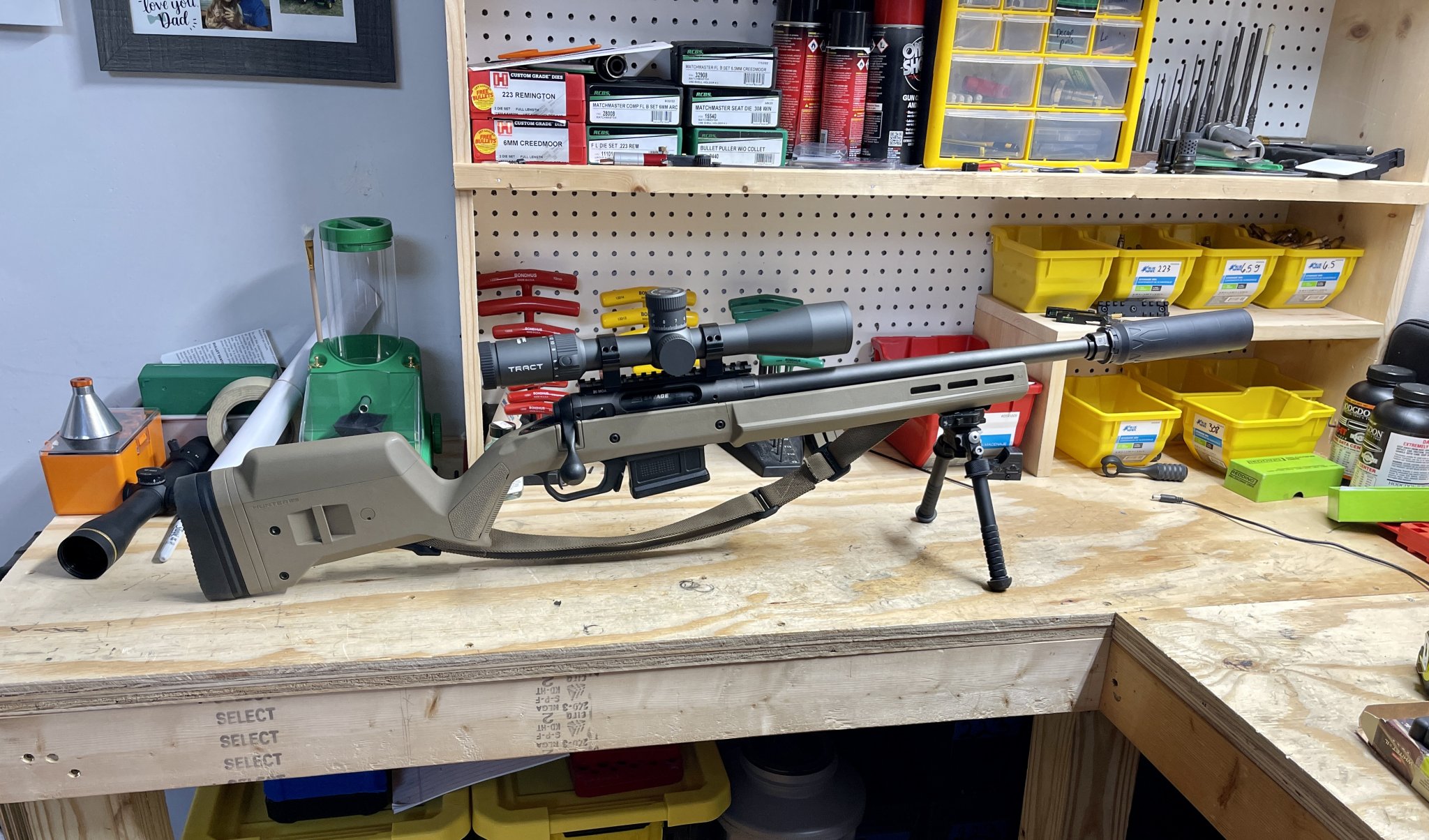

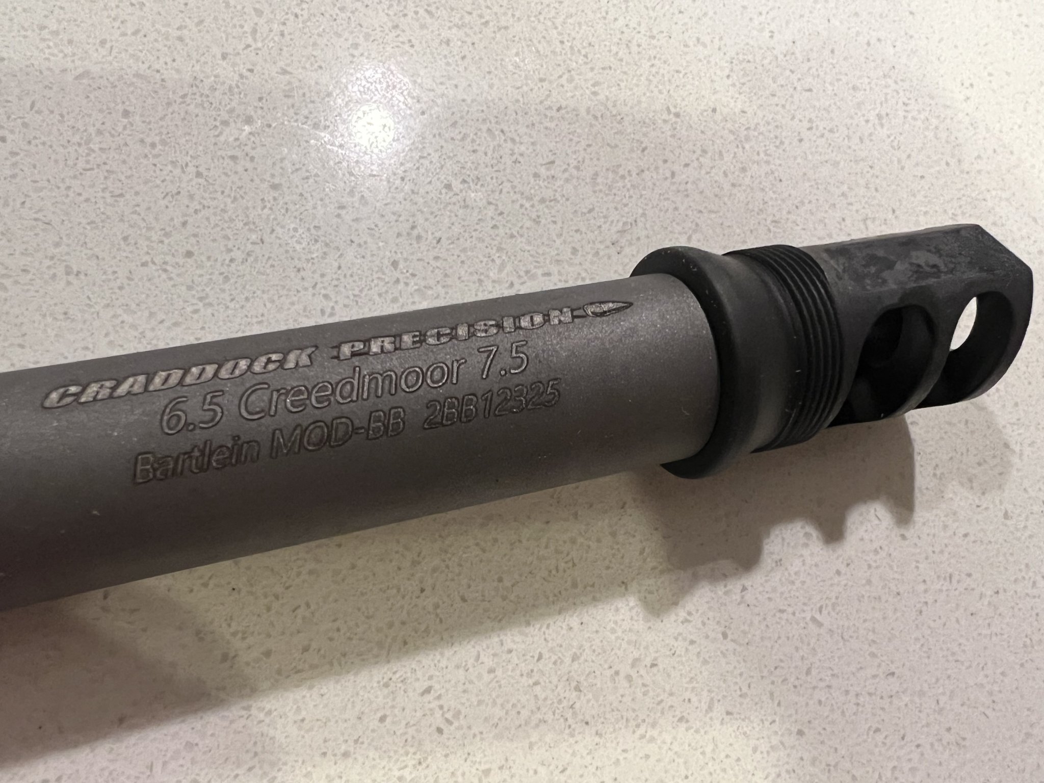

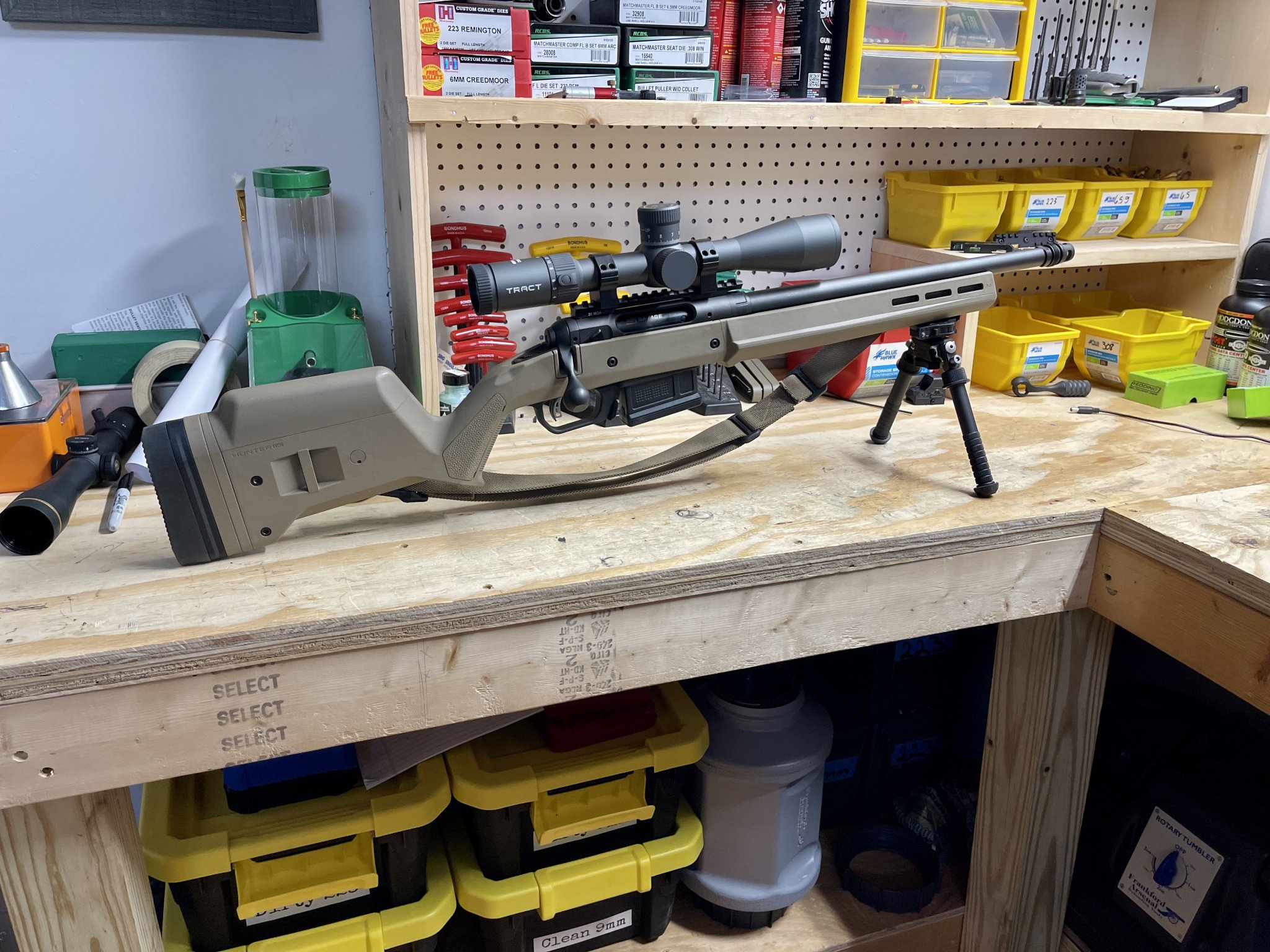

I had some pretty serious heat drift issues with my original Sig barrel - issues persisted after a trip back for a barrel swap. I decided to stop messing around.
Paul Craddock of Craddock Precision is working up a Bartlein 400MODBB barrel for me in 6.5 Creedmoor with an M24-ish profile. Will report back when it arrives and I’ve had a chance to run it through its paces.
Given the work he’s done before, I’m excited for the result and the turnaround times once these are in production.

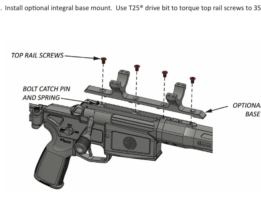

Sig customer service advised that the “integral base mount” pictured on page 91 of the manual has been assigned a part number, but is not yet available. Based on the recent availability of the 0 MOA picatinny mount, the rep guessed it will be available “soon”.
Nice. Did you get a price?
