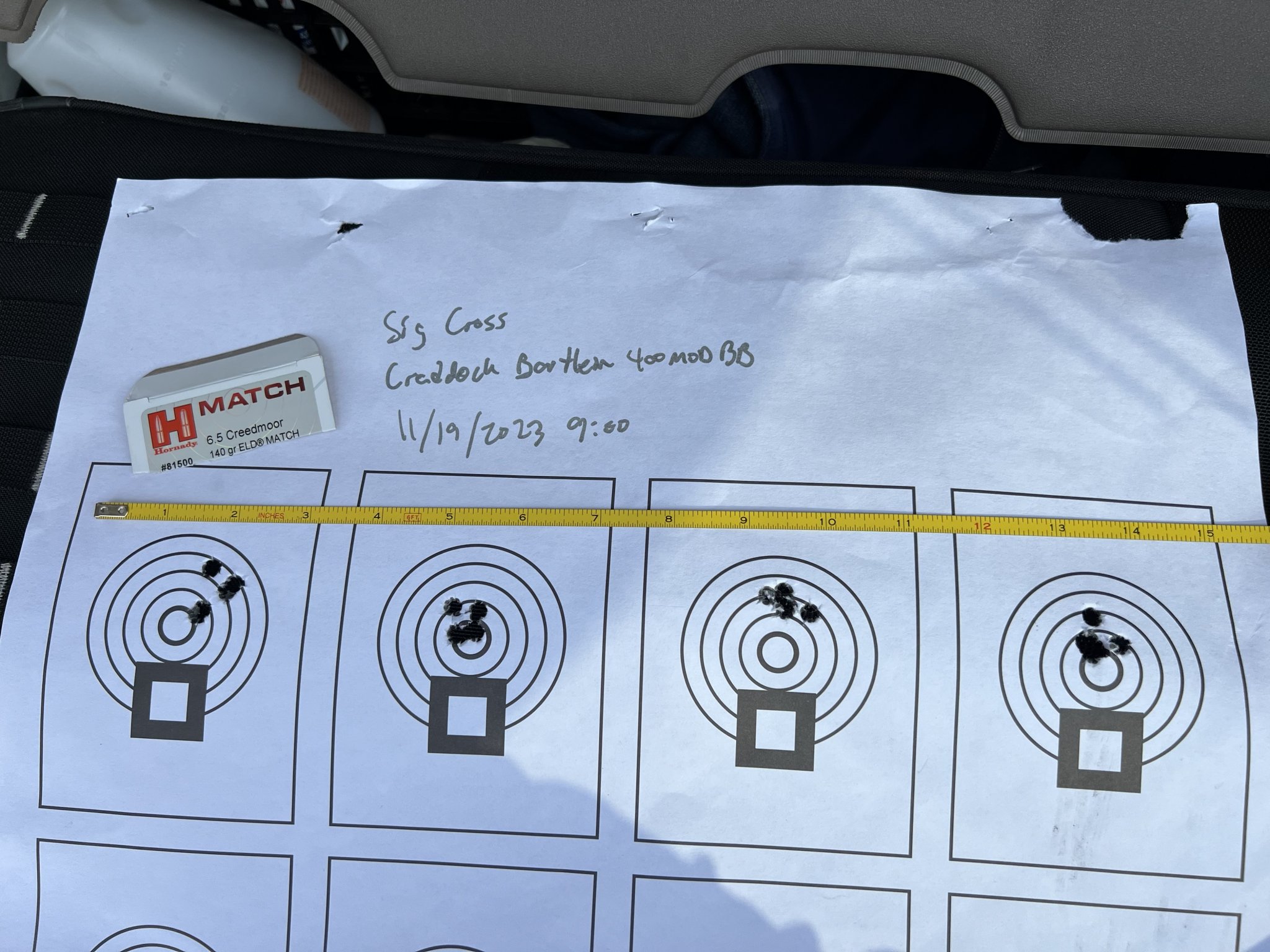

Update on my Craddock barrel, spun up on a Bartlein 400MODBB - it shoots. I’m not fantastic at printing bugholes, but at 100 yards, I printed four groups under 3/4”, in pretty quick succession (maybe 10 mins of shooting).
I first undertook this project because my stock barrel would walk like crazy under heat. This barrel is practically passive by comparison. Love it, and Paul is great to work with.
