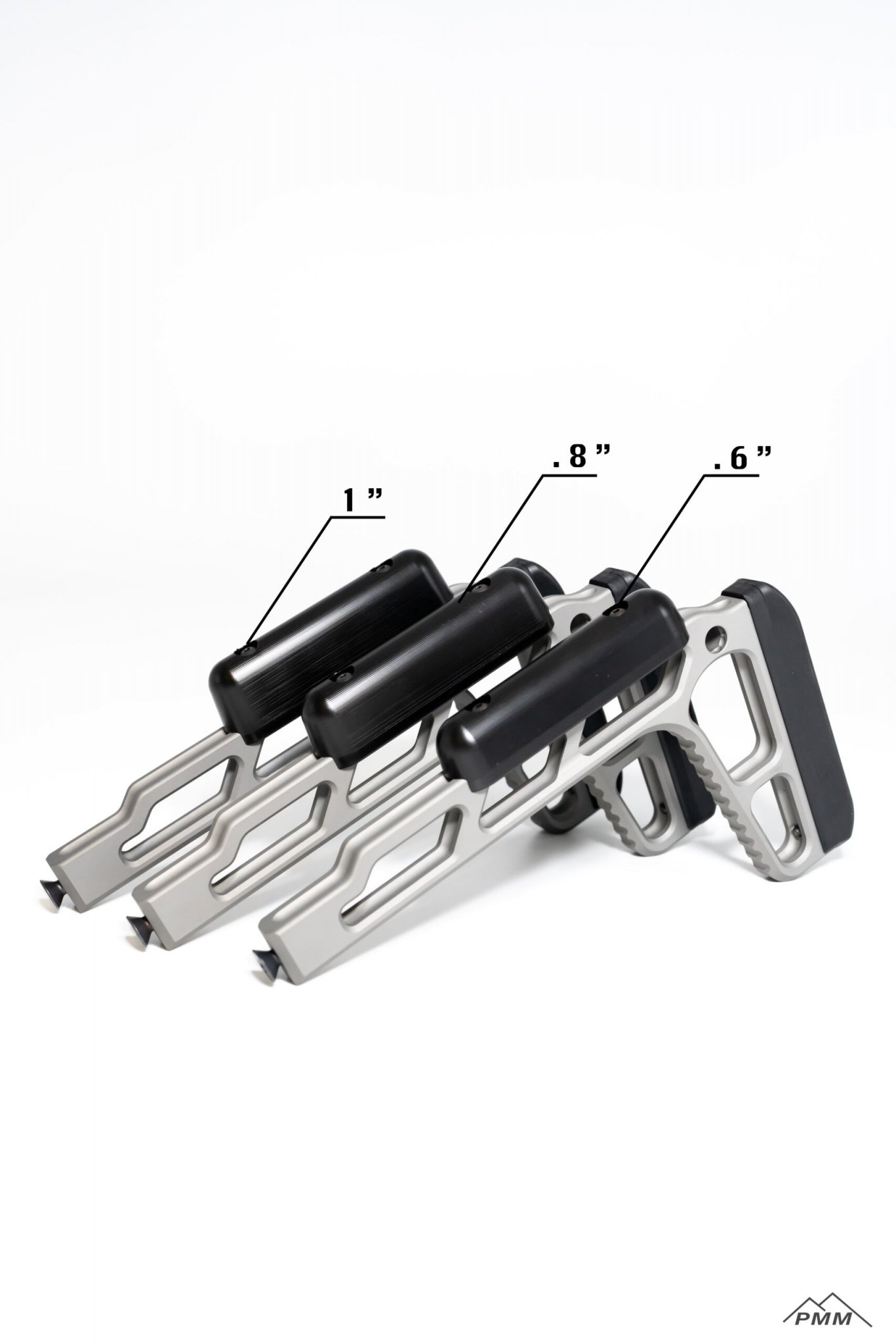

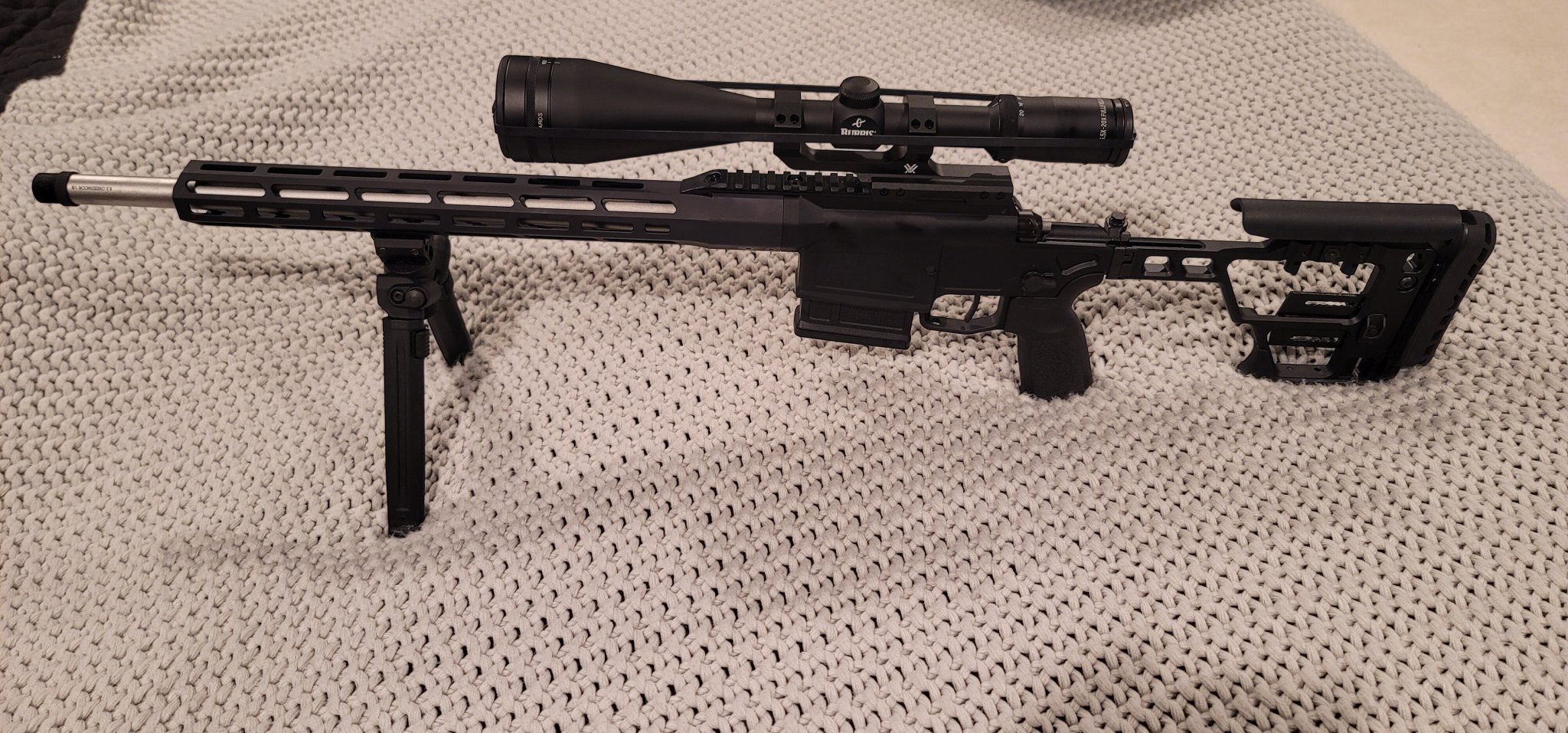

New Sig CROSS
Ok...hear me out.
I want to replace my stock with this...
Thos should drop somewhere in the neighborhood of 10 ounces or a bit more.

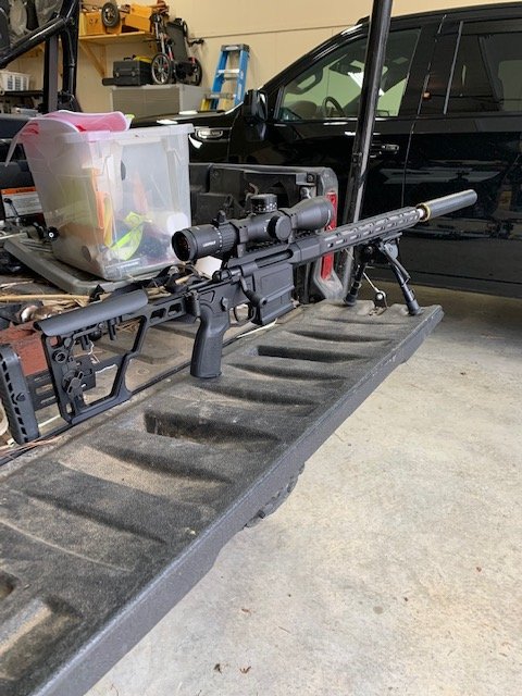

I recently picked up a used Sig Cross in 308. Initially, I had some accuracy issues. Changed scope rings, mounted them differently and torqued everything down properly. Shot it today with good results! I share this only because of negative posts by some.
Worked up a quick load for mine this weekend. Found some 150 nosler ballistic tips, varget, 210M and Lapua brass and gave them a shot. All shots were from bipod at 150. Not too bad for stock small light weight rifle. Shot sub 1” at 150 pretty much anything I shot through it.F489422C-155A-4309-994F-B66C96772F32.jpegAF45F6D6-7449-4150-A88F-6439687CC164.jpeg
Reactions: Gtscotty
Nice set up. I was originally going to go with the MK5 for mine, but went with the LHT 4.5-22 simply for the weight savings. My can “should” be out of jail here in the next 2 weeks for it, of course right after hunting season is over, lol
