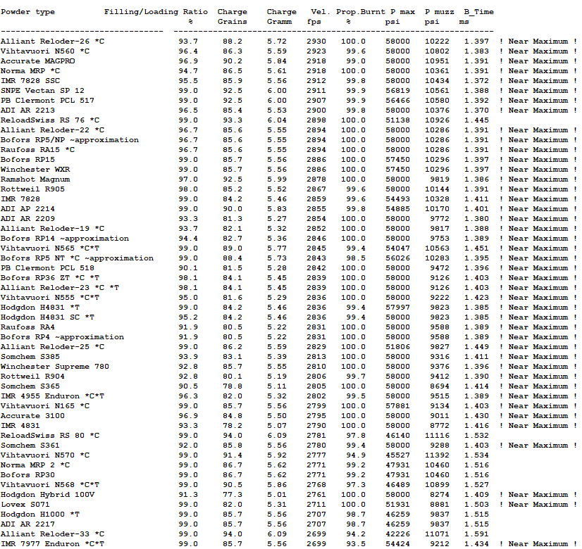

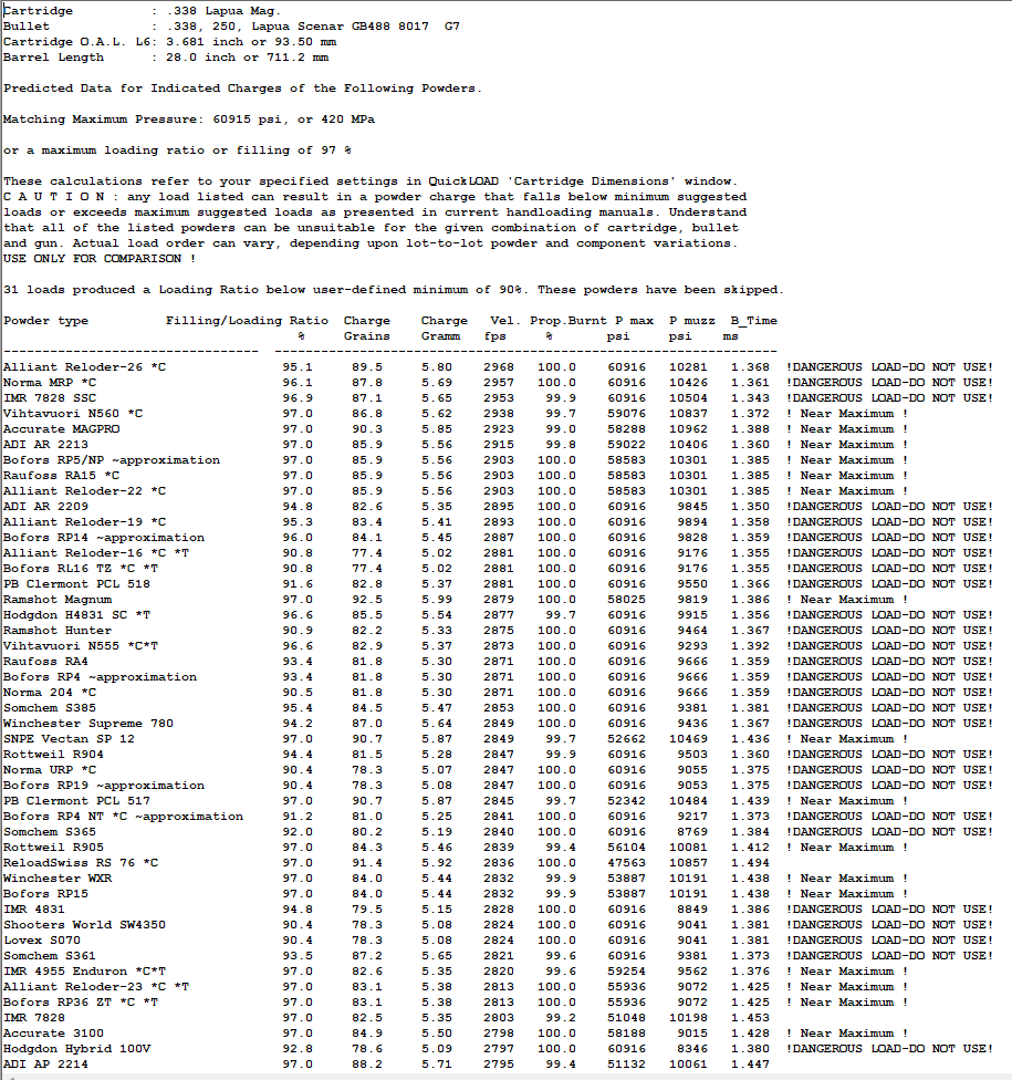

For 250s, here are some good powder options...

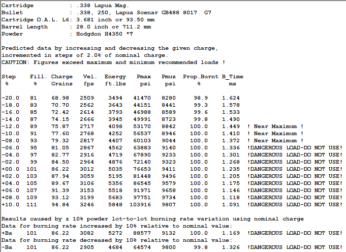

And if you were wondering why using H4350 would be a bad idea?
It's a best practice to keep your Fill Percentage somewhere in the 90s. You can do the 80s, but it starts to get a bit iffy and DO NOT GO INTO THE 70s because that can lead to a detonation (all powder burns at once vs linearly from the primer to the neck).
If you're shooting 250s in an average .338LM barrel length (26-28") you should be easily in the 2850-2950fps range. With H4350 you're really only safe in a slim window of charges. In Kurdish we'd say that's "Nah bash!"

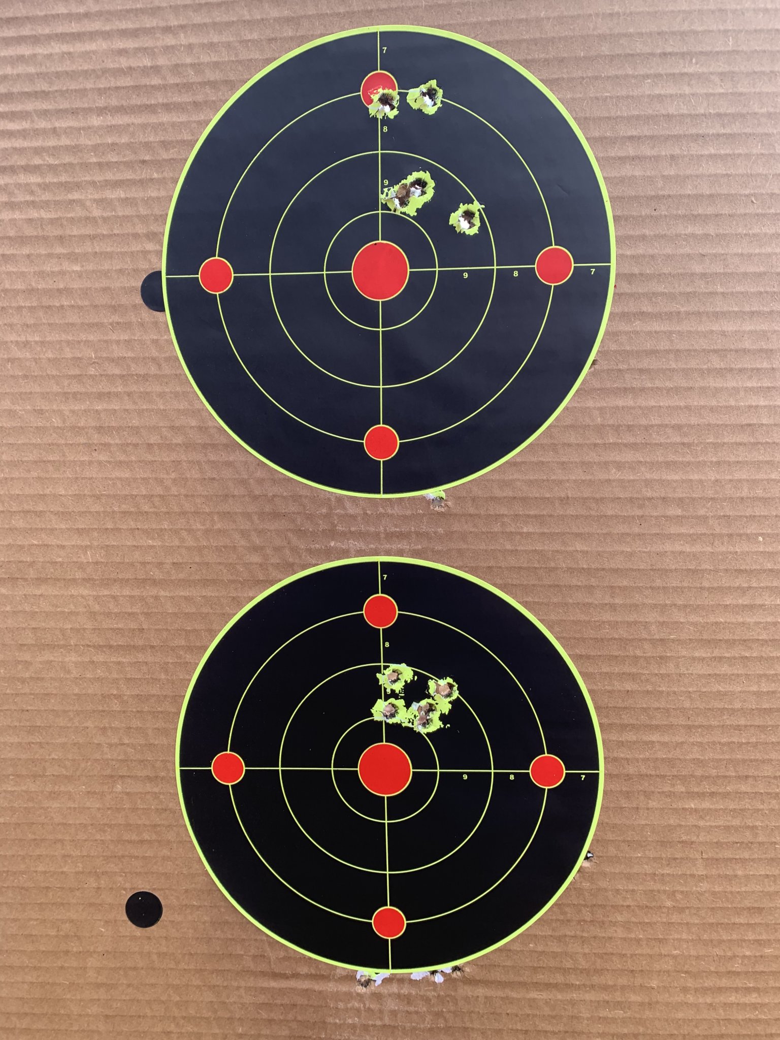

New to the Forum and precision shooting. Been reloading my 300 win mag, 270 win, 308 hunting loads for many years. Bought a 338 LM Ruger Precision a few years ago, created a great load for it. Bought a Christensen Arms MPR 338 LM about a year ago, still working on loads for it. Using a Berger OTM Tactical 250, H1000, Fed 215 Primer, Lapua Brass on both guns.
Not so happy with CA MPR. Feeling like now, I am chasing loads rather than finding one! Bipod only, no beanbag rest for stock.
Being a "rookie" at this load and caliber, I am seeing some trends from these posts...the gun runs more accurate on a 300 Gr bullet with H1000. Is this correct? Also, according to Nosler Reloading data, H1000 mid point is 92.0. I started both guns at 91.0, and worked up slowly to 93.0, then settled the Ruger Precison load at 92.8. BUT, having inconsistency with CA MPR at 93.0.
Ran five shot groups side by side with both guns. Ruger is bottom target. CA MPR is Top. 100 Yard Target, Right quartering headwind at 12-15, 58 degrees temp, fairly high humidity.
I did run another 5 shot group for each gun...Ruger stayed tight while MPR got worse, almost shotgun spray, stayed inside the target but went high then left on the last two rounds.
HELPFUL thoughts???
Thx
HELPFUL thoughts???
Thx

Good intel! Yes, you are right on the support...should have done that since I am still in the hunt for a load on this gun. I'll run them again with more secure bench rest and see how that might clean things up a bit. I've moved all my hunting rifles to Weatherby 300 Weatherby Mag, 338-378 and 30-378, so my mind has been imprinted with faster is better!!! BUT, I give into those that know this much better than me.
I do have a chrono...still in the box from two years ago LOL...I'll break it out too.
Thank you!

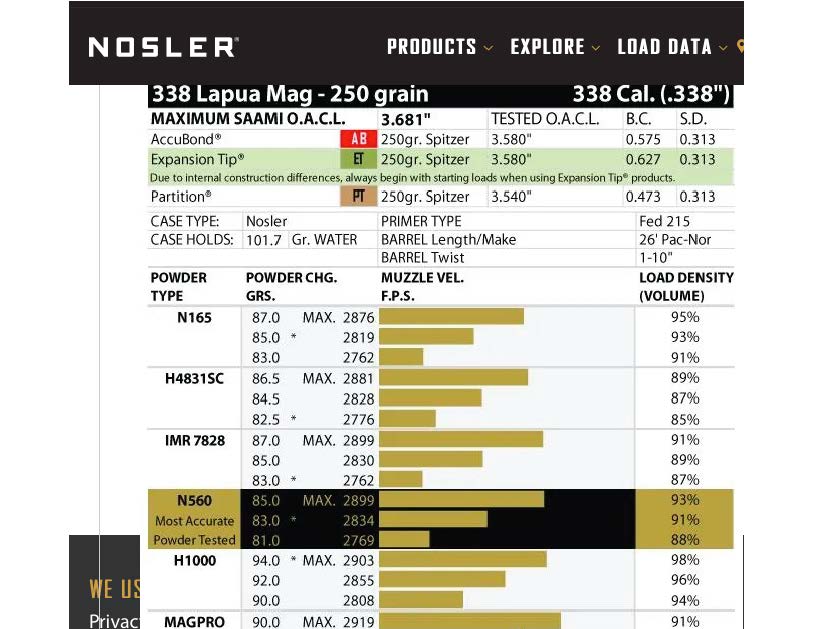

Load some 4831SC at 88.0, 88.2 and 88.4 to compare with H1000 and Berge3 250 OTM Tacticals
I think I might be over charging my H1000 and these Berger 250's. Berger says 90.0 max and I am running at 93.0 (Nosler Reloading Manual). Although, No sign of over pressure at all.
Just read through...great stuff for sure. I am going to try a few things...
Go with BiPod AND bean bag set up for bench shooting.
Sierra Manual Edition 5 , 8th printing has
250 grains , H1000 Max load as 100 grains for 3,000 fps. Sierra was using their 250 grain bullet
FYI - I found Berger to be on the conservative side and Sierra to be 100% honest. If Serria says, don't do it.. I do NOT do it.
*Disclaimer - please be aware of pressure signs and all that stuff.
Sierra used a 26" barrel, 1X10 twist, and 93.6 grains of H1000 was around 2850 FPS

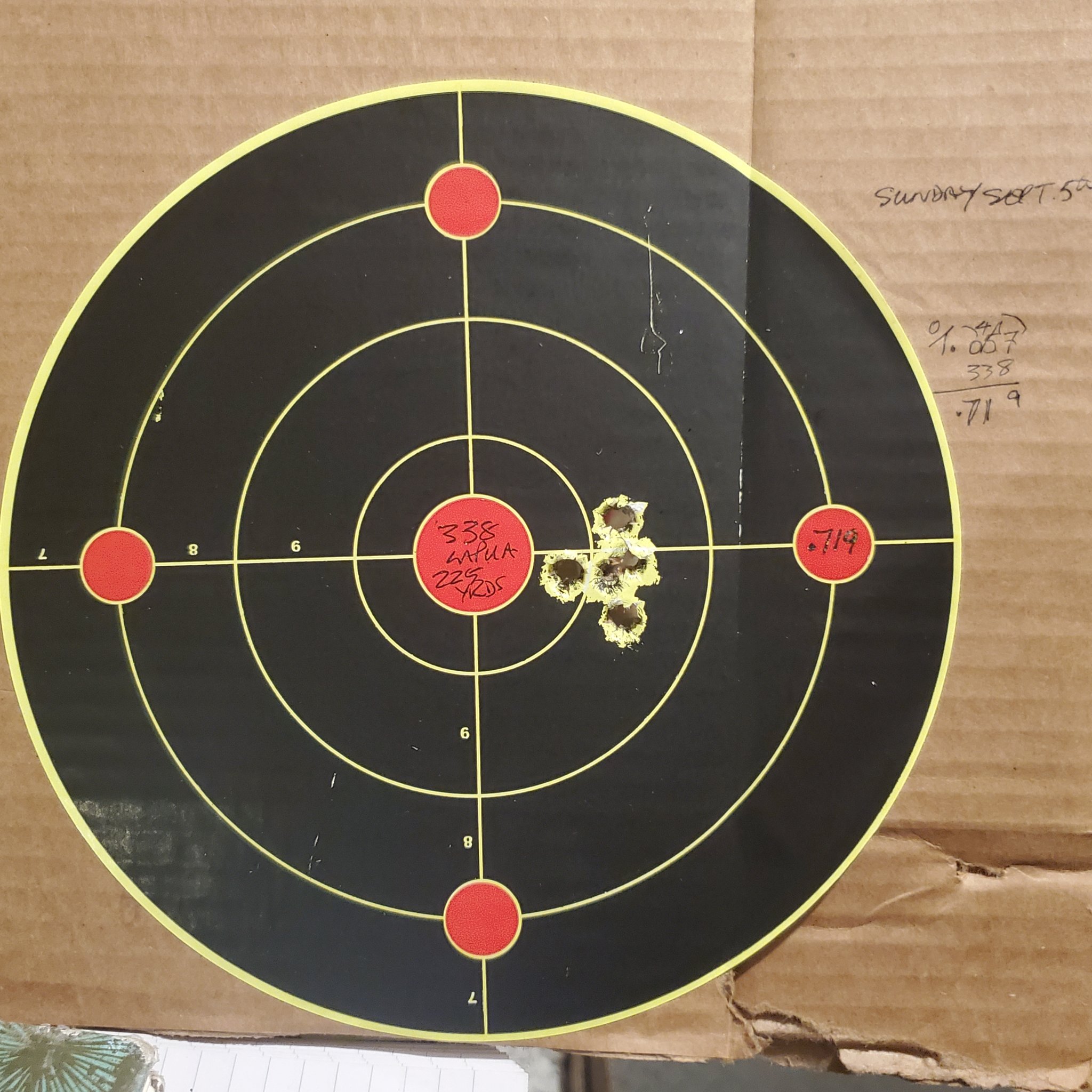

Mine loves the IMR 4831 and 250g Scenars .
