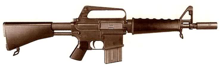

They first tried to address the issue with a 3.5" Moderator with no flash suppressor slots on the Model 607:

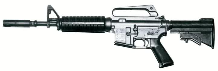

Then on the XM177E1, which actually saw fairly widespread use with officers, K-9 handlers, and LRRPs, the 4.5" Moderator was introduced:

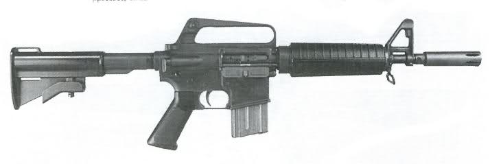

http://bpullignwolnet.dotster.com/retroblackrifle/sitebuilder/images/629-1-sm-721x237.jpg

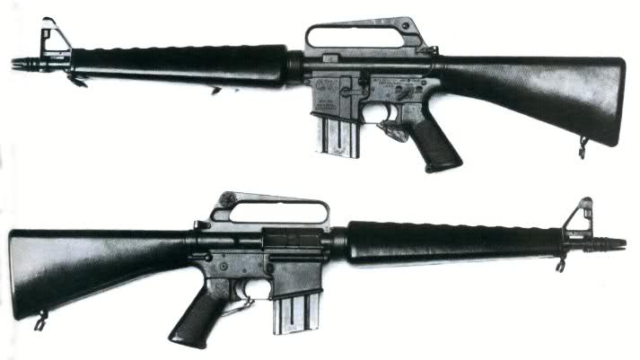

The Model 607 was the first in the Commando series, but not the first carbine, interestingly. That was the Model 605:
http://bpullignwolnet.dotster.com/retroblackrifle/sitebuilder/images/605-22-713x401.jpg
SOCOM is re-experiencing the failure rate with the Mk.18 that the Army and Navy experienced with the Model 607 and XM177E1 back in the early-mid 1960's.
