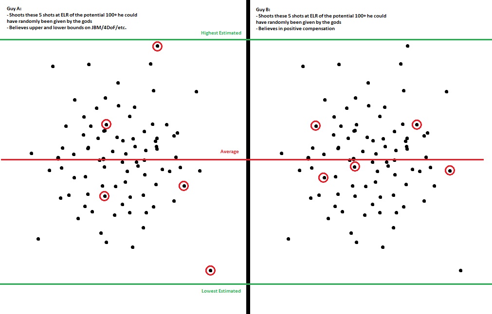

Also, there’s literally dozens of documented cases where vertical spreads at POI are less than the ES in muzzle velocity would have you believe mathematically.
That is commonly referred to as positive compensation which if used properly actual vertical dispersion is well inside of the calculated dispersion which assumes the same lunch angle on most ballistic programs.
