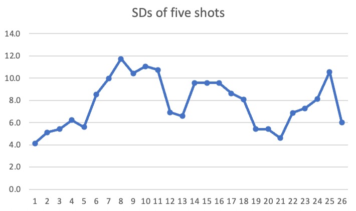

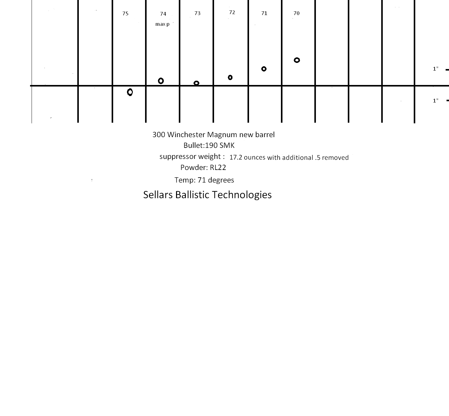

    Here is a graph set up for a military demo gun . The numbers at the top are powder charges of a 1 grain diifference . This makes the ultra long shots possible even with velocity variance especially cold bore shots.
    Tim in Tx
    Tim in Tx

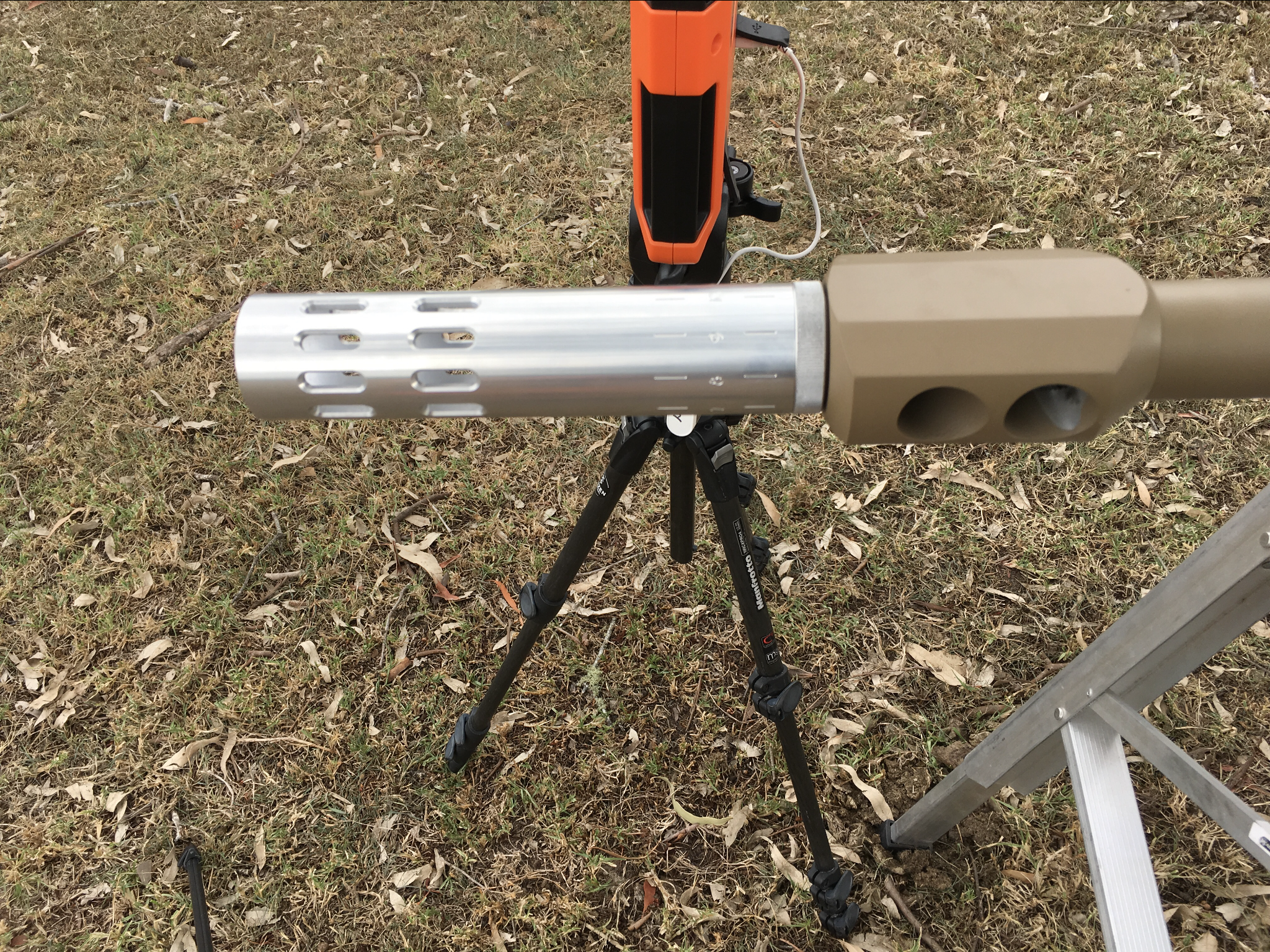

    Tracking velocity and POI are very useful, as is using the device in the pic below.
    Nothing new but very effective, consistency is everything. 9BFB317C-6725-47FF-94C4-7201070DB313.png

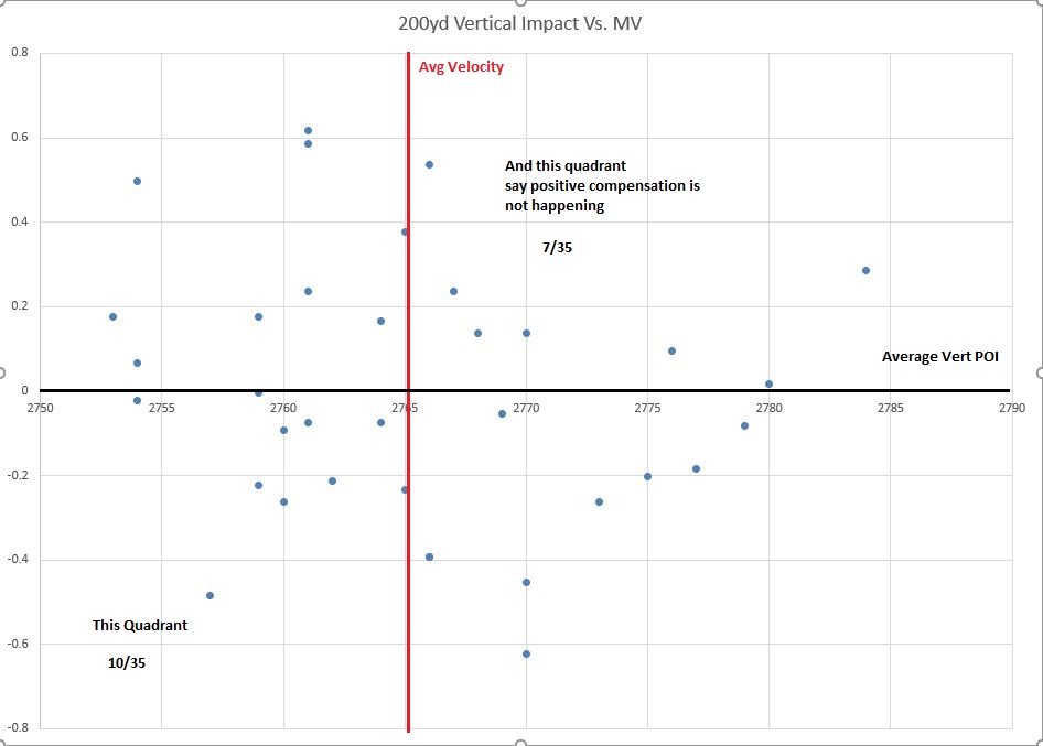

    Here's 35 shots of 1 powder charge. I have a ladder test that spans a couple grains with this particular test with 35 shots per powder charge. None of them are skewed to suggest serious, reliable trends that positive compensation is happening.
