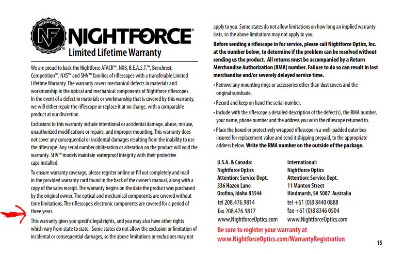

thank you for the great review and perspective. Curious though where did you see the NX8 only offers a 3 year warranty on electronics? I cant find a manual but the nx8 1-8 only discusses lifetime warranty, which is what I thought NF standard was. I just started looking into this optic, so may have missed it, thanks again!
I grabbed warranty information from Cal's article here - https://precisionrifleblog.com/2014/08/07/tactical-scopes-where-theyre-made-and-warranty/
I would recommend calling Nightforce directly and asking as manufacturer's sometimes change the terms of their warranties
Reactions: TangoSierra916
Here's a screenshot of a manual from NF's site. I'm sure you could call them to discuss, also:
That's the second manufacturer that has reduced the coverage of their warranty this year. Granted, Nikon was far worse than this. But not covering "accidental damage" is pretty big. That's pretty much large portion of damage occurance. And it's a hell of a lot of peace of mind to guys who use these pretty hard.
So its surprising in a market where scope manufacturers are stepping up to no questions asked coverage that a company would backpedal from that.
The NF warranty has been this way for years. I have an NXS owner's manual from 2010 that says the same thing.
