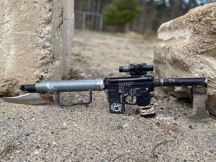

That’s ok guys, thanks for all the great advice! Definitely looking forward to setting up the Nightforce rings on my new build! Here’s a pic. Not to brag but I built a lot of it myself 💪
I ain't even mad... If it blows up, that's a Darwin award. If not, color me impressed lol
