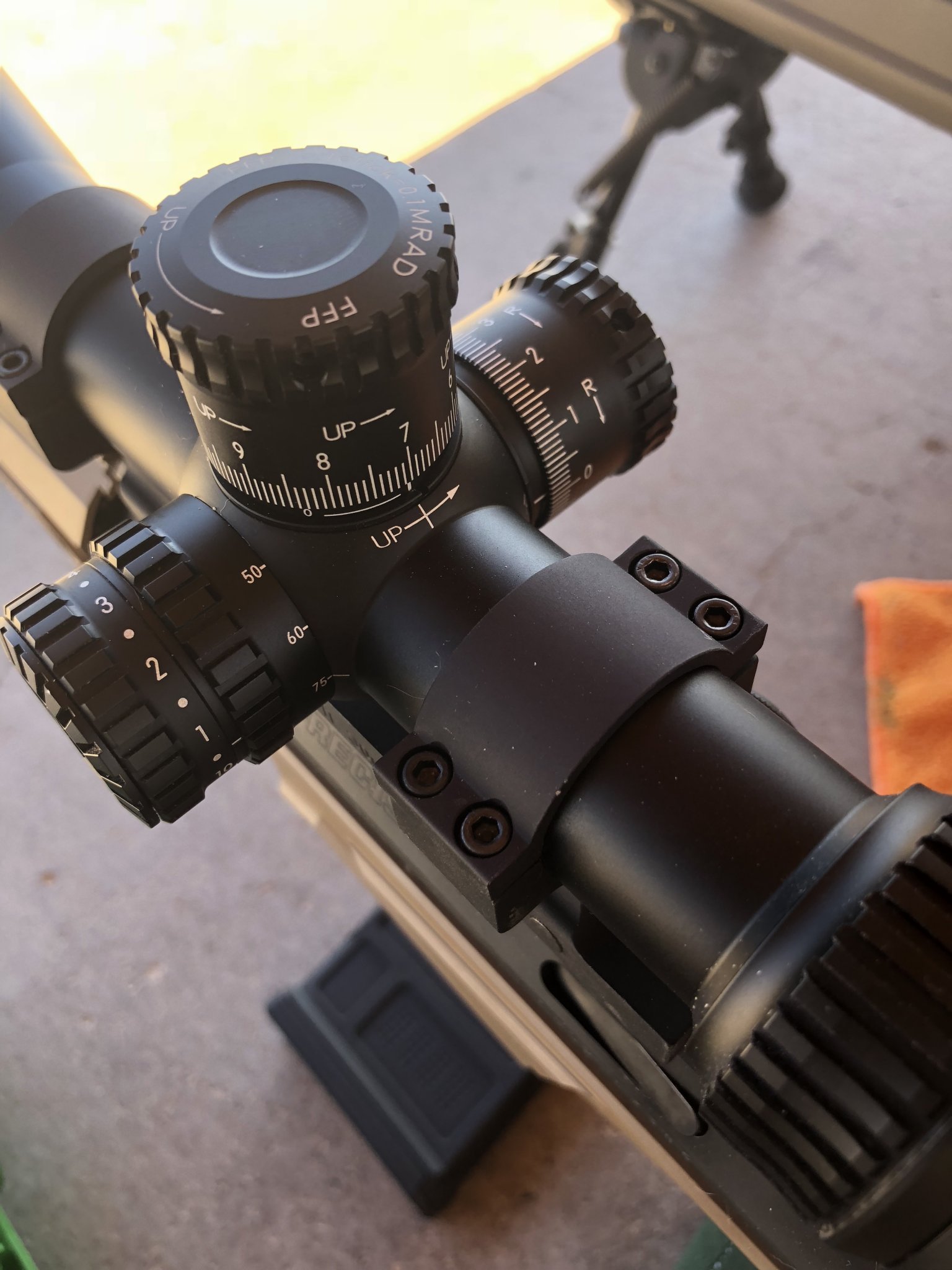

I got my 6-24 mrad last Tuesday. Mounted it in tps short rings on a 0 moa egw rail on my .308. I have 11.6 mils of vertical left after zero. The glass looks fantastic to me, the clicks are extremely positive and tactile and the reticle is very usable and user friendly. The zero stop is simple to set and WILL NOT let you adjust past it. I didn’t really mess around with the illumination very much. Overall I am very happy about this purchase. Time will be the true test as to how durable it will be. I plan on using it for local prs club matches and feel that it is up to the task.

The glass is great, I am blown away by the image quality for the price. Clear to the edges on all magnifications. Good clear, crisp image. Easily on par with, if not surpassing the PST gen II. This is my first Nikon scope and, again, I am thoroughly impressed with what I got for the price.
