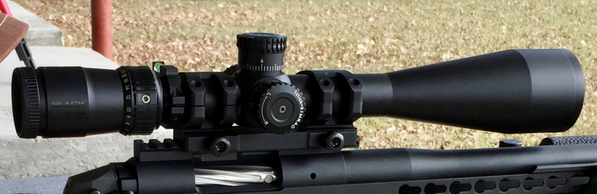

Quick update on latest status of my 4-16x50 FX-1000 scope ... Looks like the third time is the charm. If you remember, I initially purchased my scope back in late April and received it in earlier half of May. Got busy and did not look at it again for a couple of weeks but prior to mounting it I exercised the turrets and discovered there were quite a few ghost clicks (extra felt clicks) when turning the turrets. For example, I would hear and feel 12 distinct clicks on turret but scope only dialed up 1.0 Mil instead of 1.2 Mil. Overall, the turrets felt sloppy and were not consistent when counting clicks and adjusting for elevation. The scope was determined to be faulty and was replaced by Nikon after about ten days in the repair shop.
The turrets on the replacement were crisp, with precise audible clicks and perfectly aligned hash marks throughout the full turn on the turrets in both elevation and windage. Unfortunately, just when I was starting to feel really good about it I took the scope covers off and looked through it for the first time and immediately saw a large chunk of debris on the periphery of the FOV at the lower powers. Optically this scope was good, just like the first one, and even though I tried to dislodge the debris, I was unable to clear it out of the FOV. I took some pictures and again returned it to Nikon. Good thing I included the letter with the pictures because I was told the debris was not there when they received it. UPS must have treated the package not so gently. Regardless, Nikon opted to replace this one as well but I was informed that they were presently out of stock and would have to wait a couple of weeks for product to come back in stock before getting another one. Of course, like all things optic, two weeks turned into three.
Throughout this entire ordeal I had the assistance of Bman940 here on the Hide. Bart is a Nikon Pro Staff member and was instrumental in coordinating, tracking, and updating me on the current status of my repair. Because of his assistance and contacts I was authorized to receive an upgraded model as consolation for my troubles and patience. No doubt Nikon encountered some significant QC issues with regards to my scopes but in the end they behaved honorably and bent backwards to make me happy.
About a week ago I received my third scope, and I am, pleased to confirm that both elevation and windage turrets had an excellent feel, clicks were crisp and audible, hash marks aligned perfectly, illumination was excellent (thanks Nikon), parallax knob tension was good, and optical quality was great throughout the entire zoom range. This one was ready to be mounted, zeroed, and have a tall target/box test done on it to confirm turret precision and return to zero capabilities. I ran all of these tests this past weekend and was impressed with the overall performance. I shot the test at 100 meters and over 10 Mils of elevation travel and +/- 3 Mil of windage, the scope showed a difference of less than 0.5 cm (less than 0.5%) overall error. Some shots were just over a cm away from their predicted/expected positions, but this difference is easily attributed to shooter's margin of error and in my mind I have fully validated this specific specimens precision, tracking accuracy, and ability to return to zero.
In summary, the long wait was exasperating and disappointing but at its conclusion has resulted in the delivery of a quality product by a company that firmly stood behind its reputation and satisfied a demanding customer. I would not hesitate in recommending this scope... hopefully the growing pains of getting this product to market will soon be behind them.
Thanks again Bart!
