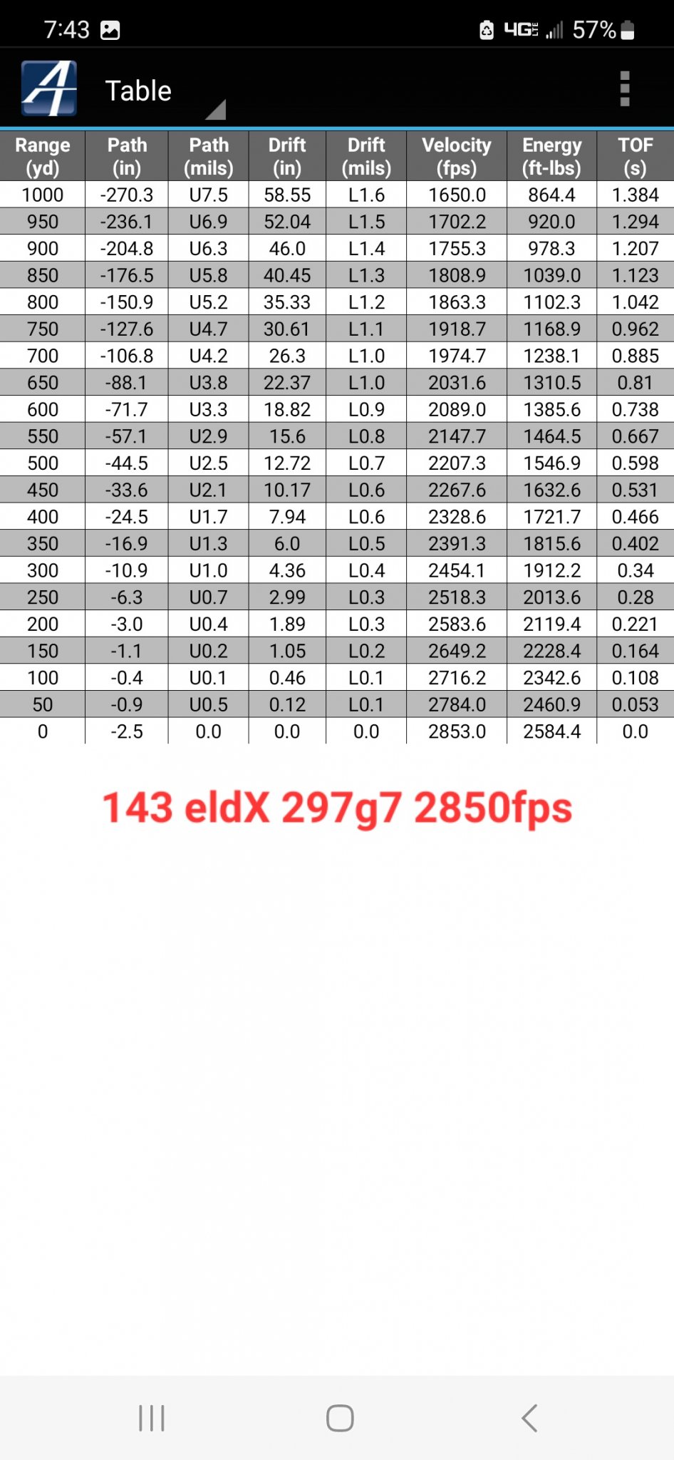

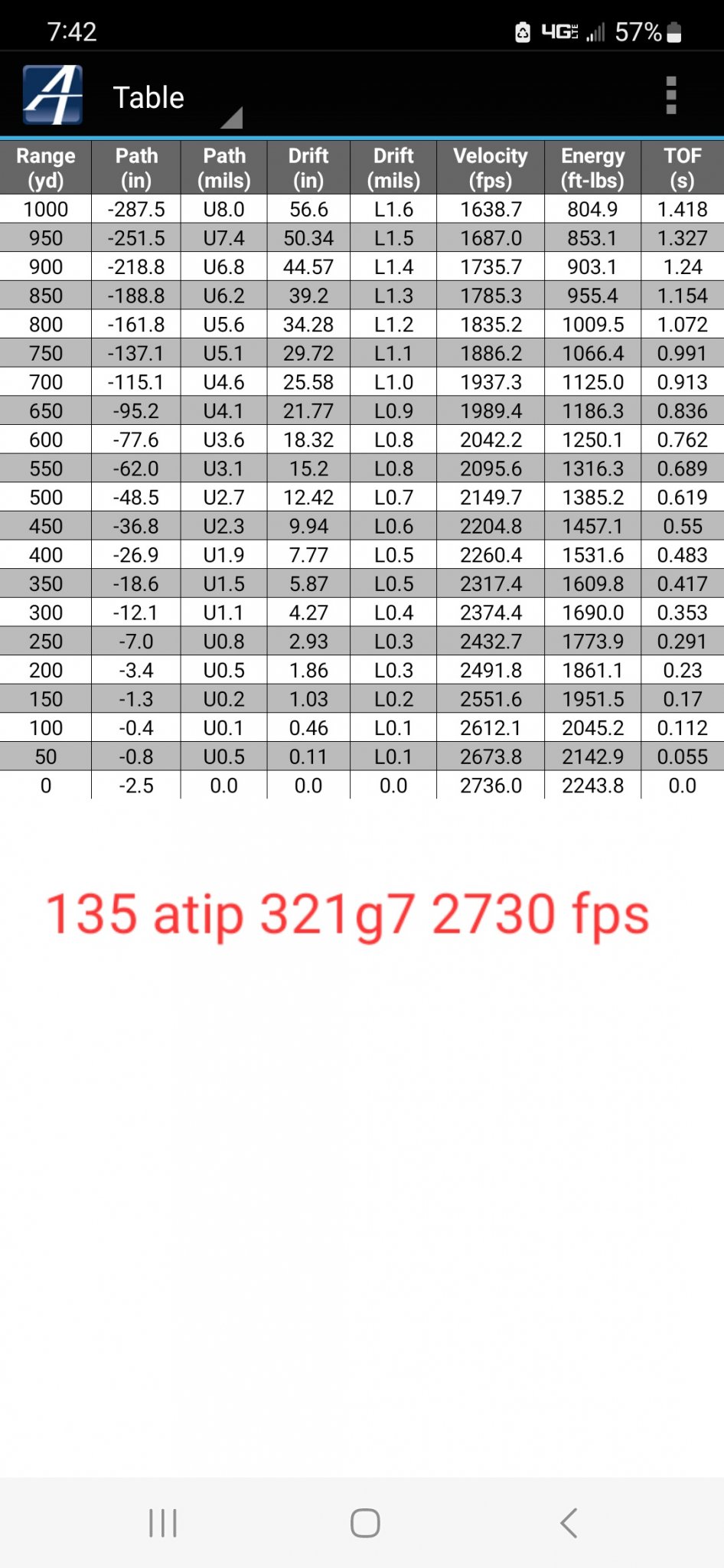

The 130 grain has an advantage of 2 Mils in Elevation and 0.6 Mils advantage in a 10 mph crosswind at 1,000 yards
Only gets more pronounced as distance gets further
295 VS 321g7 pretty much dissolves that 120fps advantage of the lighter bullet at distance. Maybe less drop with the 130, but wind will be the same, and may even advantage to the heavier slower bullet. I'm just comparing the 2730 VS 2850 advertised box velocity.
Edit, just because I don't trust Norma box BC, I ran some bullets with known bc similar to these two 130 VS 143. I ended using a 135 atip with 321g7 and 143eldx with a 297g7. Winds the same, and the faster bullet is 0.5mil less drop at a G, 120fps difference.

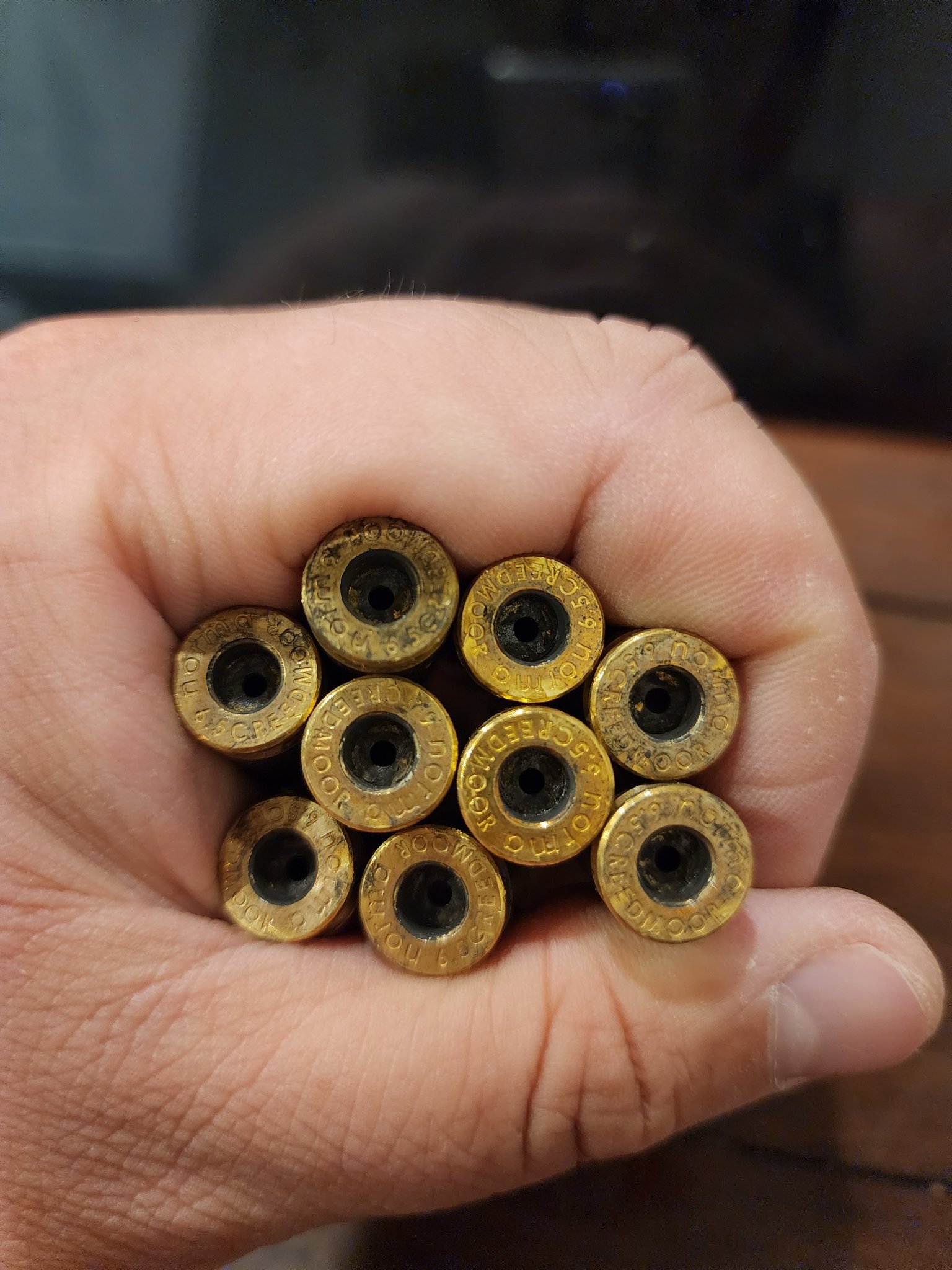

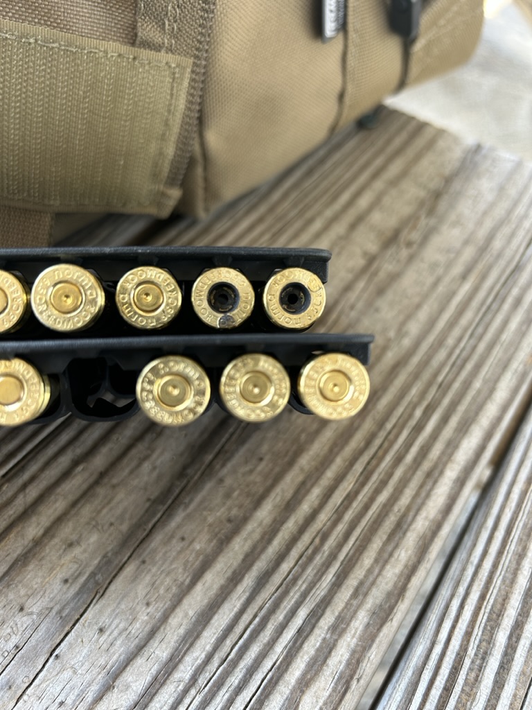

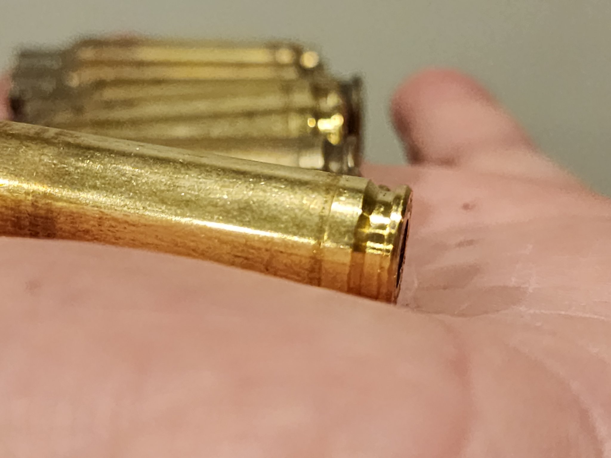

Ive shot three or 400 rounds of this ammo. It shoots great in my Bergara HMR pro. But, yesterday I had some blown primers. First time this has ever happened to me. I noticed my bolt was very hard to open and close. Anyway, I attached a picture of the ammo. I'm going to contact Norma and see what they say. I have read on here that another individual had the same issue..
That was me. Norma ammo was incompatible with my Desert Tech. It shot VERY well, but it was a very hot load in that chamber. Norma sent me a shipping label to return the rest of the ammo and refunded me my order.
Yeah, In the last six months I've shot about 300 or so rounds with no issues. But for some reason, I've had a couple boxes in the past couple days do this. One box there were a lot of rounds doing it. And today, there were two rounds that did this. But the rest looked normal. All the Hornady and Winchester stuff I shot today was fine. Weird.
Had the same thing happen at a match a few weeks ago. Have shot about 1400 rounds so far, almost all at PRS matches.

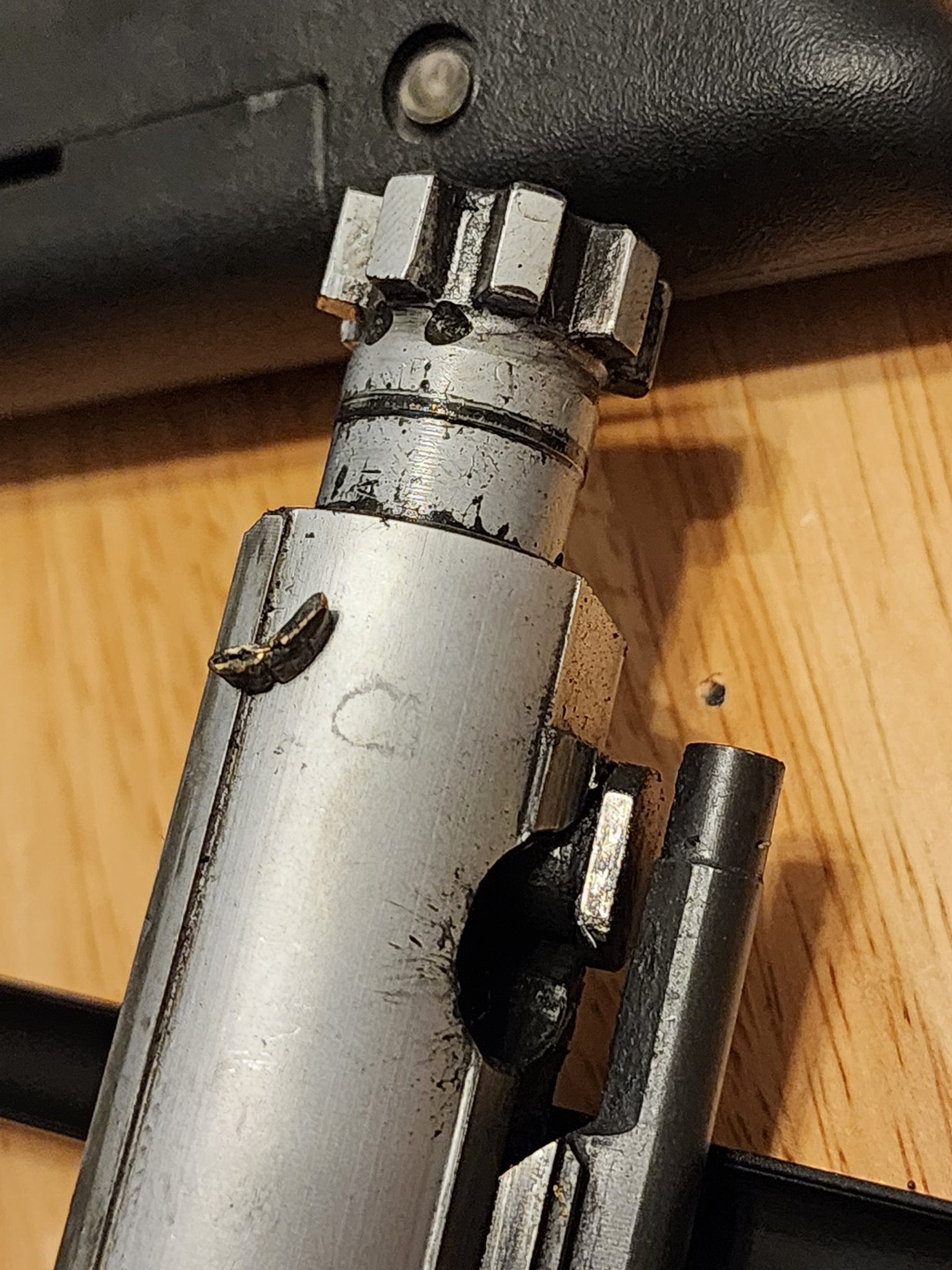

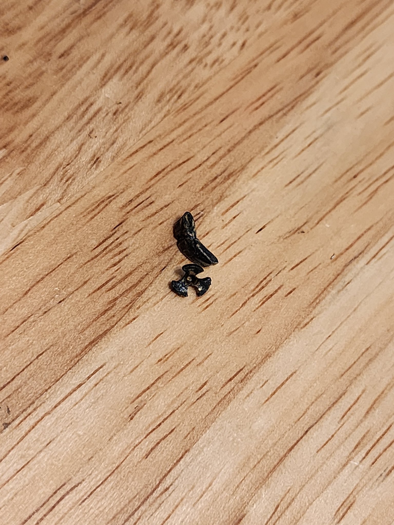

Did a 2 day prs class and I blew about 10 primers out of 150 rounds fired in a lmt 6.5 20" mrggs. Recovered 9 pieces of blown brass. Significant bulge right above the rim.
The last blown primer took the gun out of action. Mortaring it cause the entire bcg to lock back. Had to remove the buffer extension and pound the bcg forward because the primer was lodged between the upeer and bcg.
I've emailed Norma twice about it with no response.
Swapped to hornady 140 eld since and have had zero issues. Shame because this ammo was consistently half moa and yielded ad's less than 10
Would avoid.
