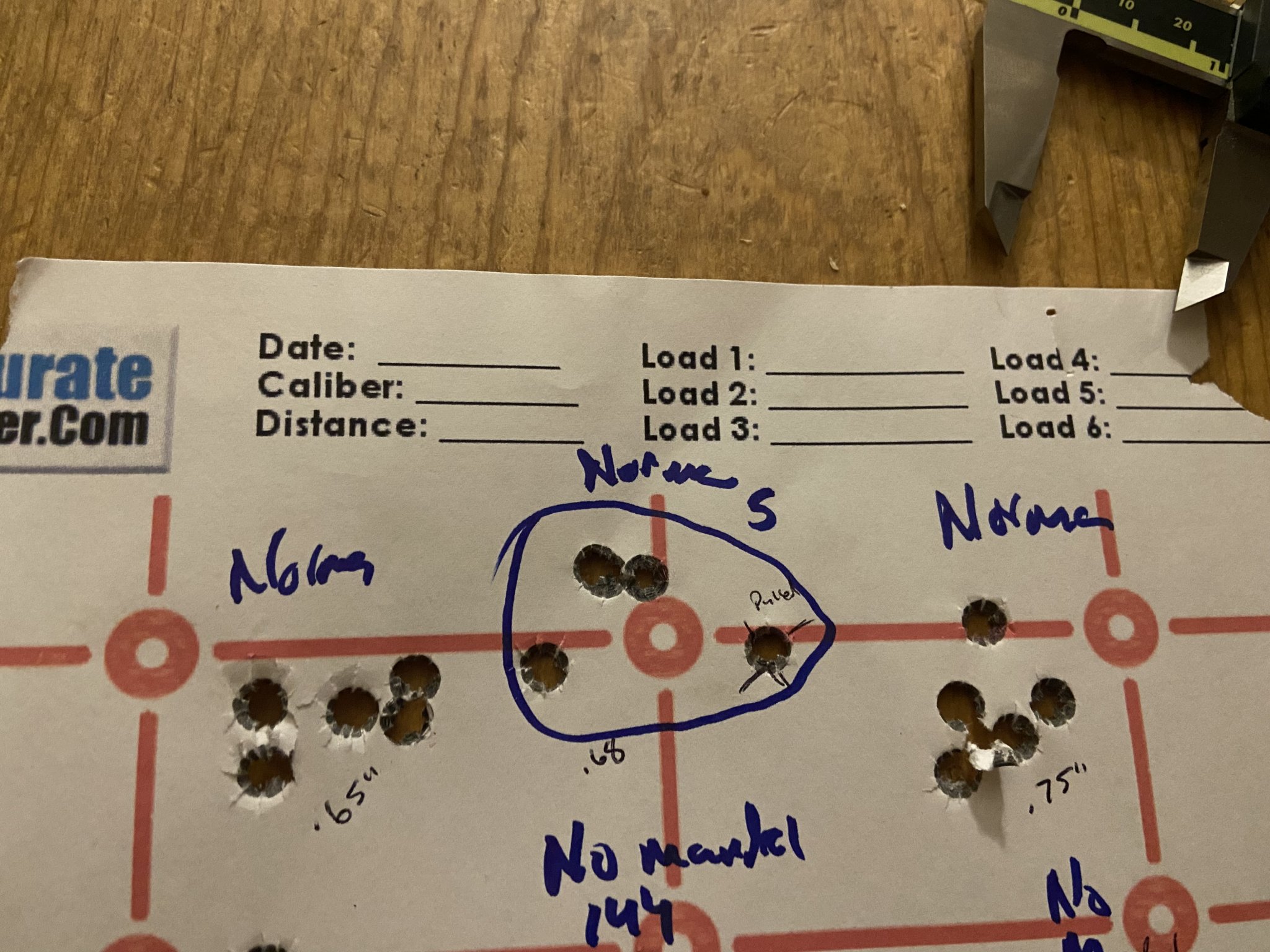

I’ve finished my first case of this stuff, so far it’s pretty good for the price. Real average seems to be about .7 moa, plenty good for practice and local matches, probably even an NRL Hunter match. It will group 3-4 on top of each other and then throw one or two. (Other groups not pictured).
Have only tested to 550 yards for distance, need to run it to 1k.
10 shot strings over chrono aren’t great, ES of 50 fps, SD 16 or so.

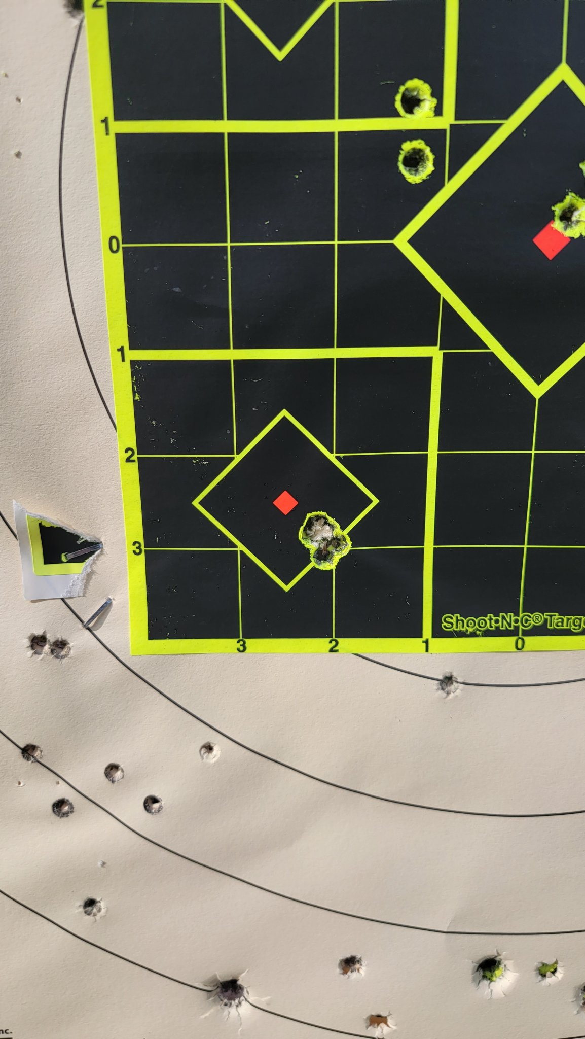

This stuff continues to impress the shit out of me. I had 7 rounds left in the box, so I loaded them up and shot this little group. I am actually finding this stuff to be more consistent than Hornady ELD-M as of late. It also doesn’t seem to wind sensitive as ELDM’s. Agreed with above, hopefully this stuff stays affordable as my AXSA loves it.

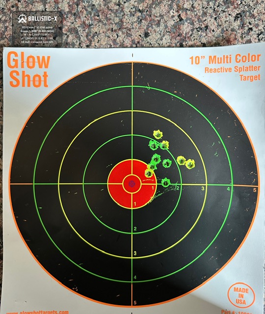

So I just shot my 3rd match with this stuff and am super impressed. Has settled at 2715 out of a 26" HH. SD is about 12 and ES around 35. Settled on .315 G7 and matches up out to 1100. Not one bad primer or issue in about 650 rds fired so far. This stuff is a sleeper round and totaly capable of winning PRS matches with ( if I was good enough of a shooter).

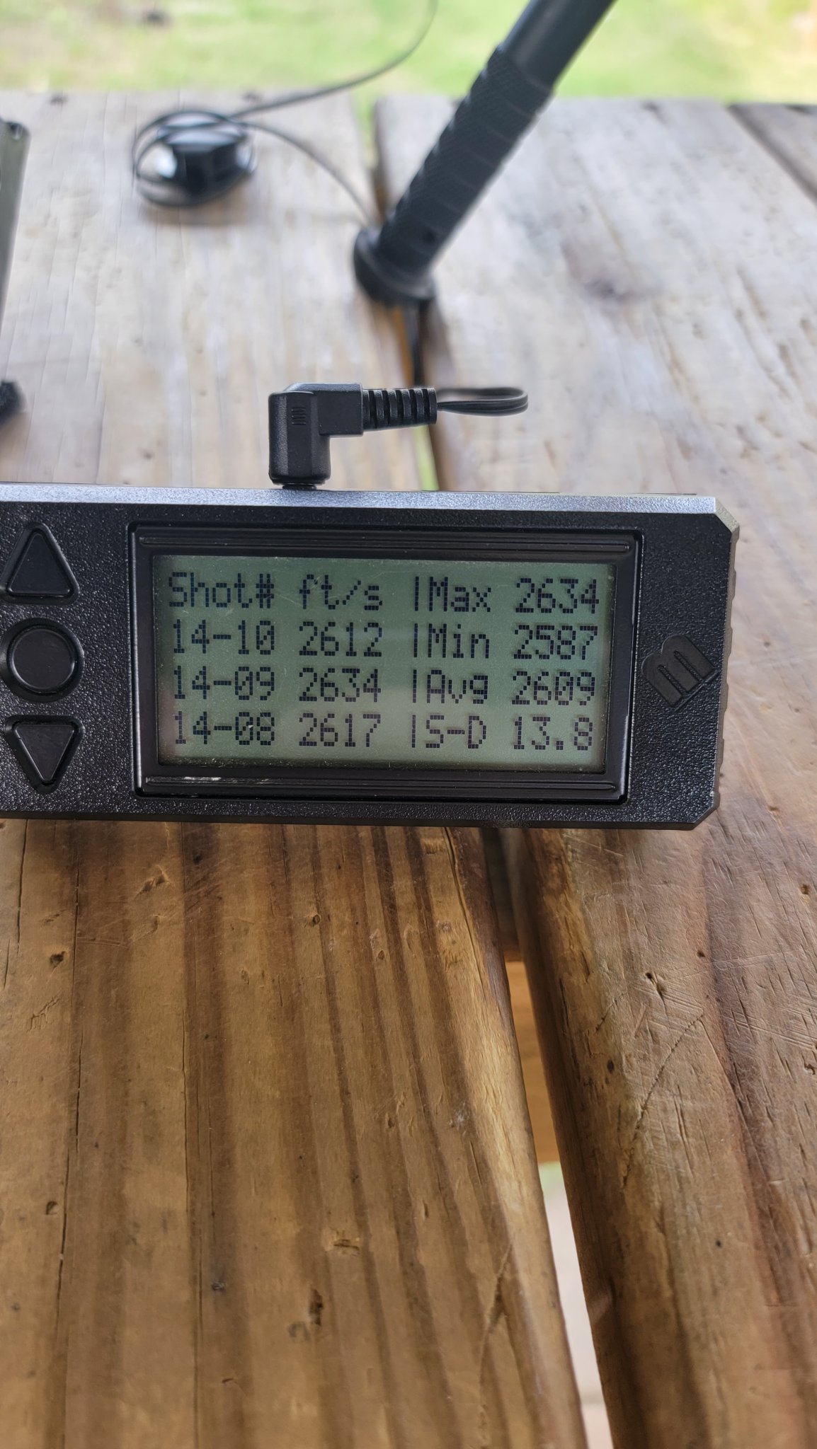

I have shot multiple 10 shot strings with this ammo, SD of 11 and ES around 35-40. Average velocity of 2645 out of 24" barrel. However, last long range outing I either wrote down my dope incorrectly or either the BC or Hornady 4DoF was way off.

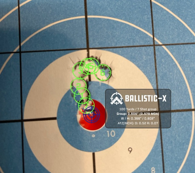

I’ll give it a shot for certain. This is from yesterday’s fun. 10 shot 0.61 MOA group at 300 yards using the FGMM 130s.
This is typical from that ammo
