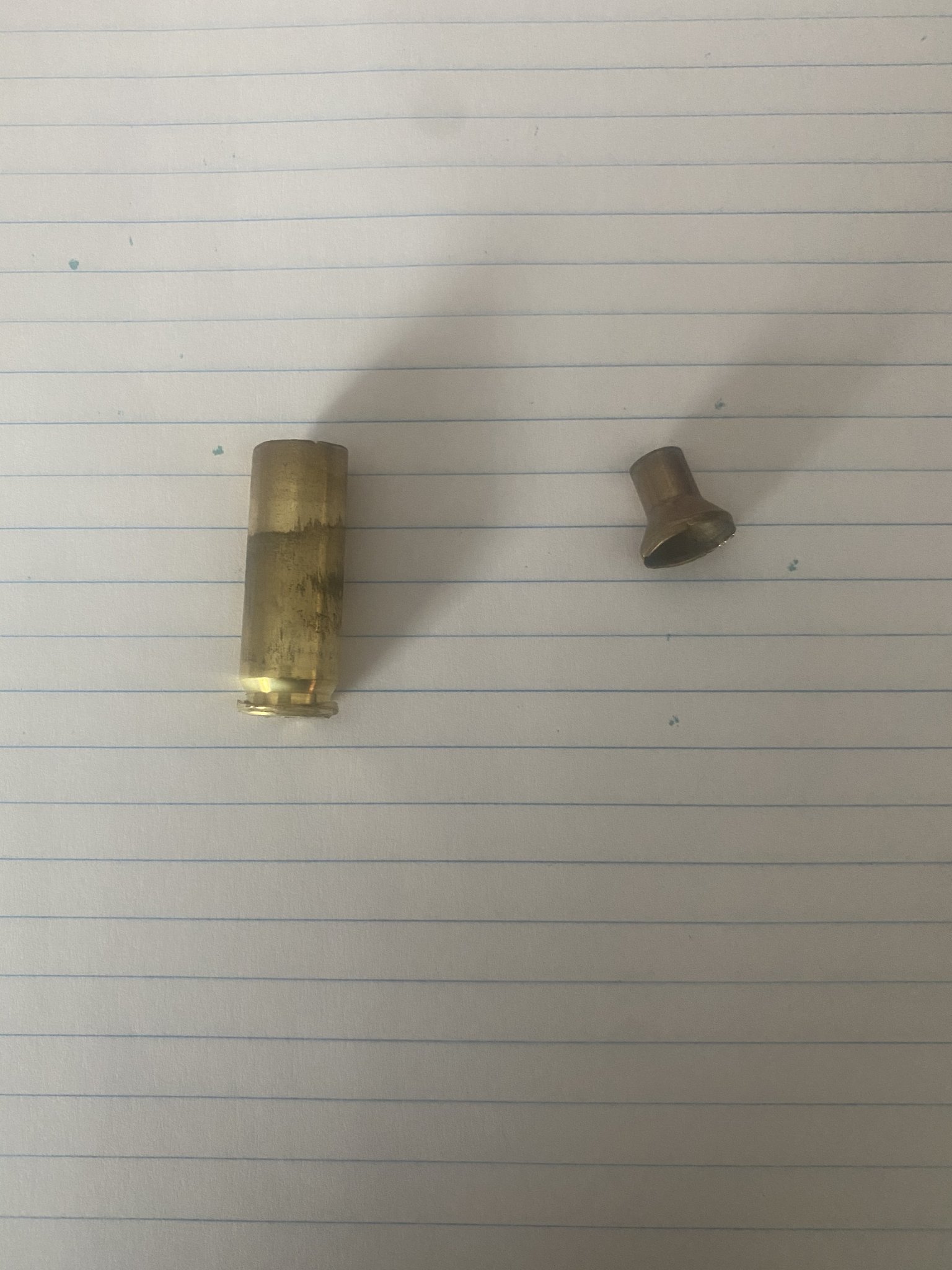

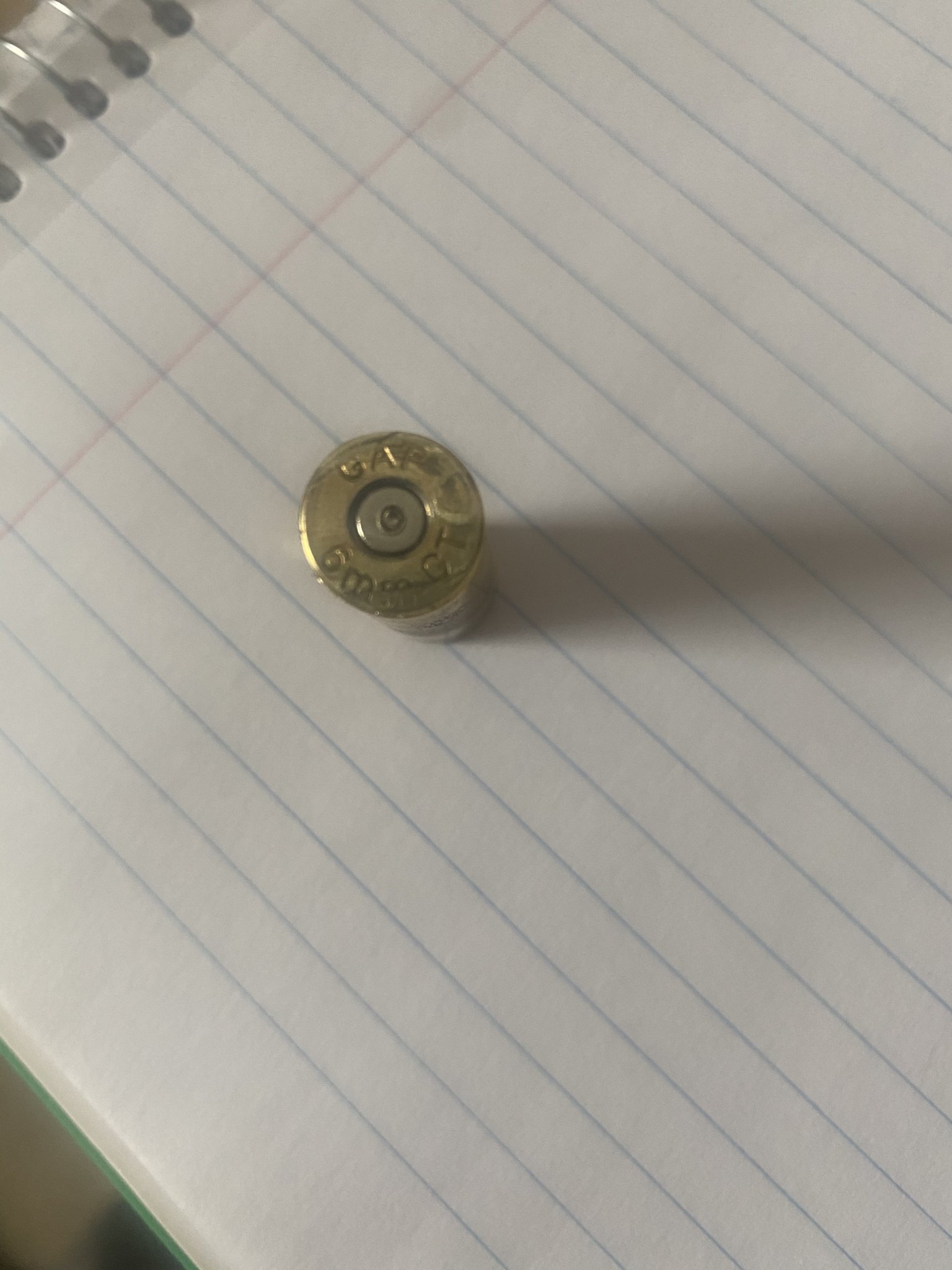

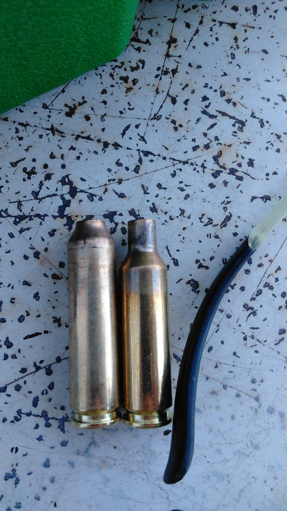

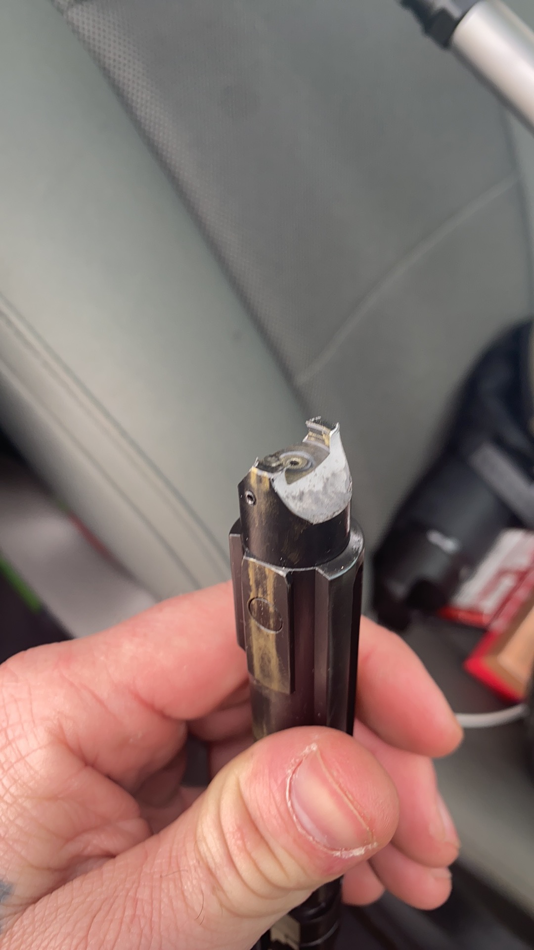

Hey all. As the title states, I had a catastrophic failure on my bolt gun that was not from a reload. However, I am a reloader and need some consensus on the root cause. Is this from an over loaded “factory” round, bad metallurgy, or a combo of both? Pics listed below.
Specs
26” criterion
Action-I won’t name yet to save them any infamy
Chassis- MDT LSS-XL gen 2
I have sent a message to the ammo manufacturer in hopes that they do the right thing and recoup me for my loss. My action has a replaceable bolt head and I’m really pressed for time and cash before an upcoming comp.
I believe the issue to be an extremely over charged round. Tell me what you think...

Majority of time this is caused by excessive headspace. A smith can check relatively easy for you. This will also give you some credibility with the ammo company if the issue is not headspace.
Overload would blow the primer out. Looks a lot like what i would suspect would happen were you to shoot a 6GT in 6mm Creedmore chamber or something like that. I.E too much headspace. I don't see any reason to think the ammo was at fault.
Reactions: lloydx2 and Slides
The primer doesn't look overpressure, but excessive headspace would have caused a case head separation and gas venting but it wouldn't have sheared the lugs off the bolt head would it? The sheared lugs look like way excessive overpressure doesn't it?
Normally dangerously overpressure rounds will blow the case head which you don't have, however your case head does look like it had ejector swipe and indentation in the case head, so perhaps it was overpressure.
Was this a brand new action? If it was I might speculate that you had a bad bolt head that failed at normal pressures.
So it could caused by overpressure ammo, excessive headspace, or a bad bolt head, which could involve the ammo manufacturer, the gunsmith who built and chambered the rifle, or the action manufacturer.
I think I just raised more questions instead of providing answers, but as I was thinking things through while typing, I realized your situation is not simple to diagnose.

There are some 'pressure signs,' but I would expect to see those if the case took a running start at the bolt head. But too excessive, and I'd expect that you would have had some light strikes in the past unless the firing pin protrusion was on the longer side...
Are you sure it's the ammo? Have you fired other ammo in this barrel?
If it's a new gun, I'd involve the manufacturer too. If it's a new barrel, the gunsmith is getting the same email. Then they can fight over who's getting the pieces sent to them.
Also, might want to police up those pictures if you really didn't want to name and shame....

Those are classic "false pressure signs" that are really signs of excess headspace.

First, what is deconstructed? Pulling the bullet?
I think your bolt head was weak. I have always been under the assumption bolts were heat treated to be harder than the action itself.
I have never seen a shoulder blown off a case. I have seen cases come apart on the first firing, always closer to the case head. Not saying it is not headspace, this is just weird. is the barrel still tight? If it is headspace, the bill is on you.
I would take a caliper to the fired brass from this batch of ammo and see if a story can be told. How much case growth in key spots.
I have managed to do what you mentioned, 6x47 in a 6 comp match chamber. I managed to get 2 off.

There is nothing to obstruct your bolt lugs from opening in there. I would guess they broke during the process of firing the round and not during the process of removing the round. The bolt lugs breaking could cause everything you see there.

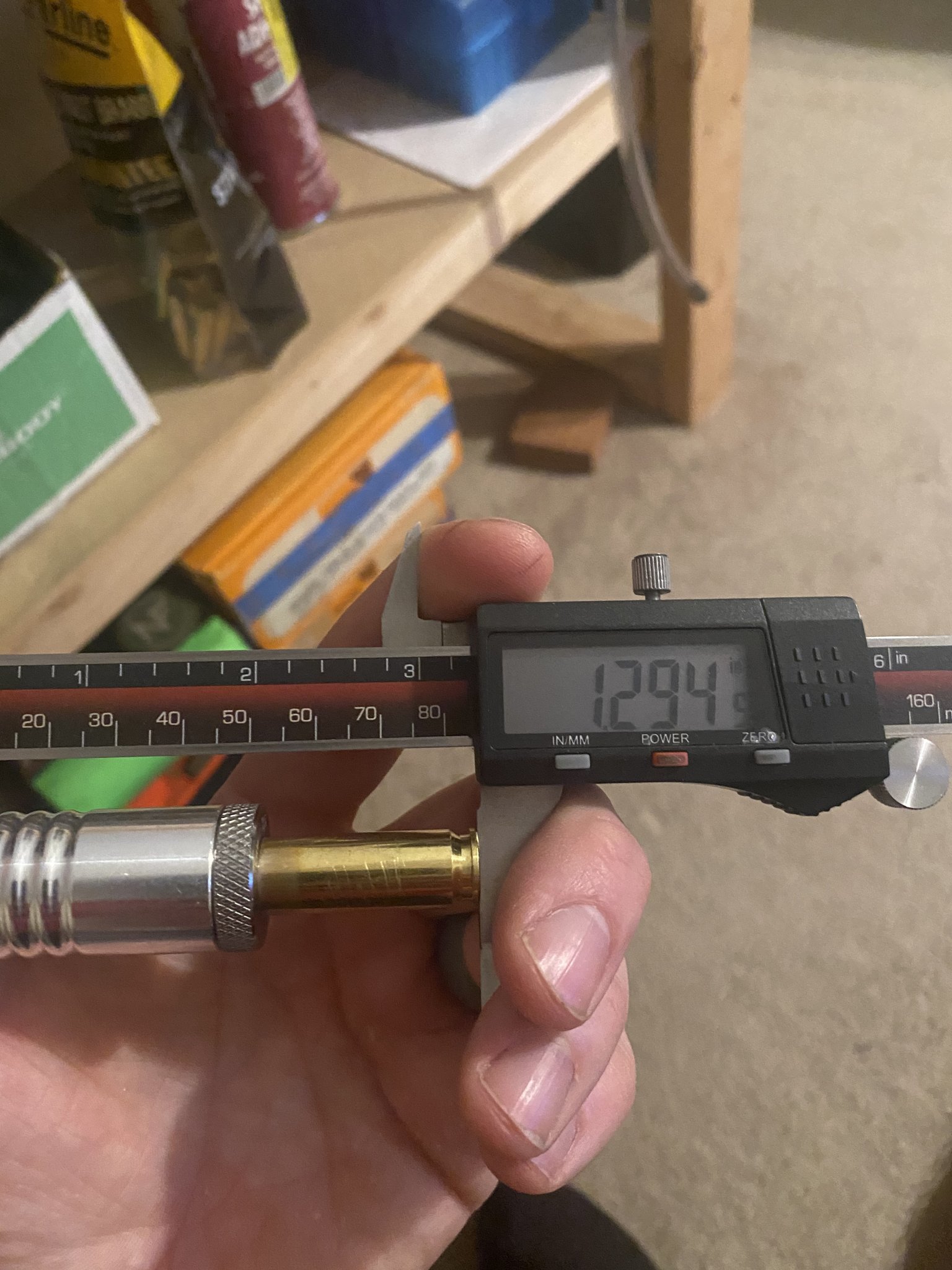

I’ll try and answer both simultaneously.
1 out of every 15-20 rounds showed light ejector swipe. That was with virgin brass loaded by the ammo company. Once fire formed, the brass was bumped 2 thou and I ran load development. This was not one of my reloads as stated above.

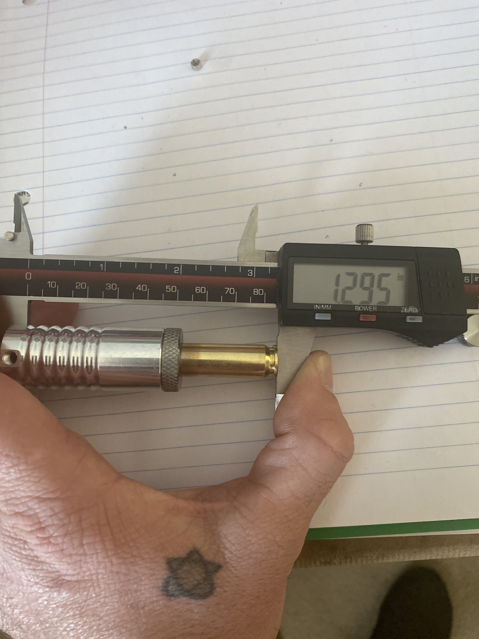

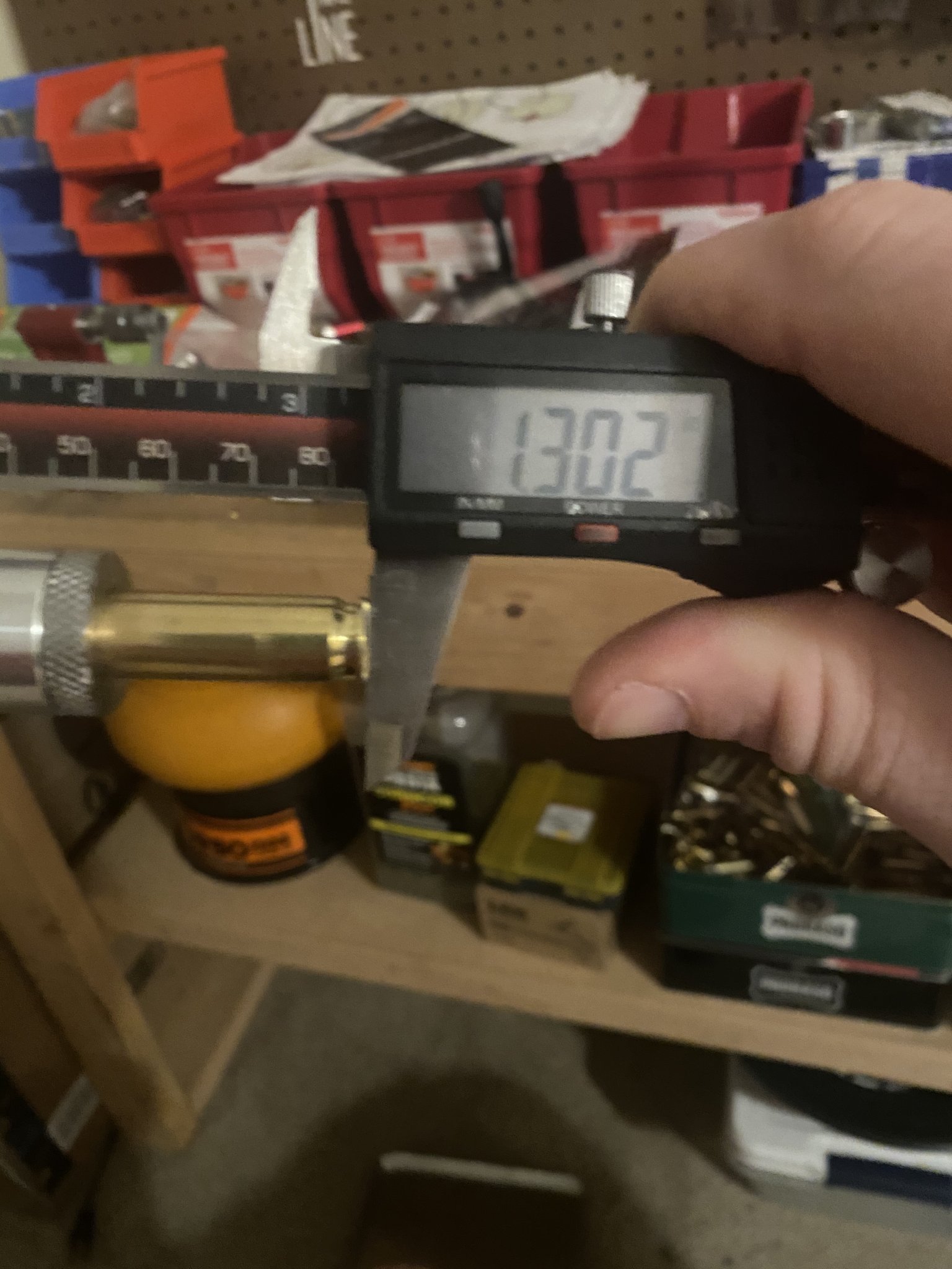

The pics below show the growth from virgin to fire formed. By my understanding (and again not being a smart ass) there was 8thou of growth from start to finish. The barrel was still set to 50 ft lbs when I disassembled it. When I set head space, it was over by two thou on the NG, but started to mar the barrel. That was with the cocking MEC out and ejector removed (manson’s do not need the ejector removed.
De constructed is just what you asked- pulled pulled and powder dumped.
I guess my overall question (as I’m great full for your guys’ expertise on this) is do you really think 2 thou too long is too much?

I’ll run a size comparison and post the sizes momentarily
Reactions: 338dude
If your pics are a new to fired, yes .008" growth is excessive, and I am no expert, but I say not enough to blow a shoulder off.
I can't wait till you get this nailed down, it will be interesting for sure.
Edit: Also, case growth with a different brand of brass may be less or more, so headspace here could be subjective.

My thought too, but I’m no expert. As I stated before, this was round 299 of 300 I was fire forming for reloading purposes. The bullet, powder, primer combo itself did not preform at all out of my barrel. I attached what I refuse to call groups (@100 yds) for pic 1. Pic 2 is from a lighter bullet that has been substantially better with absolutely no pressure signs.
Like I said (and I appreciate whoever stated that I should police up the first batch of photos, I’m not trying to burn anyone, but I did notify the ammo company of the inconsistencies I found in their ammo and that that they might need to be on the look out for more if this were a pressure issue.
Again, no expert here, that’s why I’m asking

Your bolt head came apart, more pressure and you could have been sucking on the bolt. That should not be normal. No matter what you do here, I would look into that, maybe a hardness test, or find someone who could tell you if it was fractured beforehand.

Typically SAAMI chamber datum tolerance is .010 Min to Max add the case tolerance to that so .008 growth
is not excessive.

Even with the ammo discrepancies, because of the low round count I think the bolt and action need to go back to the manufacturer. They should be able to check the bolt as well as your prefit job, as I'm assuming it's done with a barrel nut system - they should be able to check if the barrel walked out on you at all when they inspect it.
ETA: If you have a micrometer, it may be worth measuring case diameter of a few cases near the head, to check for overpressure via expansion.
You blew a case and sheared bolt lugs, but without getting hands on I doubt we're going to be able to tell which happened first.
This action company makes “tool-less interchangeable bolt heads. They make interchangeable heads. The bolt resembles a Schultz and Larsen pattern so changing isn’t the issue, but I was asking and putting possibly myself and the incident out there for the good of future shooters whether it’s my fault or not. If it is, I accept that fully.
I also don’t want this Wonkie shit to happen again when I get said new bolt head.

Primer and case head don't really look like typical bolt shearing pressure. The bolt shear looks like it was done in not many cycles (one?) and looks like pretty hard material but I'm with 308Pirate in that that's not the whole story. Lots of parts are hard on purpose. Doesn't look like a fatigue crack that propagated over time, though.
Maybe high pressure, maybe a headspace problem, maybe a bad bolt head... Can't really say anything for certain. Take pictures, don't modify anything, talk to the ammo company-- ask what pressures they run with what chamber and how they determine pressure, and send the action to the mfg., maybe arrange for a 3rd party lab to do hardness testing. These things usually go smoother when you talk it out with the mfg before you get lawyer happy but don't get bent over, either.

Couple more notes on the ammo companies load
Brass- virgin hornady
Bullet in the 115 gr class
Load from five disassembled rounds varied from 38.5gr (low end) to 39.1 gr.
All rounds were pulled from different boxes that I still have. I do not have a micrometer, but with the slight red tint on the Small rifle primer, I think it might be a fed or fed match 205m (correct me if I’m just making assumptions. I know that the anvil on the CCI SRPs and SRMPs do not have a red tint to them.
Pic 1- virgin brass
Pic 2- fired brass
Pic 3- No Go gauge
As stated previously, I was sitting at 2 thou over (beyond) the no go gauge but the bolt would not fall and it started marring the barrel when I tried to apply pressure.
I’m going to reach out to both companies like many of you suggested. I will post what they tell me as soon as I get it

Just for interests sake, can you take another well lit photo of the back side of the lugs (where they sheared off) and the same again of the bolt head.
From you photos it does look like there's a colour gradient across where the lugs have separated from the bolt head, but it could just be the lighting or surface discolouration from after the event.
