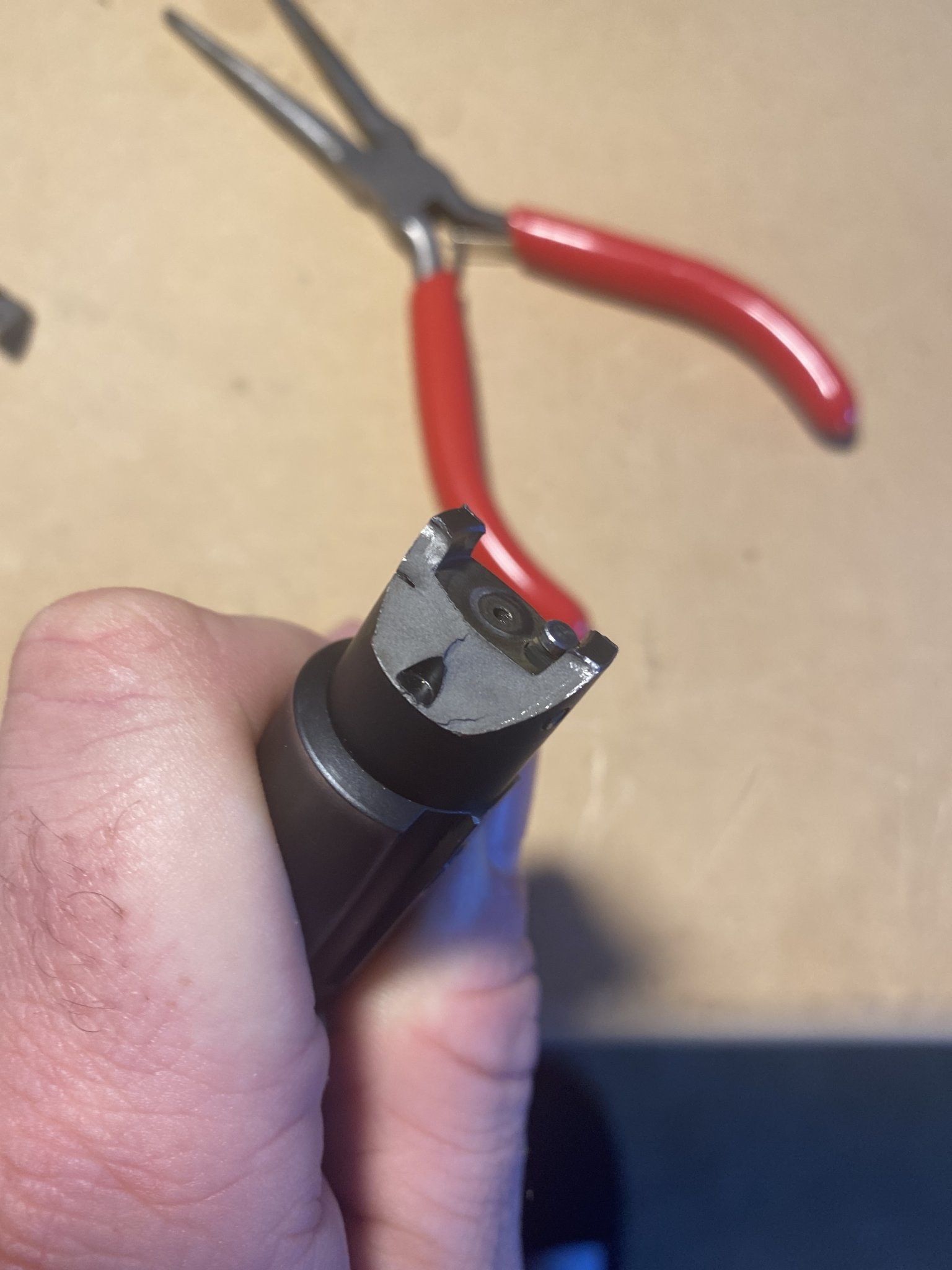

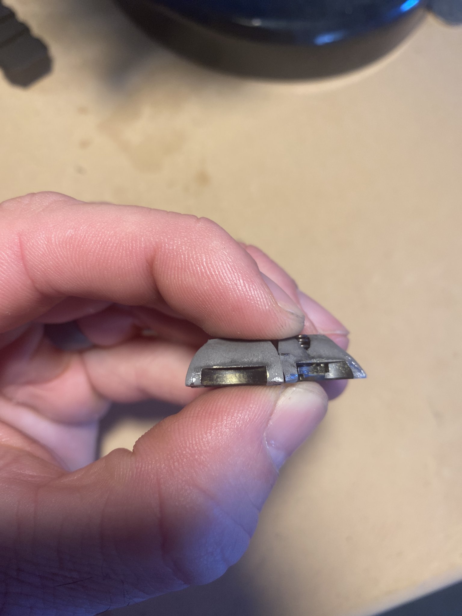

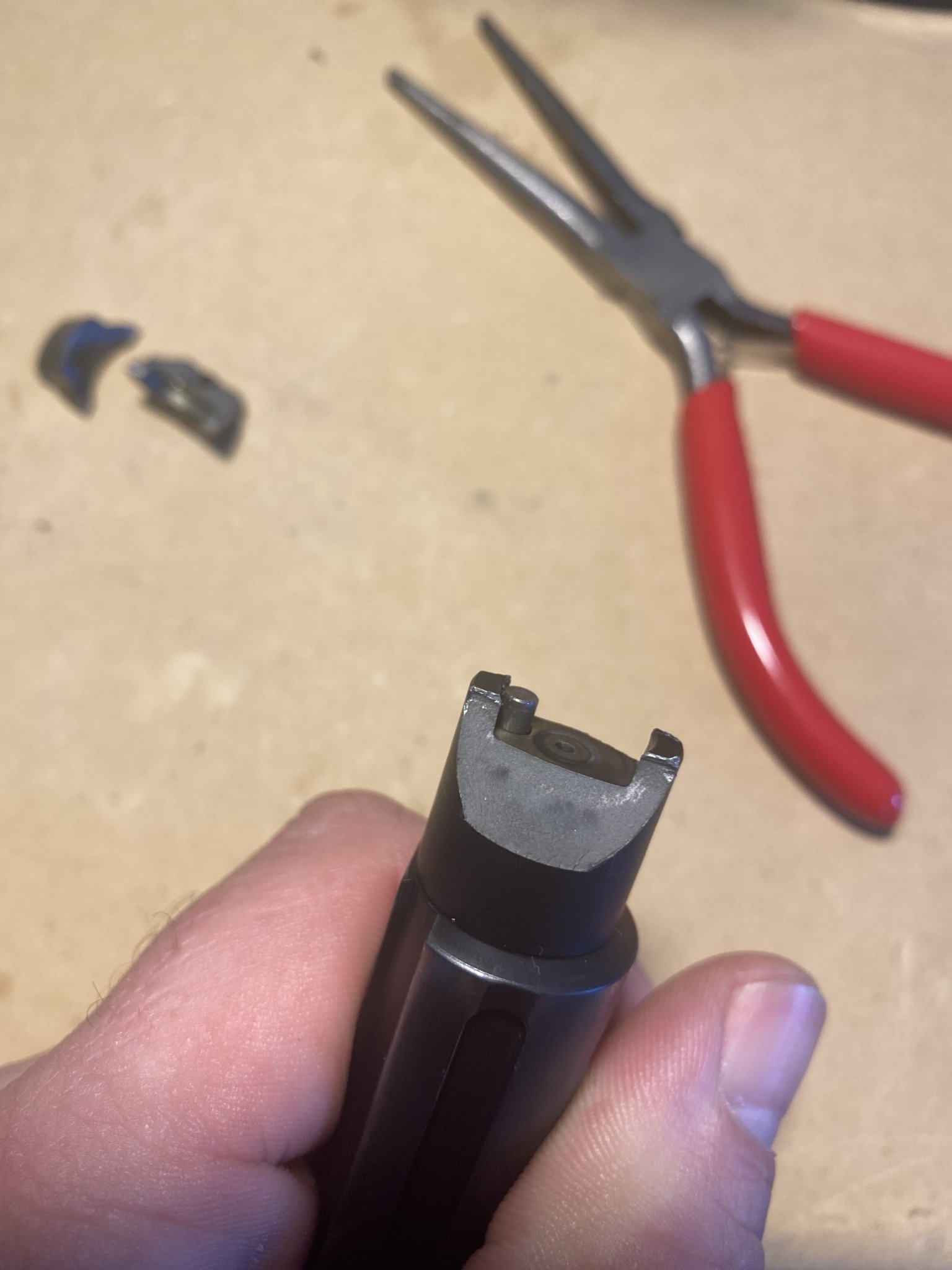

Here you go

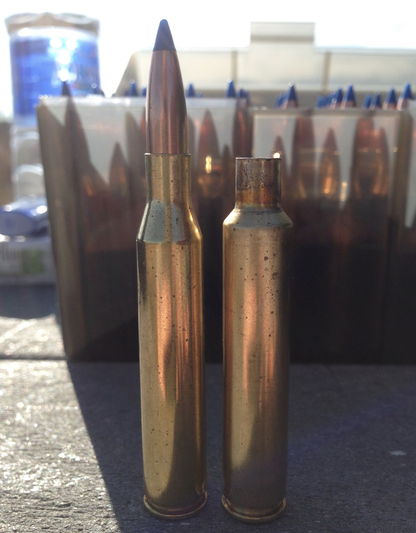

The rifle was at round 82 of 83 for the day.
Total round count: 500
After firing the last round, the bolt had what started to feel like a heavy bolt lift. But would not unlock. After a minute or two of working the bolt back and forth, the lugs sheered off and came free.
With regards to the ammo, the seating depth was all over the place. I observed around 40-thou of variance. This meant that some were jamming when fed. I pulled these out and deconstructed them. The rest were were shot to fire form the brass.
So I guess for educational purposes and not to stir the pot, if 298 out of 500 rounds (the rest have either not been shot of were deconstructed due to jamming into the lands) fired fine, then I’m not understanding how this is an excessive hs issue. I have also put 200 hand loads through this with no issue and minimal resizing. Again, not trying to Piss in anyone’s wheaties... just looking for knowledge.
The barrel is a prefit. I used Manson headspace gauges to set head space.
Re. your headspace question- the headspace that matters is the difference between your chamber and the ammo. The headspace measured by gauges is only a comparison to a standard; presumably the ammo was also made to that standard, but sometimes it’s not.
So if you reloaded some rounds with “minimal resizing”, I.e. no more than a few thousandths shoulder bump, then your headspace was good for those rounds, but that doesn’t say anything about that “factory” ammo. Keep in mind that the headspace might vary widely on that ammo; if the OAL varied as much as you say, maybe the size was inconsistent too. I’d want to check a bunch of those loaded rounds.

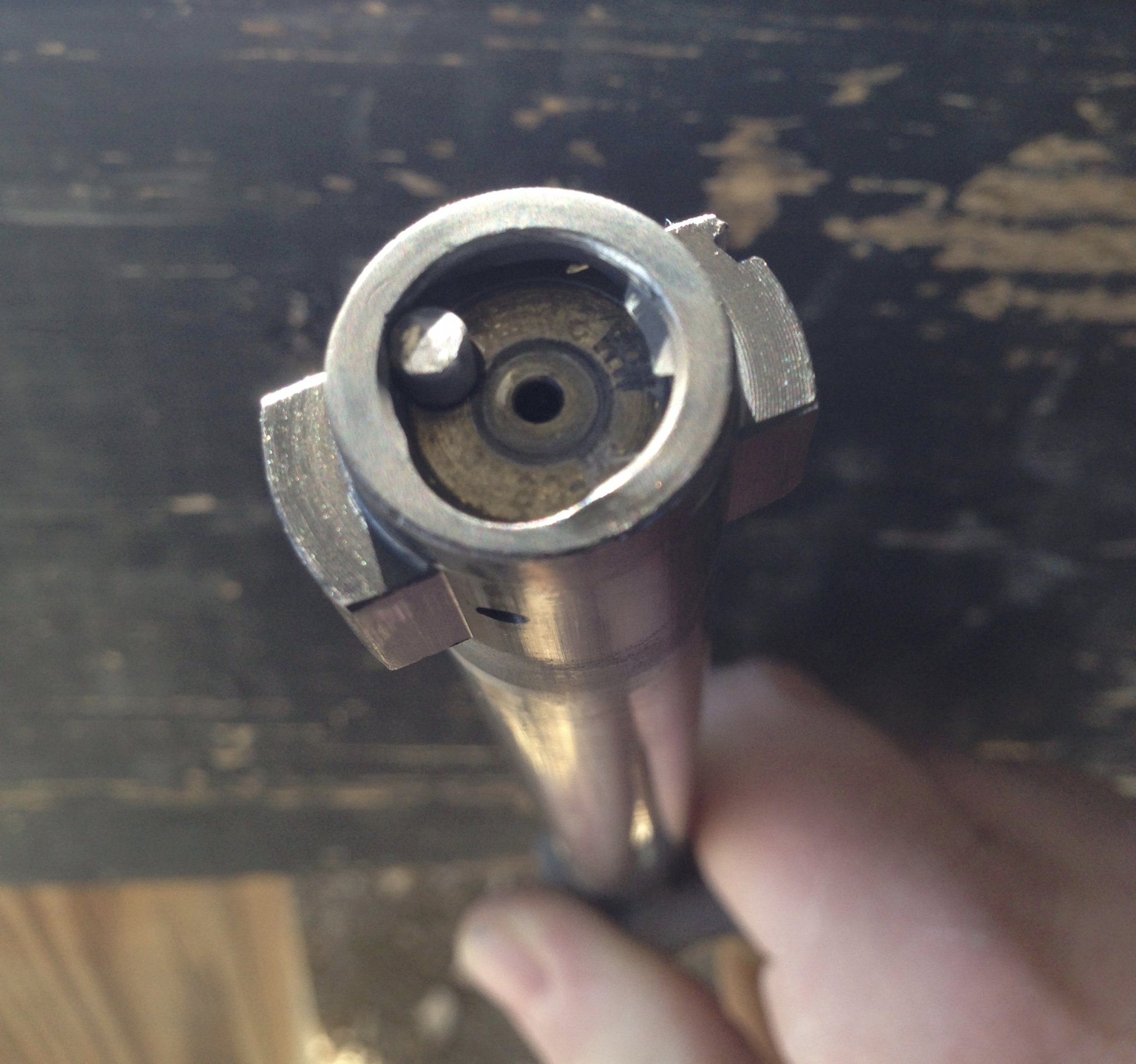

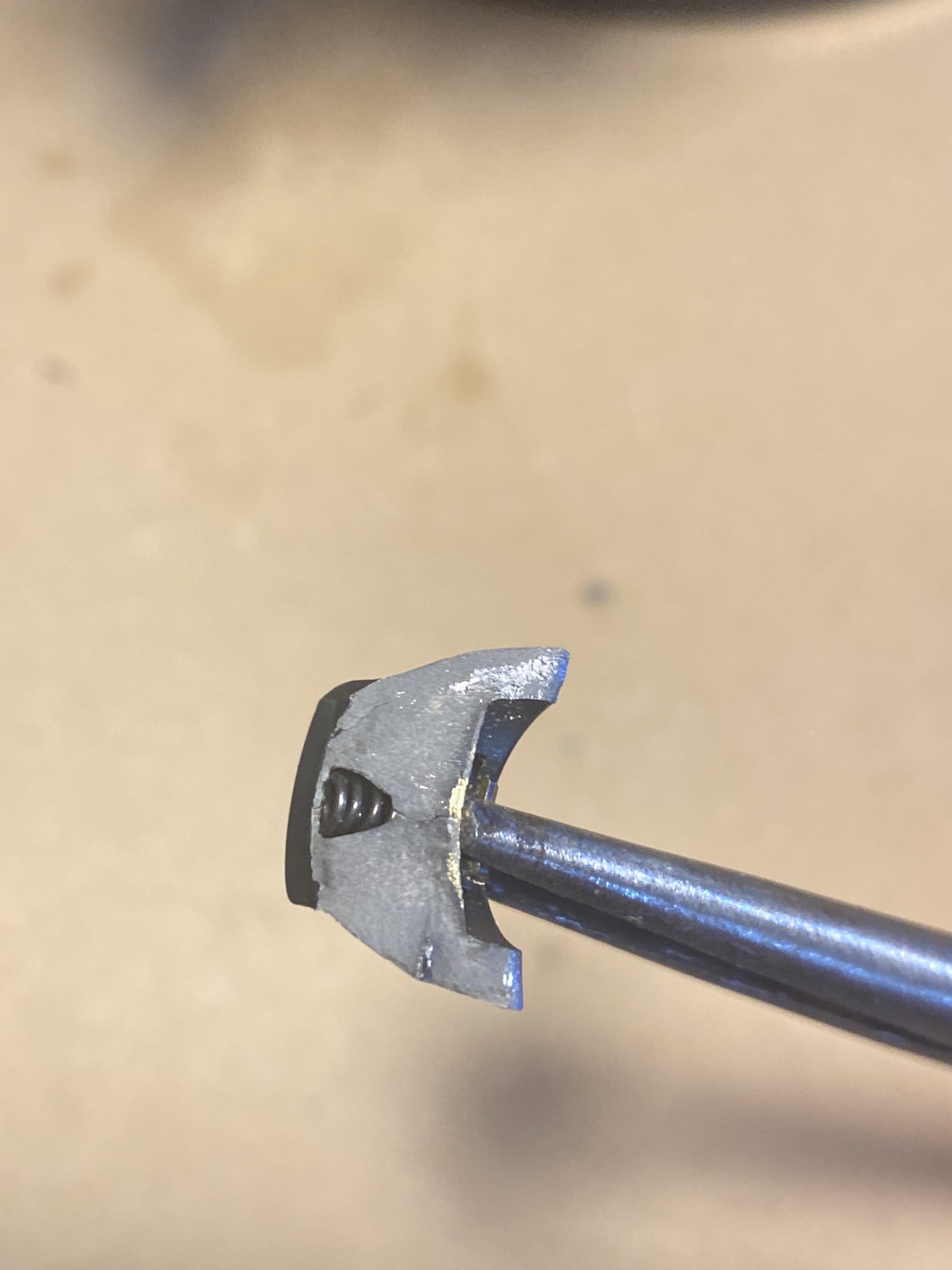

As to the bolt, it looks to me like a brittle fracture, but better pictures of the fracture surface would help a lot. It’s definitely not a shear failure from soft material. I’ve also spent the last 20 years diagnosing broken metal parts, and can comfortably say that nobody here can really tell you for sure without hands-on inspection and some testing.
Edit - you posted those last pics while I was typing. Good pics, thanks. There are no signs of beach marks that I can see, so not a fatigue failure (no surprise with such a low round count). Looks like a brittle fracture to me, but high impact loading can result in similar failures and it may be that the material strength was just lower than it should be.
I do see where it looks like the bolt lugs were still attached around the rim of the bolt face, which matches your description of having to wiggle them loose. This is speculation but I wonder if the bolt head wasn’t fully tempered properly (not long enough), leaving it too hard in the thicker areas.

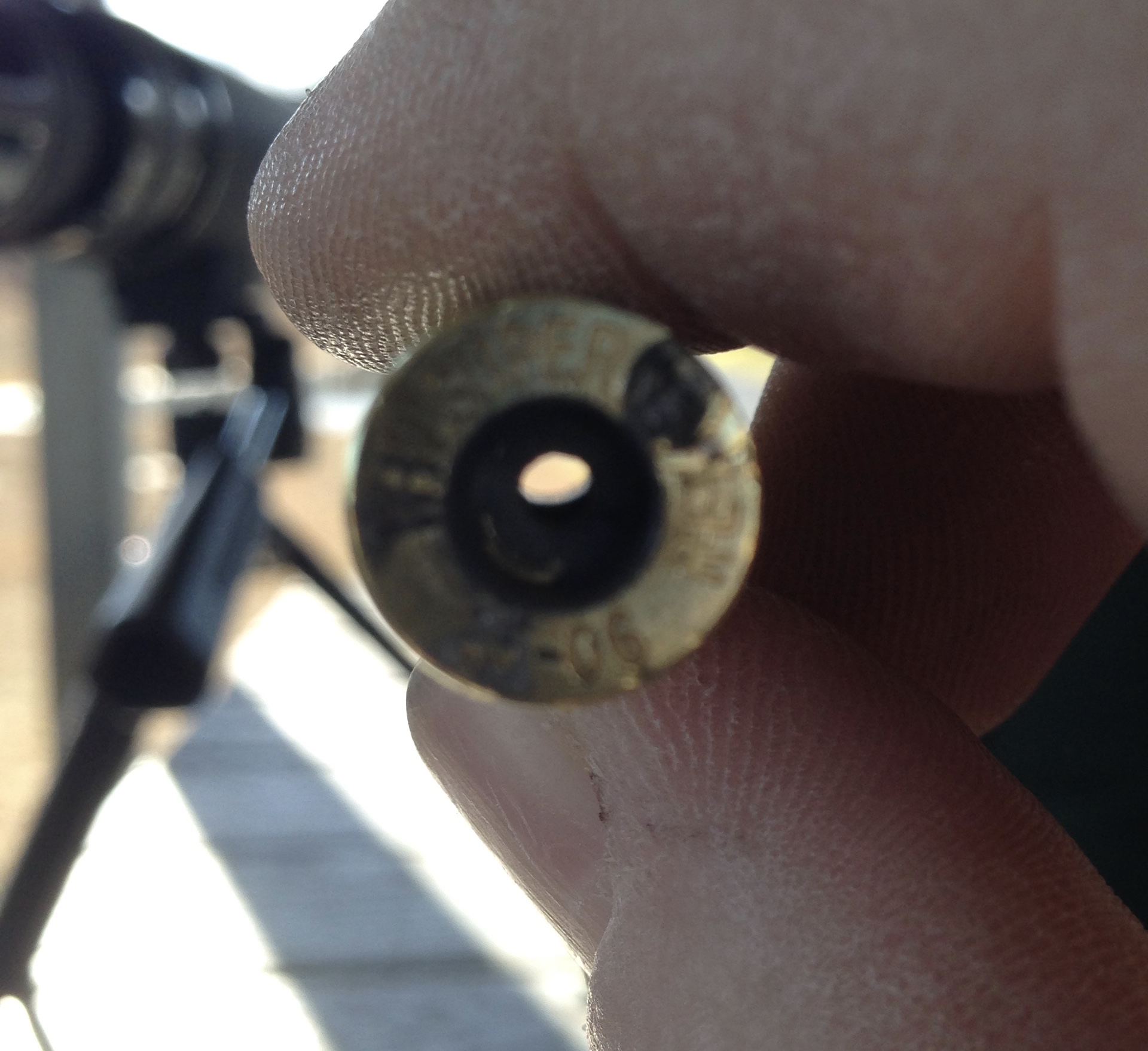

Primer and case head don't really look like typical bolt shearing pressure. The bolt shear looks like it was done in not many cycles (one?) and looks like pretty hard material but I'm with 308Pirate in that that's not the whole story. Lots of parts are hard on purpose. Doesn't look like a fatigue crack that propagated over time, though.
I agree with most of what you said, but shear is the wrong term. Shear is a wiping separation, like if the bolt lugs were wiped off leaving a mostly round bolt head intact. Shear failure generally implies a softer material, and leads to the wrong conclusion if used for something like this. The word “shear” gets way overused but it is not just a general term for failure. Fracture is more accurate for a failure like this.

I’m not arguing with either one of you, but the OP has fired cases that tell him what the chamber dimensions were. He can compare those to unfired cases to determine actual headspace, and to the gauge to compare headspace to spec. He’s already done some of that (although I suggest checking a bunch more of those loaded rounds). He doesn’t need a new bolt or even the intact original bolt to know as much as can be known at this point. What is unknown is headspace of that particular round.
His pics show that a fired case is only .002” longer than the go gauge, so it appears the barrel was headspaced correctly. The rest is up to the ammo, but some of the people here seem to be stuck on headspace relative to the gauge, which isn’t important here.

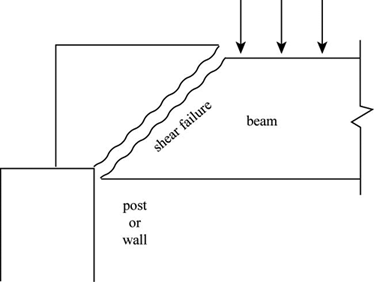

It's a compression shear failure. Mix of negative tensile and positive transverse shear stresses, no? Fracture propagation is the means by which brittle materials fail, but the reason why all materials fail is tension, compression, and/or shear.
Looking at the pieces of lugs it looks like the extractor side broke first (shiny rub marks), maybe held on for a few cycles, then shortly after the left lug said "fuck you, I'm out!". Wasn't down for the bolt thrust socialism.
OP, check your bolt handle to look for marks on the back side of it to see if it ended up being what saved your eye hole.

No, the failure was not shear. What your diagram shows isn’t shear either. Shear involves slip planes sliding against each other instead of pulling apart; shear failure is perpendicular to tension failure. Tension and shear happen at right angles to each other, and a clean break without the failure surfaces sliding against each other is generally not a shear failure.
This looks like a brittle fracture with the failure plane in tension, with a small ductile portion at the rim around the bolt face. (With the caveat of high impact failure I mentioned above.) The shiny surfaces appear to be from the OP working the bolt around to get it loose, not part of the original failure. There were both shear and tension forces involved in the loading of the bolt head, but it was not a shear failure.

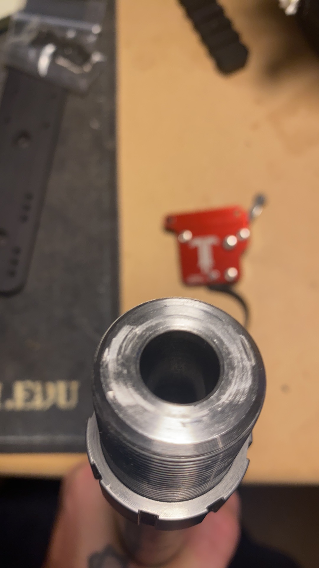

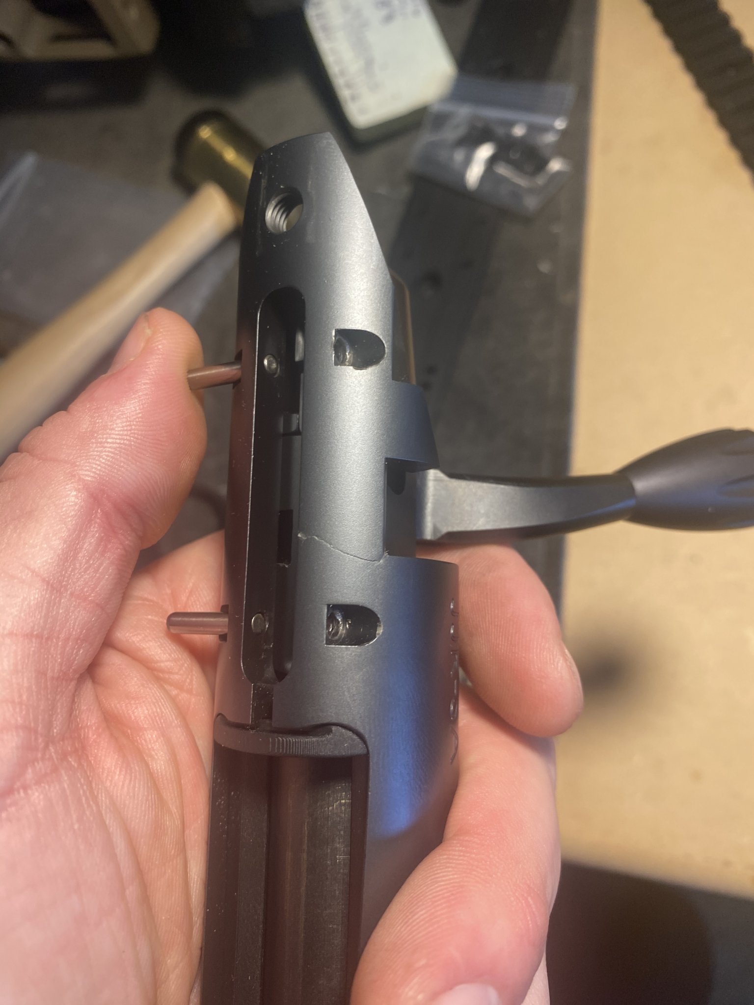

Yeah not on the bolt handle.... but there is a crack in the receiver
Ok that changes things a bit, since it’s pretty unlikely you ended up with a bad bolt and a bad receiver all in one package. That looks more like you’ve had some pretty high pressure loads running through it (for example when guys try to meet ball powder velocity with Varget), and collapsing the bolt lugs led to loading the receiver through the bolt handle.
Given that info, I’m wondering if those might be real pressure signs on that case in the first pic; as said above they can be caused by headspace but also can be caused by high pressure. I don’t put much faith in primer appearance but that may have steered a lot of this conversation in the wrong direction.

Excessive headspace signs probably happened when the lugs gave up and head space was set via a violent setback to the bolt handle.

Not seeing much of any of that here. Some primer blow-by, some cratering, and some scuffage on the head stamp where the broken sections of lugs used to be. The shoulder separating, the cratered primer, the blow-by, the case head scuffing, and the crack in the receiver are all explained by a sudden let-go of the bolt lugs, then a hard stop when the handle hit the receiver.

- The failure surfaces of the bolt lugs indicate they were still attached at the forward edge of the bolt rim after the failure, and the OP’s account matches the visible evidence there.
- If the bolt had actually set back while the case was under pressure, it wouldn’t have caused the ejector hole mark but it should have caused marks in the case head matching the fracture lines. I don’t see those in the picture.
Given all the evidence the OP has provided since the discussion started, I think the simplest answer is the most likely explanation- that the action suffered a steady diet of over-pressure loads which led to this failure. It’s possible metallurgical issues were involved as well in the bolt lug failure.

I probably should’ve included this pic from the onset, but I honestly was in shock. I believe the scrapes show continued contact from round 1. I believe the gouges came from the incident. Again, I’m not a metallurgist, physicist, engineer, or machinist. That could be another possibility.
I am an uneducated idiot myself, but i would say those marks occurred trying to free the bolt after the come apart. Separated parts created a gap between the bolt head and separated lugs. Now, working the bolt to free it scratched things up.

Speaking for myself only - I was suggesting that headspace may have been the reason for the “pressure signs” on the case in the picture (in response to people jumping straight to claiming high pressure), not saying that it broke the bolt. The thought being that we don’t know that high pressure was involved based on those signs because they could also mean excess headspace instead, and the bolt may have failed as a result of metallurgy issues instead. Sorry if I contributed to any confusion there.
However I’m second guessing that thought now, with the new evidence presented of the receiver also cracking.
To your point though- excess headspace does contribute to the impact forces of the case against the bolt face; evidence of this is shown by “false pressure signs” such as brass flow into ejector holes and extractor cuts in loads without high pressure. The impact force may or may not be significant relative to the strength of the bolt, but impact does create higher and sharper forces than normal cartridge ignition.
Note that this is just offered as a detail to consider though; I’m not claiming this is what damaged the OP’s rifle, as I don’t see any evidence to point directly to that cause.
sooooo ... "excess headspace does contribute to the impact forces of the case against the bolt face". I'm going to pose a scenario in order to ask a question. Suppose: the bolt is intact with proper headspace. OP inserts a round with insufficient headspace, say .020 too short. I chose that number because if it was more than 30 thou too short, would the firing pin energize the primer? If it was 10 thou short, the case head would not get much "running start". So 20 thou. Firing pin drops, case slides forward against the extractor, primer fires, pressure builds in the case (because they are closer, side walls first) then the case expands along the case axis shoving the case base to impact the bolt face and starting to push the bullet into the barrel.
You are saying that the mass of the case, accelerated by this pressure, delivered enough additional force - that is, more force than normal - to shear off the bolt lugs? Please explain how that works?
Hi,
First - we do not have Proof House requirements here in the USA.
Second - proof rounds are typically 125% of CIP standards.
For example 308Win the CIP proof round is 75,275 psi with Piezo pressure.
SAAMI says max pressure for 308Win is 62k.
Sincerely,
Theis
Okay, not 150%, 121 percent. However, that is avoiding the question. I was trying to understand the mechanics of how excess headspace causes bolt lugs to shear off. For the purpose of discussion, I assert that a cartridge that is too short (when measured from base to datum) will not generate pressure sufficient to cause this specific bolt head failure. I make this assertion so that smart guys like you can show me the error of my ways. I'm trying to learn something.
In the mid-1990s I made a little reloading mistake. I was loading 300 win mag with H1000 and 200 SMKs. I set my scale incorrectly and threw charges of 84 grains - 10 grains too hot. Because I was new to the game and didn't understand what was happening I fired three rounds - the rifle didn't blow up. After the third round I had to hammer the bolt open but the cases didn't fail and the bolt and receiver lugs were fine and they still are. Why is the situation above explained by excessive headspace? Is there some sort of shock factor? Is the kinetic energy of the moving case head that much greater? Does the initial movement then sudden stop cause powder detonation? How does it work?
Parliamentary point of order - you're mixing standards. A CIP proof cartridge is 125% of CIP standard pressure (which is 4150 bar, or 60,2k psi).
Also, in the event of a case head separation due to excessive headspace, not only is there the force of the (now broken) case to consider, but there is also the hot combustion gases that are allowed to flow around the separated case walls and back to the bolt face during the acceleration of the bullet.
No. Please go back and read the last line of my post that you quoted. I'm not interested in debating anything with someone putting words in my mouth. I offered an explanation of what headspace does; please read the entire thing before trying to argue about it.
A great reason to always strive for 100% case fill when selecting powder. Consistent and safe. The people who taught me reloading left out all of the important parts and taught me a bunch of junk that I had to forget.
Reactions: Yondering
Think of someone punching you in the back of your head, vs pushing the back of your head and which one do you think would hurt more.
Whether or not that's what happened, or whether or not it would be enough to bust off the lugs I don't know, but that's the gist of what you are asking be explained to you.
Edited to add: .007 headspace shouldn't even smoke brass like that, let alone an entire action.
