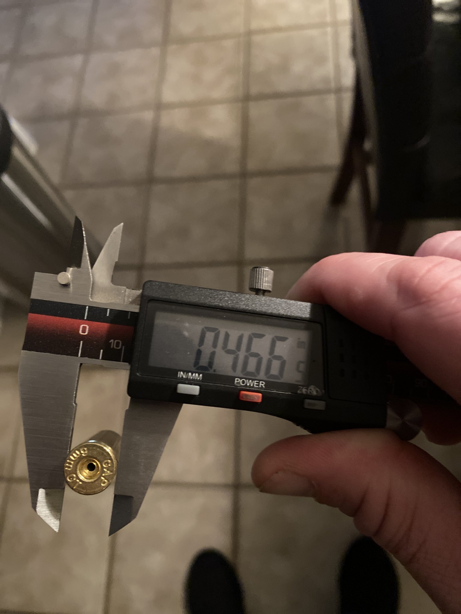

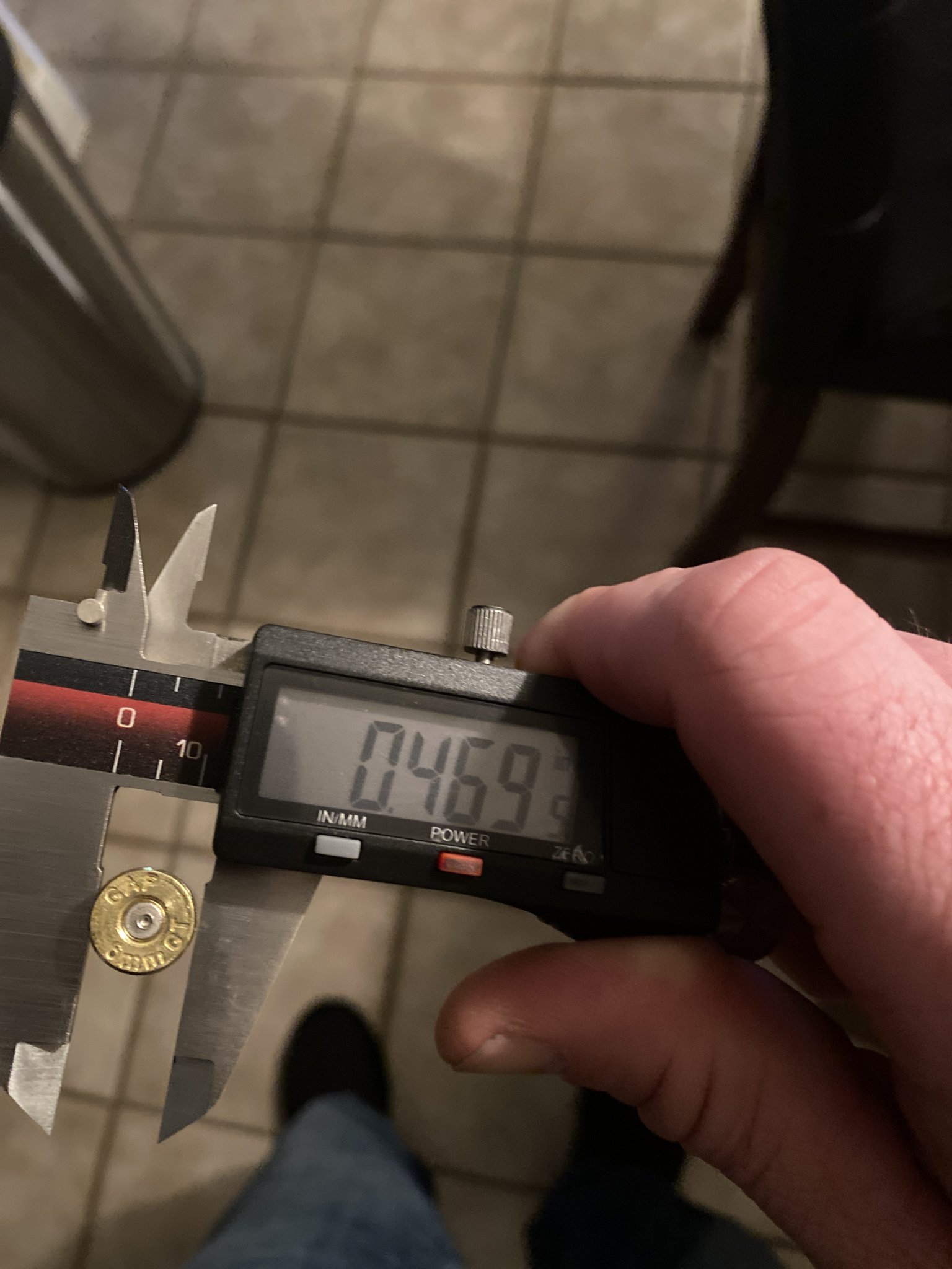

I'm still waiting for a mic'd case measurement of some fired brass an any unfired that may be left.
Also, could the case head separation cause an increase in bolt thrust? Sort of like one would see in a lubed chamber?
I don’t have a mic.
Best I could do
Pic 1- virgin
Pic 2-fired from the last batch
Case head measurements don't mean much unless you measure the same case before and after, and mark the case so you can measure the same spot. Just comparing random cases out of a batch is misleading; the measurement accuracy needed for this is finer than the tolerances of the brass dimensions for most manufacturers.
