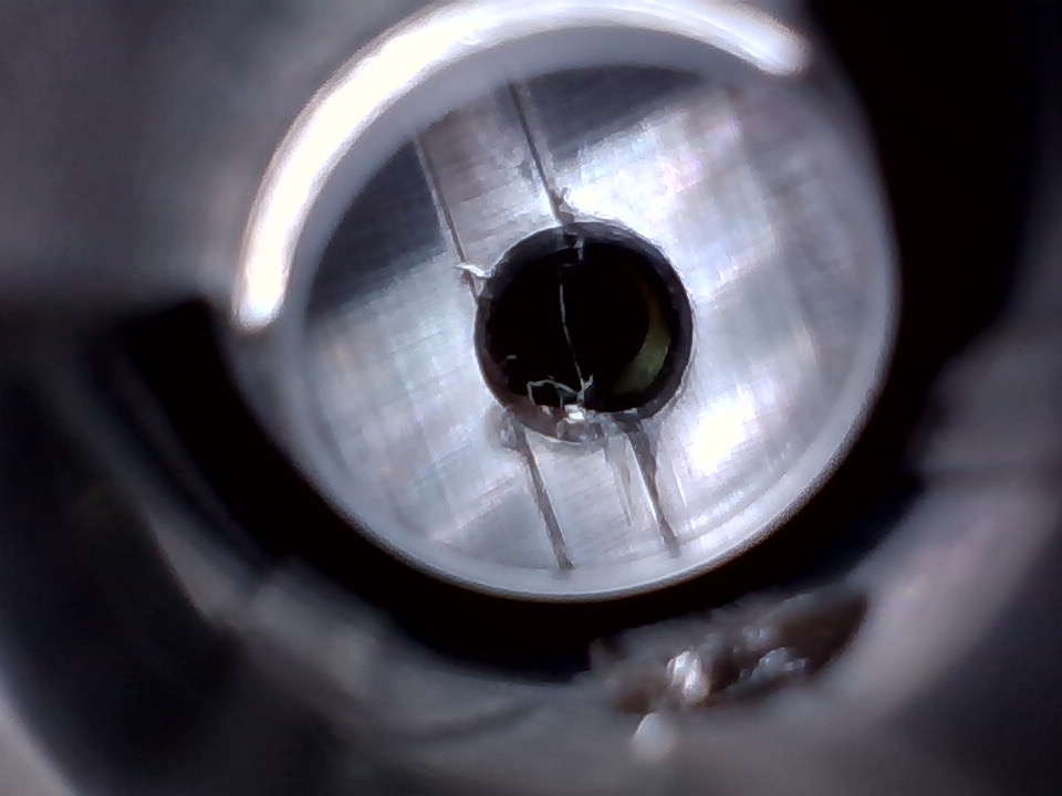

Nothing like a brand new rusted barrel, didn't even need to scope this one! :)
I would consider the Tubb Final Finish or Neco fire lapping products to help with these bore issues with respect to roughness and burrs around gas port. I haven't used it personally but it a suggestion that if used properly won't make things worse.
That's old school internal deburring tools for production purposes, not precision, used those like 40 yrs ago, in production of zirconium guide tunes, they tend to over and under champher, and deburr not a precision tool. Then went to hand deburring internally.
Their tool diameters probably do not go down to like .086" or less for pistol ports.
They are spring loaded, so ya never get the exact same chamber twice, how long you dwell pulling back, the rpm used, angle on the tool enrty and retract.. They would gouge out too much metal, especially if hitting the lands and make the problem much worse.
Once again, you are incorrect.
https://cogsdill.com/products/deburring-tools/micro-burraway/
https://mollart.com/featured/e-z-burr-hss-tools
All 3 links I provided go down to .040", that's smaller than any gas port in any AR barrel. Also they can be turned by hand or at any speed.
Yeah great I noticed that and said I didn't know if the tool went that small...it does ..great.
BUT ITS FOR LOW ALLOY STEEL, & ALUMINUM AS THE OPENING STATEMENT...So no need to read further. It's not a Precision instrument, but for general deburring of softer metals....same old patent I tried 40 yrs ago but for holes about a 1/4 " in dia. We discarded it back then. Its design is not for rifled barrels or it's steel. No one should even consider it. You want the gas port hole flat, on the same plane as the surfaces, land and groove of the rifled barrel. Not some uncontrolled gouged out champher making the problem much worse. I've used the tool, and rejected it for what it was designed for...supposedly...40 yrs ago.
I believe it has application in general deburring but where tighter tolerences and thin walls are used it over champhers, enlarging holes out of print or leaves a partial burr.
Its use is "food grade" ..."tolerences are not critical", ..."substandard machining acceptable." On your blueprint ...then you are good togo with this tool for deburring.
First off Proof Research Barrels may be High dollar but they are far from High Quality. Every custom barrel I order from CLE has the gas port timed and drilled dead center in a groove no matter the gas length, so it has nothing to do with luck. It is and can be done, thats why I only buy from CLE.
Are you sure, every barrel dead center at a point in the rifling you prefer no mater the length of the gas port or twist...always perfectly centered. How many have you actually inspected, personally?
How did you measure that ...perfection? In a temperature controlled clean room?
When you inspected the drilled hole, did you notice how out of round and jagged it really is?
So how did you find dead center of the out of round hole? Was it even dead center in the diameter barrel to begin with? How was all this perfection measured?

Its not necessarily rust. Had something similar happen with a few BRAND NEW from the factory LMT MWS Stainless barrels. One of the guys who bought it called up bitching about the bore having red shit in it and thinking its rust. Knowing I had just gotten the barrel from LMT (at the time they had a 2 year backlog on these, so this thing was freshly machined and not sitting around in a warehouse for months/years) It made no sense.
I told him to go scrub out the barrel using the usual method (few wet patches of Boretech or whatever, soak a nylon brush and give it 20-30 strokes, then wet another patch to push through, then dry patches till its clean). And it all went away with zero pitting or evidence it was ever there.
So I checked the other barrels I got and yup, same red crap in there. 5 minutes and they were all cleaned out. I dont know how the bore would even rust on a new stainless barrel unless you packaged it at 100% humidity and it say for a while. It could be some sort of residue from a protectant or even cutting fluid.
Burrs on AR barrels is an issue from forever, Once you get enough rounds to break in the barrel they will be gone/knocked down anyway and not an issue. By then you will start to see gas port erosion anyway which will make the borescope OCD kids go crazy. Gun will still shoot.
Cheap bore scopes are one of the worst things to happen to this community. People don't know what they are looking at most of the time and make posts complaining about it without even shooting the damn thing to see if it matters.
I disagree somewhat. I agree that absolutely we see people get too spun up over what they see in a borescope, but defects in barrels speak to the quality of the barrel, period. It's not always about just accuracy, it's about how long that accuracy lasts, how bad the barrel fowls, etc. etc. A barrel that's been damaged by corrosion/pitting will fowl/corrode/pit that much easier/more as time goes on. Sure, I've seen barrels that looked horrible inside shoot great, but if they fowl badly/quickly or take a long time to "shoot in" after cleaning those are also undesirable qualities. Also I've yet to see anyone argue that given all other things equal a barrel with a pristinely prepared inner surface/throat/rifling is not preferred over one that has significant surface defects. Can you have a great looking barrel interior that shoots like crap, sure other factors are important as well. However one thing is for sure, barrel interior defects are not doing anything beneficial.
According to the shop notes the "light discoloration" was from the stress relieving process. All I know is what I read on the internet on that topic, but it seems like the process for that is simply heating the barrel, holding it at temp for awhile and slowly cooling. It seems like this is typically done in an inert vacuum furnace, so I'm not sure how that could create corrosion, and it doesn't seem like any fluids are involved, unless of course they are not doing it in a vacuum environment. Others have complained of a dark red/bronze colored even coating in the barrel with WC in the past, and it appears that is from the fluid used during button rifling. Having seeing pictures of that posted by others, this definitely is not that.

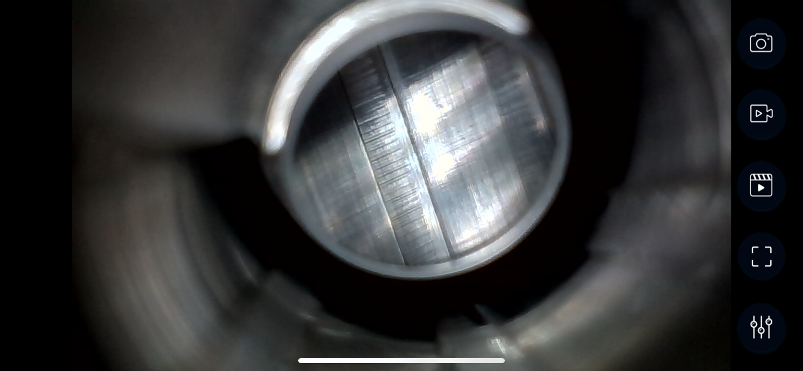

So the repaired barrel was returned today. It seems like they did get the discoloration out, I don't see any heavy obvious pitting left. The finish of the barrel interior looks quite a bit more polished than before, could be whatever they used to clean up the discoloration.
The gas port is better, I wouldn't call it great, still looks like it has some burrs that sit higher than the land does. Still looks like there's part of the land that is "smooshed" up into a burr on the muzzle side of the hole (lower side of gas port pic below).
Probably the biggest thing I noticed now that it's clean, or perhaps because I was not focused so hard on the gas port/corrosion, is what I assume are chatter marks, or perhaps the barrel was not well lapped, down probably 90% of the barrel on the lands. Should be a good copper/fowling sample collector.
We'll see how it shoots. Definitely be the last WC barrel I buy. Turn around was fast, I guess that's something.

Finally got it to the range, didn't shoot great or horrible, probably 0.8-1.2" groups with 80.5 gr FGMM, it did not like 88gr Hornady at all, or 75gr AE that some people seem to have good luck with, closer to 2" with those. I was surprised it didn't like the 88gr since quite a few have had good luck with that. It also seemed like the 88gr needed way more clicks opening up the gas port than 75gr/80.5gr did. Not sure if i'll bother to try the 90gr FGMM.
You have a scope, watch it after you shoot, I'd put money on that point dragging copper from the bullet and fouling all the way to the muzzle.
That would be a bad wager to take you up on! The barrel cleaned up easily of all copper, aside for a probably 2" solid copper streak from the gas port forward on top of the land the port went through.
