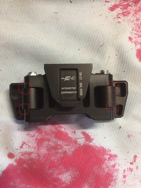

Using a different mount is not going to change things. In this case, the distance between eyes is a defining factor. In other words, for comfortable viewing, the distance between optical axis of the NOX and PVS-14 has to be fixed and equal to the distance between centers of your eye pupils. I hope this makes sense.
To expound, the battery compartment is in control of this relationship - you can’t get them close enough without swapping.
That said, the rifle mount they picked is as light as they get - which is heavy for helmet mounted NODS. I was very pleased to remove it and save that weight for a 99% helmet mounted rig.

How about swapping the dovetail, then using a dovetail weapon mount like the Wilcox flip-to-side? This may require a different or modified dovetail, setup to use both screws in the rail side, and the user would need to enter the menu to swap the orientation so the reticle can be used. The issue would seem to be using the single 1/4-20 screw under recoil. The dovetail system itself should be fine, the M300W mounts that way, it just a matter of a secure mount. I'm sure I could mill a replacement of the weapon mount interface and then secure a dovetail to it. In fact, someone should suggest that to N-Vision.
That’s a pretty strong suggestion. Good thinking.
I’d also love to see a new dovetail to rail mount interface that clamps the dovetail and is simpler-less expensive than the Wilcox.
Bobro uses a compression spring on the pic portion of their mount that could also be used on a navy style dovetail. That way there would be no slop.

It's an interesting idea but, unfortunately, it's not going to work. The "dovetail" side of the Nox is not strong enough to be used for weapon mounting. It is one of the compromises that we had to make very early in the design phase, trading size and weight for the ability to have a weapon mount on both sides of the Nox.

I think what they are saying is make a dovetail that goes on BOTH sides. including the one that has the weapon mount today.
Then you clamp the dovetail that’s on the weapon mount side but can still helmet mount.
You could make the dovetail on the weapon mount side with a notch that only allows the weapon rated side to click into the mount to avoid damage, while not affecting helmet mounting compatibility.

Maybe I misunderstood. However, the dovetail, in general, is not a good weapon mounting solution. It is OK for SkeetIR (clip-on does not require perfect alignment or repeatability), but I don't think that it's going to work for a weapon sight. Return to zero may be / will be a major problem.

I have a solution to that, and understand from using the Wilcox/etc in this space EXACTLY what you mean.
In the mount design I propose, the dovetail no longer slides into the front. What happens instead is you cantilever it on just like you would when mounting a pica tinny unit. Then, as you close the mount locking lever it forces the unit to the opposite side AND forward at the same time. A spring loading system puts substantial pressure on the dovetail to lock it into place regardless of tolerances of the dovetail, and it will then lock up ROCK solid and return to zero.

This may work. Something to think about :)

Something like that may work. Nox is going to move down 1/4" or so while installed on a helmet mount. This may present a problem if dual-mounted because it's not going to be leveled with PVS-14 or another Nox. However, if the Nox is used by itself, this can be a valuable solution for users who want to have it mounted on the left eye + have the ability to switch to the weapon sight mode quickly.

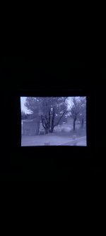

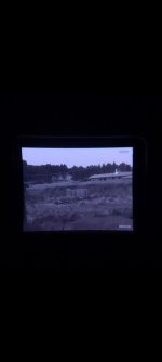

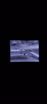

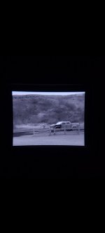

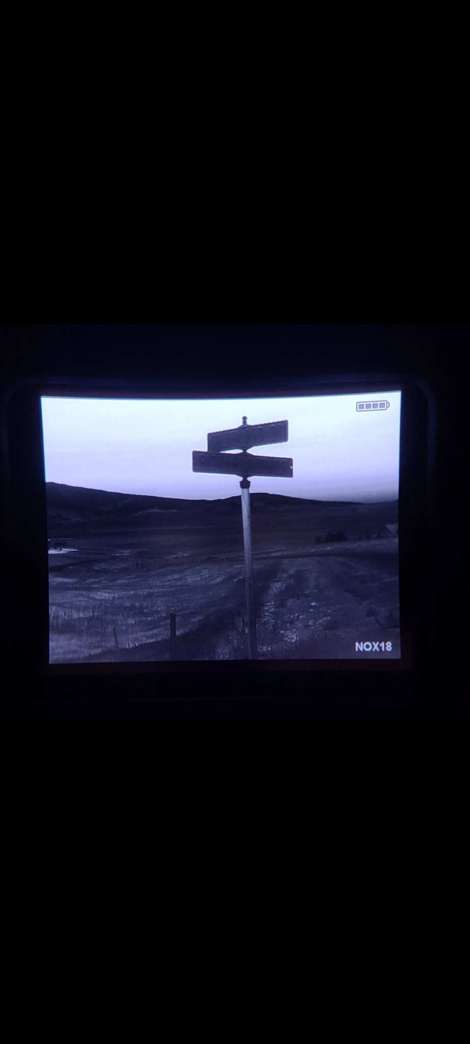

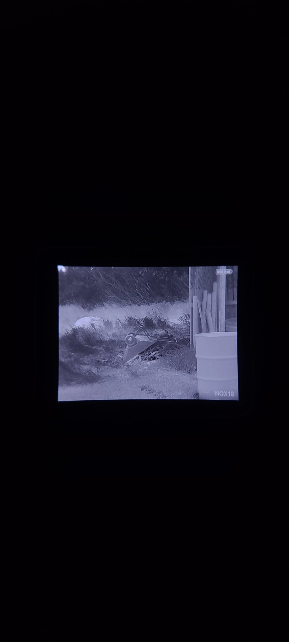

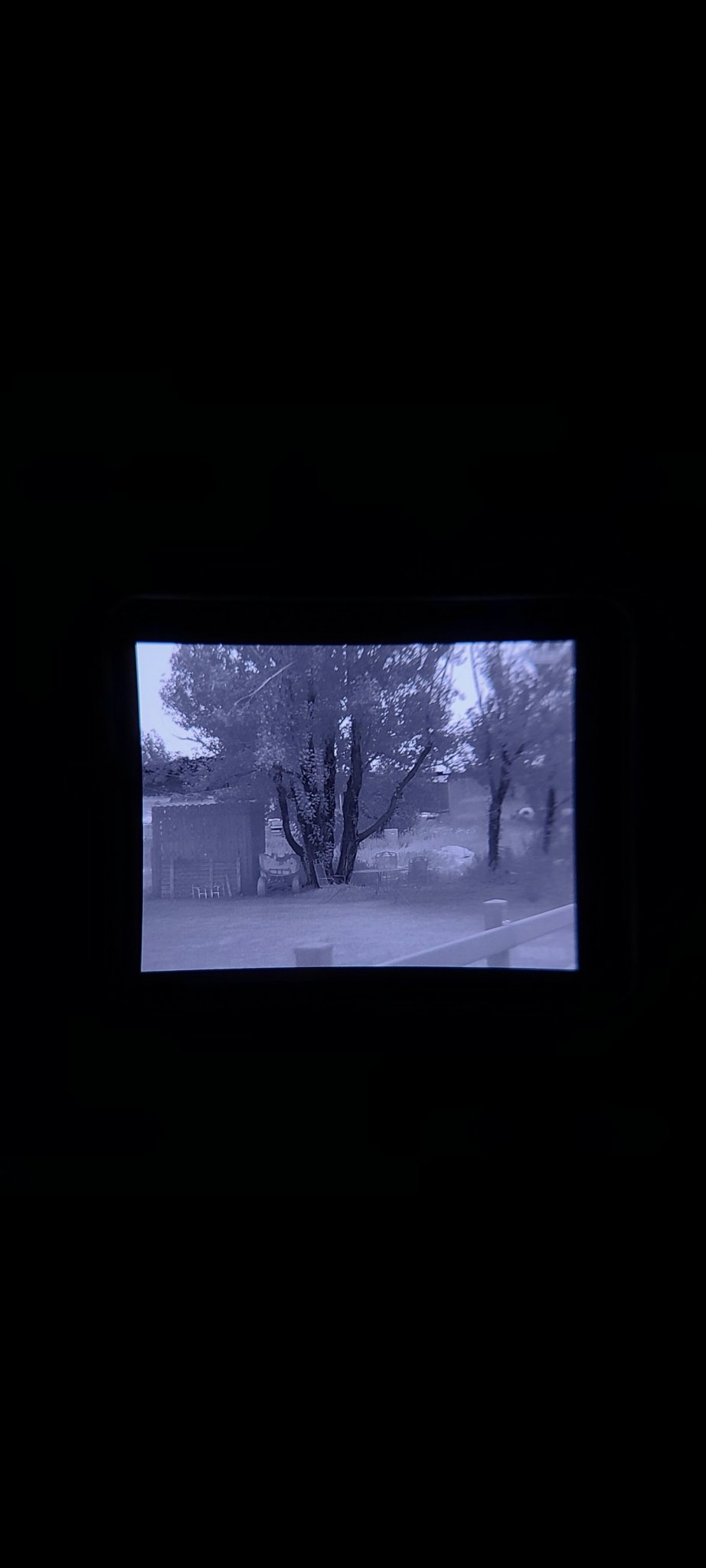

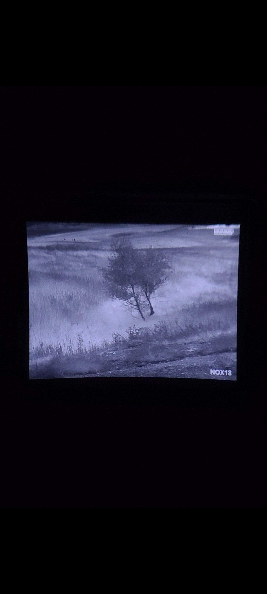

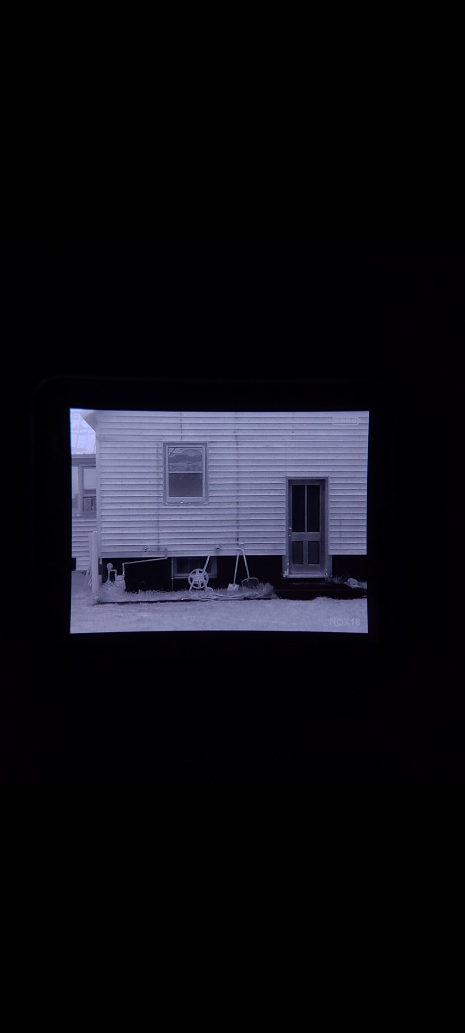

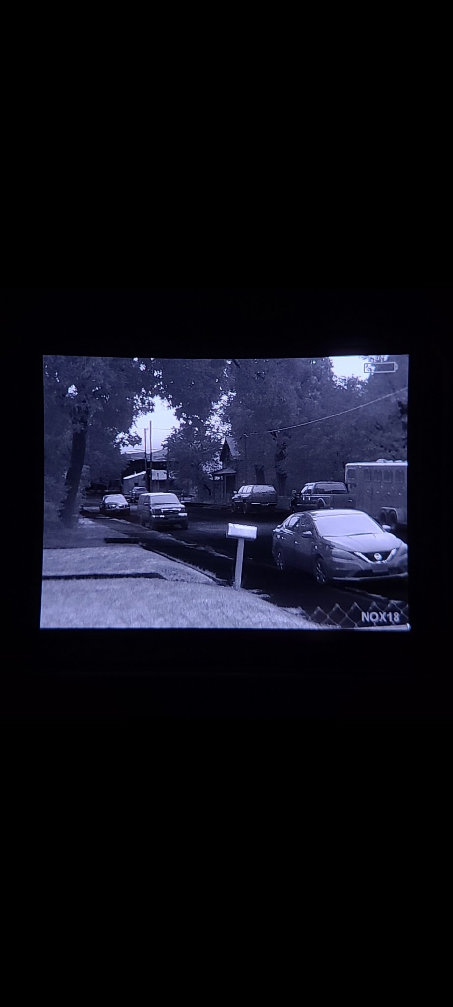

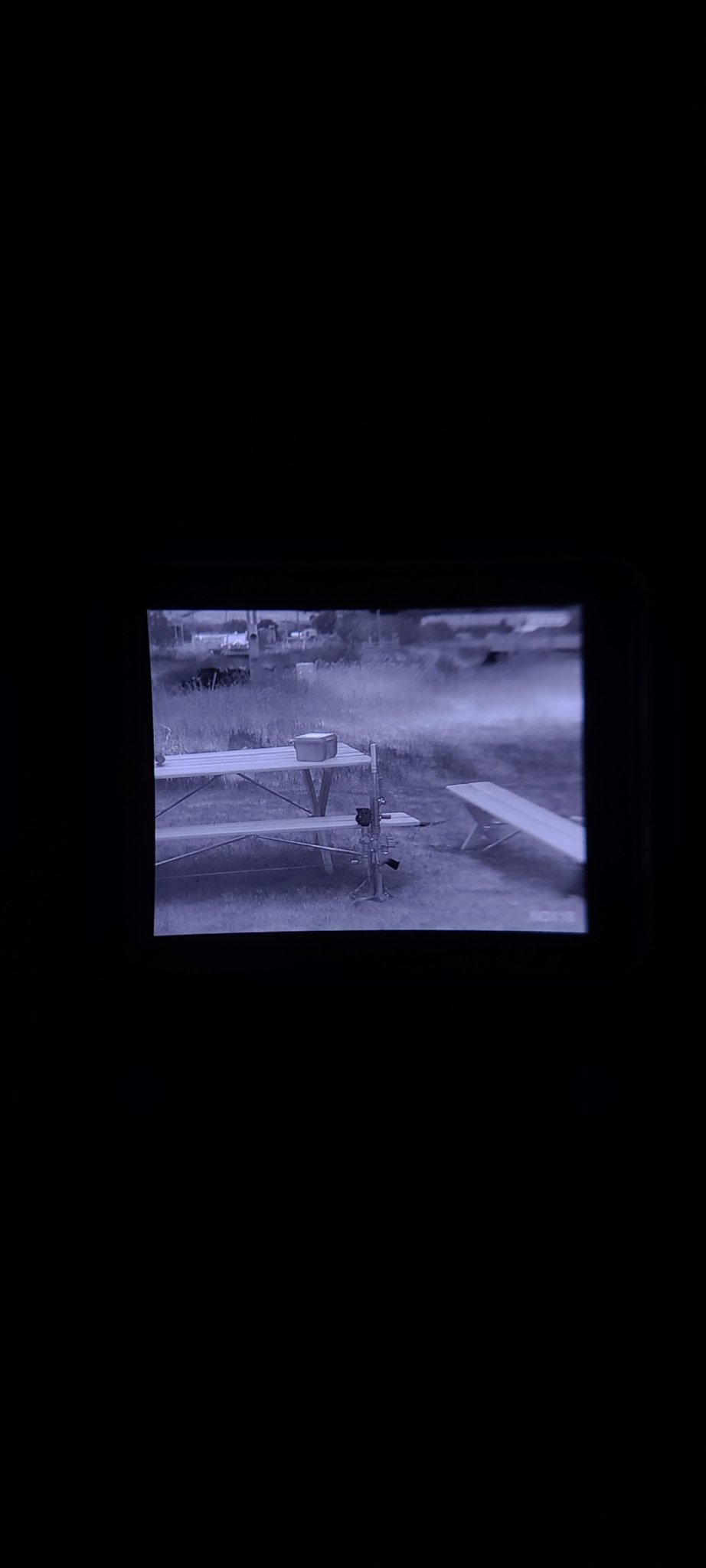

Just picked one of these up.. and I'm impressed to say the least. The image is smoother than the earlier Halo 25/50 LR units that I had over a year ago, and the housing is fantastic. I compared it to the MH25 and the FH25R.. and it held its own. This is going to make a WAY better helmet mounted unit for sure. Anyway, here's some pictures for you degenerates

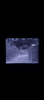

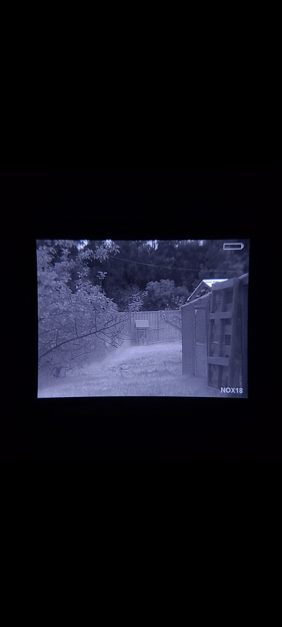

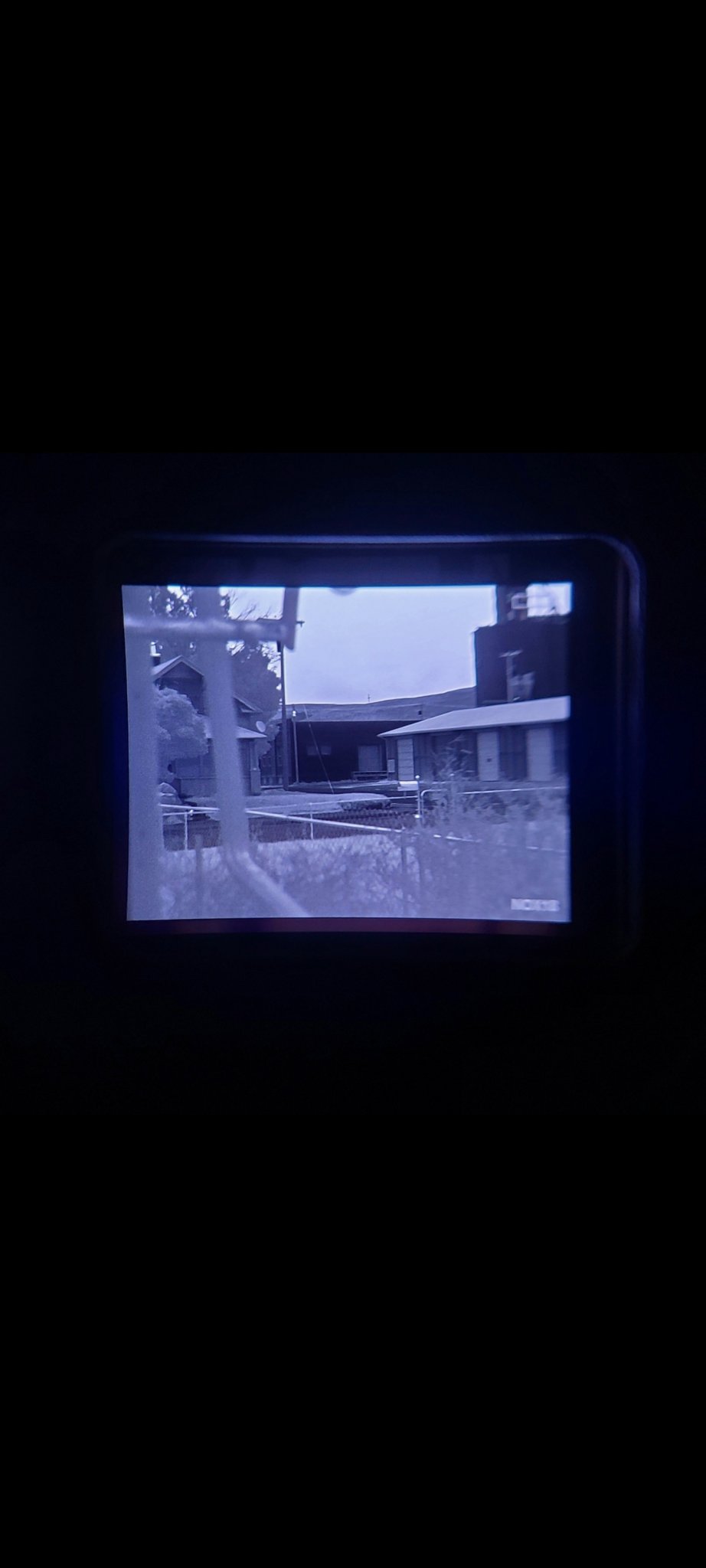

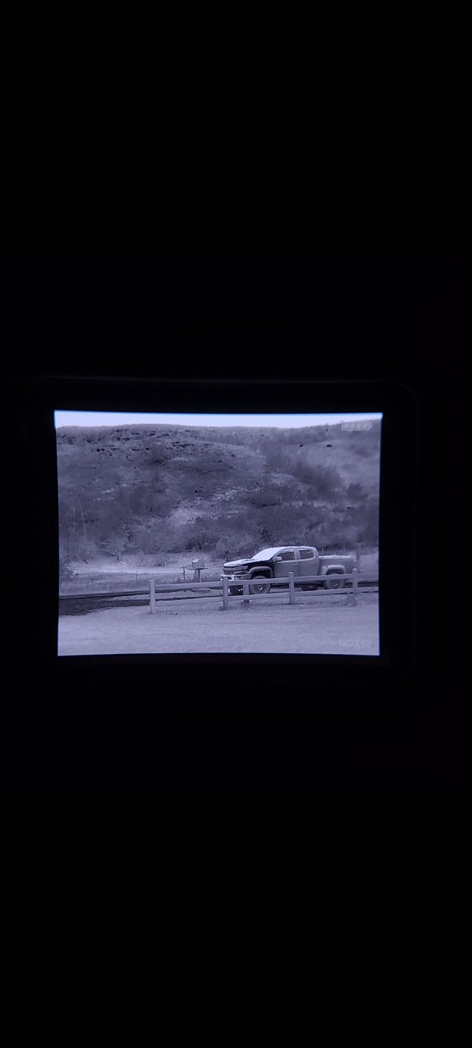

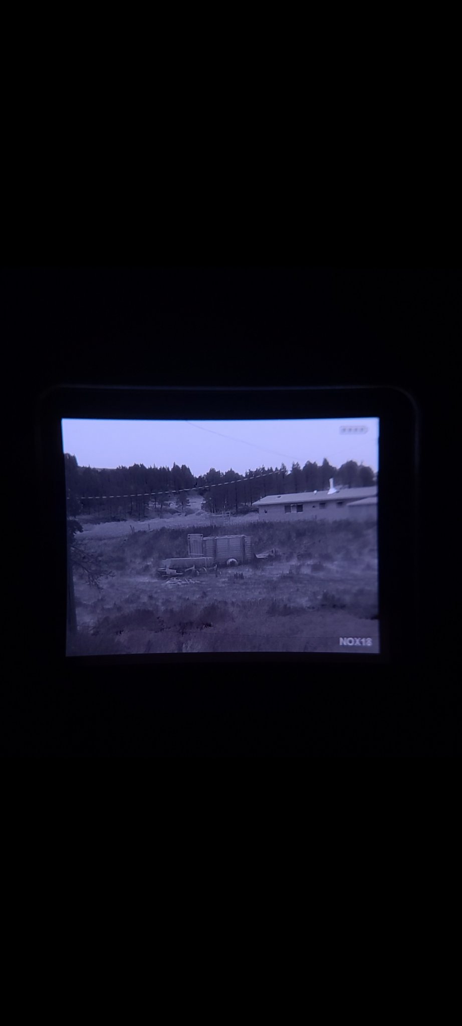

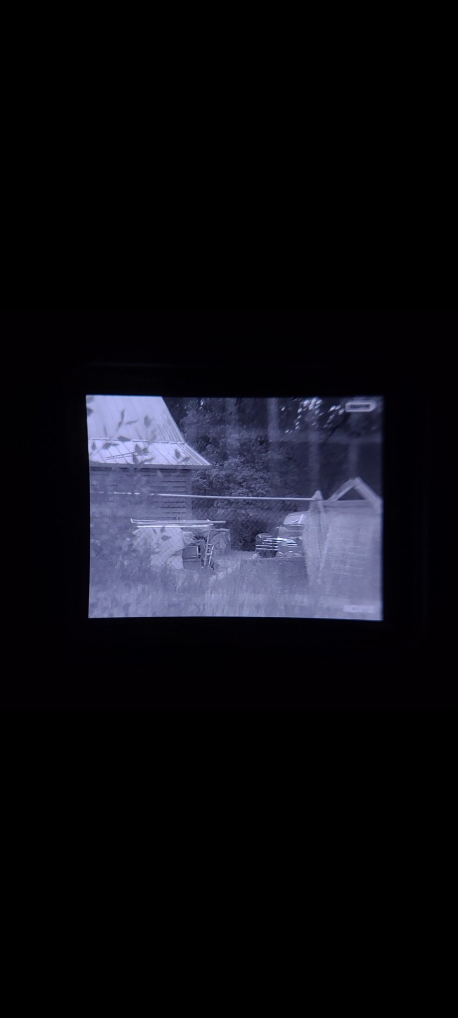

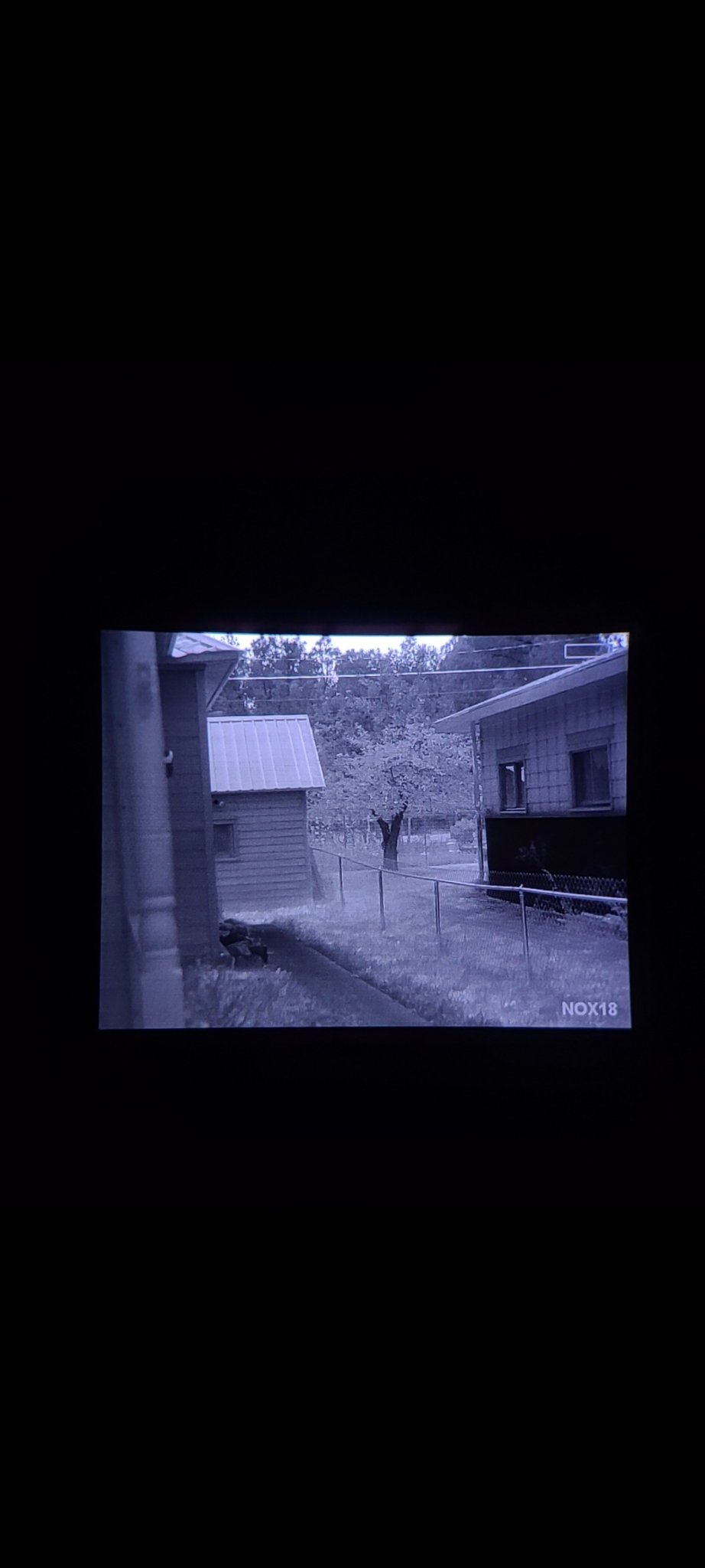

Taking pictures through the eye piece is notably better than still shots with the unit itself.
Just the 2 batteries. 15.8oz. If you haven't taken it off the weapon mount weighs quite a bit. Also if your running plugged in go down to cr123 or no battery. Stripped down the 18 weighs about the same as a 14.

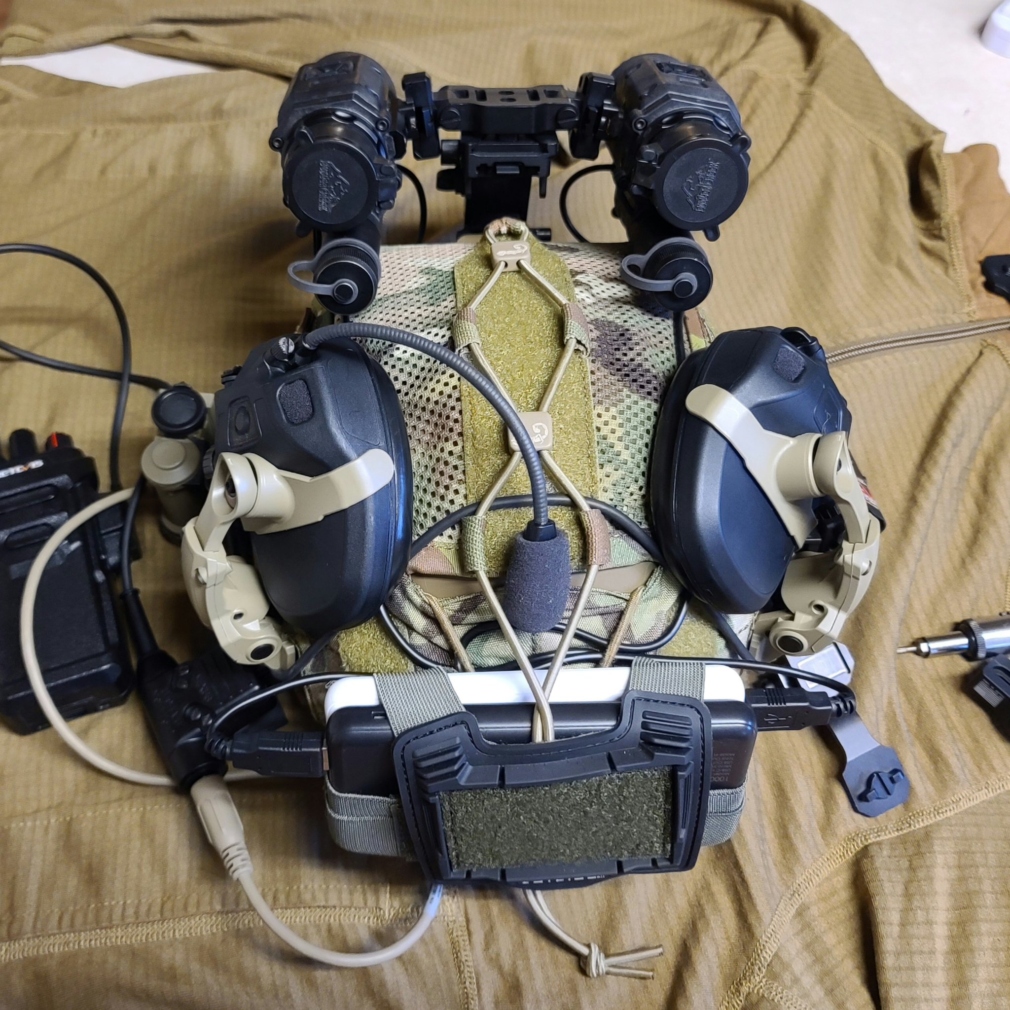

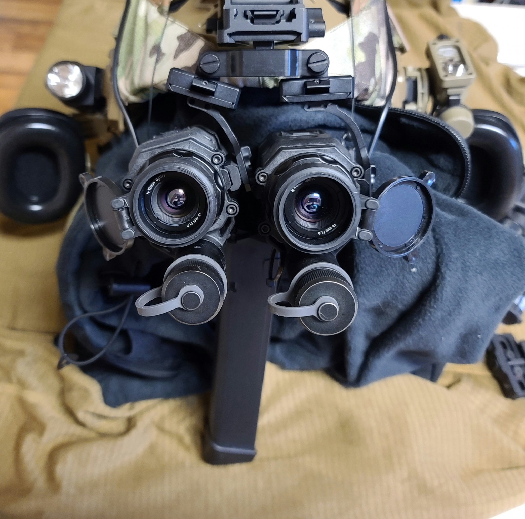

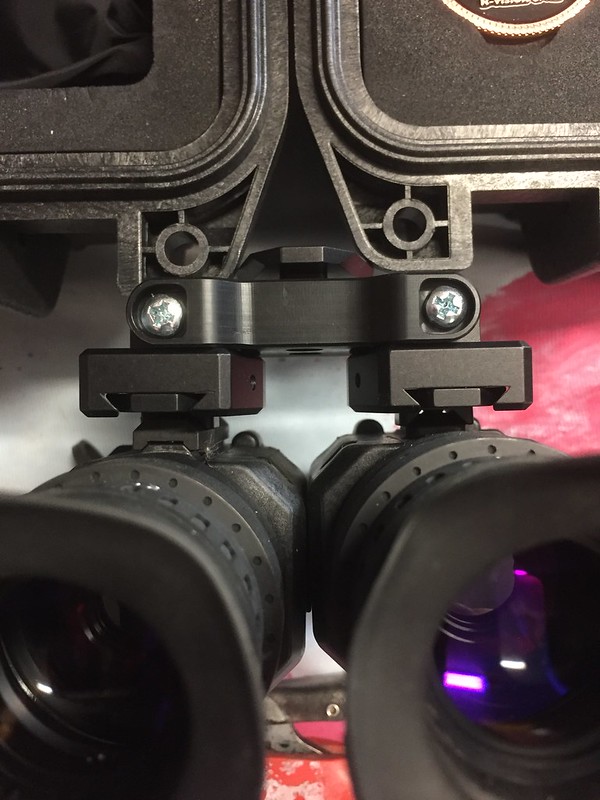

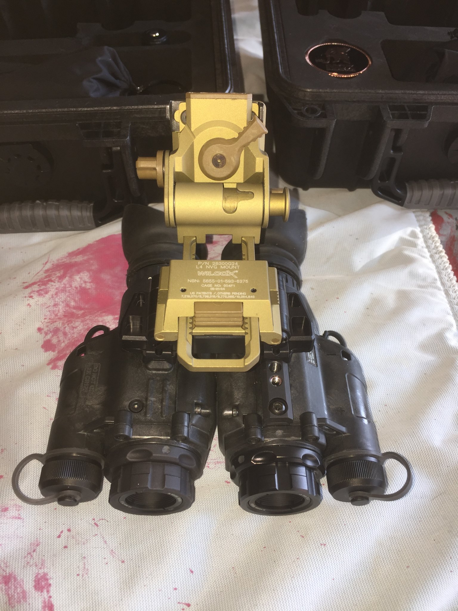

U can get the two Nox 18 to come together with NO cant......u have to remove the bolts that hold the dovetails into the D14 and put back smaller shaft bolts..this allows the D14 dovetails to spread about 1/16" wider per side where they mount on the D14 as seen in pics.......this brings the units parallel to the D14 and the screens become ONE with NO CANT....just get good grade bolts and locking nuts .....and yes the controls have to b on the inside batteries outside to make it work....Good Luck
Reactions: stefan73
^^^awesome post!
Would you be able to post some specific thread and length measurements and possibly a source, please?
Reactions: stefan73
^^^awesome post!
all u have to do is take the bolts from the D14 to a hardware store and get stainless minimum or grade 8 if they have them........BUT.......i dont know the sizes.......BUT...all u have to do is match the new bolt thread size in diameter to the D14 bolts threaded portion only that u removed then obviously the same length and a locking nut to match it......its a cake walk........Good Luck

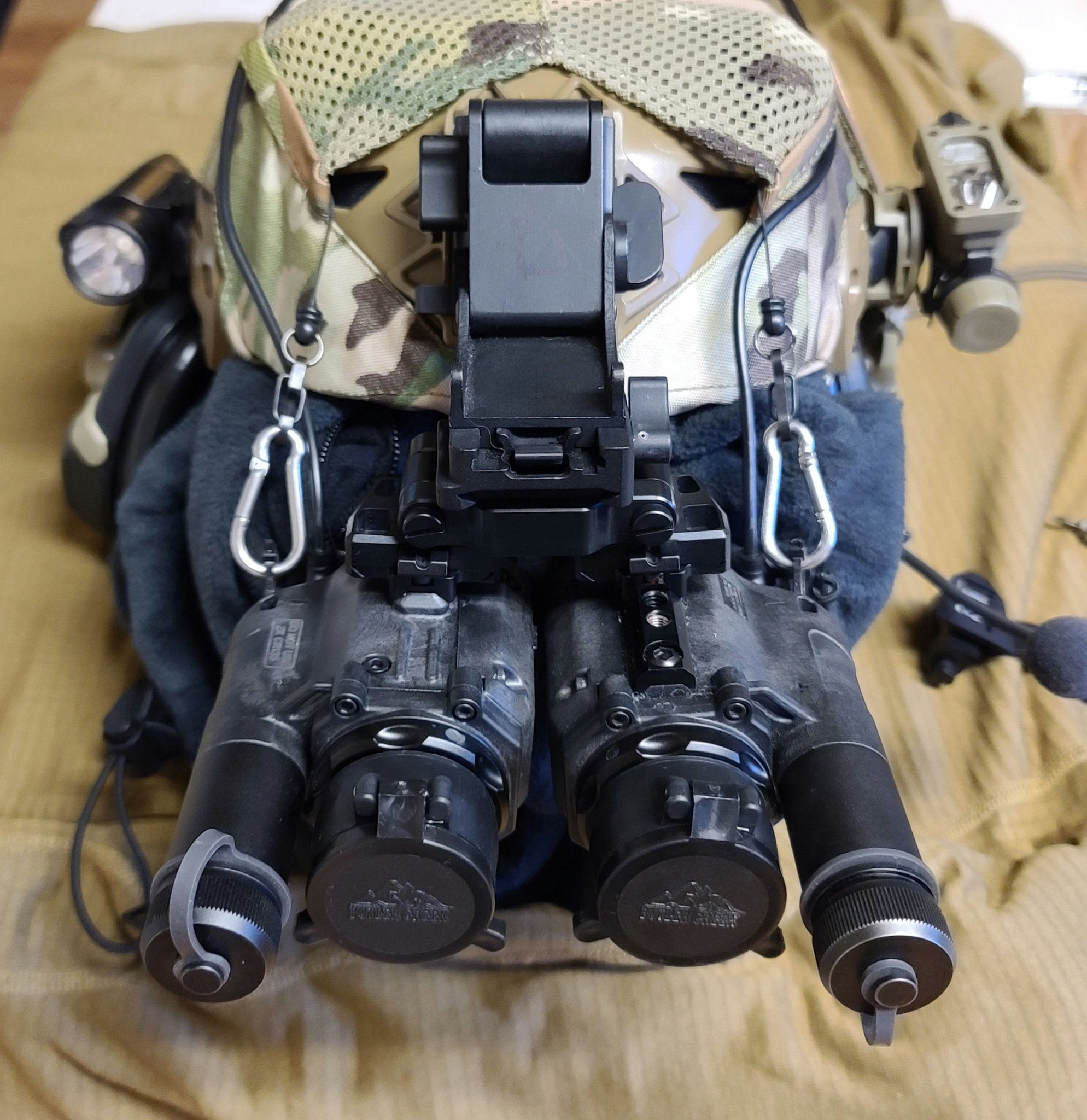

They pretty much touch no matter what. The fix above will level the screen if that's an issue for you but I don't think it really gets them closer together. This might have some kind of potential but I don't have the bits to make it work and since I won't run them doubled up much I don't wanna through $ at it.
Thats a dual j arm setup? How did you accomplish this?
I guess I was just hoping someone could measure with them touching. Would hate to invest 13k in this and find out they are still farther apart than the 62mm between my eyes.
I'd help you but I don't have them set up that way anymore and I'm more tape measure speed than caliper speed. Honestly you'd be better off with an 18 and a high spec wp 14 or a cheap wp 14, 18, and 35 for your rifle.
Eta if your buying that much gear I'd give jrh or strictly offensive kit a call. They might be able to put together a package deal and save you some $.
Reactions: jstokes1
Between the 2 holes for the weapon mount there's a hole that's threaded like a pvs14.
There is???? When i contacted mod armory and nvision, they said there was nothing for a j arm. I had to buy a dovetail model vs the lightweight. Did nvision recently make changes to the nox to fit this????
I screwed it onto my Mod Armory jarm as well as the pvs14 arms for my d14. I was just messing around but it seemed to screw in tight. I can double check when I get home. One of those 18s is brand new but we've had the other one for awhile. It does move it back further towards your face. That's an issue with my rhino2/pvs15 socket but it might work with one of those wilcox helmet mounts that look longer.
Eta I don't think it would work on the lightweight. The hole threaded pvs style isn't going to line up with the one on the 14. If I remembered right the rear hole of the weapons mount is where the dovetail goes so using the pvs hole would push the nox eyepiece back further than your 14.
Reactions: Jgunner
Ah, now i see. Dual nox is ok, but not paired to a pvs. Makes sense.

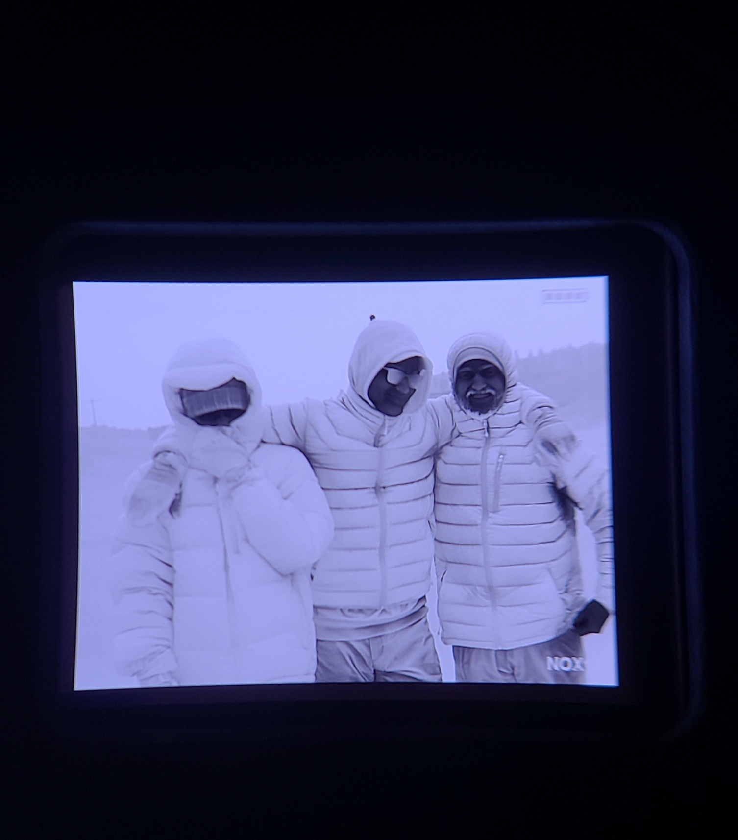

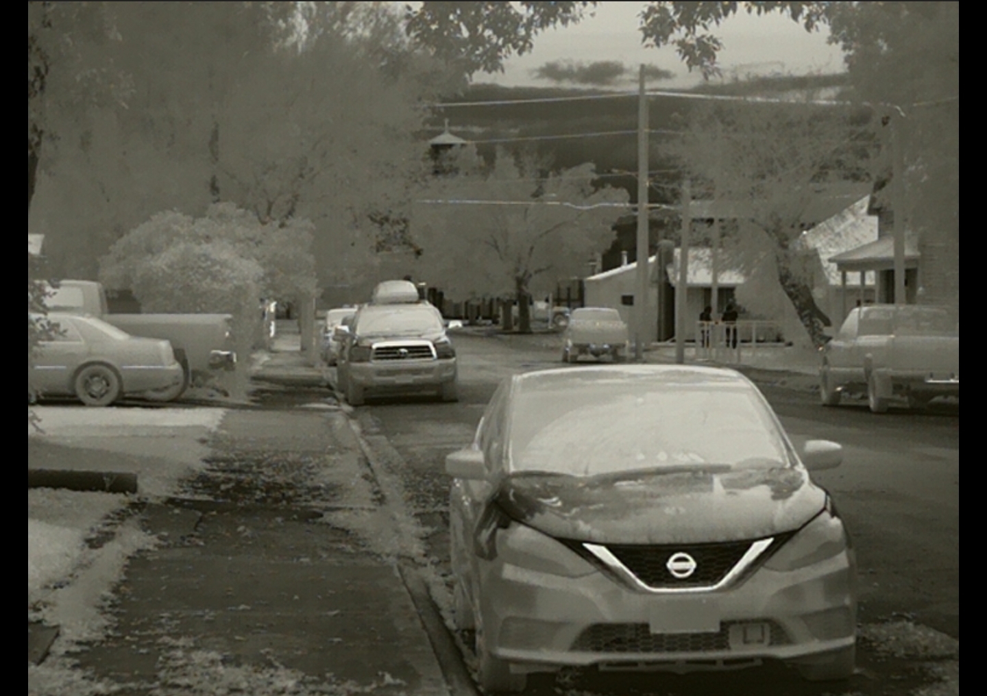

Another picture for you guys.... but in poor thermal conditions. It's currently 39⁰ F in my area, 96% humidity (quite rare up here) and has been raining all day, but yet, the Nox still prevails. Feast your eyes gentleman.
Compared here is the FH25R in about the same location and with comparable (well as best as I could get it) settings.
Bluish hued image is the Nox, lighter colored image is from the FH25R.

Paired a nox 18 Last night with a (not mine) photonis echo wp last night. Nox has a filter on it. Dialed the nox back to 2 bightness(it was still barely light out), and the color was damn near spot on. It was easy to look through these while looking at white light(neighborhood) and stuff that was white hot. I was truly impressed. Didn’t get to try it in the field but i will, soon.
What filter were u guys using? I’ve been seeing footage of the Nox 18 having a blueish hue to them which is what I need to pair with white phos 14
