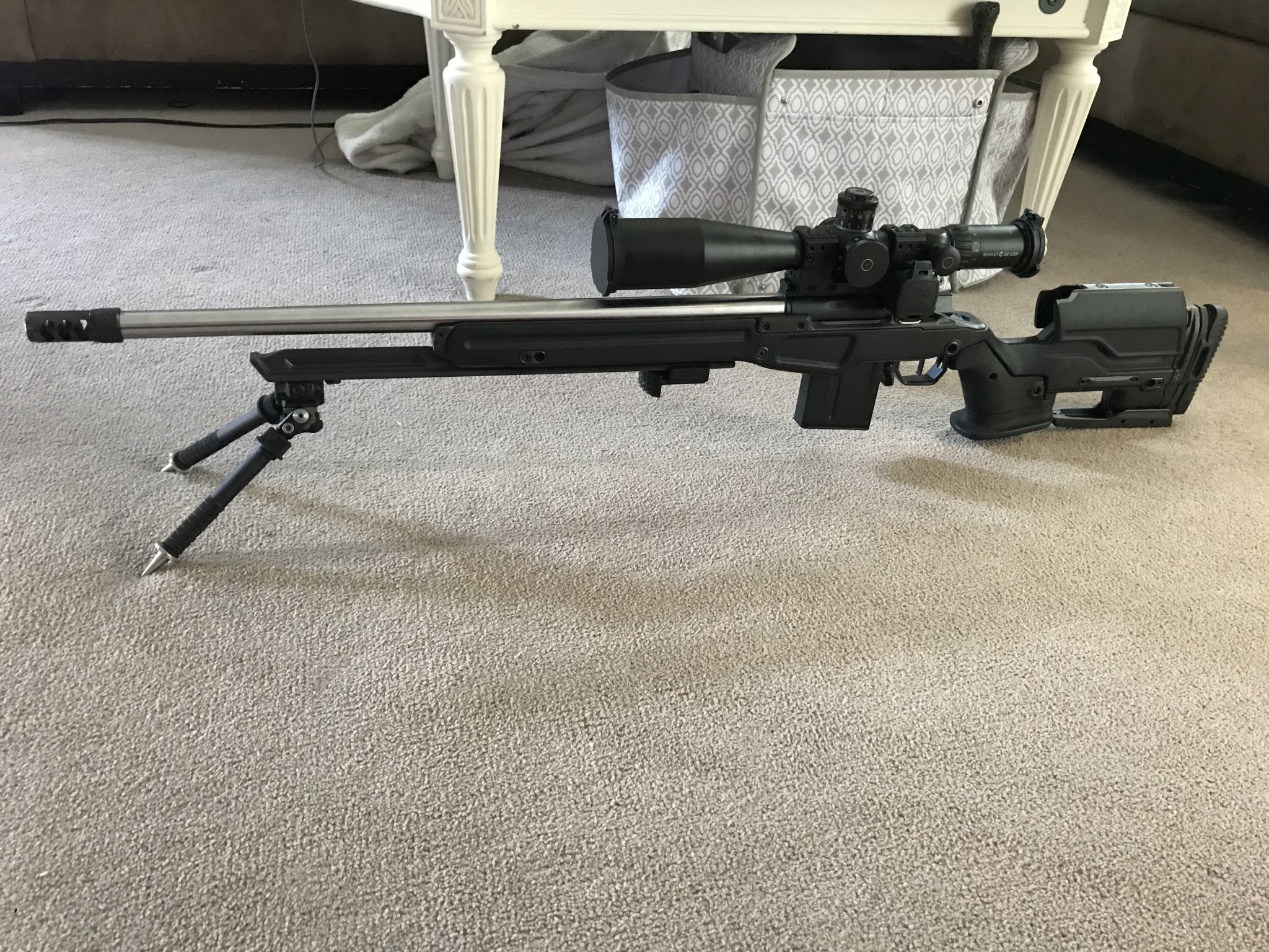

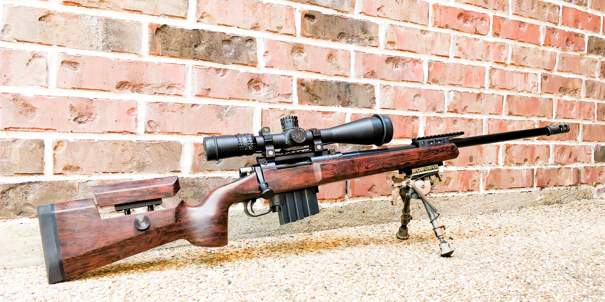

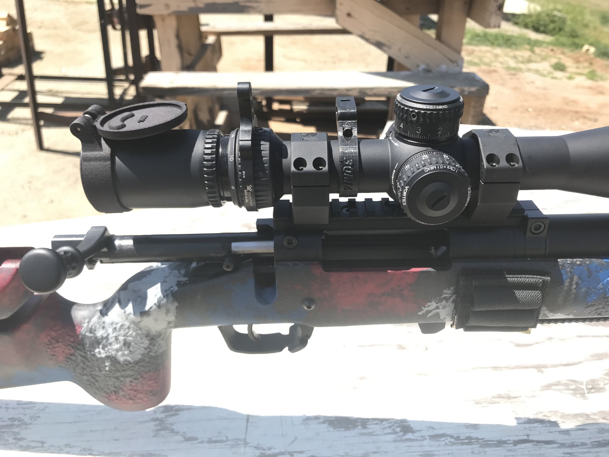

I don't know if my Nucleus which from the serial number appears to be #164 was blessed by the rifle fairy, but I now have over 600 rounds through it with no issues at all. I've shot 2 local matches with the best finishes I've ever done, and a 3 day Scott Satterlee class and my Nucleus has performed great. Here's the rifle and a group shot while taking sighting shots before yesterdays match:

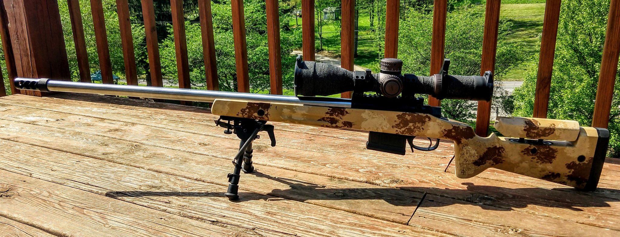

Nucleus action with shouldered Barloc
PVA Rock Creek button rifled shouldered barrel 6.5 Creedmoor
Huber 2 stage, 2.5 lb. trigger
Manners T2AGAP stock w/Gen 2 mini-chassis, Americana finish
Vortex AMG in Vortex PMR (Seekins) rings
Area 419 12" universal rail (the stud holes in the Manners matched up perfectly with this rail)
My action is the smoothest of the ones that I own which include AIAW, custom FN SPR, Gap Rem 700, and Stiller Spectre. I got mine in December 18 so I think it has the original 16# mainspring. Had no issues getting controlled round feeding with AI AICS mags, and have had no misfires with CCI BR2 primers or Prime 130 ammo. However, I will note that the firing pin indentations of my Nucleus are not as deep as my FN action or my AW.

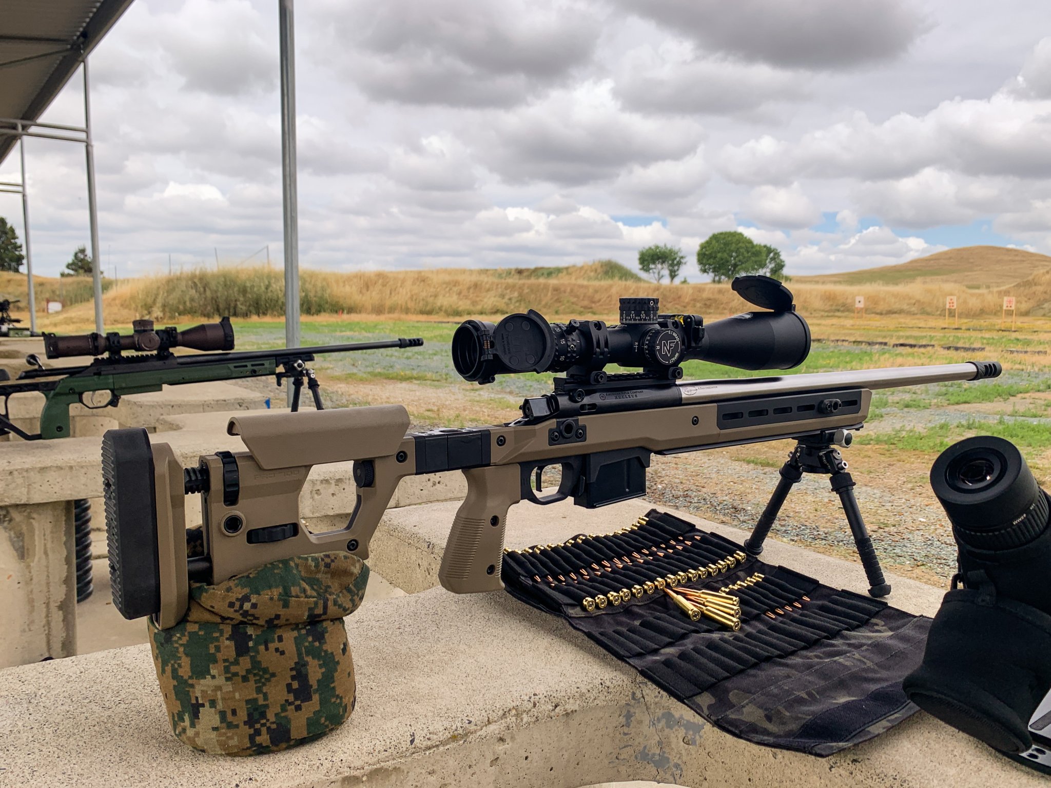

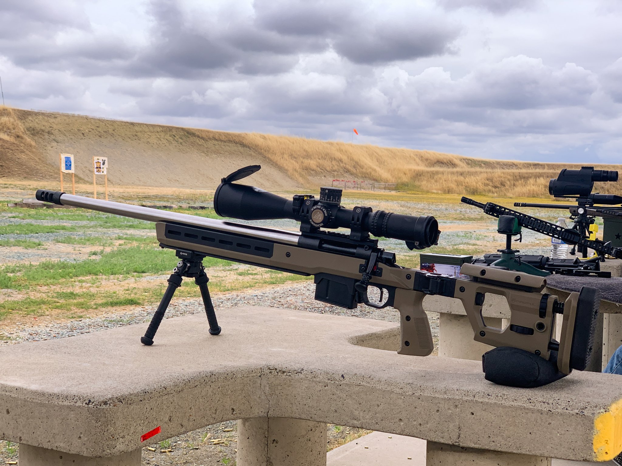

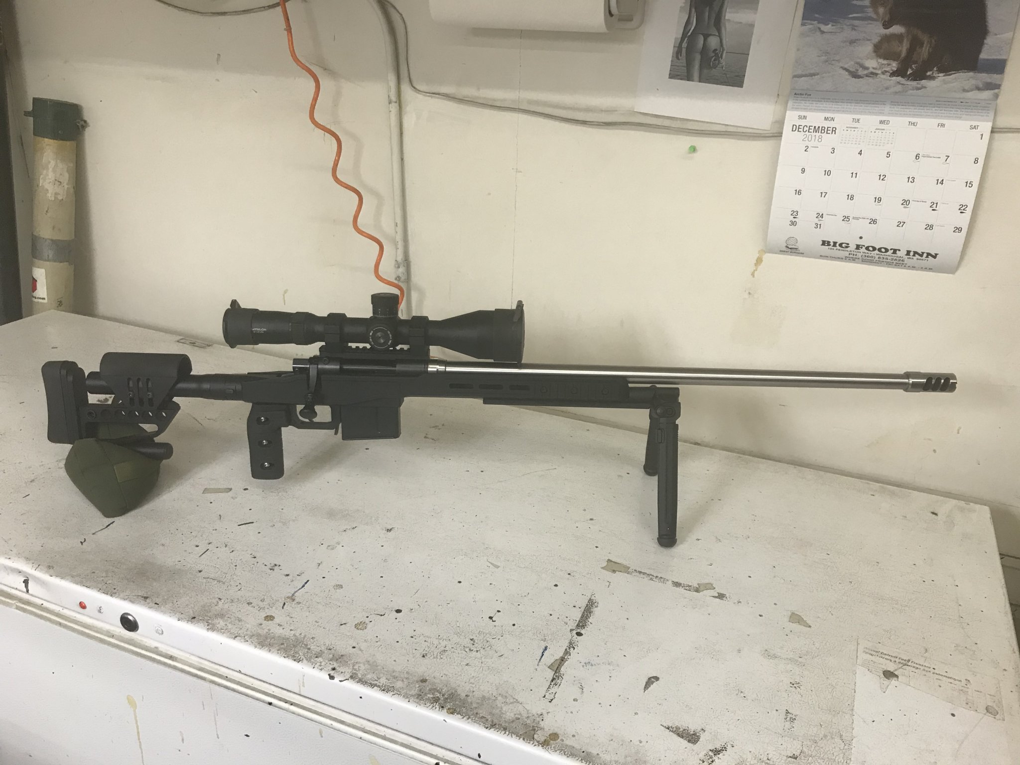

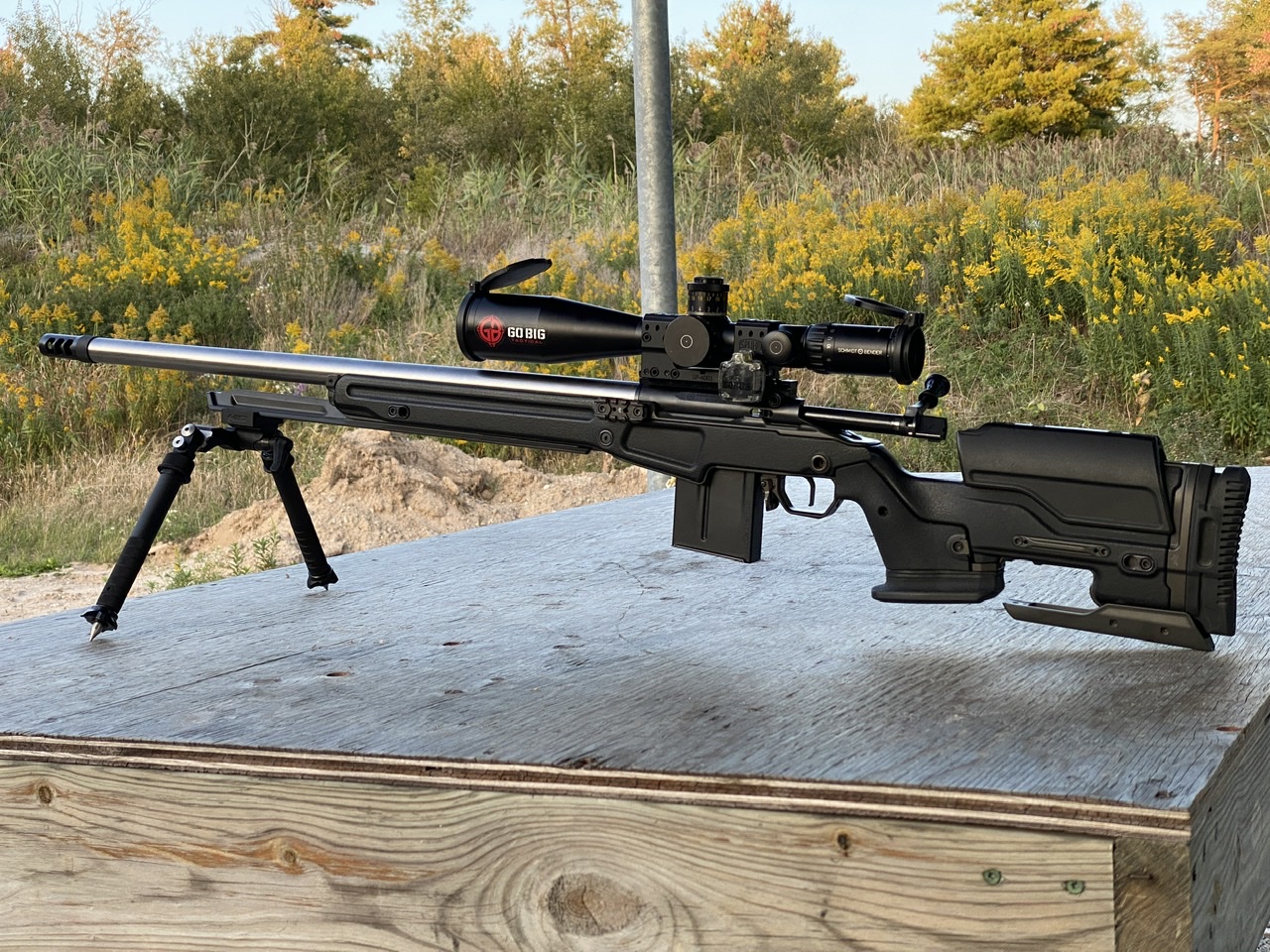

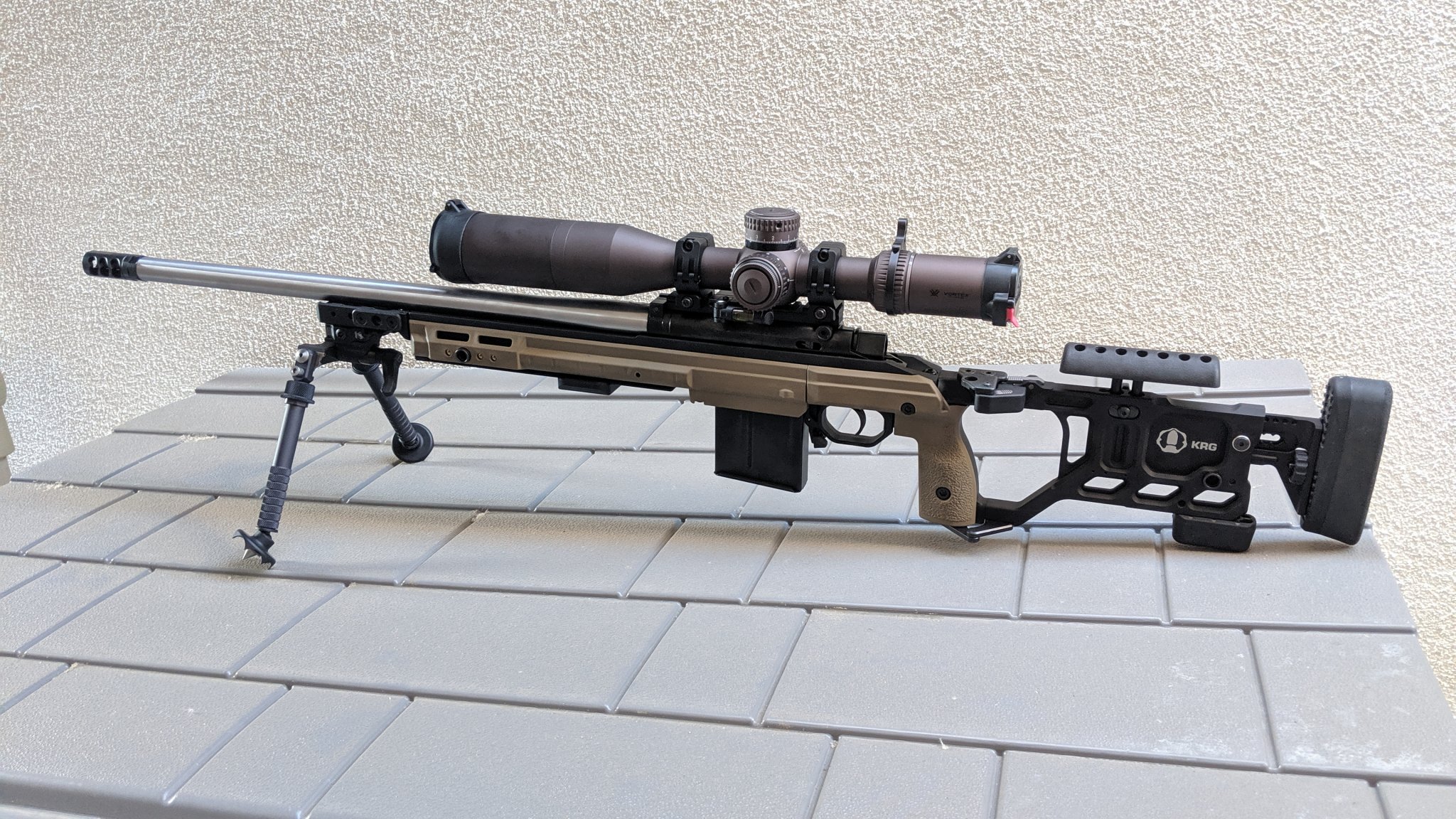

All done! I cant believe this build is faster than my PVA BA. Still waiting for that BA ?
-Nucleus Short Action
-Barloc (Shouldered - NO Barrel Nut)
-30MOA Rail
-6.5 PRC 22" Heavy Palma (PVA bbl ha!)
-Jet Blast Brake (A419 brake is a bit easier to install and time)
-3-18x50mm Razor Gen2 EBR-7C
-ARC low rings
-KRG Whiskey 3 folder
-Atlas CAL
-FlatLine Rail bubble level (barely fit)
-Huber 2Stage
***I used 2 washers for front action screw and 1 washer for the rear.

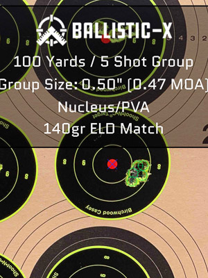

Absolutely loving my nuke so far (~150 rounds down the pipe). Haven't had issues with poi shifts with the Barloc so far, but haven't ran it harder than hitting the end with my fist. Installed it with some anti-seize on the mating surfaces. Also tapped it all around while torquing, like I do with V-clamps on the aircraft I work on.

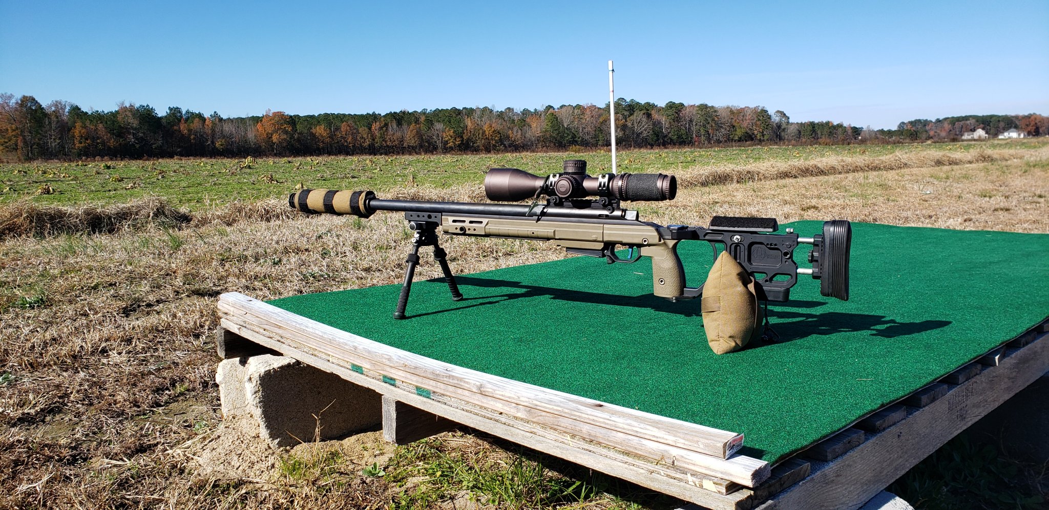

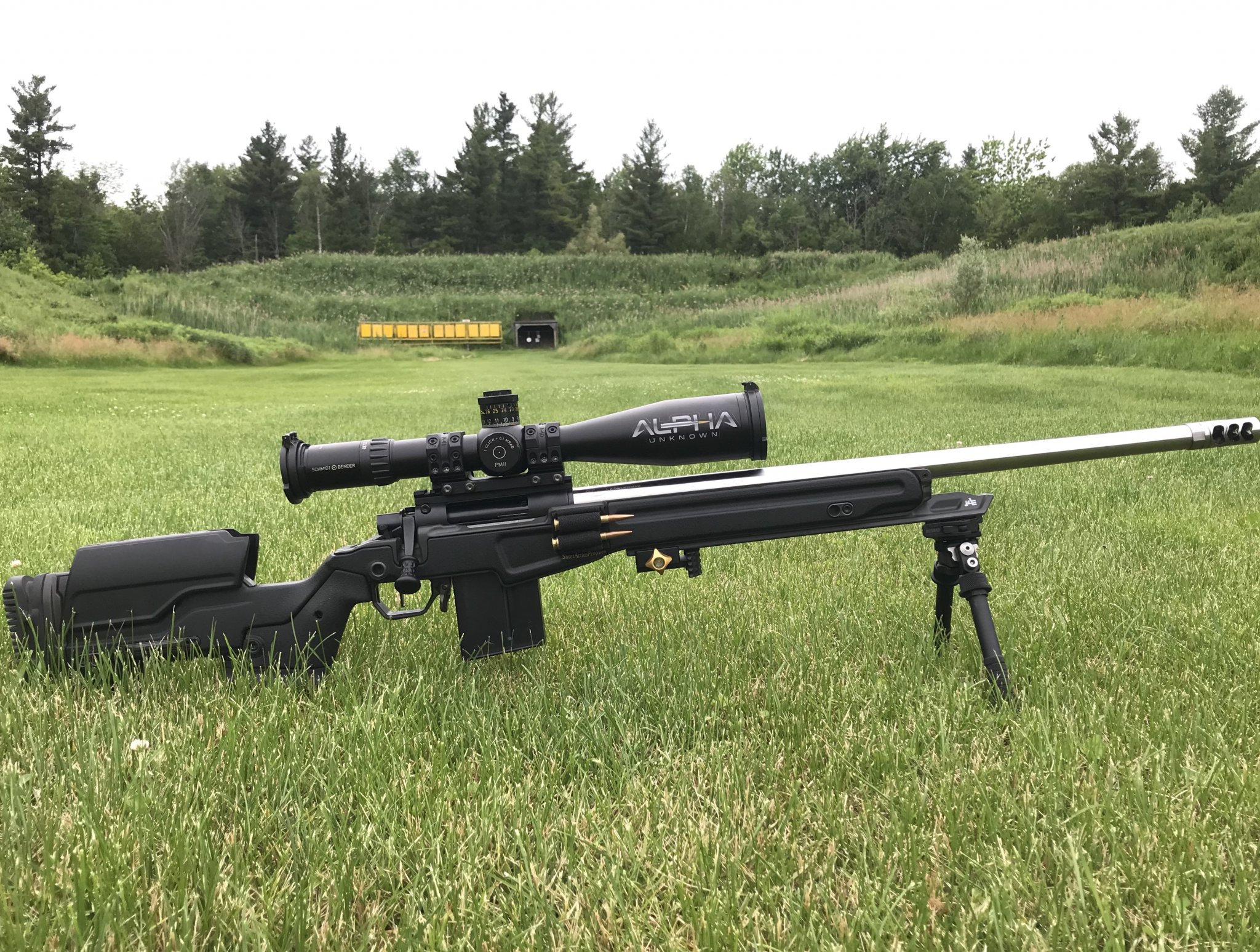

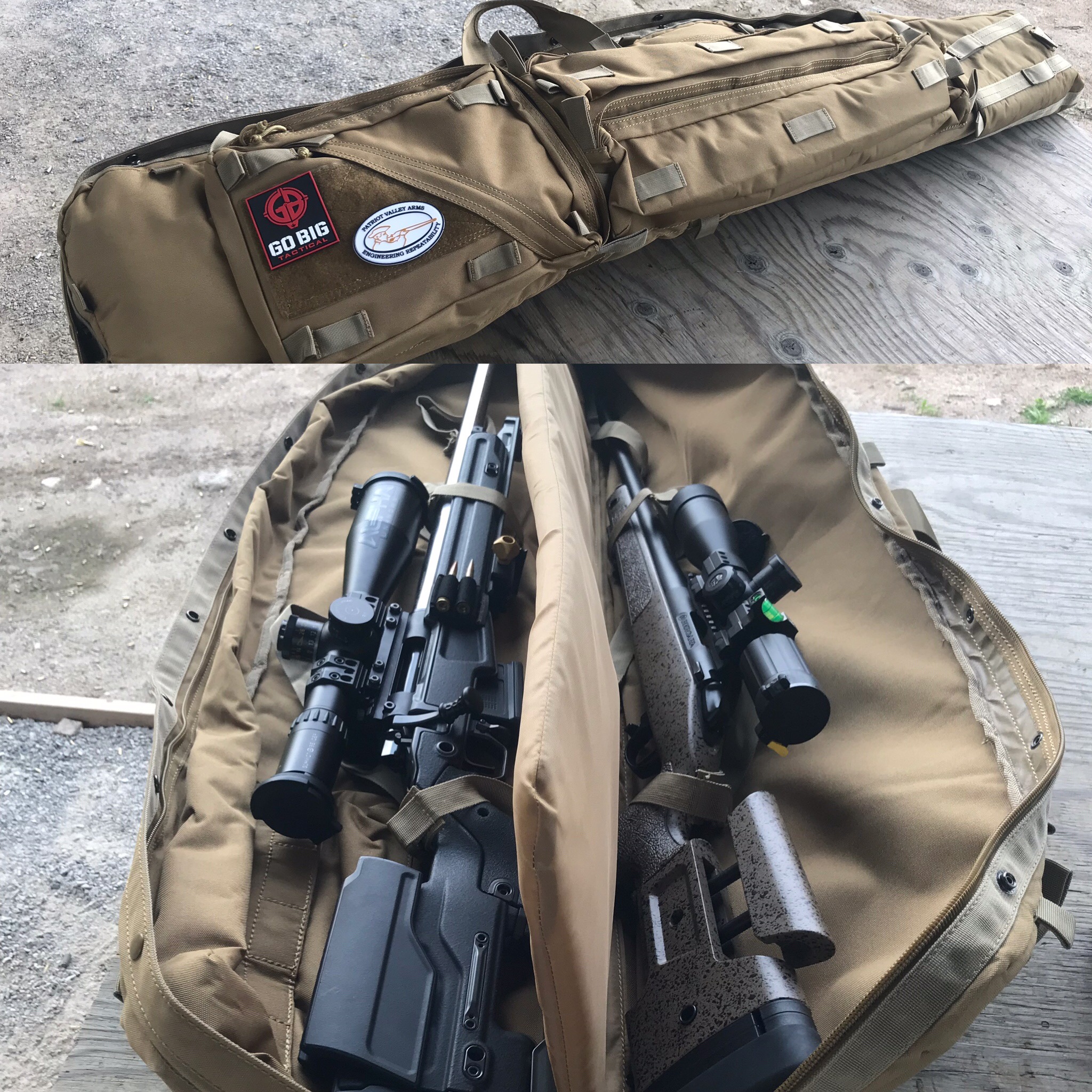

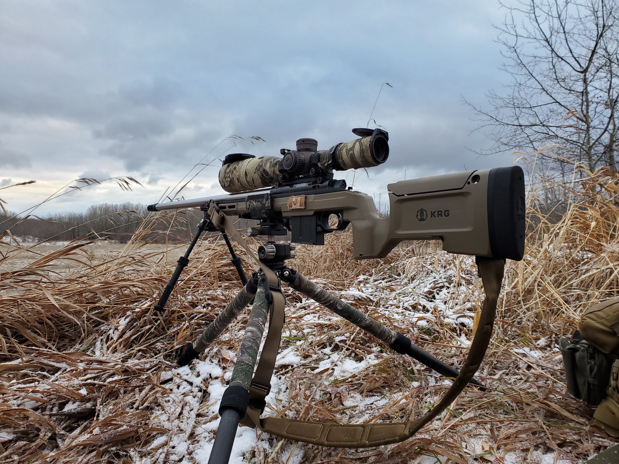

- Nucleus Short Action
- Barloc
- IBI 26" pre-fit barrel chambered in 6.5CM
- Insite Heathen brake
- KRG Bravo (place holder until I can afford a W3 folder) w/ arca spigot
- MDT elite low rings
- Vortex Razor Gen II 4.5-27x56 EBR-2c
- Atlas CAL gen II
- SAP run n gun bag
Groups are with virgin Alpha munitions brass, 140 grain ELD-M, RL16 and Federal 205M, loaded 0.015" off the lands.

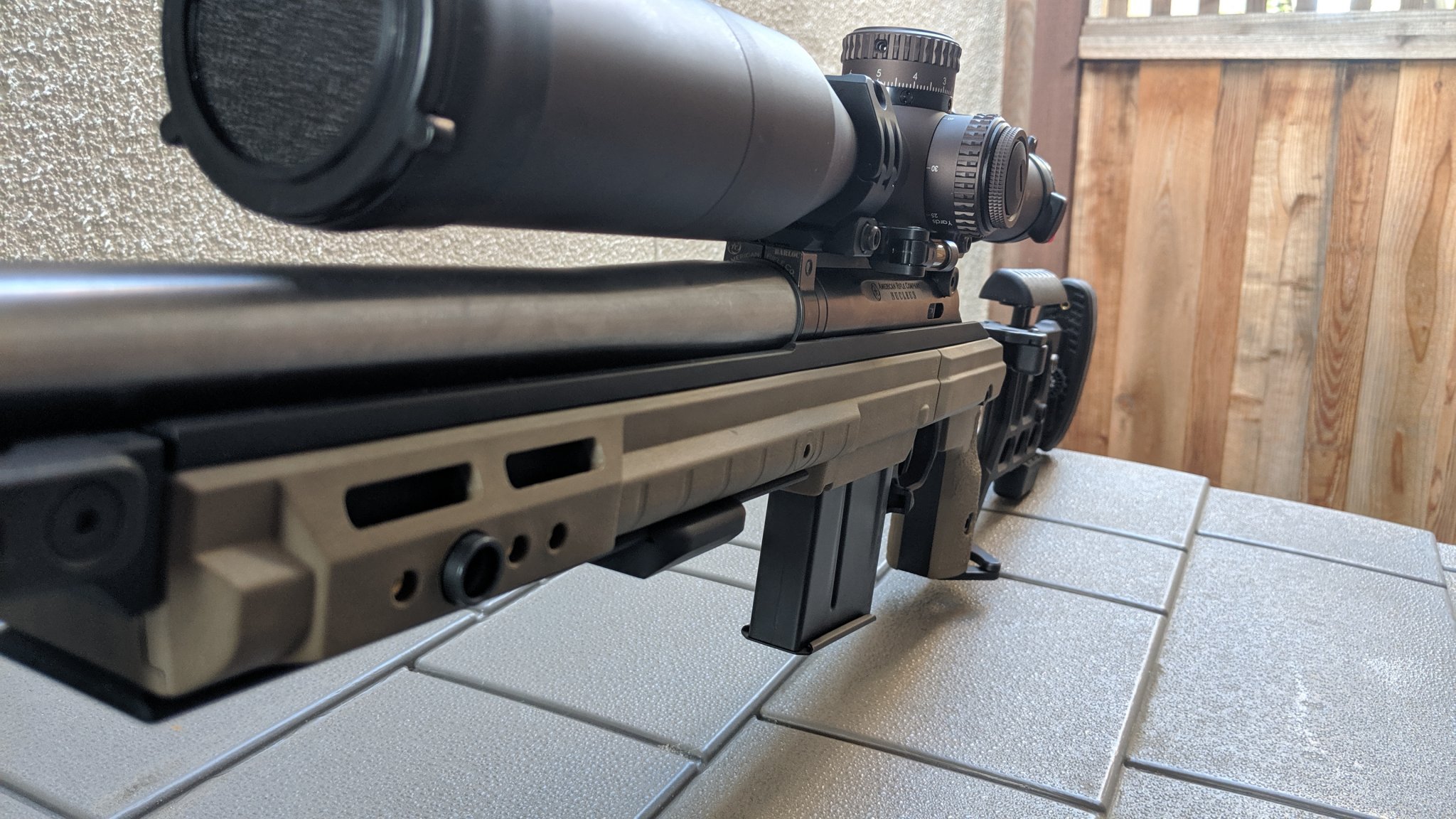

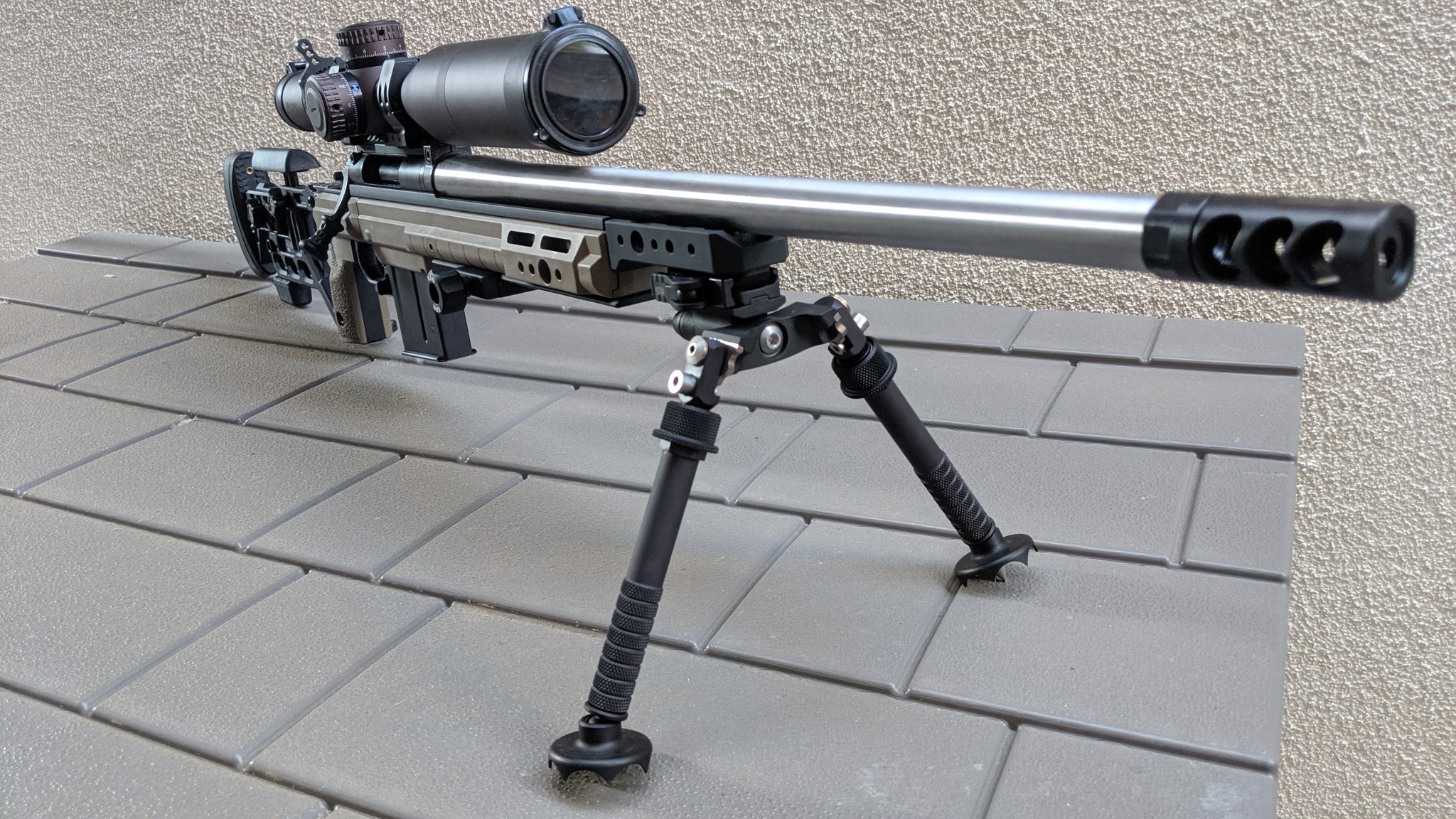

I'm going to go with an MDT ACC chassis. I saw one in the thread, anyone else fit the Nucleus in an MDT ACC chassis and have any comments on fitment?
Also looking at different triggers. I'd like a 2 stage trigger, so looking at the Bix N Andy. TT isn't out yet (but might be by the time I actually need it), I have other Geissele triggers, did they fix the R700 trigger for use with the Nucleus?
giving the thread a bump- slowly working towards an ARC Nucleus build. I had ordered a JH from PVA but put the deposit towards a 6.5CM barrel. That will arrive Saturday.
I dropped my Nuke into my Buddy's ACC temporarily to compare the fit vs his Ultimatum Deadline (he was having issues). From what I remember, there weren't any notable issues with the Nuke. Mind you we didn't fire it or cycle any dummies through it, but as far as the drop in fit went, it seemed fine. Mine has lived it's whole operational life in a KRG Bravo with no issues, including with a Barloc installed. This would be with the current KRG backbone.

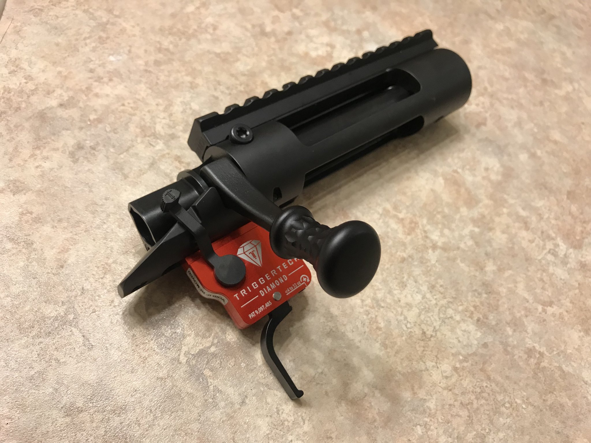

Only trigger I have experience with is the TT Special and have the 19lb firing pin spring installed. No light strike issues after 350 rounds using Factory Hornady and Federal match ammo and 205M primers in Alpha brass. This includes hunting down to 0 degree weather with blowing snow. Not the most helpful answers, but hope it helps nonetheless.

I just picked up an ACC and thought about putting the Nuke in it.
I don't see why there would be any issue as long as the ACC is cut for a 700 pattern rifle.
I have a Gesseile SD-E trigger in an AR and love the two stage so I went with a Huber as I picked up a cert off a prize table. It's a damn nice trigger.
But, recently pick a TT Diamond, and hot damn is that a nice single stage.
Switching to a single stage may take some getting used to, but may very well be worth it.
Only more rounds will tell.
I ordered the 19 pound spring for mine and I will get the occasional light strike if I don't keep the firing pin and spring clean. Now I run it dry just to avoid it collecting grime and it seems to work well, but I clean it every few hundred rounds, which is a PITA.
I’m curious as to why some can run 16# trouble free(me included) and others have issues.
I went back to the 19# just for piece of mind.
me 2. i had some issues at first last year, but i realized a big part was my primer seating depth. i was seating them too shallow. Deepened it, problem gone. i think the trigger pairing has a lot to do with it.
