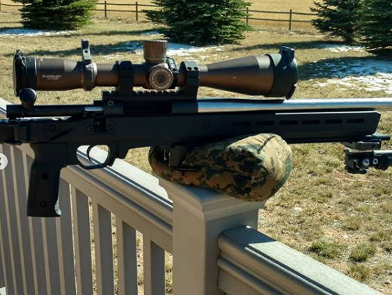

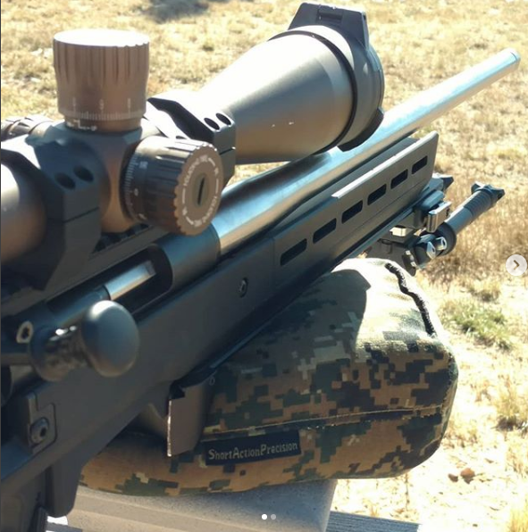

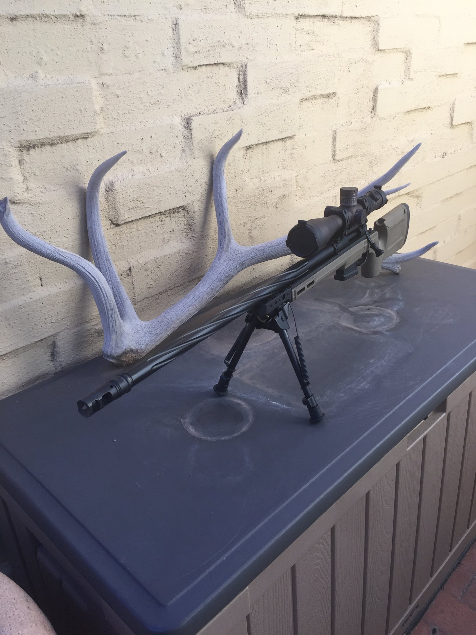

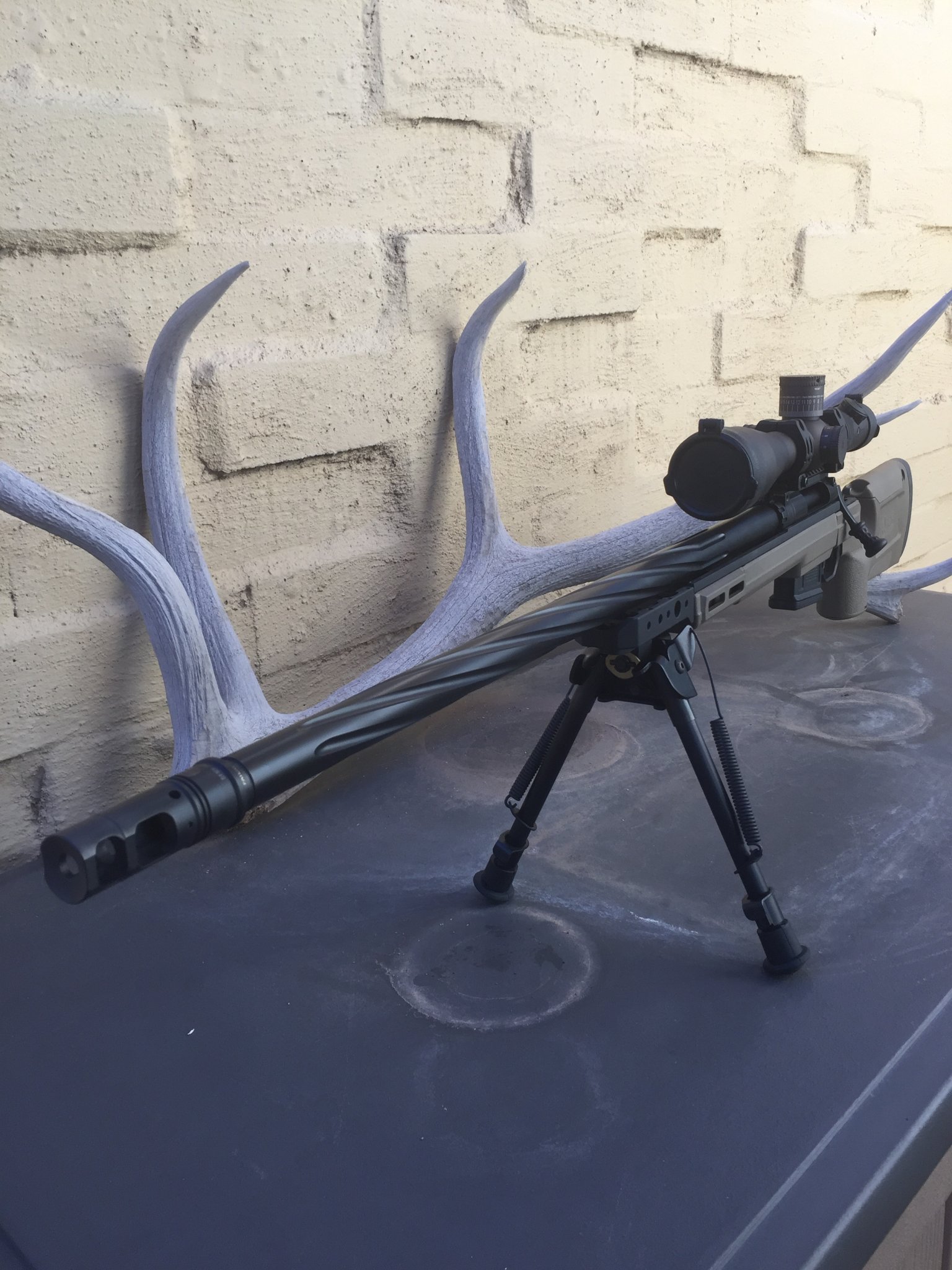

The world could use more rifle pictures and less bitching about order numbers. I've had my action now for a couple months. I have about 300 rounds threw mine so far. Definitely a huge upgrade over my RPR. I have shot a couple club matches with it and took 4th in both of those, only being off the top by a few points. PVA spins up a hell of a barrel!
RH SA Nucleus .308bf
PVA 6mm Creedmoor 25" Medium Palma
Magpul Pro 700
ARC Mags
Sawtooth rail for 15" seekins handguard
Area 419 barricade stop chopped up to move further back towards magwell
Huber 2 Stage - 0 light primer strikes with factory and handloads
Love the chassis, only problem is upward pressure on the mags binds up the action. I am trying to help it with the 419 barricade block.

That's a common problem using AICS magazines in almost every chassis/DBM and action combo out there. It usually requires fiddling with the feed lips (trimming and/or bending) to eliminate the problem.
I can not bend the feed lips or file them down enough for this problem. I have tried bending them out. It would take probably close to 1/8th inch to come off the feed lips to get it low enough. The bottom two lugs on the Nucleus bolt hang out just a little too far for how this chassis positions the mags. There needs to be a mag stop with this particular setup to fix it right, I believe.
I am by no means trying to stir anything up and am pretty happy with it so far otherwise.
Taz, have you tried other mags? I’ve got 4 accurate mags for mine. One of those mags binds the bolt when pushed up. The others don’t.
There’s a lot of variables that play into this of course but if you haven’t tried another mag type it may not hurt.
I have been meaning to try an accurate mag, but haven't yet. I'll have to get one rounded up soon. I have tried two different ARC mags and the magpul aics that came with the chassis.

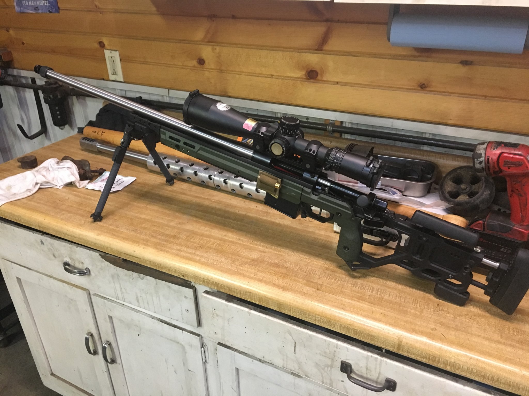

Finally done for the most part. Still waiting for my Rockcreek barrel but it’s still a ways out. Had some issues with getting it but it’s all good. I had this backup we Barloc’d on. To the range in the morning.
