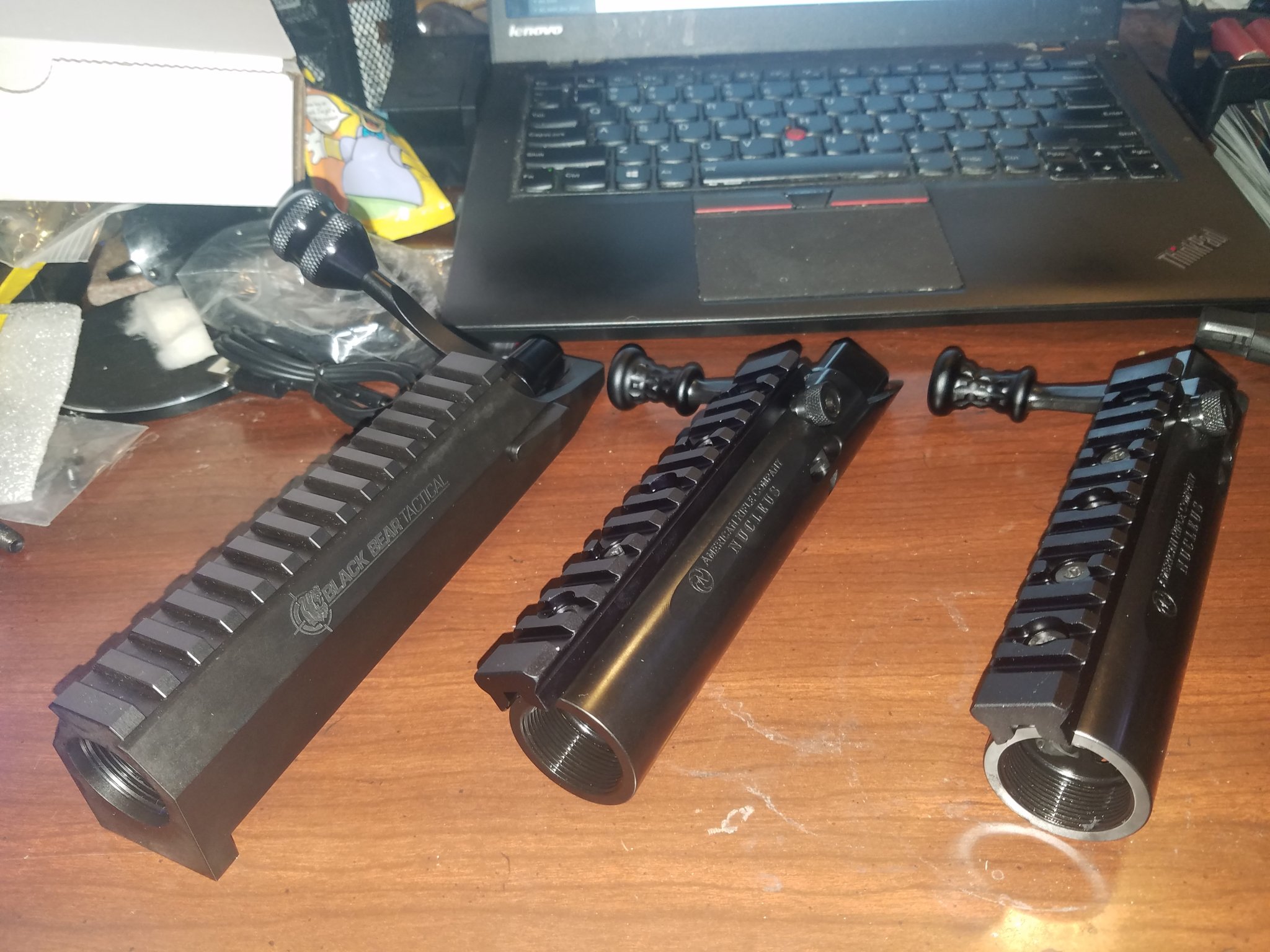

Like Christmas today. FFL received my 2 nucleus actions and a kelbly black bear...
