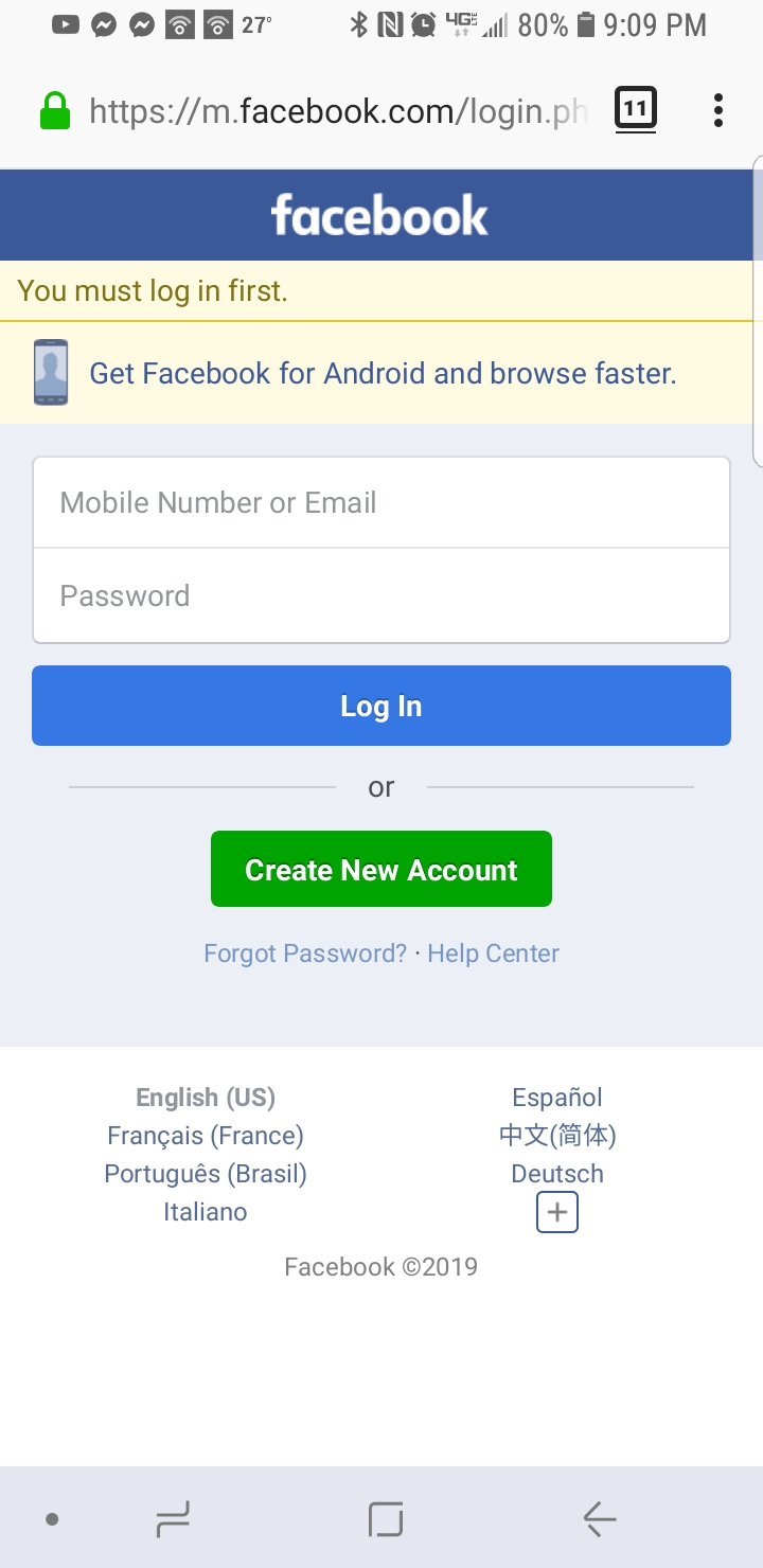

Any difference is bound to be subtle is my guess when running it full speed. Running the bolt in person I "think" could feel a minor difference, besides the obvious extraction cam that does not exist with the Archimides. I can tell you sometime later this year though....
This is what I see when I click on it.
