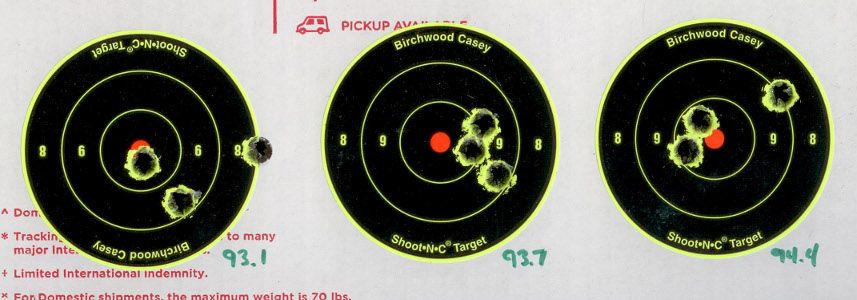

OCW workup today. I've shot the 250 gr Berger hybrids before after a quick load workup, and thought I'd revisit them today.
This was out of a 338 Lapua Magnum TRG-42 with 1x12" twist.
New Lapua brass, Redding neck sizer only with a 365 bushing. Fed large rifle magnum match primers. Retumbo powder.
Berger's web site lists 86.5 as minimum charge and 94.0 as maximum for Retumbo, so per the instructions on Dan Newberry's web page I settled on 86.5, 88.2, and 89.9 gr for the first three rounds, then 3 each of 91.8, 92.4, 93.1, 93.7, and 94.4
Went to the range and shot the first 3, then the remaining 15 round-robin, from a rest through a chrono to a 100 yard target.

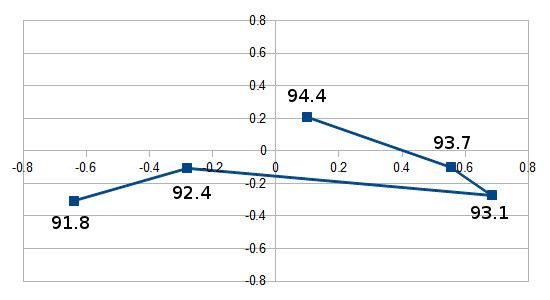

OCW math:

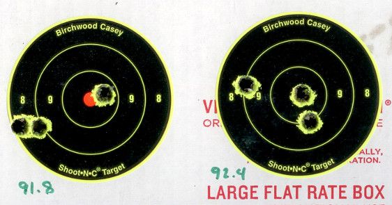

91.8 gr     0.26   0.09  -0.92  -0.51  -1.26  -0.50     -0.64  -0.30    1.64"
92.4        0.00   0.00   0.15  -0.50  -0.99   0.18     -0.28  -0.10    1.31"
93.1        0.04  -0.17   0.51  -0.66   1.50   0.01      0.68  -0.27    1.46"
93.7        0.52   0.23   0.41  -0.11   0.73  -0.42      0.55  -0.10    0.67"
94.4       -0.34  -0.15  -0.18   0.21   0.82   0.56      0.10   0.20    1.36"
OCW graph showing average point of impact relative to aim point:
I know group size is not the point of an OCW workup, but I was still really disappointed with the >>1 MOA groups (except the 93.7 gr group). I didn't feel like I had any fliers. Low wind. After this, I shot 5 rounds of 250 gr Lapua Scenars into a .64" group.
What do you experts make of this? What's next? Thanks.
Your graduations (though I do agree are on the 1 percent scale) are a little large, and therefore the tightness of the groups isn't what it could be.
Your decent group at 93.7 may indicate that there's a good node in that area... revisit that area with .3 grain charge variations and see how things look.
