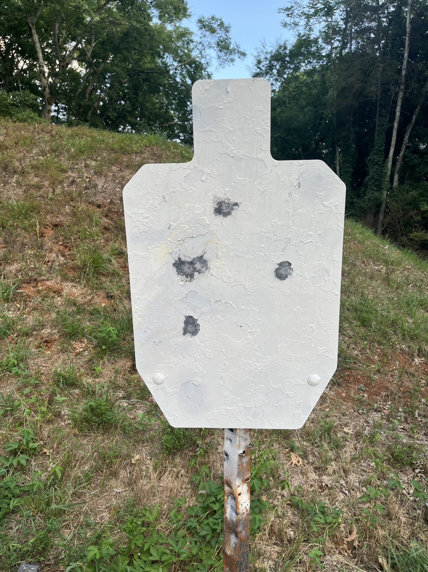

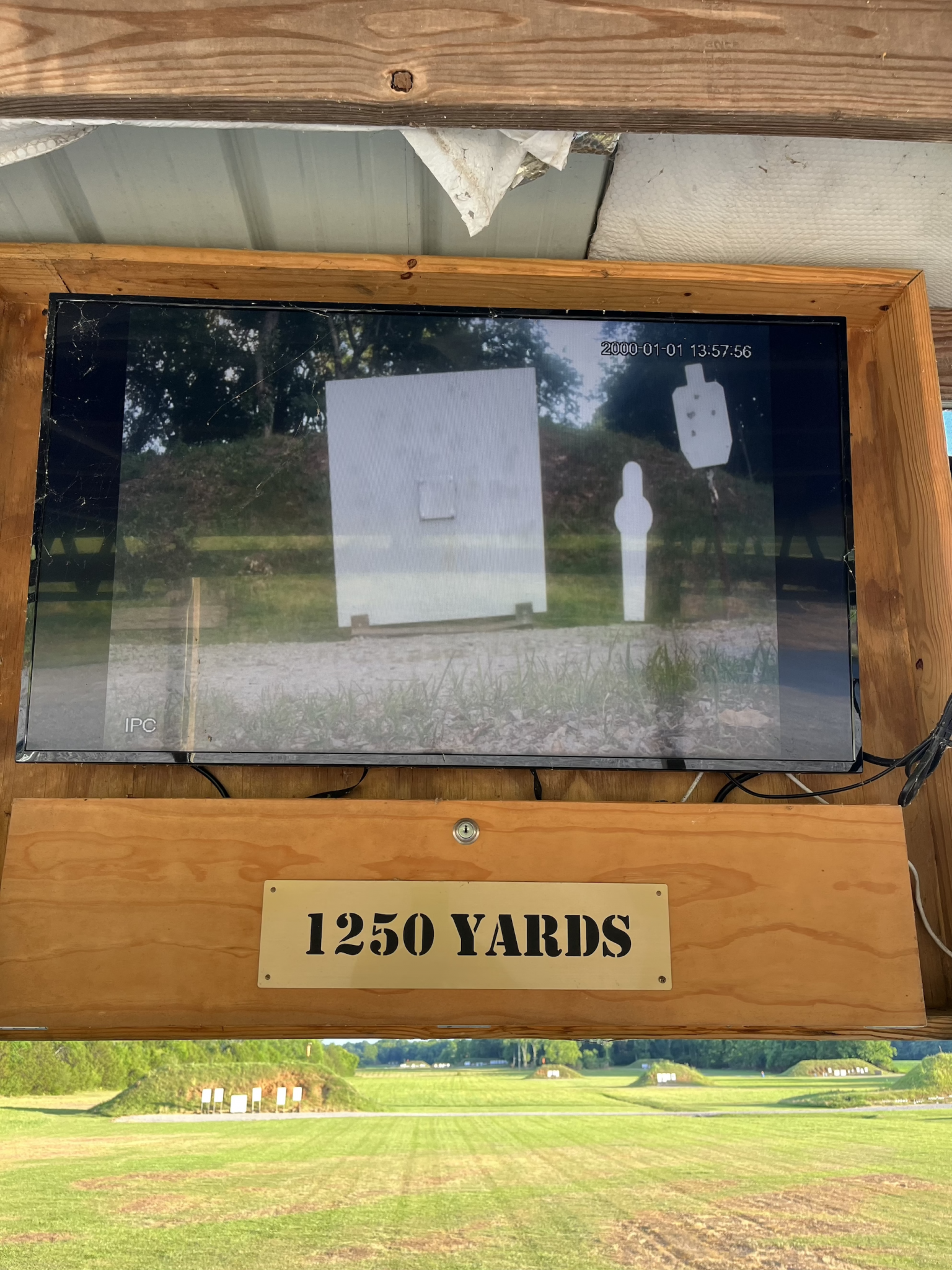

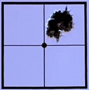

Like with my current barrel, I started with my old barrel's load since they were the same thing (Proof prefits) and I was going to be using the same case/primer/powder/bullet, and that ended up being it...
Zero load development, "picked a speed" (old load), 5 shots at 1250 yards (literally rounds #96-100 down the barrel), rear bag + bipod off the bench, didn't have to change shit:
View attachment 8047186View attachment 8047187
Sometimes you get lucky, even more so when you use good components and have a good barrel. I lucked into 2 loads recently without any development. Once was another rifles load I used because I had some loaded up and it created a nice 3/4 moa 20 shot group, and the other was just a light charge thrown with a Lee PPM to break in a barrel and some brass that ended up putting up sun .5 moa 15 shot group (profile pic).

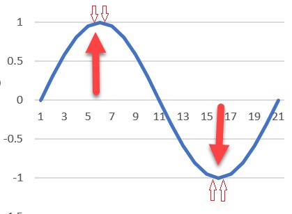

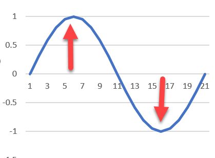

Going back to the discussion on statistics and sample size too many are misunderstanding the point that Hornady and Kieth Glasscock make in its application of testing. In the real world where we test for applications to either modify production, testing for damages related to performance of equipment, or designing a test to determine the effect of a change in some variable, we have to consider the sample size to ensure that the results have the desired confidence. The confidence required determines the sample size of the test.
One of the worst examples of testing was Scott Satterlee's one shot ladder. The following is attributed to Scott from the 6.5 Guy's site
“I start 1.5 grains below my max load and load 10 shells ascending by .2 gr. So for the Swedemoor, 50.0, .2, .4, .6, .8, 51.0, .2, .4, .6, .8, 52.0
Then I will shoot these over the chronograph and look for the nodes. A node will be a velocity flat spot where .4-.8 gr of powder doesn’t move the speedometer much. This example with Reloader 26 in my 6.5 Addiction with 140 RDFs, the flat spot is between 51.2 and 51.8 grains -velocity went from 3025-3033 fps. So, .8 grains of powder added a total of 8 fps. Therefore, the middle of my node is 51.5 grains."
In this example with .2 grain increments he was expecting to find velocities that varied by 6 fps or less with an instrument with an accuracy of +/- 3fps and to find it with one shot when loading a round which will have a standard deviation greater than 5 fps. Statistically detecting what he intended was impossible. There is too much uncertainty to find the perceived flat spot.
We can shoot 3 shot groups with a chronograph and the average will be somewhere in the ballpark of the true average but the standard deviation is a crap shoot. Making a decision on whether we are at a velocity we need is probably OK but thinking that the standard deviation is meaningful is "BS". Using that mean velocity for ELR will likely be incorrect and its likely we will blame the ballistic coefficient when the error is likely to be in the velocity or zero, depending on how we have determined these values.
Similarly we can shoot a three shot group for zeroing and it will get us close or it might get us spot on but we really don't know. Often we may actually attribute a zero error to scope drift when in reality it lies in the uncertainty of the zero due to a small sample size. Insufficient data leads to a probable wrong conclusion in this case.
If we are evaluating consistency of our reloads then we are trying to understand the standard deviation. By definition the standard deviation does not fit a normal distribution like the mean (average). it is bounded by zero on the low side and it fits what is called a Chi-Squared distribution. To develop confidence in the standard deviation it takes a significant number of shots. When someone says they have a standard deviation of 8 fps that number has a confidence interval associated with it. For 3 shots that range is 4 to 50 fps. For 5 shots its 5 to 23 fps. For 10 shots 5.5 to 14.6, and for 20 shots it's 6 to 11.6 fps. If the reloader was looking for single digit standard deviation for his handholds he would be very unlikely to have it from the 3, 5, or even a 10 shot group. Even with the 20 shot group there is only a 75% confidence interval. This means that if an infinite number of 20 test were done on 75% of them would be in the range of 6 to 10 fps. This type of behavior would also apply to the standard deviation of the various radii in a group for determining mean radius.
SO DO NODES EXIST OR NOT?
There is a lot of "data" and analysis that seems to indicate that "nodes" exist in some form. Seating nodes, powder nodes and maybe primer nodes? There is is also mounting evidence that nodes per se don't exists. I have seen OCW tests on rifles where the POI did not move of a significant range of powder loads. I also know that my 223 and 308 show a definite "node" for a given seating depth. The OCW method usually depends on 9 shots to show what we refer to as a "node" with 3 different charge weights. As an engineer, I know that barrels vibrate and it can show up on target. That is a fact. Heavy barrels will vibrate with a smaller amplitude than lighter barrels, hence less effect on POI. I'll take that as gospel. I cannot put together a theory as to why a small change in powder charge in a reasonably full case would yield a significant change in velocity standard deviation. Do seating nodes exist? There is a test that is published on the subject on the Precision Rifle Blog that shows a definite defendable correlation, at lest for the bullets and barrels tested.
My personal untested, unverified opinion is I believe that nodes exist for barrel vibration that is more pronounced in thinner, lighter weight barrels and that changes in seating depth and powder charge will affect this. I also believe that for a given powder charge there is a seating depth that will find the barrel node. That is, the node concept does exist but our interpretation of it is likely in error, and one of the sources of that error is too small of sample sizes.
This may be similar to the proverbial question in physics, is it particle or wave? And the answer turned out to be Yes!

Suppose I say that I want 2700 fps, with 175 grain SMK bullets. I can demonstrate that, in my rifles, a 2700 fps load won't shoot well where a 41.52 grain load will shoot well. In my rifles, 41.52 grains gives the best accuracy with good brass life. I honestly do not know the velocity and I do not care. I care about accuracy. Adding powder to hit some arbitrary velocity number while ignoring the accuracy is silly - there is nothing magic about 2700 fps. There are probably several (3 maybe 4) velocities that will shoot well in my rifles but there are many many more powder charges and corresponding velocities (and barrel times) that will shoot poorly.
For a given powder charge, bullet, case, and primer - you get different barrel times. The speed of sound in steel is about 18,000 fps. Gordon's says that my 308 load in a 26-inch barrel has a 1.35 millisecond barrel time. During 1.35 milliseconds, the shock wave created by ignition has traveled from the breech to the muzzle and back about five and a half times - the muzzle end of that barrel is waving around like an beer-chugging Irish setter's tail. The barrel is getting longer and shorter, it is twisting and untwisting, and it is swinging vertically and horizontally - all at the same time.
Imagine that you are looking at the muzzle end of the barrel from the side. Suppose that the barrel is resonating only up and down (it is much more complex that that). This is a chart of the direction the barrel is pointing over one full cycle - pointing center, pointing up, passing back through center, pointing down, then going back to center.
I want to bullet exit at the red arrow points
The objective is to have the bullet exit the barrel at the end of a swing. Not in the middle when the barrel direction is pointing straight ahead. Why? Because at the end of a swing the muzzle end of the barrel has to decelerate, stop, then accelerate back in the other direction. I want to bullet to leave when the barrel stops swinging. Apparently, in my rifle, at 1.35 milliseconds from ignition, the barrel is approximately at the end of a swing and, for each shot, pointing in about the same direction so I get good groups.
If I add powder, the barrel time drops to say 1.30 milliseconds - 50 microseconds sooner. At that time, the barrel may be right in the middle of the swing. In the middle of the swing, the barrel direction changes the fastest so even tiny differences in barrel time cause bigger groups - notice the slope of the line around 11 on the chart. At the end of the swing, the barrel direction changes slowly or actually stops for an instant. I think that if the bullet leaves the barrel when it stops swinging, I get the best groups. So the trick is to find the powder charge that creates a barrel time that matches when the barrel motion is at a minimum. I do that with ladders.
Laugh if you want but that's my theory, it works for me, and I'm sticking to it :)

As I pretty much agree with all that you're saying, ideally we want the bullet to leave when the barrel stops at the anti-node of that wave. But, that would require each shot to have exactly the same velocity . . . and a lot of effort to find the exact timing. So, to be clear, we're trying to get as close to that as possible within a period of that time at the apex of the anti-node (like I indicate with the two arrows). The flatter the wave, the flatter that area . . . which is one of the reasons why heavy long barrels with their lower frequency makes it easier to tune a load than light thin barrels.😵‍💫 :sneaky:

Yeah, the barrel's oscillations are complex, yet . . . like in a "complex" sine wave. Minimal dispersion is certainly the goal for all of us. Sometimes I feel like we're all talking about the same thing, only describing it in a different way??? 🤷‍♂️
No habla on the "anti-node" lingo. I think about it this way - at your "two arrow" spots the barrel points down or up. And for some significant period of time - like the distance between those double-arrows - that direction does not change much. However, move the arrows around to 11 on the x-axis and, during the same time interval, the barrel direction changes a lot. As we increase the powder charge, the muzzle velocity increases and barrel time gets shorter. At the arrow points the barrel direction is more stable for a longer period of time. The range of powder charges that produce that barrel time (and velocity) is wider than it is around 11. According to my made-up theory that explains "nodes". The velocity isn't the same (it makes no sense that it would be the same, the powder charge is different) but the barrel direction IS almost the same - barrel direction change is minimized for those velocities.

I'm in that second bunch. I shoot 3-shot groups where each 3-shot group has the same charge. The loading block has maybe ten rows of cases and there is an increased charge from one row to the next - the delta depends on the case size and powder. I am looking for groups that are round and where three consecutive rows impact in about the same place. I stop when I see pressure. When I find one or two sets like that, I reshoot the same three rows to see if it repeats - mostly they do but not always. If it does repeat, I increase the charge range a little (I want to make sure that I identify the bottom and top end of the sweet spot) and reduce the charge increment to 0.1 grain and reshoot. I now have good gun data from that load and from there I usually pick a charge in the middle of the range and load that. I do not use a chronograph. When I have a load that shoots, I shoot it from 100 out to as far as I can go, writing down the ups. I open Applied Ballistics, configure the cartridge then change the velocity until AB predicts the curve I just measured.
Last weekend, I shot 25 rounds at 1k. When the barrel was new, AB told me that the velocity was 2700 fps and telling me to dial 7.6 for 1k. This has been a good setting for about 200 rounds. But last Sunday I had to dial 7.3 in order for my point of aim to match my point of impact. Apparently something changed and the velocity increased by about 55 fps. I don't KNOW that the velocity changed but that it what it takes to make hits so that is what I use.
It has not occurred to me that I should try to find three different charges that gave about the same velocity. I stopped caring about SD and ES a long time ago - I could never get it to relate to group size so I stopped caring about those numbers. I do care about the average velocity number so I can dial or hold but I don't care what the number is, it is just a parameter in the function that gives me "ups" and windage.
