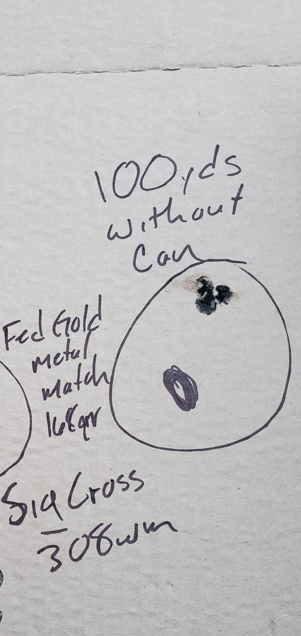

    I was pretty set on a Bergara Wilderness HMR in 308 but actually ended up ordering a Sig Cross in 6.5 since it’s more practical what I’ll be using it for which is a mix of casual LR as well as hunting and I know that they cross that gap very well. I’ve owned a couple fixes and love them and one with a 20” Proof CF 6.5 barrel is my perfect rifle I think but I just can’t justify the price for something I’ll rarely use anymore when I can do the same thing with something that costs 1/3 of the price.
    I can’t recommend the cross as my only time with one is handling them a few times in gun stores, but just saying that’s the route I just went.

    I kept mine stock and sold it for a 16" Sig Cross 308 and like the cross better. The cross is very accurate with factory ammo and has been flawless. I would buy a Cross again long before I'd buy a Ruger, buy I already have a few heavy range toys.
    This is rounds 2, 3 and 4 out of my cross and is fairly typical.
