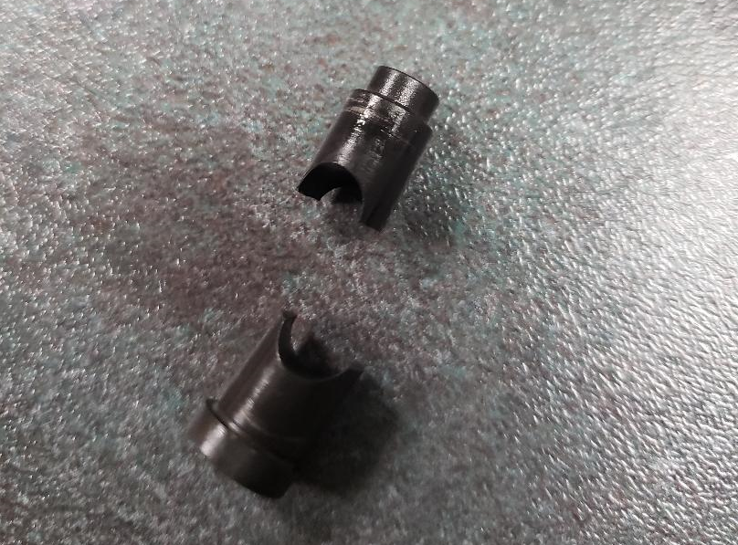

Are bolt head pin cracks a known issue? Four rifles, three were completely cracked. Pulling the fourth tomorrow, I suspect it will be the same. Bolt lift gets noticeably rough and end up chasing 2-3 MOA groups. Brass shows no sign of pressure but firing pin strikes are not center on the primer.
I have an afternoons worth of experience on DTAs. Any ideas?
This happened to me about 2 weeks after getting my SRSA1.
Long story short Desert Tech overnighted me a new pin. I was told they had a batch of pins that were heat treated too long causing them to crack and break like this.
