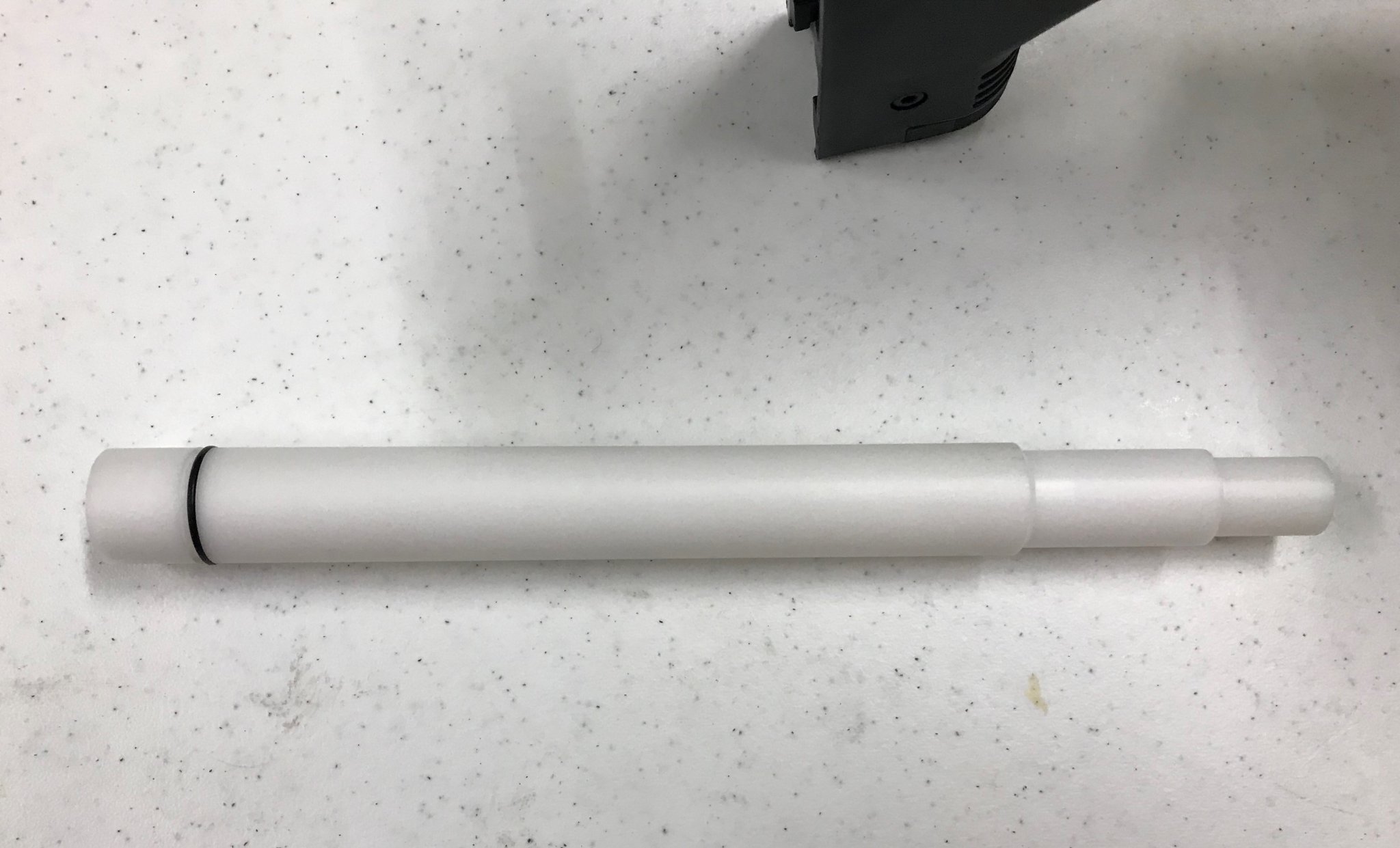

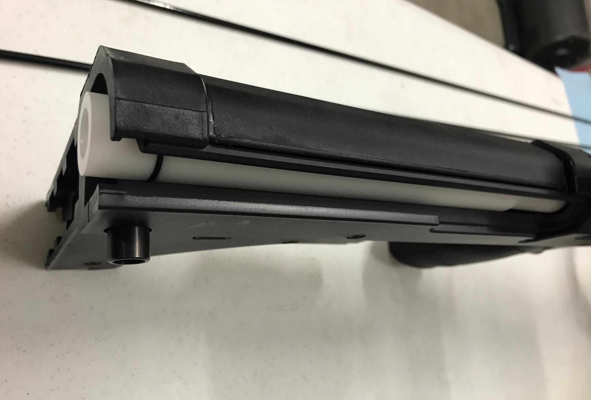

What the hell are recoil spacers?
Frank
I was wondering the same thing for quite sometime. I’m guessing he is asking about length of pull spacers?
Reactions: Edgecrusher

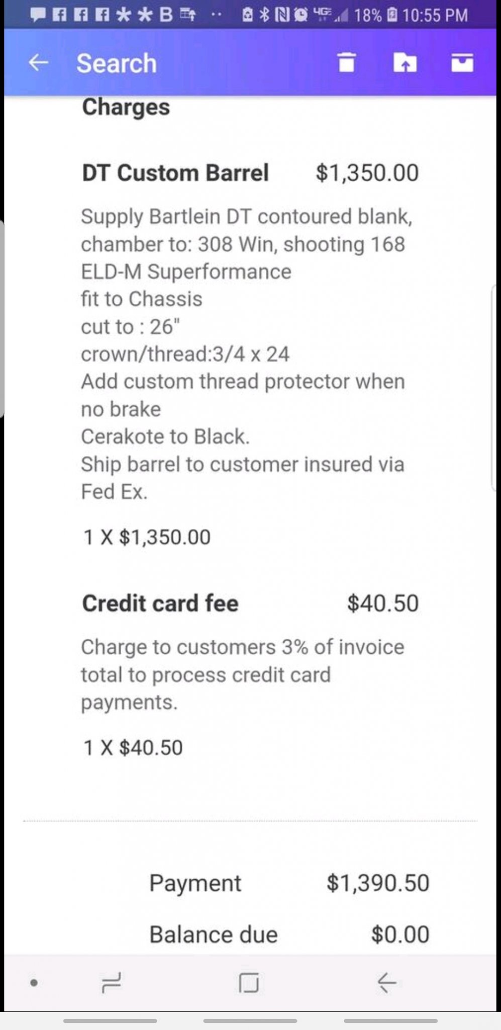

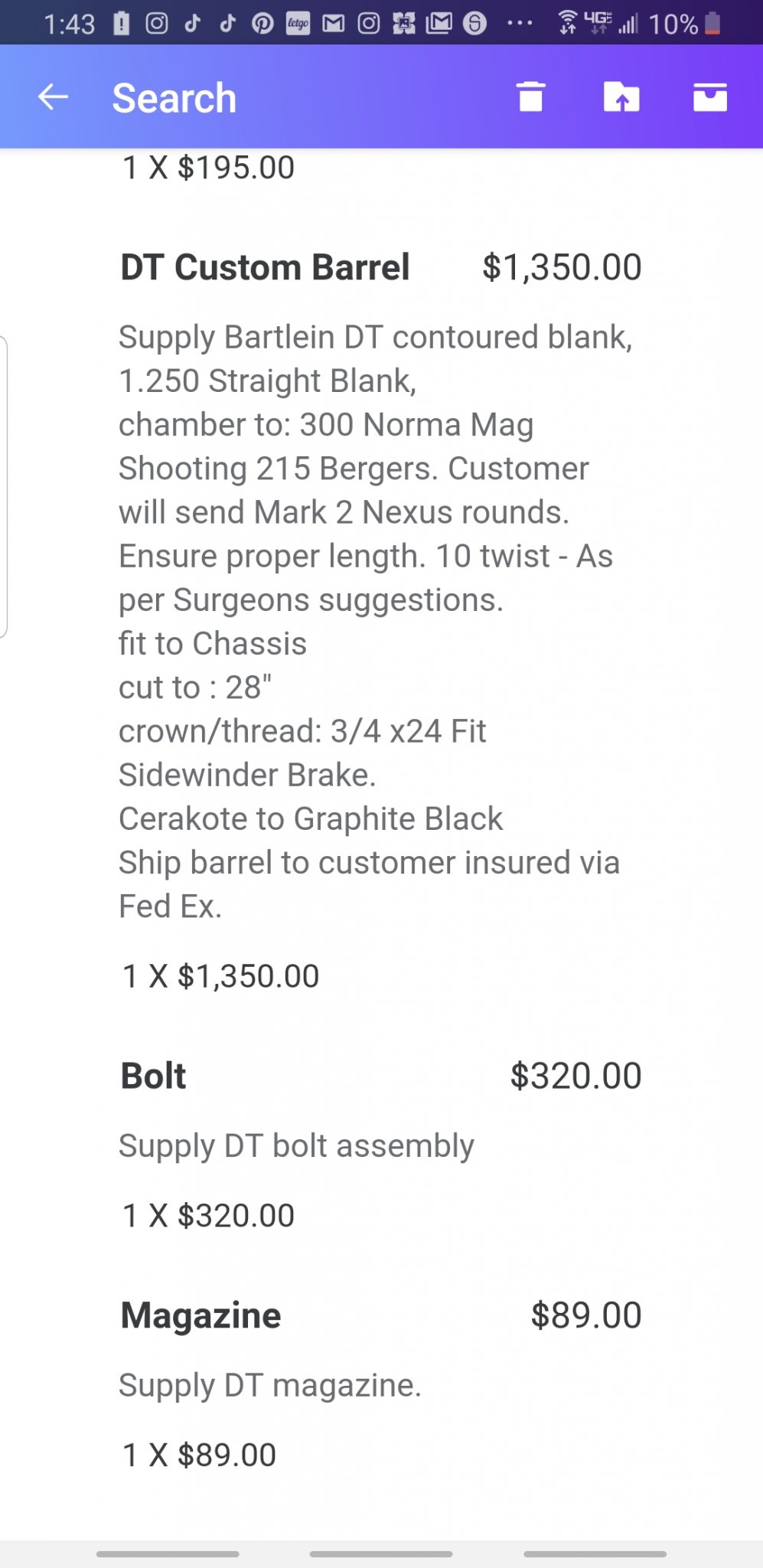

Hey everyone, I'm selling a couple DTS Bartlein barrels. Just built a dedicated PRS rifle and these not needed. I posted them on sale thread as well.
26" .308 shot about 500 rounds. 2,900 fps superperformance ELDs 168gr.
And 26" 300 NORM not broken in. Maybe 10 shots. 3150 fps
Both chambered by Marc @ SAC
1k for .308, area419 w universal adapter included. 3 shot groups shown below
1,300 for 300NORM w complete bolt, magazine and area419 universal adapter
These barrels shoot amazing
