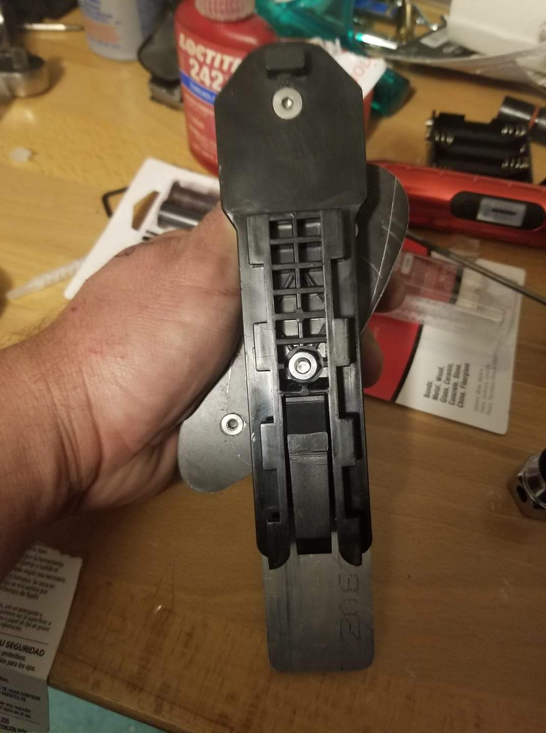

My gen 1 and a number of them that I've worked on and built barrels for over the last 10 years had no issues with mags rattling. Usually the mags were sticky until you got the skins squared away. All the mags in my current gen 1 seem to fit and lock up fine with no rattle or slop. In the Gen 2 A1 I just got the mags are a little floppy. Should be an easy fix if I cared but I don't. I'm not stalking anything. If you are and its a problem you can put something in the skins to take up space and get rid of the rattle.
Adding weight should be easy. Just buy the pieces that clamp on to the accessory rails and bolt some weights on so you can move them around. I find it simpler to just make the barrels heavier and longer. My 33XC barrel is about 7 or 8 lb I think. 32" long and not a lot of taper so its not light. The 338 Lapua barrel is 30i" and big too. Some of the small cal barrels like the 7.5 Swiss are straight cylinder at 1.043" dia from the front of the clamping surface forward. About the only lightweights are the 17" 338BR barrel made for subsonics which is pretty light and the 12.7 X 48 (510 whisper equivalent) which is also 17" and light. Both use aluminum suppressors to keep the weight down too. Lots of possibilities out there to add weight. The tough thing is taking it off.

Mine was a Gen 1 SRS with the pin barrel alignment. My mags didn’t move from side to side but from front to back. It never caused any problems. But was just an annoying feature of my rifle. Kinda like a dash rattle in your car. I love the platform though and miss it. Based on the opinions here it seems like a non issue now. Thanks for the insight though

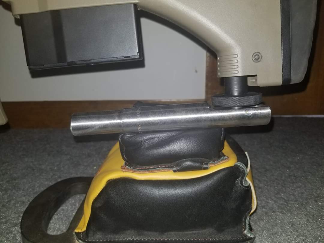

Has anyone ever seen or made a bag rider for the SRS? When shooting my 37xc barrel in the ELR style of static prone, I feel like it could use one.
I’ve had other rifles with riders and they can be pretty sweet and make a positive difference
I messed around with one but ended up scratching the idea. I didn't want to modify the monopod too much and needed a lathe to do what I really wanted to keep it from rotating. Later on I made an adjustable pad setup since I couldn't find anyone selling the guy made on here. I left it long and was going to attach a piece of round stock to it but didn't like the was it turned out.
