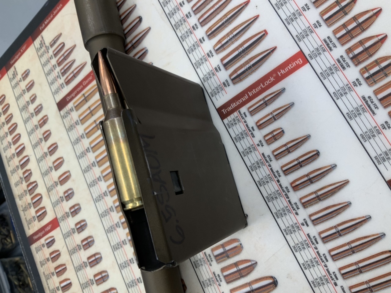

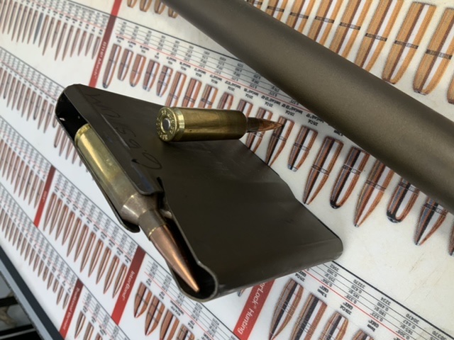

Is anyone running a 6.5 SAUM in an SRS? How does it shoot/feed?
I use a 6.5 Saum in an a1. Mostly that conversion for hunting. Shoots and feeds great. 22.5’’ barrel. Run it suppressed sometimes. Berger vld hunting 140gr around 61 gr of h1000, average 3015 mv. I think that barrel and mag was from tye . I’ll post a couple pics of the bent mag.
Awesome how is H1000 with the can? I hear it cakes up really quickly. Got an A1 on the way from Fred, looking at getting a SAUM bbl from ES in 22.5 or 24.

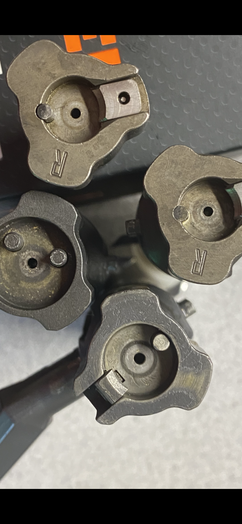

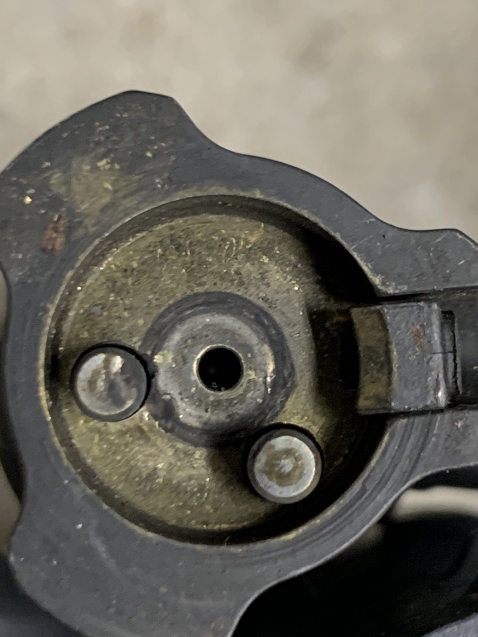

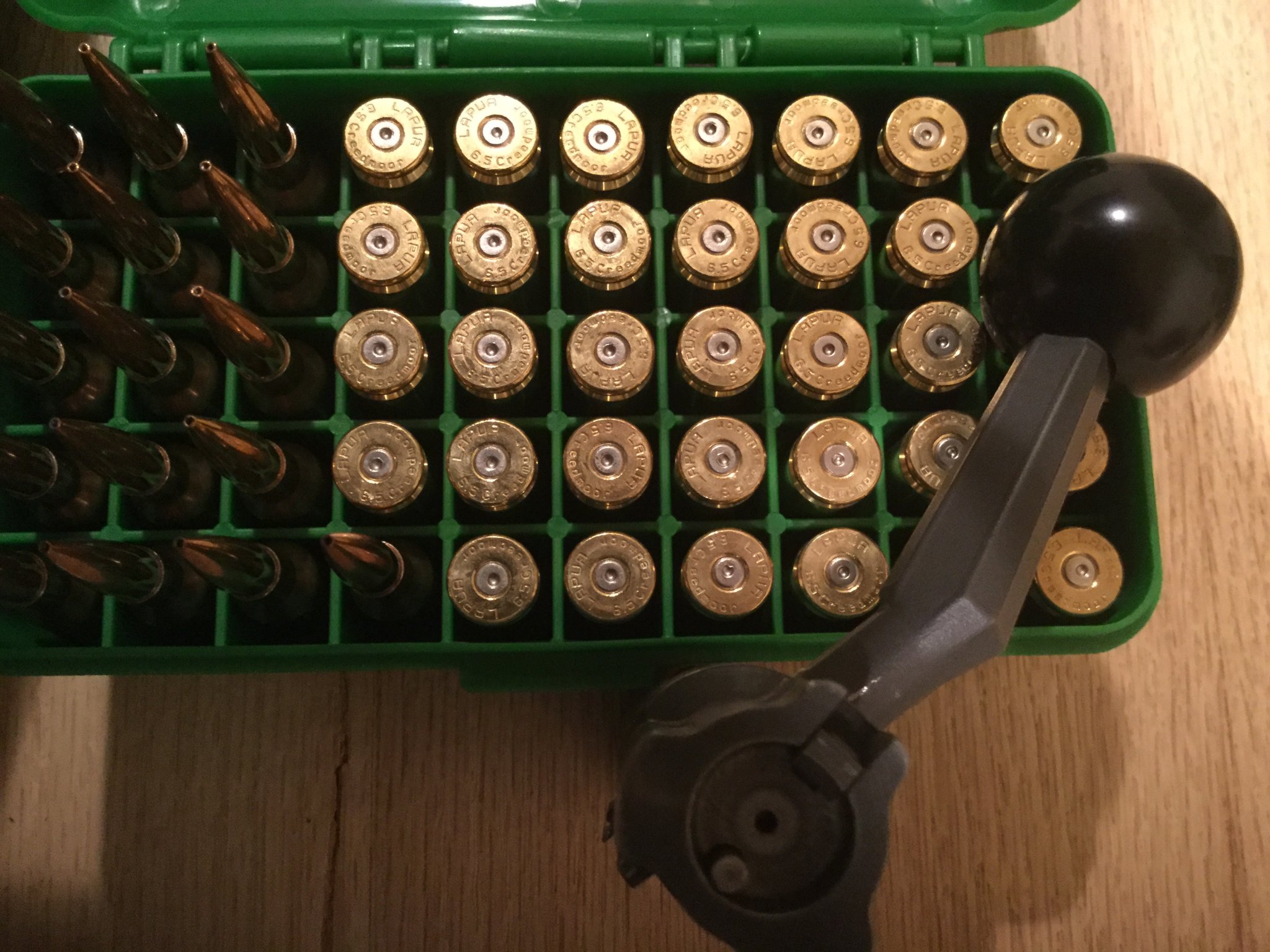

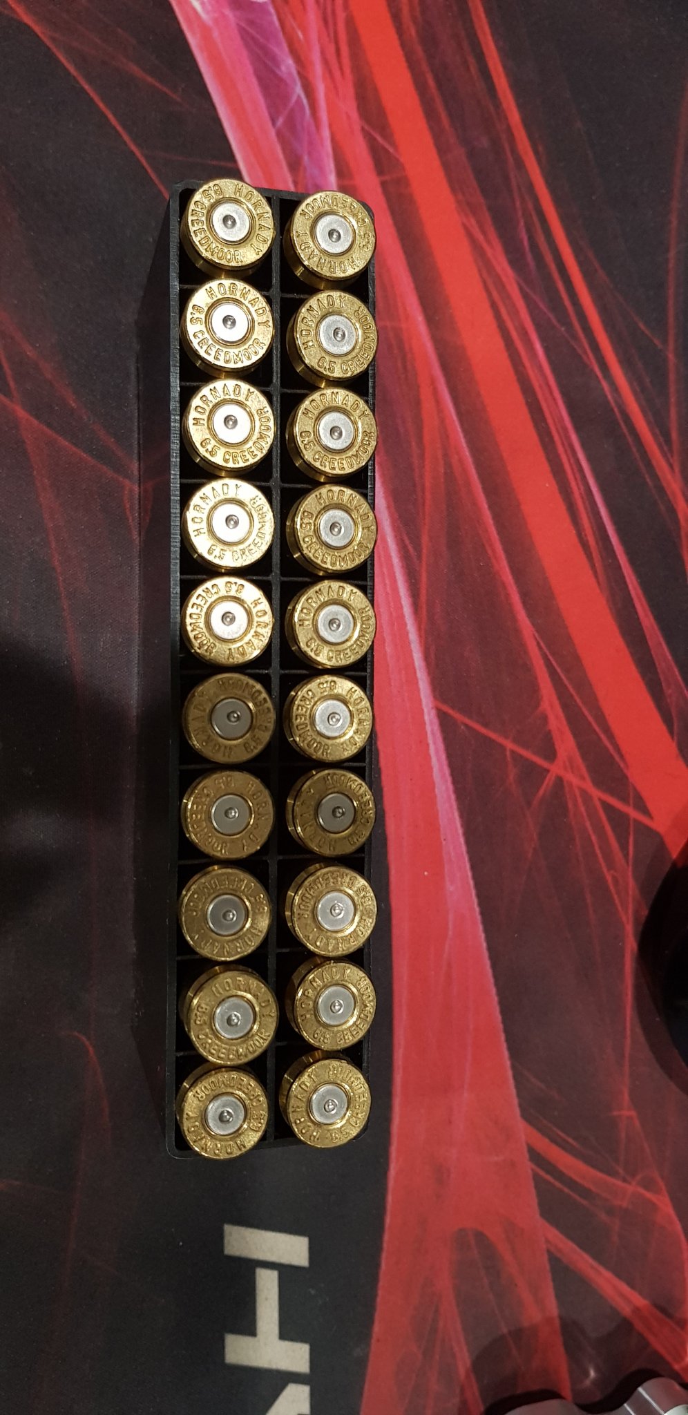

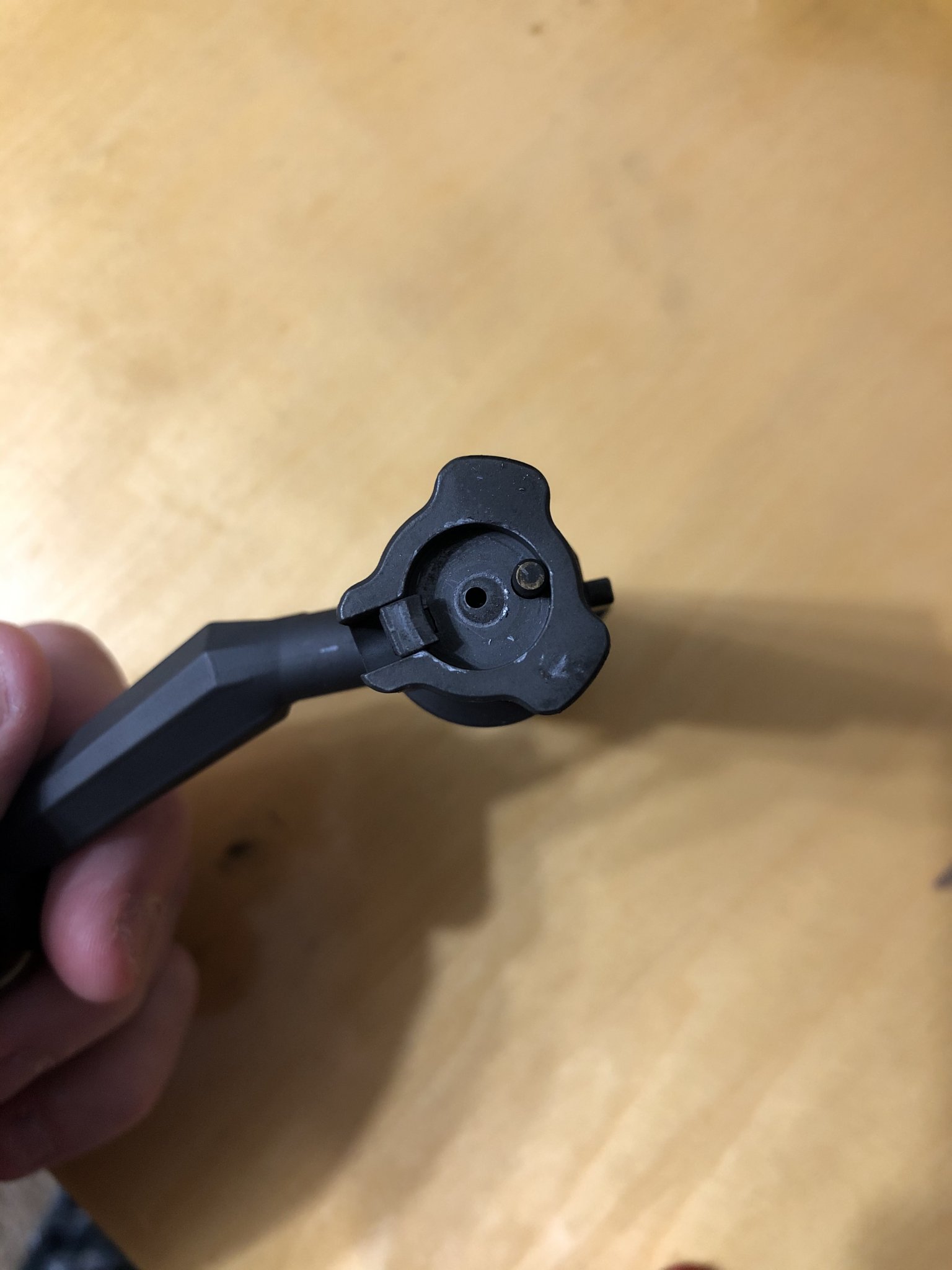

Anyone else have a firing pin hole way off center? Using Berger 156eol ammo and it shot like shit. 1.5 moa at 100yds.
Yep that’s odd being off center but has been mentioned previously On this thread but dont know here. I’m assuming all ammo you shoot the primer strikes are off center, as long as it goes boom and the bullet exits the muzzle it doesn’t matter. As far as the ammo goes I’d mark that up to just not being a good match for your rifle. Berger says minimum 8 twist which I’m again guessing you have since that’s pretty common for the 6.5. Might need to load your own so you can tweak things to make the 156 get the accuracy you are looking for.
I just am a little disappointed considering the cost of the rifle. I'm hoping it doesn't lead to high SD'S.
What factory ammo are people shooting successfully in their 6.5 cm factory barrel?
It's primarily due to the larger firing pin aperture than required and a free-floating firing pin. It was designed this way as to prevent debris from obstructing the firing pin. I don't remember if my primer strikes are off-center, but I always get some cratering, regardless of charge weight. I know primer seating depth inconsistencies can create larger deviations in MV, but I doubt a hundredth of an inch from the center can really affect SD's, if it does I imagine it would be negligible. However, it won't hurt to call DT.
Reactions: Mr. Z

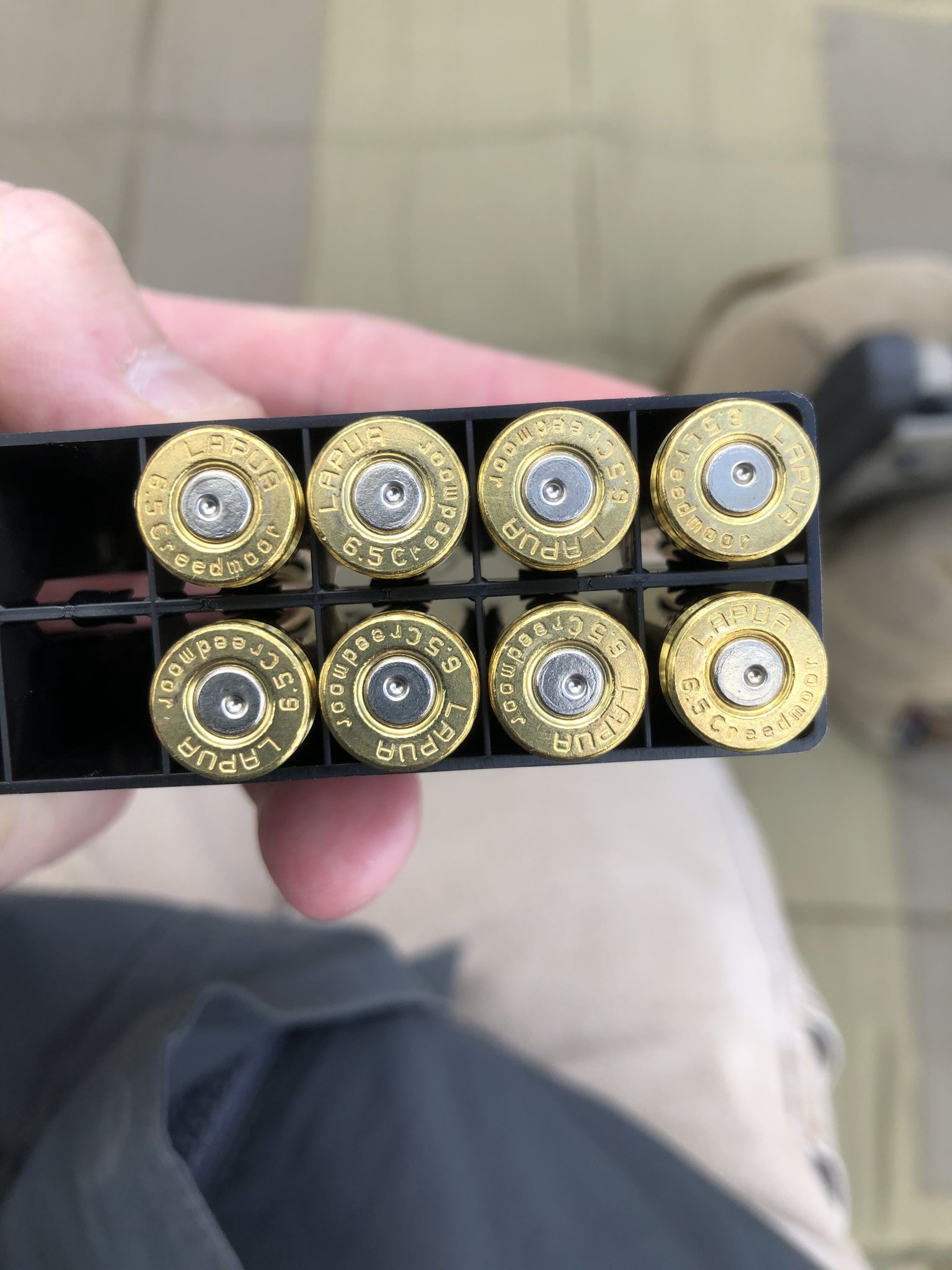

ThanKs for the responses. I'm going to call DT on Monday, hopefully I get to actually talk to someone. Might order a box of their ammo to try out if they say the out of center hole is no problem.... But Idk how this could have passed any sort of QC. You can see how far off it is on the bolt face.

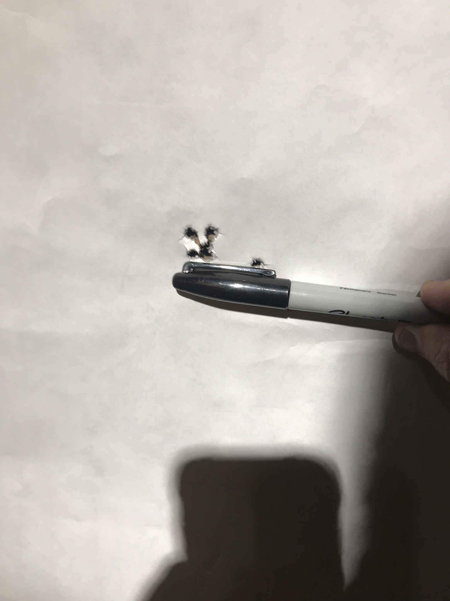

Wouldn't worry about it , here's mine
140 elds

@Reload10 i dont know if this is your first time running the DT or not but they can take some time to get used to the platform .
not questioning your shooting but i would put more rounds down range and learn the system first . you could say my primers are similar to yours . i would clean the bolt face and see if you can actually measure the hole with a caliper .

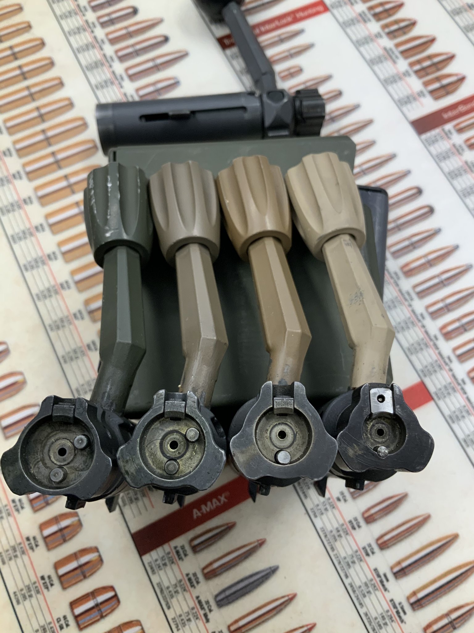

well I checked mine, been shooting this for years and never paid attention to see if primer strikes were centered, they aren’t. My firing pin hole in the bolt face is only a little off center.
bottom line is, I use this bolt on two different 6.5 barrels and a 308 barrel, all three shoot consistent 3/8” MOA. Also have a long action bolt and barrel, primer strikes not dead center but same 3/8” moa. Hard to beat the DT platform for accuracy from a mass produced rifle.
I believe DT will make things good for you, good luck.
Reactions: waveslayer
I don’t recall this subject coming up, and I’ve read all the pages in this forum and what was lost on Scout. Thanks for asking the question, and welcome to the forum. This thread is your best resource on the interwebs, so you’ve come to the right place.
I looked at my bolts and realized my Magnum bolt is off center and it shoots in the .3s. I didn’t notice the primer strikes were off center and I’m sure I would have if it wasn’t shooting well.

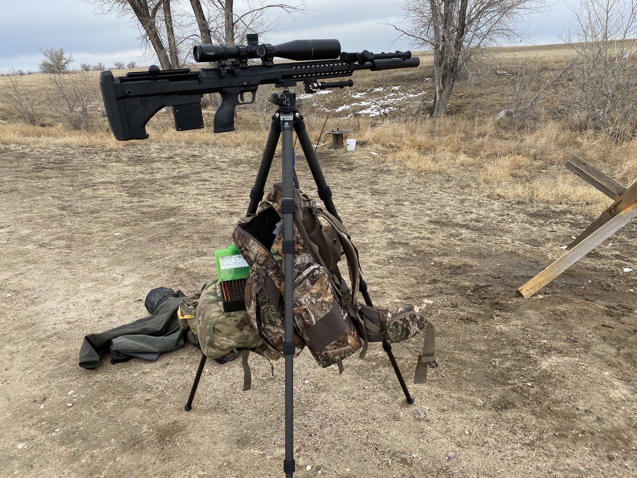

How do you like shooting your DT off a tripod?
Honestly it’s the only rifle I have ever shot off a tripod so hard to gauge. For me it took some getting used to. I found tightening the ballhead slightly lower than the target gets me to a place where I don’t have to put much force one direction or the other and it’s most table for me. Having the butt pad about sternum height gives me the most stabile accompanied with my left hand on the front of the scope and almost no force on the but pad. I can make it work but I’m much more stable on a barricade or tank trap with a bag. The 223 is perfect for hours of practice at a reasonable price.
