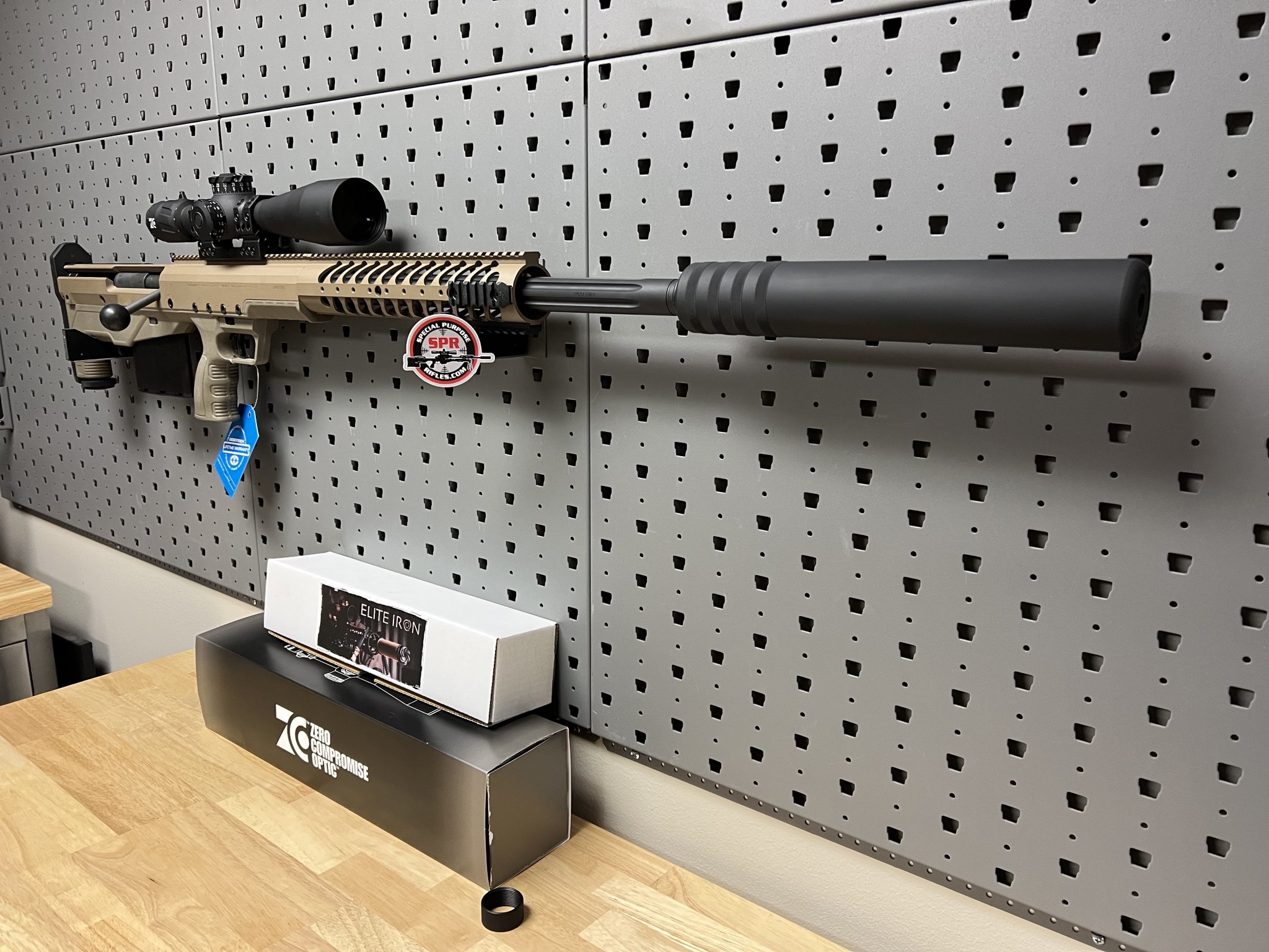

Got my Elite Iron .408 approval last Thursday. Day 251. Hopefully the Alpha 50 gets cleared this week. I done both on the same day October 7th 2022.

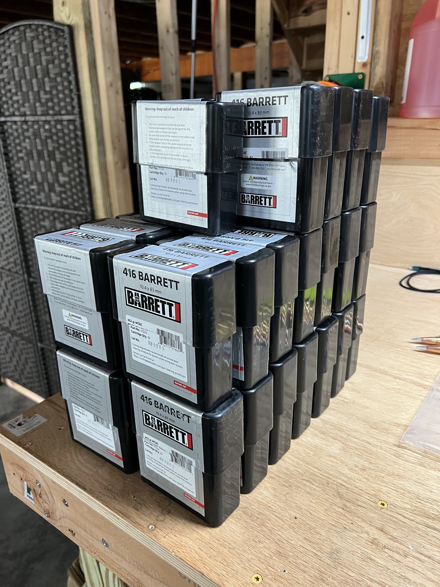

.416 ammo arrived today.. Poor UPS driver was struggling..
LoL, it'll get me through the year and maybe spring... It's hard to find, aso when I do I buy it..
Ha Ha...yeah i know what you mean...

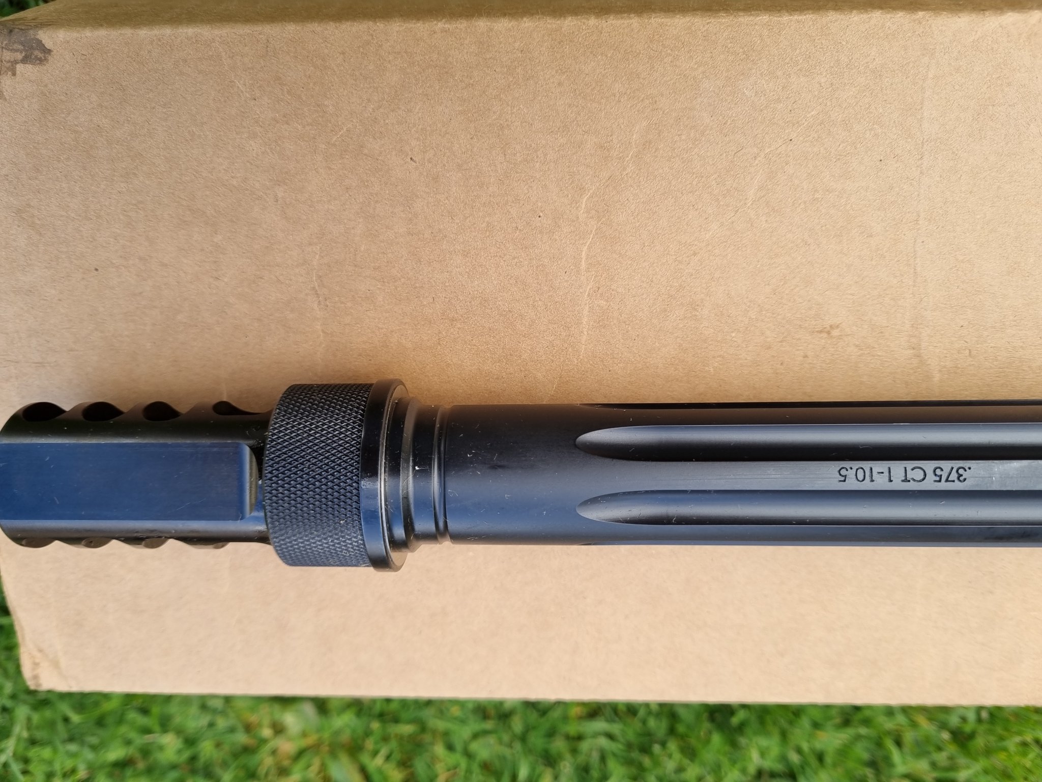

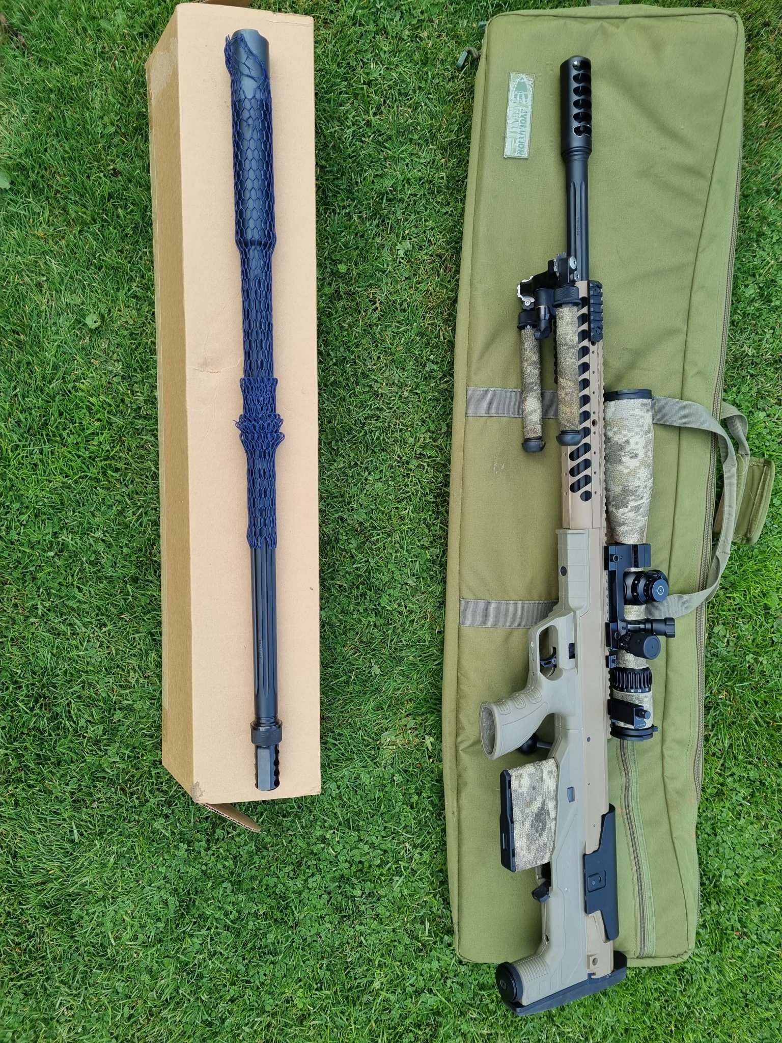

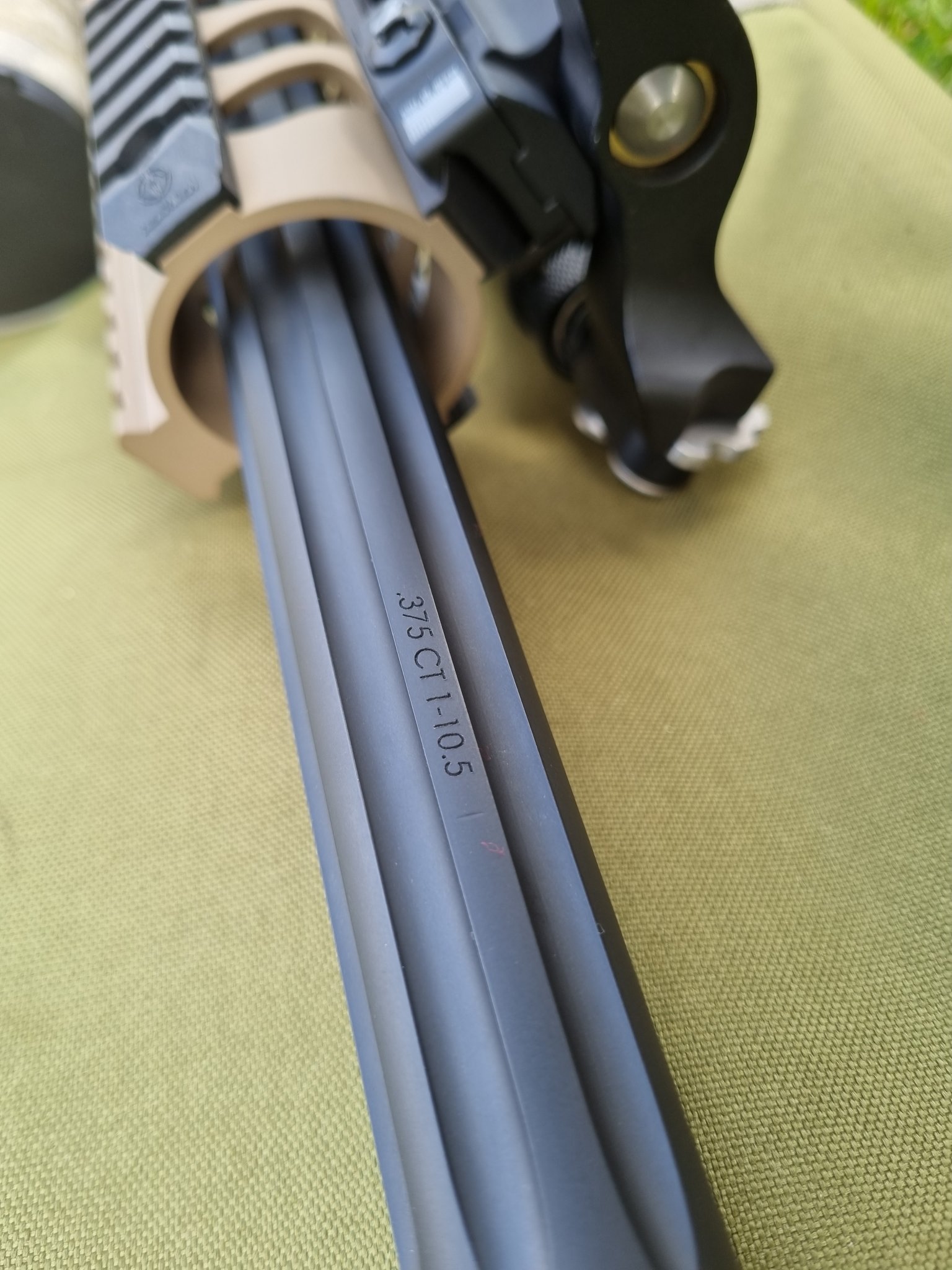

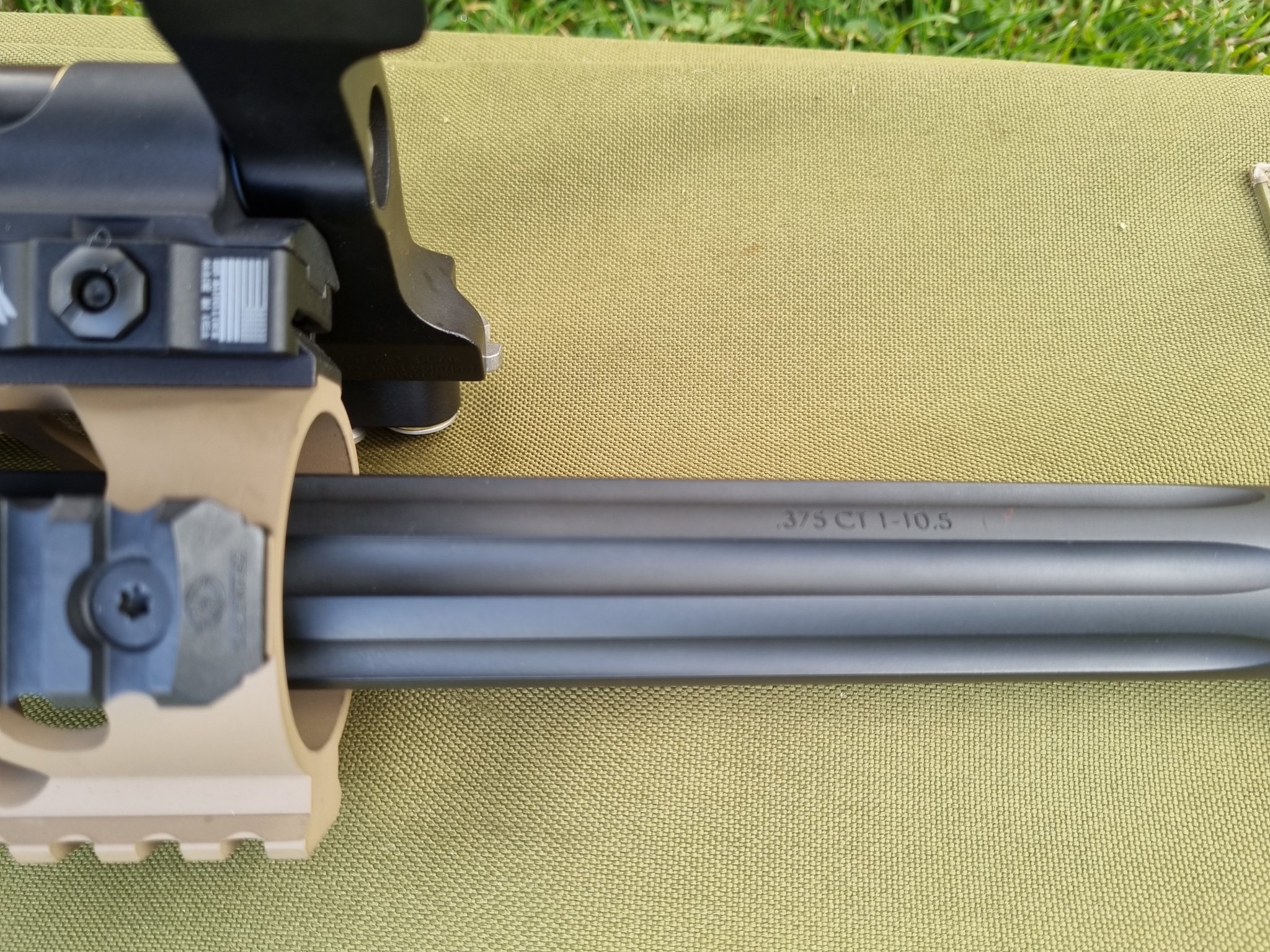

Remove the clamping screws.
Due to how the clamping screws "Pinch" the barrel....any excess clearance will cause the sides to clamp...but! there is the potential for the top yo still have a clearance even when clamped. As in my case the allowed vertical movement of the barrel.
Just remember....even 0.0005" movement at the clamping area will allow the muzzle to move enough to cause huge POI changes.
I agree, that makes perfect sense. When my first chassis had the vertical stringing issue, we figured it had to be something being elongated or oval. Hopefully this is not a future issue with the more rounds put through it. I'd like to get a 2nd HTI.
