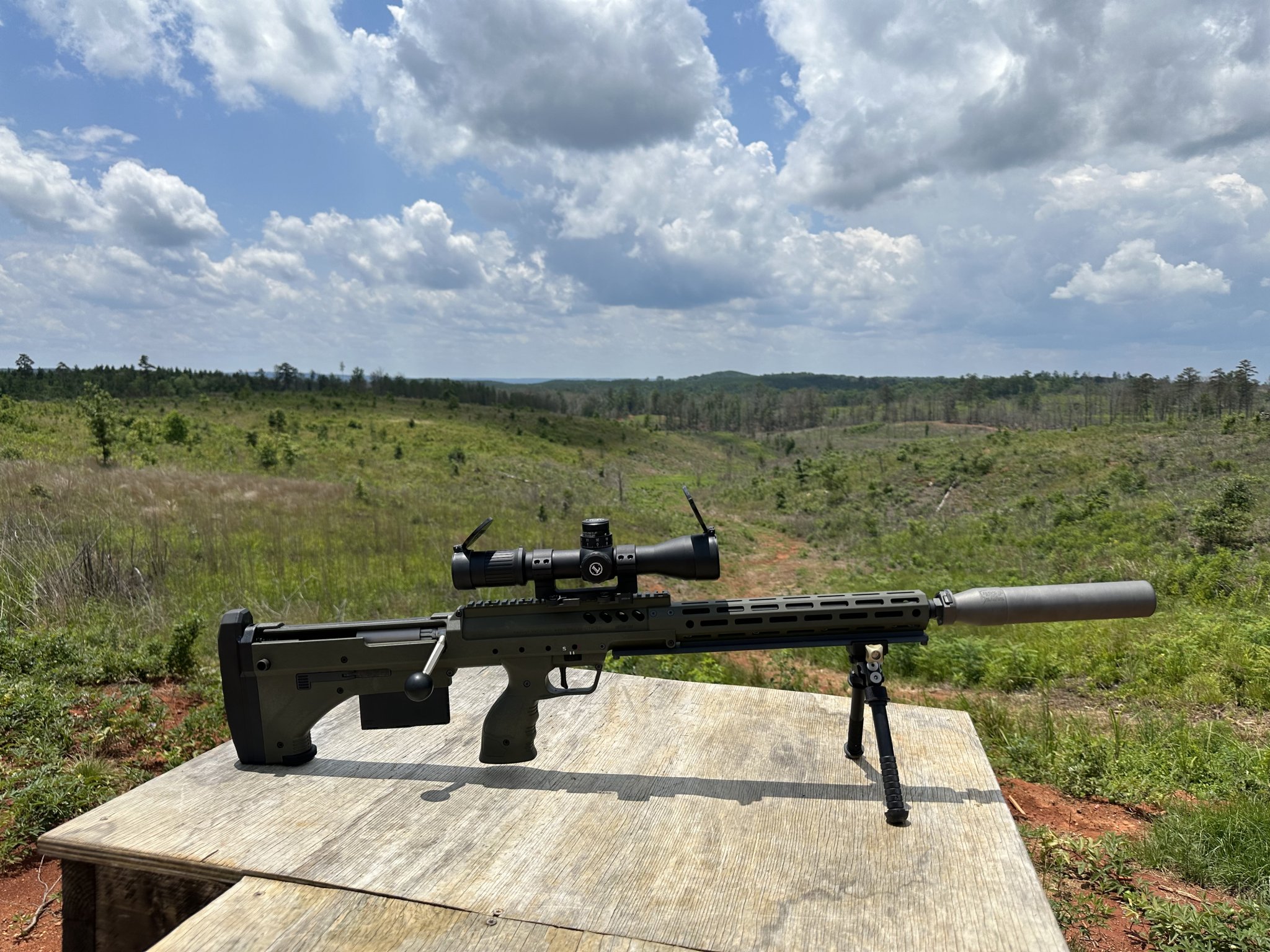

Ended up getting a 22” 6.5 creedmoor without seeing an SRS in person prior.
This gun is fantastic. First bolt action I’ve owned, let alone precision gun. First and second outing I was making hits out to 700 and 800 yards. Seems partial to 142gr SMKs. Special thanks to the guys at Special Purpose Rifles for getting me set up.

I put together a similar build and it's a tack driver. Congrats and enjoy.
Very nice, I’m glad I was able to find an OD green one too.

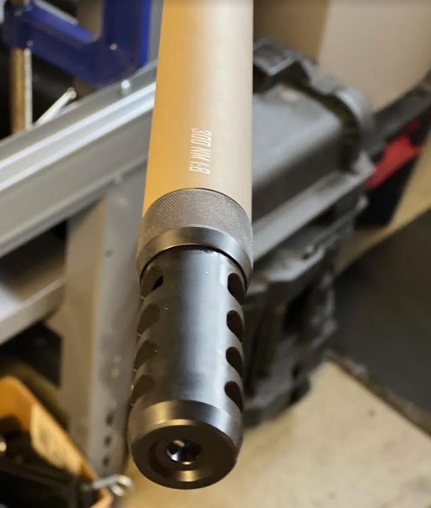

I’ve also used a 1.25” straight to the muzzle taper in my SRS. Was a Krieger 338 off the shelf blank and was a great shooter chambered by ES tactical in 338LM.

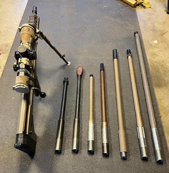

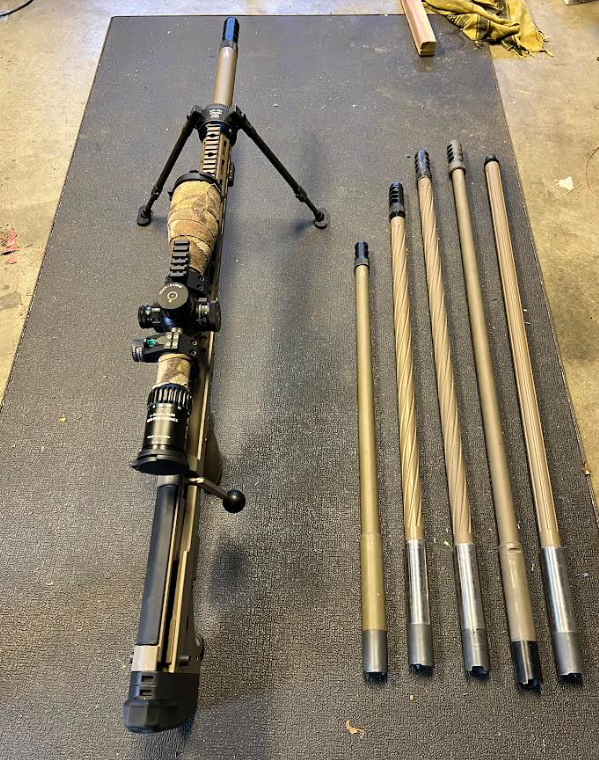

Doing some reorganizing in the garage this morning and took stock of my current SRS collection and realizing how much I've got in this platform. This doesn't count the eight barrels I wore out since I got the Gen 1 in 2009.
Gen 1 with added Covert handguard. Barrels from left to right:
- ES Tactical 16.5" 6.5x47L (installed)
- DTA 16" .308WIN (still going with over 5000 rounds through it since 2011)
- DTA 18" .338LM
- SSRNZ 18" .510 Whisper
- SSRNZ 20" 6.5x47L
- $900 paperweight
- ES Tactical 26" 6.5x47
- ES Tactical 36" .338LM Improved 40
SRS M2
- SAC 30" .300NM (installed)
- SAC 26" 6mm Creedmoor
- ES Tactical 30" 6.5x47L
- ES Tactical 34" 1:7 .300NM
- SAC 36" .338LM Improved 40
Before I got the Gen 1 SRS, I had four different bolt guns, from .308WIN to .408CT. I sold them all and the Gen 1 became my solo bolt gun. Last year I decided to add the M2 for that to focus on being my ELR-ish platform and the Gen 1 could stay a tiny Covert.
