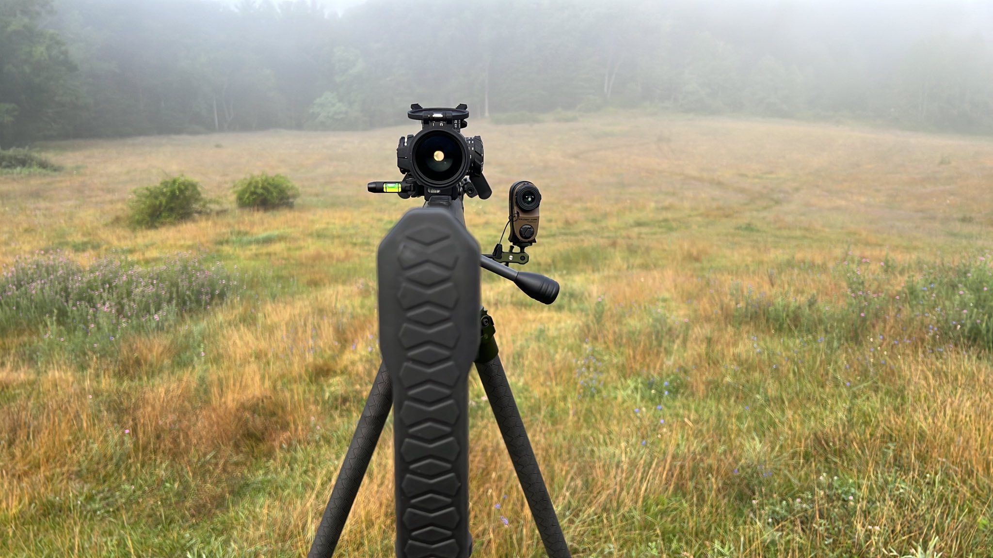

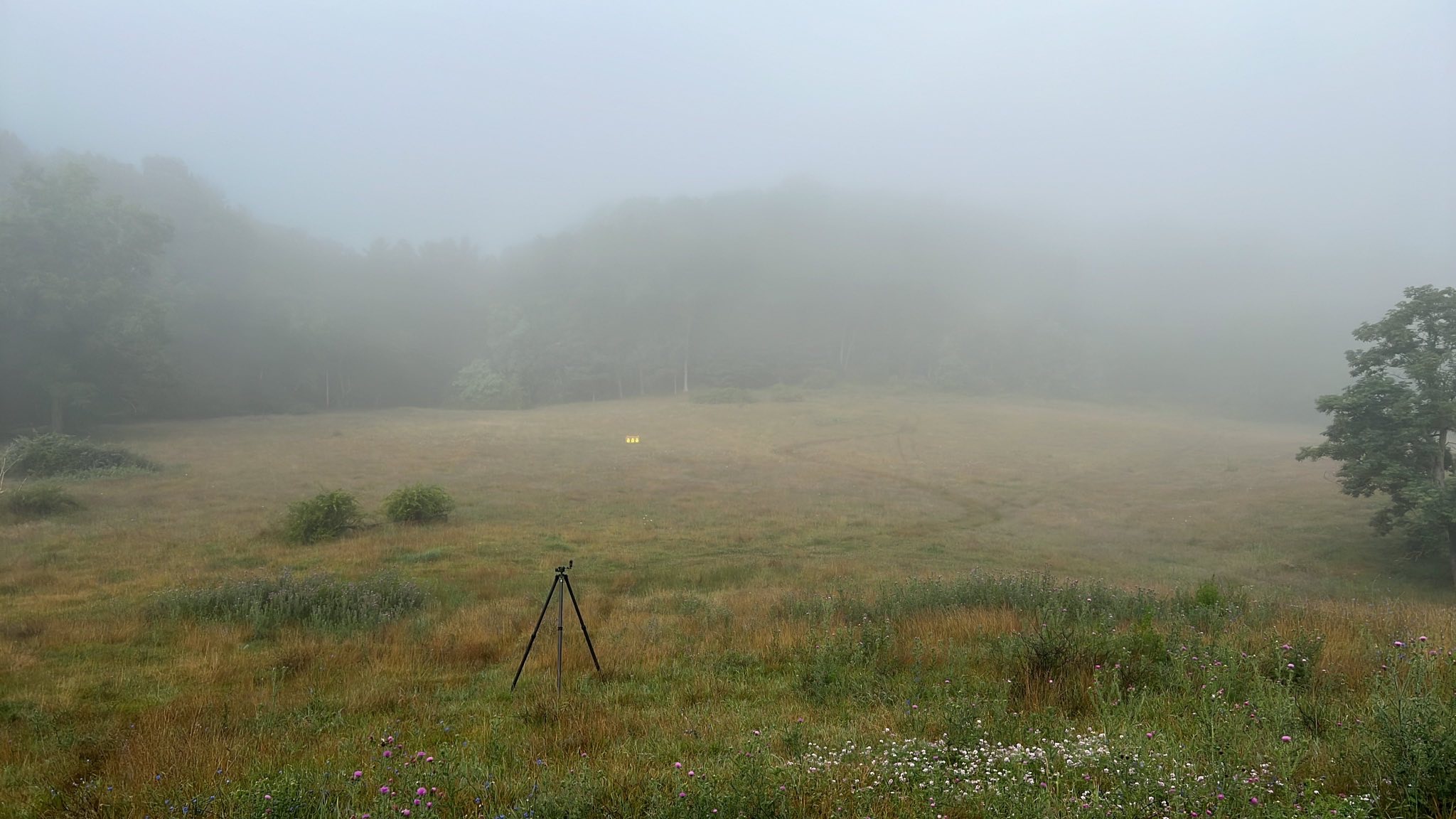

Augusta, WV. Waiting for the fog to burn off a bit before a re-zero of the 416...
Yes, factory barrel.

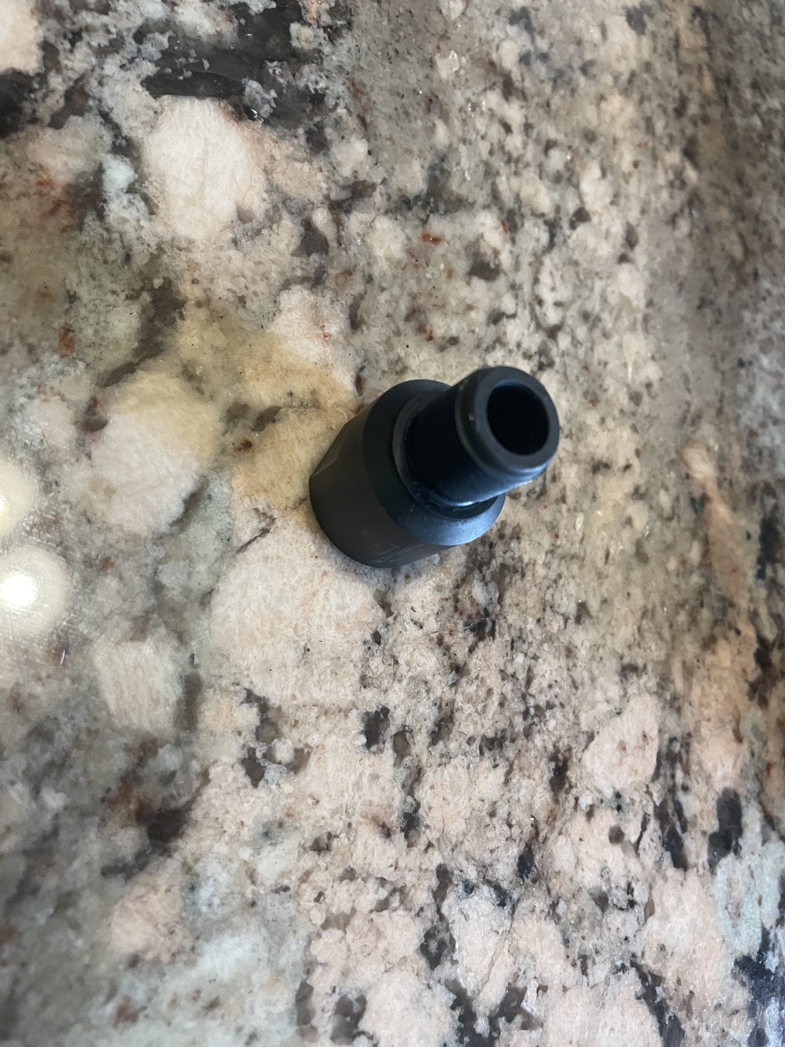

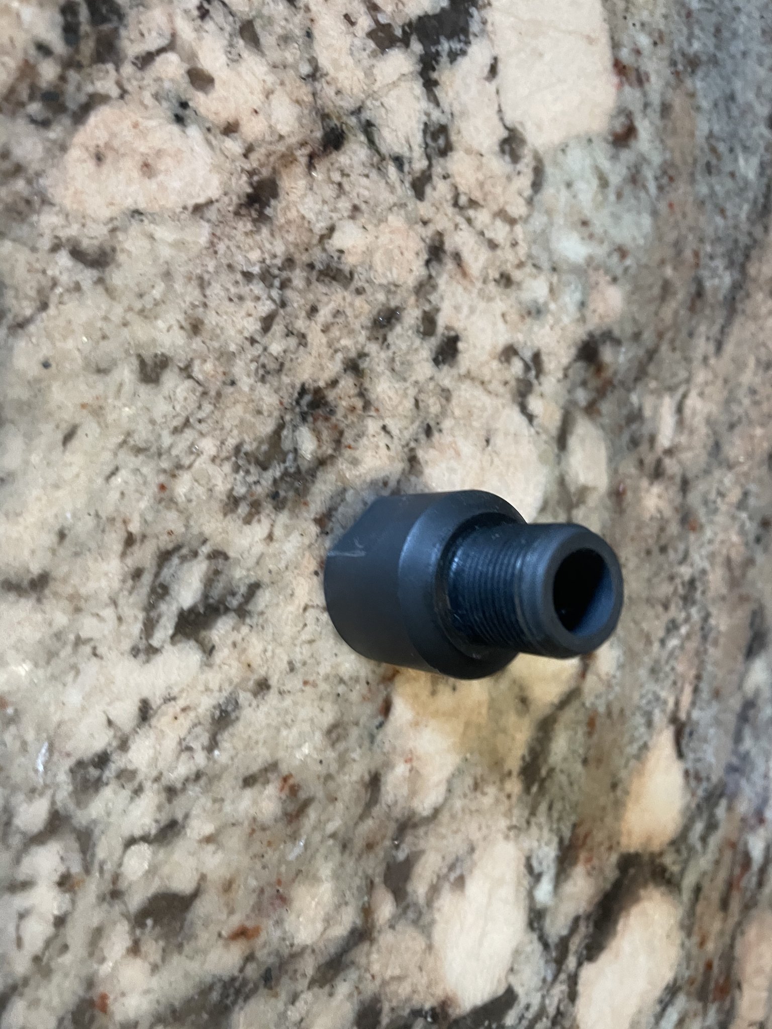

Hi All, I recently bought my first firearm, a DT SRS Gen2 in 308. Wanted to change the brake to a Precision Armament EFAB.
So I looked online, saw it had the same thread specs, was built for 308, and placed the order not thinking much of it.
Long story short, it arrived and won’t fit because the EFAB inner diameter at the back is smaller than the threaded muzzle outer diameter.
I’m weighing up my options still, but wanted to ask, has anyone had theirs smithed to accept a different brake?

Not to accept a brake, but when I bought my first SRS, the muzzle for all barrels came threaded 3/4×24, but all my suppressors were threaded 5/8×24, so I had my smith rethread the muzzle. I admit I'm not understanding what isn't lining up on yours, though. If your muzzle device is threaded 5/8×24 and your muzzle is 5/8×24, the diameter for both is 5/8"

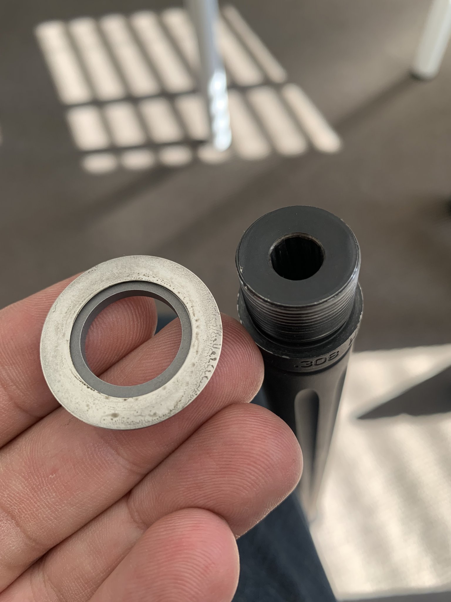

My ignorance is showing, I assumed my barrel is 5/8x24. Here’s a pic of my DT muzzle shims on top of a PA accu-washer.
I’ll admit to not understanding the measurements before and ordering based off my ignorance and assumptions.
/edit Like right now I’m assuming my barrel thread is actually 3/4x24 and I’ve been had by incorrect published DT specs.
Earlier generation barrels were all 3/4x24 threads. When the A2 conversion kits came out, they added fluting to the barrel shank on all SRS barrels and full length flutes to the covert length barrels. All the calibers in the A2 conversion kits have 5/8x24 threads with the exception of the .338 caliber barrels.
The 3/4x24 threads for some customers was an issue and DT had many customers asking for 5/8x24. We had some customers get them turned down to 5/8x24, others bought adapters from Delta P, some just purchased different muzzle devices or suppressor mounts.
I am sure there are a number of A2 rifles out there that were sold with A1 Conversion kits, because that's what the dealer had on hand when they sold the rifle.
For my personal SRS barrels, I just purchased brakes for suppressor mounts in 3/4x24 and never worried about it.

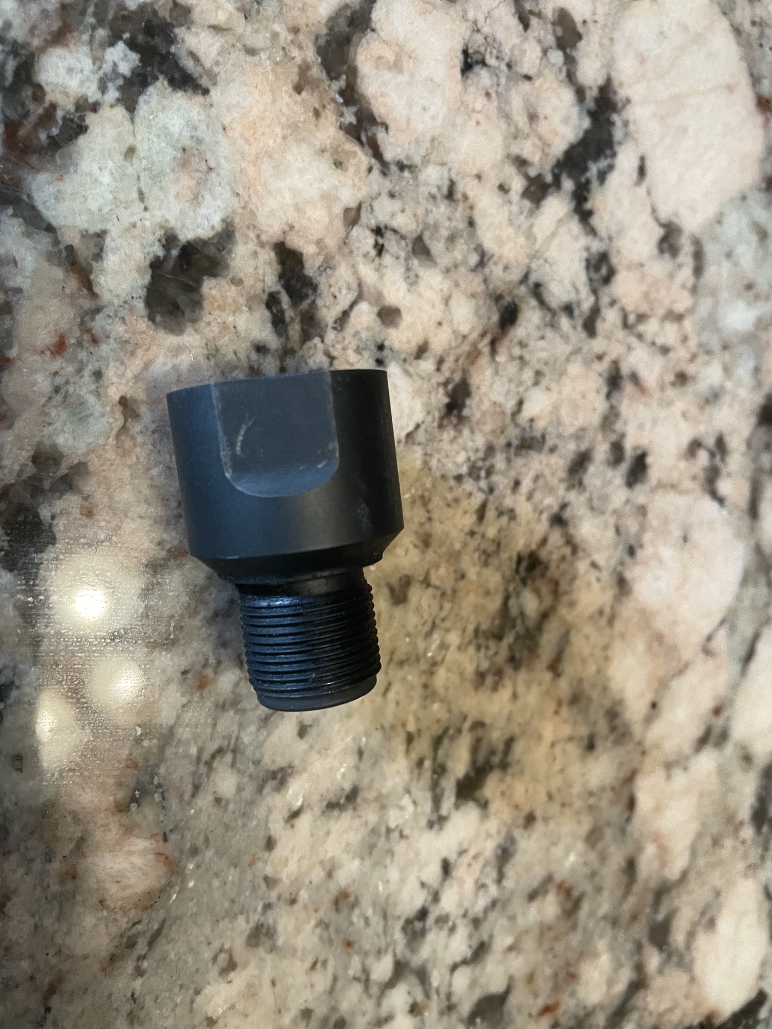

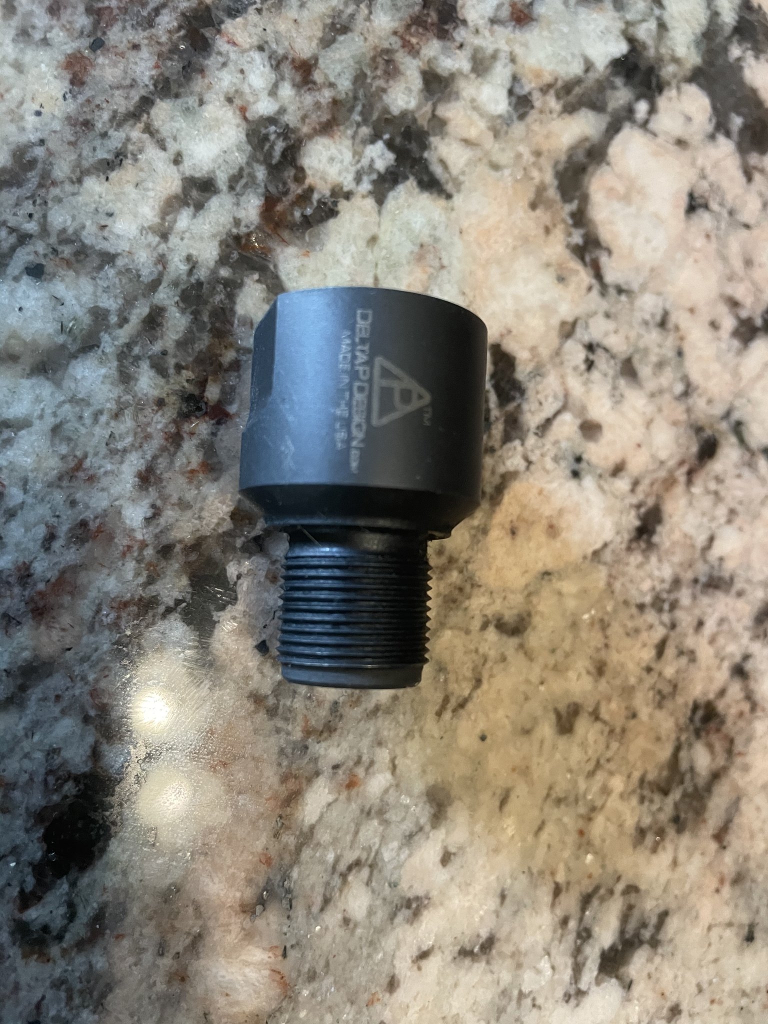

Suppose I could do something goofy and buy an adapter?
I have one Il give you a deal on. I used it with awesome accuracy on my DTA 6.5 barrel till I changed cans now I use a brake that fits the DTA thread
Works awesome
Let me know Il get pics tonight
I have the delta p
Pics
