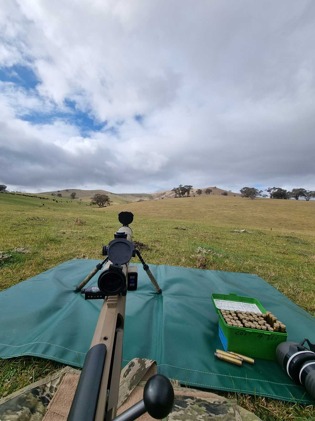

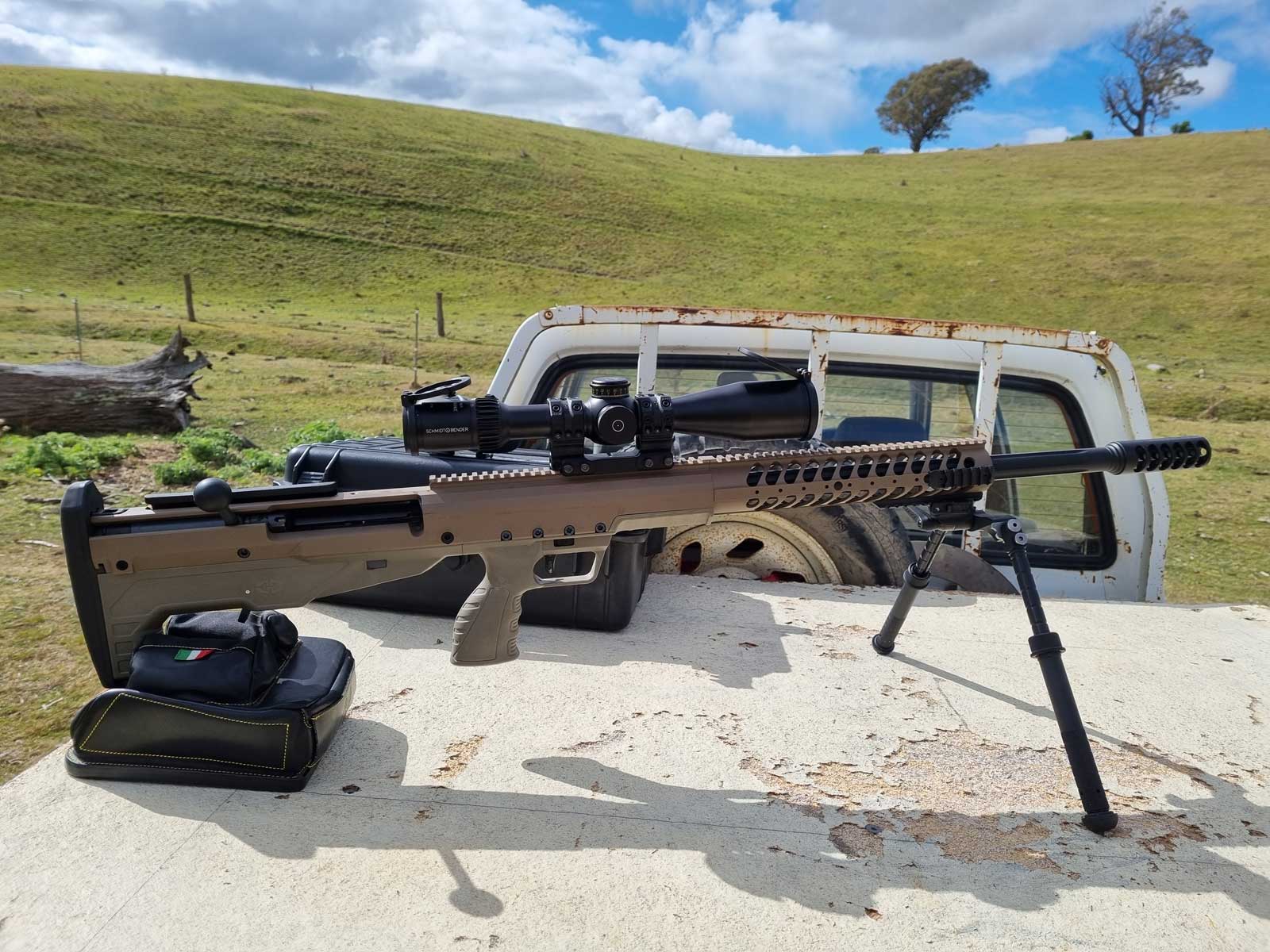

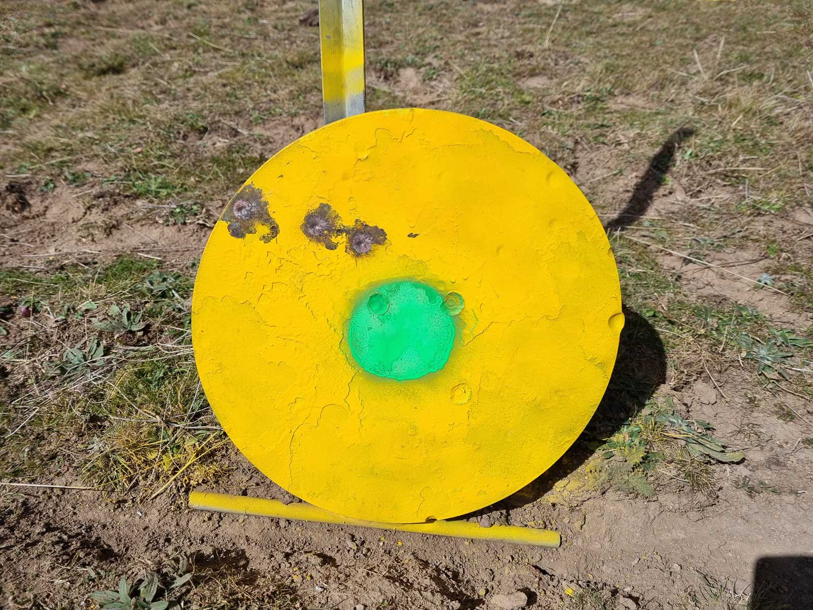

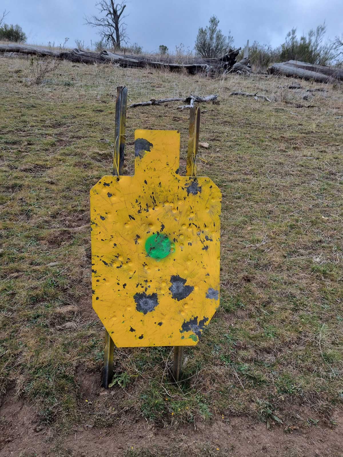

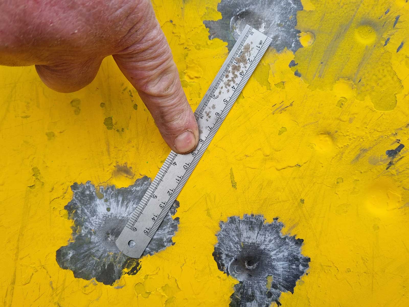

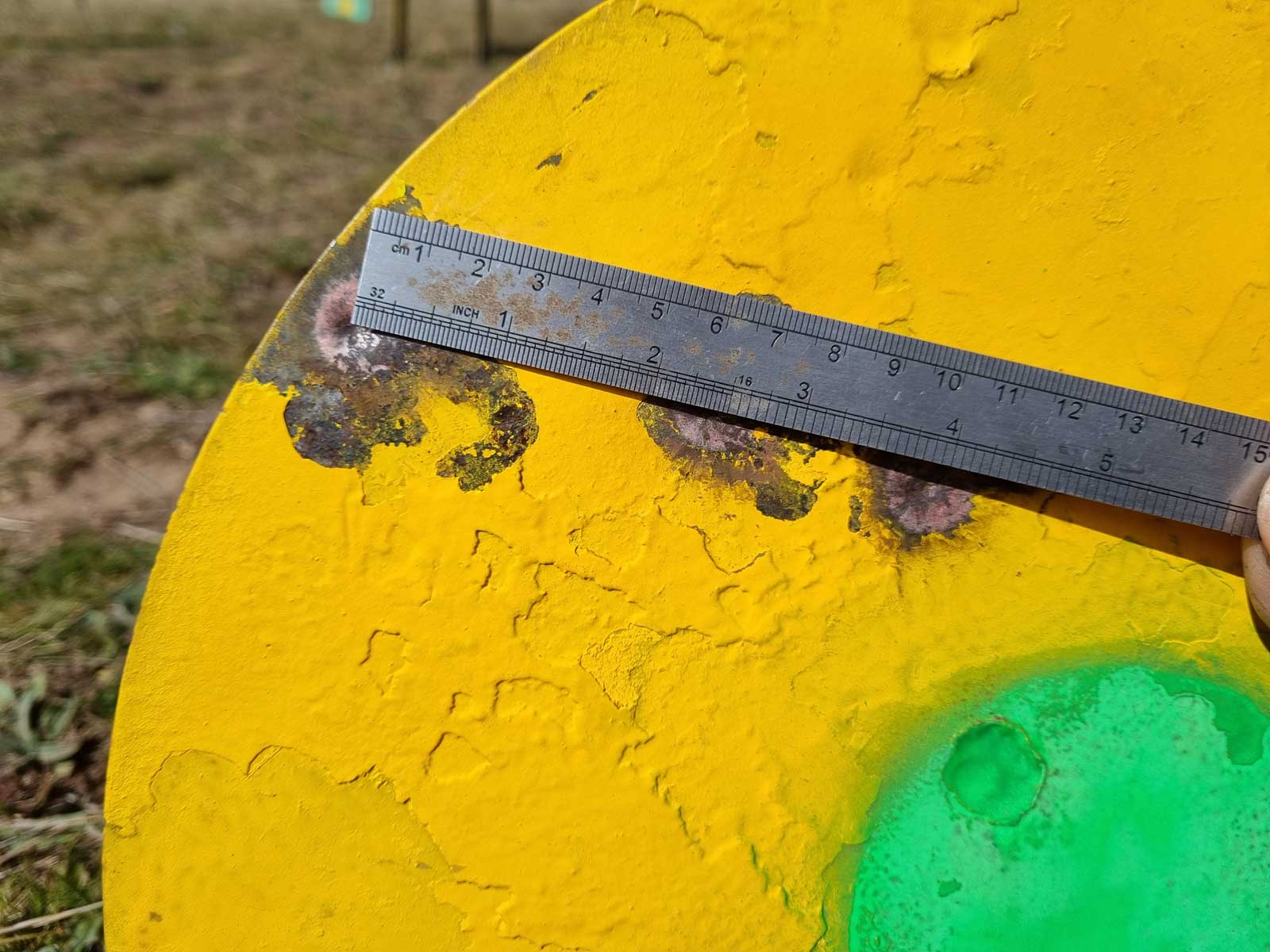

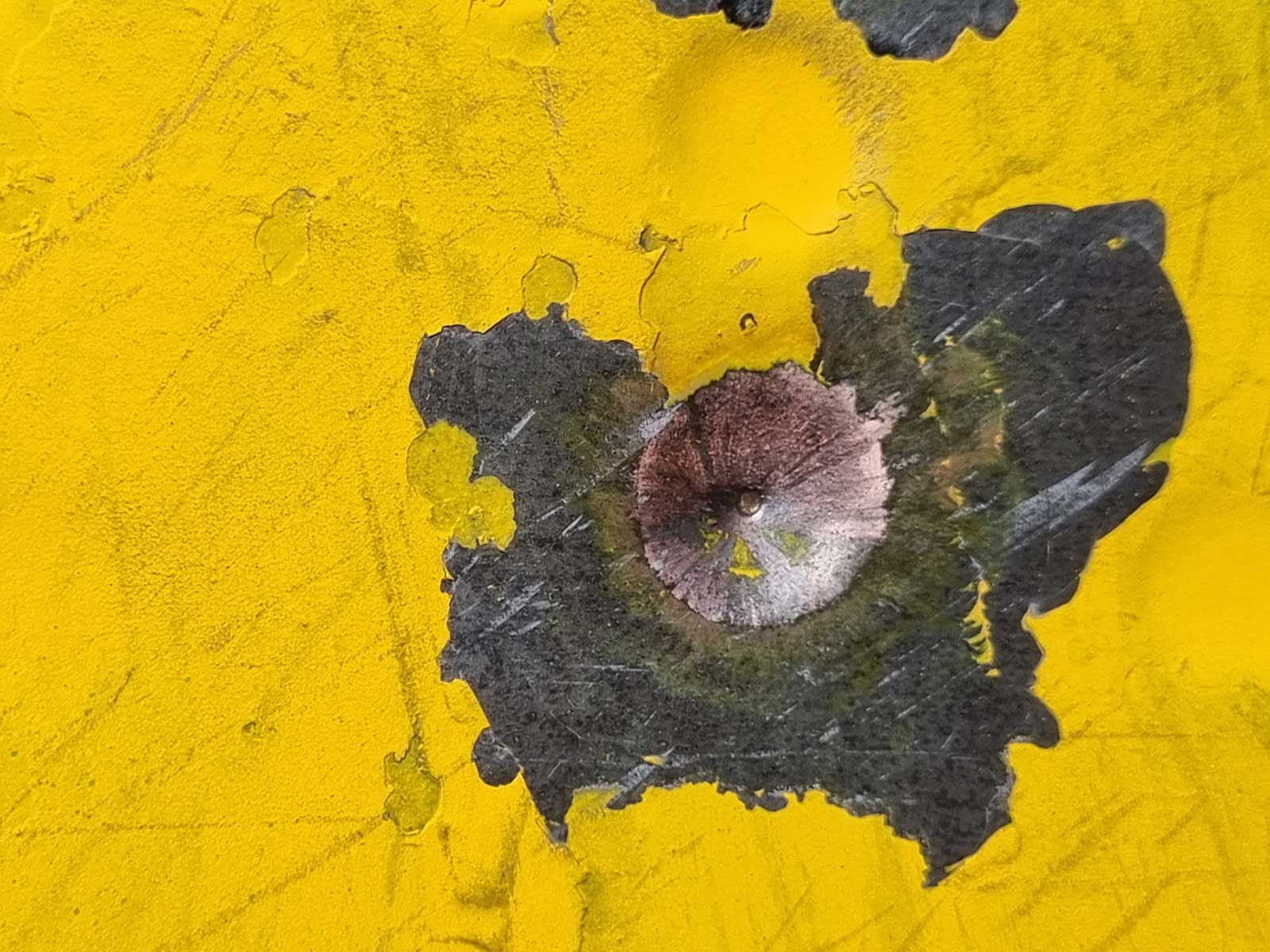

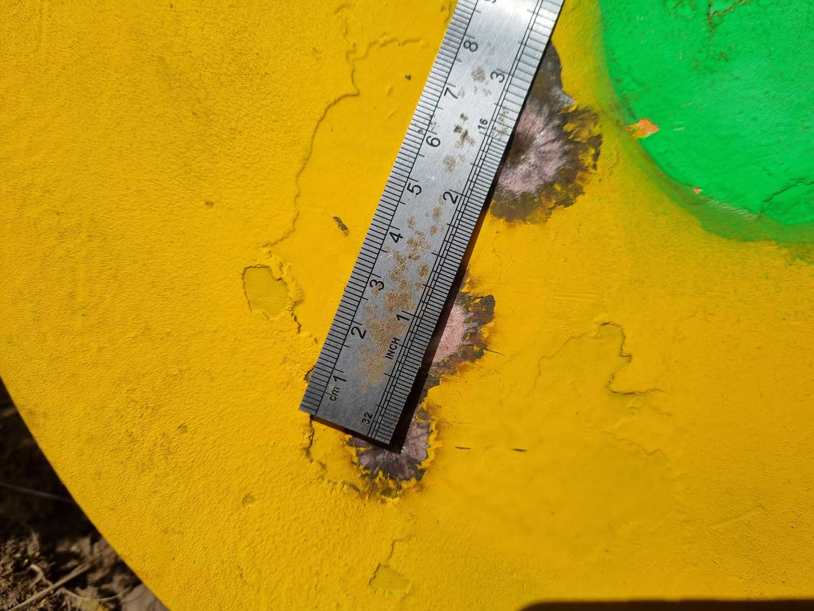

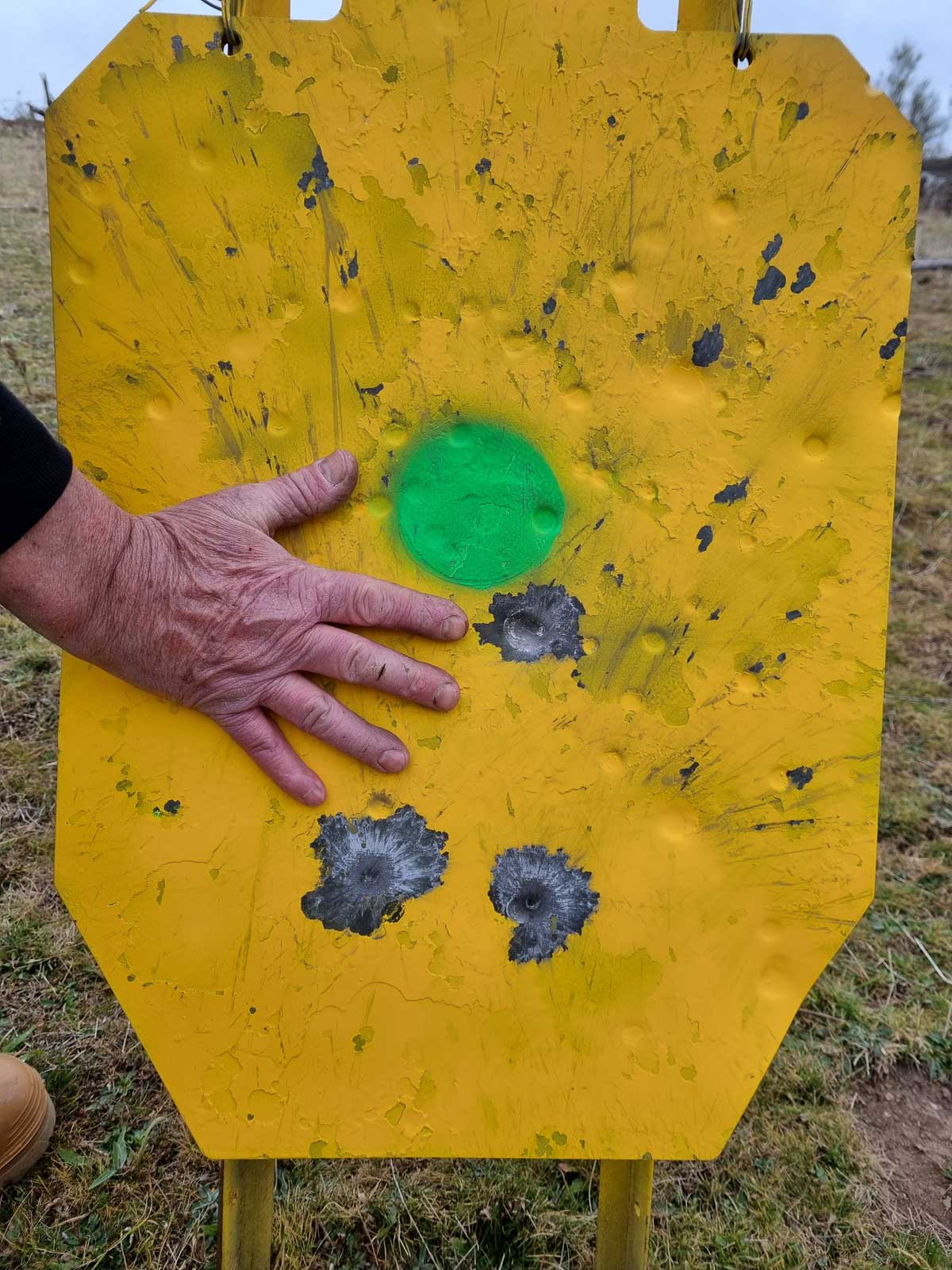

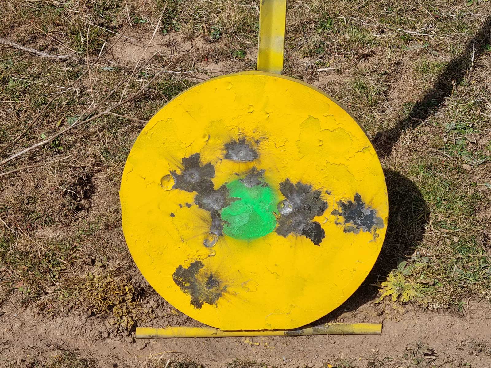

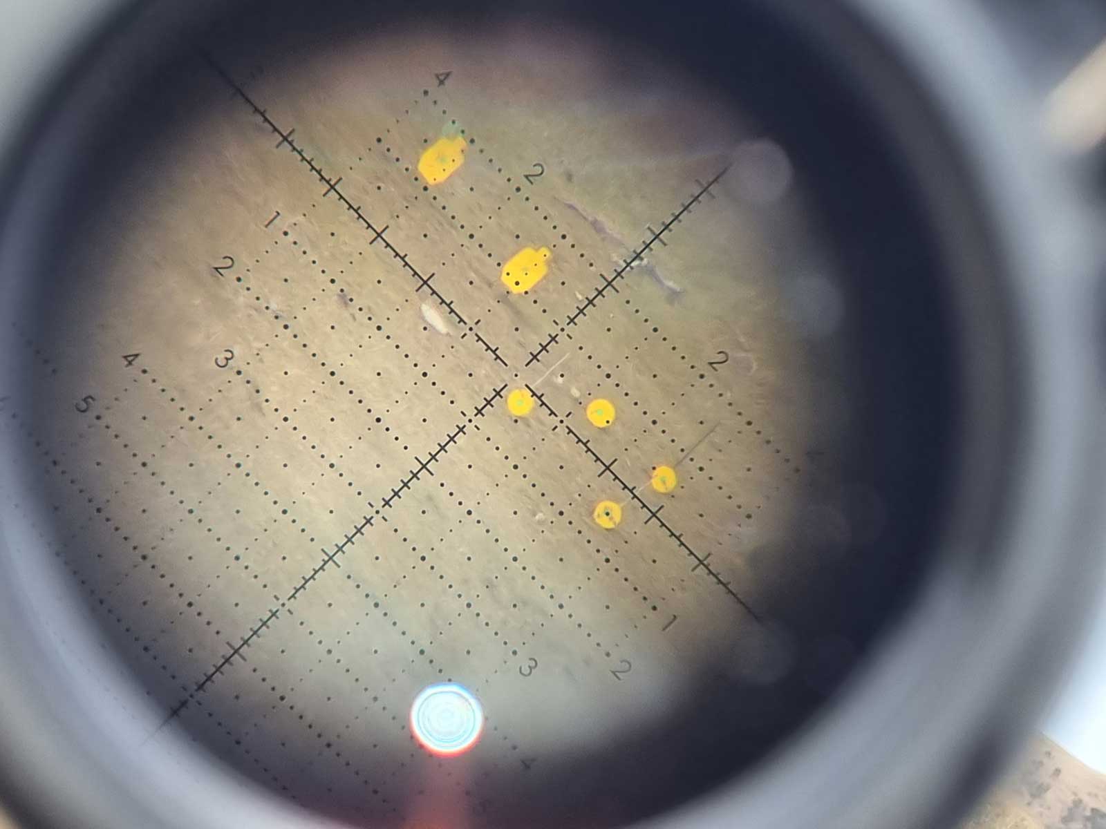

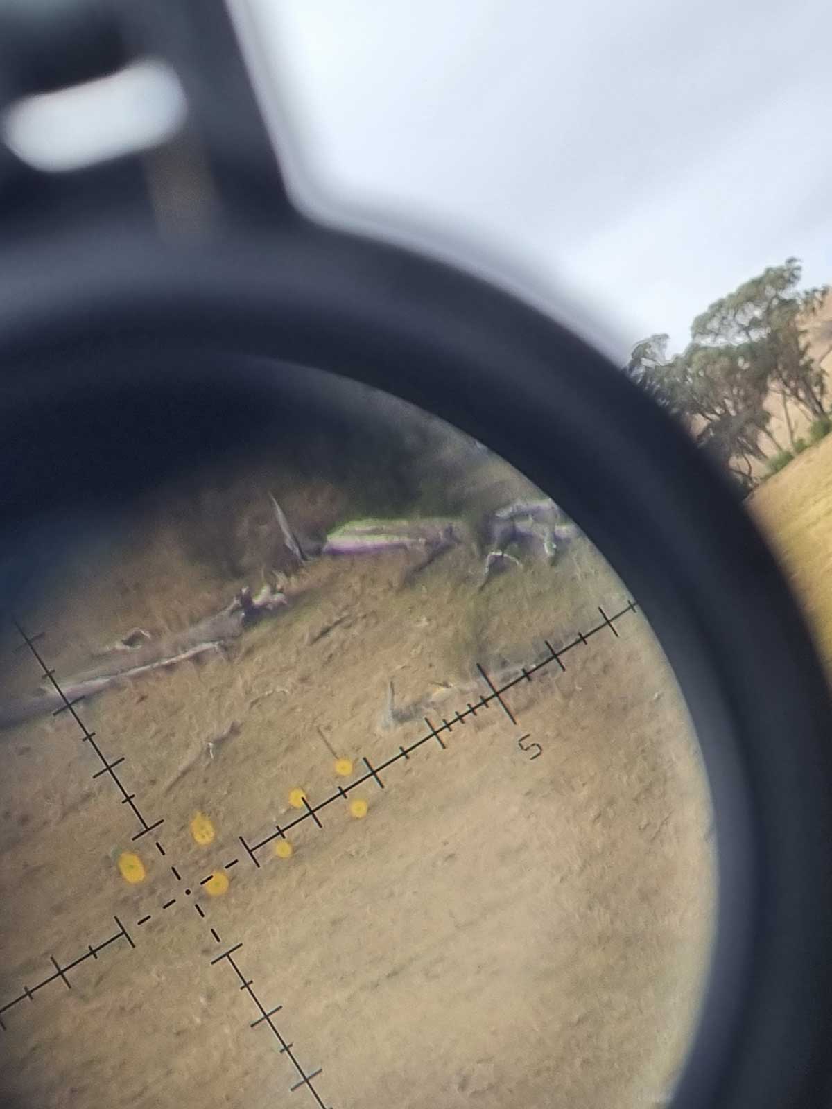

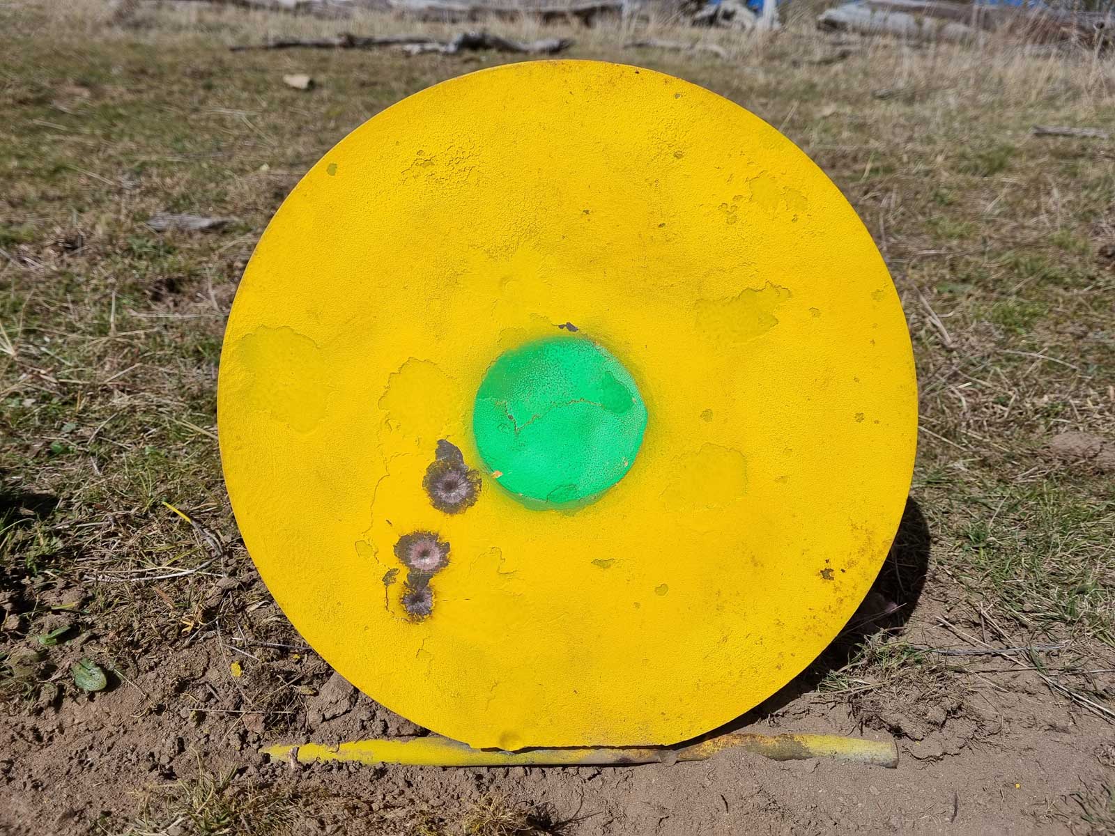

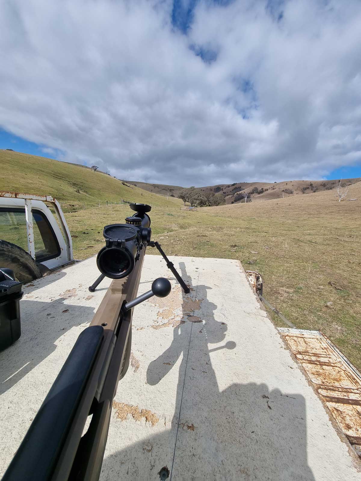

Had a bloody fantastic day today!! Went out early with just barely a breeze...overcast.

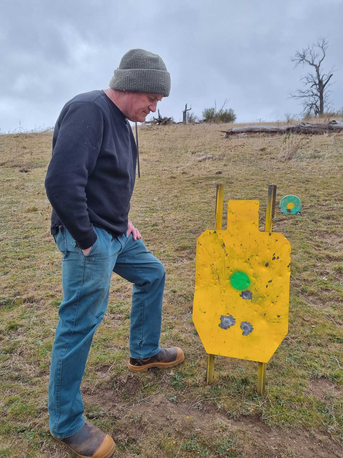

A good friend of mine shot my HTI 375ct with the 390 A-Tips at 2000yds .
1 shot just off to the RH side , perfect height. made a scope adjustment and then shot the "3" shot group in the pics ... Just on 6 1/2 inches!!!! Not sure who was smiling bigger..."Him" cause , he shot the group....or....."ME" because its my rifle and load..
I shot at the 2500yd mark ...very happy with the result.. 10 shots ... 6 hits .
Shot a very good cluster at 1500yds with the 390 A-tips..... 10 shots ....9 hits..
My mate Ian uses the Berger 379 Solids in his factory DT barrel.......shouldn't technically work ...but the results speak for themselves!!
Check out his groups at 1200yds..
Bloody good day!! :)

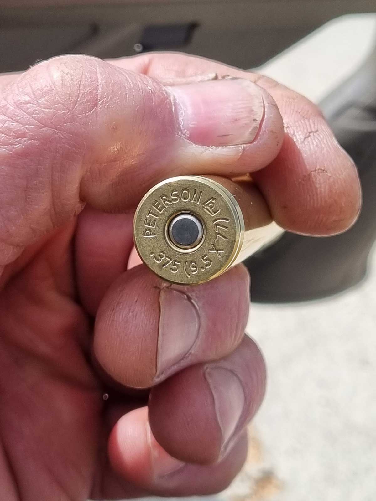

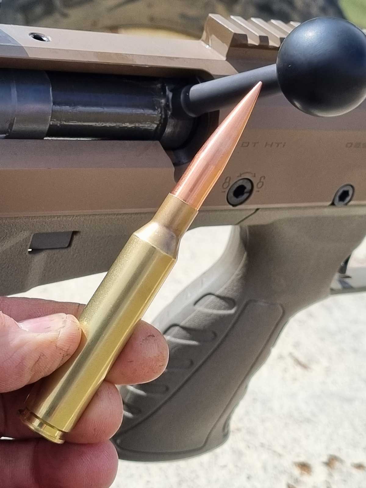

What velocity does your buddy run those 379 grain Bergers at?

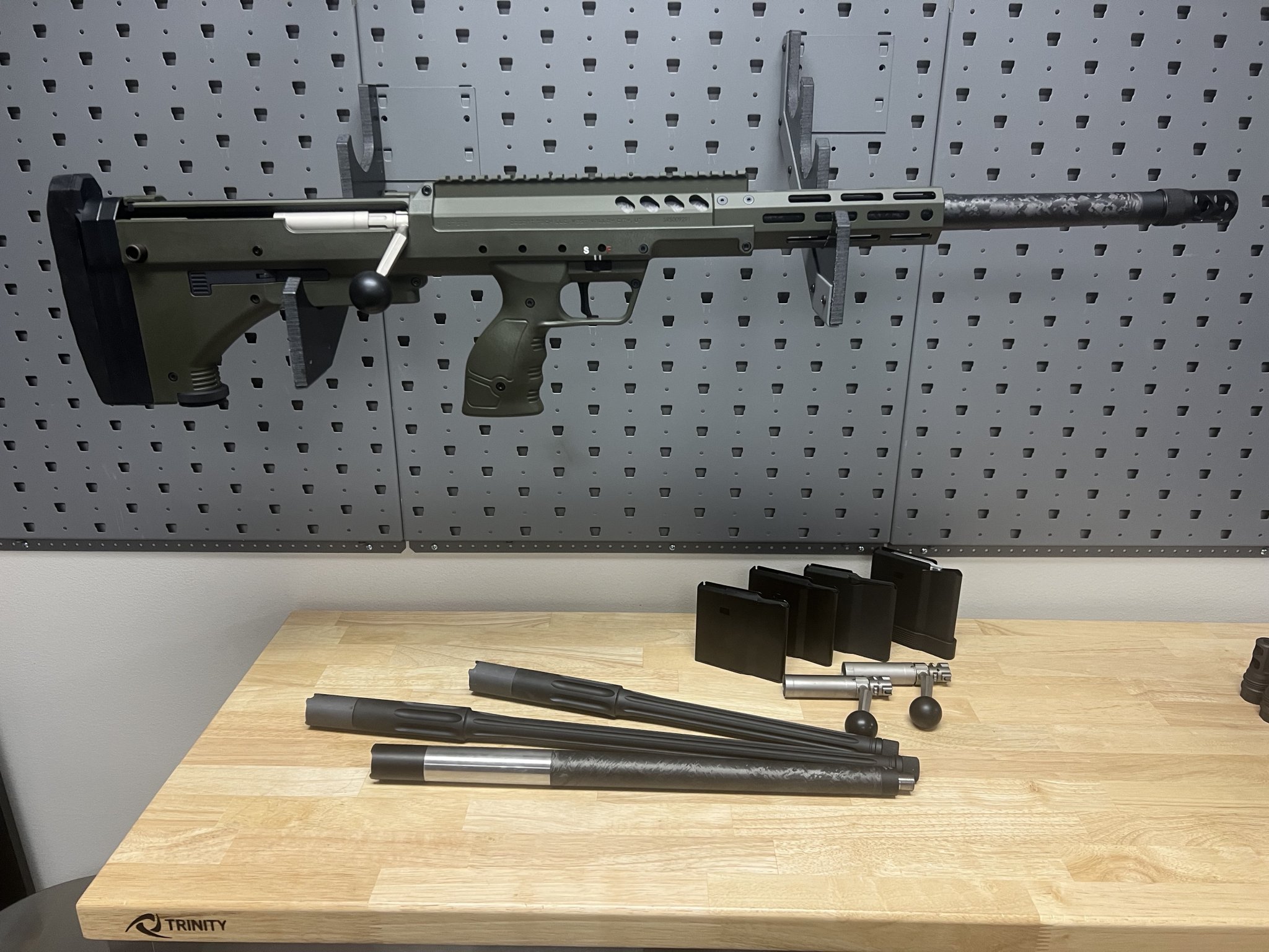

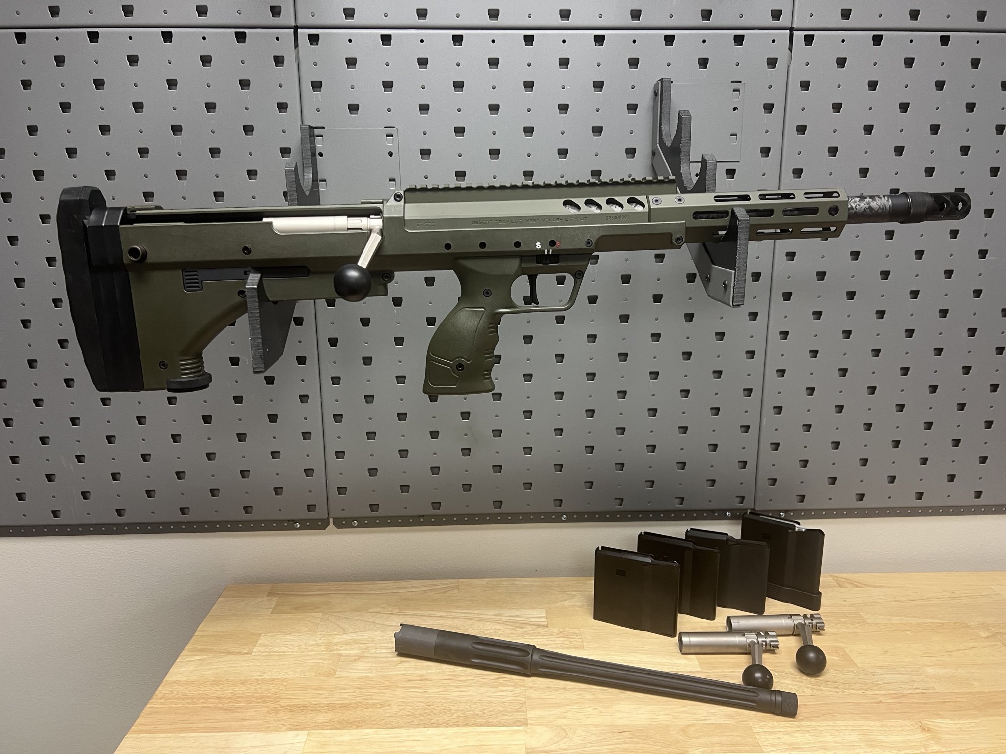

New to the DT system but have been shooting an AI AT for a few years now (still have it). I purchased the SRS M2 and have three conversions, 6.5 CM, 300WM, and the SAC .223 kit with a bartlien 7.5 twist.
Has anyone experienced ejection issues with the SAC kit? Maybe every 3rd case will eject, not really dependent on speed of bolt. Is there a remedy?
Anyways, love the rifle so far. Each barrel is a hammer.
Anyways, love the rifle so far. Each barrel is a hammer.View attachment 8213357
I do not recall having ejection issues with my 223 kit. I’d give SAC a call. The bolt on the DT likes to be run hard, especially on the .308.
Congrats on the DT purchase. I still have my AI and a DT. Both have their respective pros and cons. Both are great. If I could only have one it would probably be the DT.
Try running the 308 bolt stop instead of the 223 one supplied with the sac kit.
For me it made a difference
Reactions: PRDRIVER

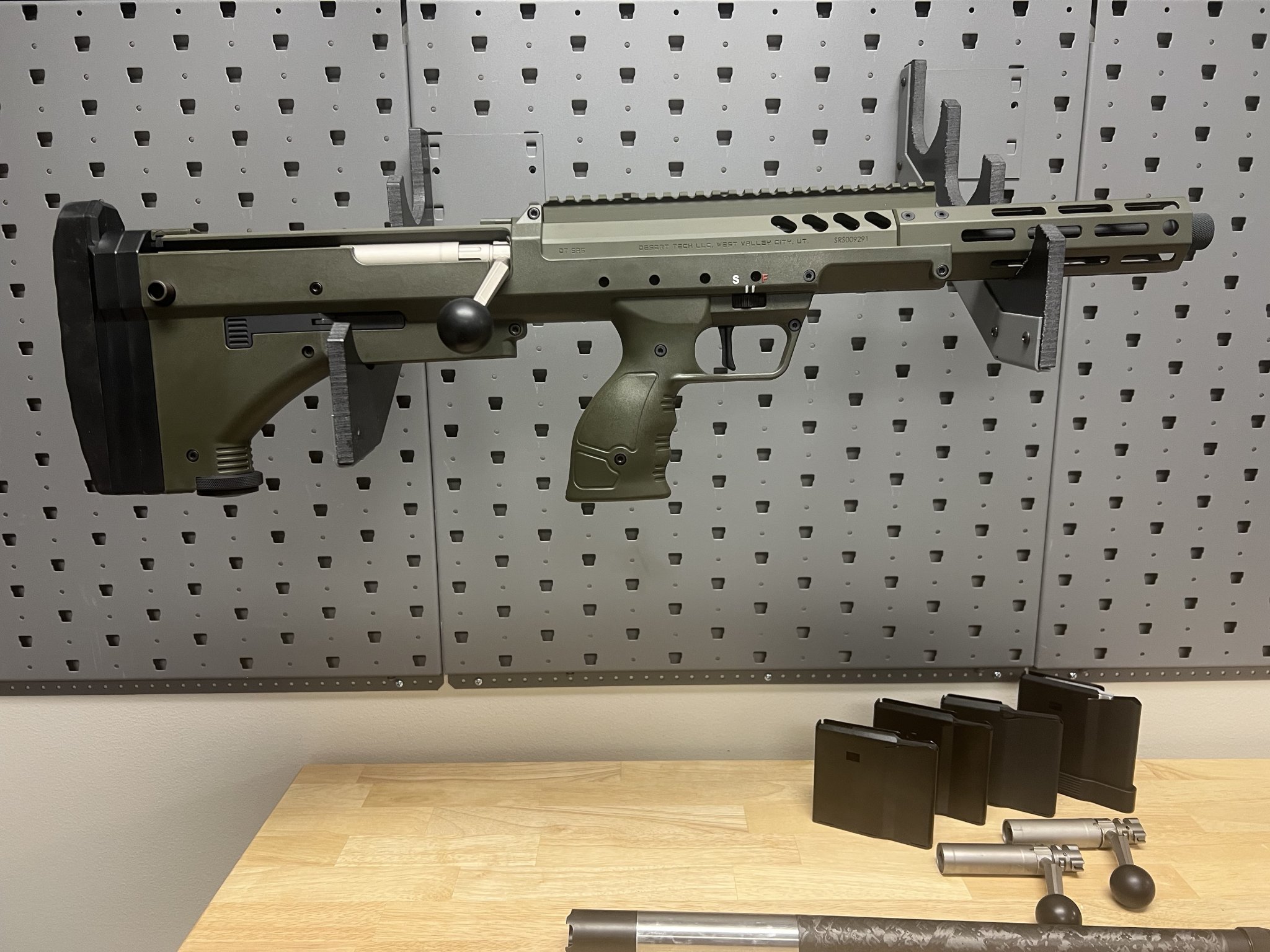

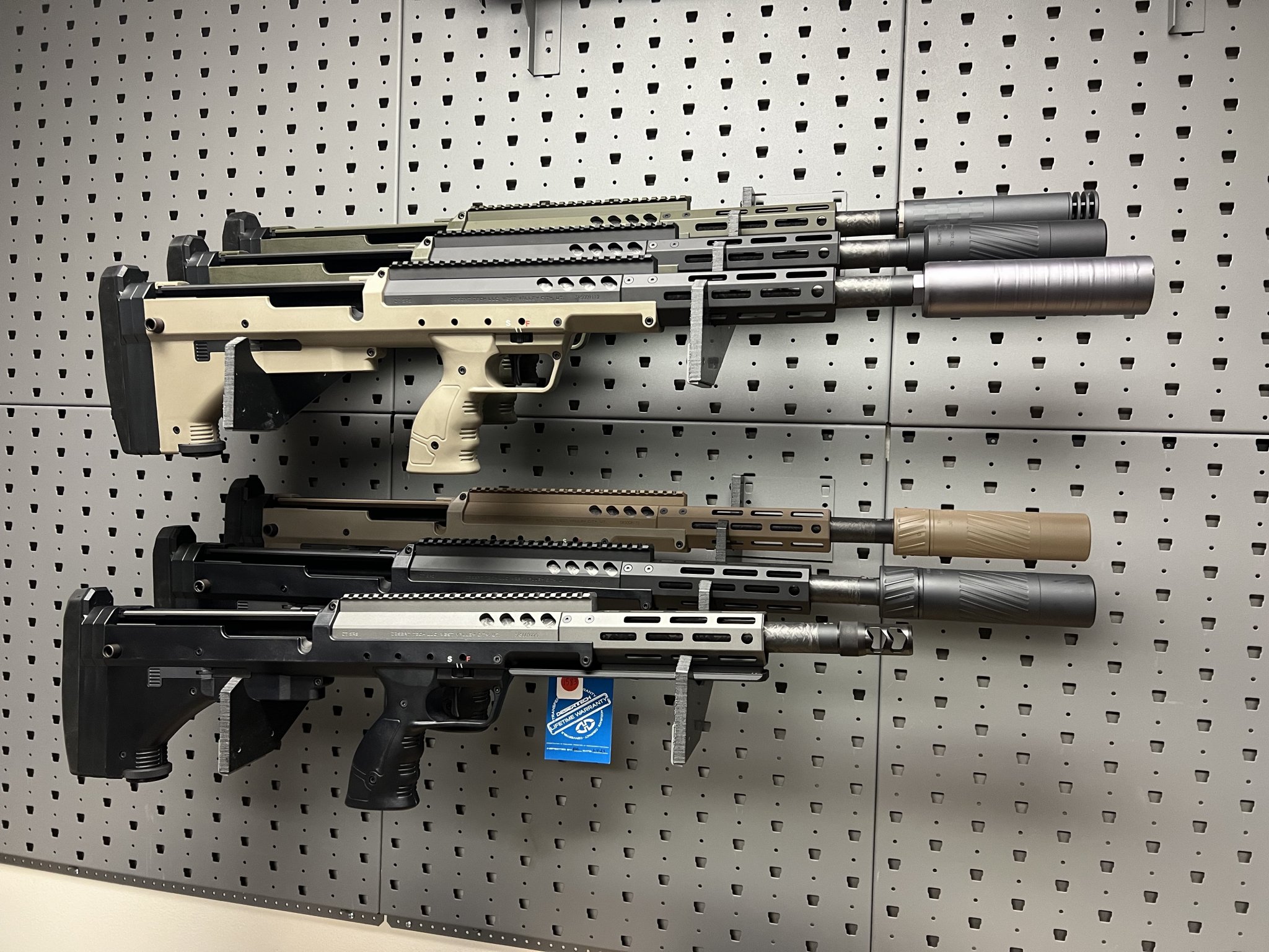

When choosing a suppressor and suppressor mounting system for either the M2 or your full rail version of the A2, do you have any advice on how to determine if a suppressor will have sufficient clearance to fit under the top rail “overhang” when used with factory 16” (covert) and 22” (M2, or PRDRIVER full rails) barrels?
For example, if I remember correctly, when we spoke over the phone you had said TBAC SR suppressors won’t fit due to interference with the “overhang.”
Is there a certain suppressor outside diameter you need to stay under? And I’m sure there’s some variance - a relatively large OD suppressor with an aggressively “tapered” proximal end (think Flow 7.62: 1.8” diameter, but not a straight 1.8”) might fit, while a can with approximately the same OD the whole length (think Theorem, TBAC Magnus SR) might not - just wondering if you had any guidance or a rule of thumb. I’m not sure what the ID and OD of the SRS forend is - can you just base it off of that?
Additionally, any difficulty in fitting a suppressor cover on with that limited clearance?
I’ll try to take some pics while I am at the shop tomorrow. Big 1.8” suppressors that are 1.8” at the base like the Dominus SR or 338 SR are a no go with a 22” barrel and an M2. Now if you go with a custom 22.5” barrel there is no issue.
If you want to run an Ultra or even a Dominus CB you are fine with a 22” barrel in an M2. Suppressors like the Sico Omega will also work with a 22” barrel and an M2, but things are going to be tight if you are running a suppressor cover.

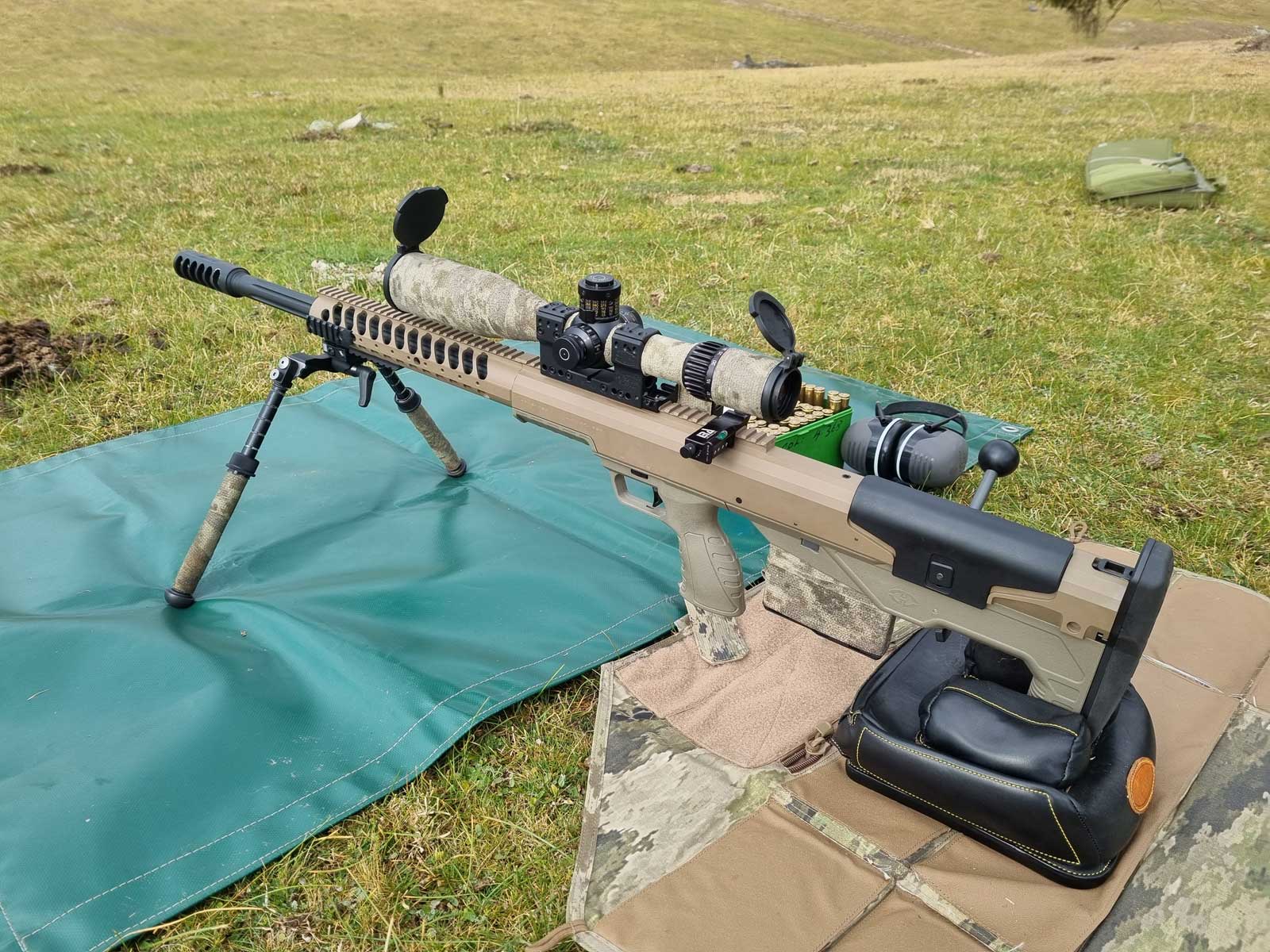

How does that Arca rail/mount hold up under recoil?
Perfect, no issues at all.. the 416 doesnt recoil bad at all.. Compared to the 50 BMG, not sure i would try it with that rig.. Its a FatBoy tripod and built like a brick shithouse... I'm 6'5 and it comes righ up to my height too.. Love that thing..

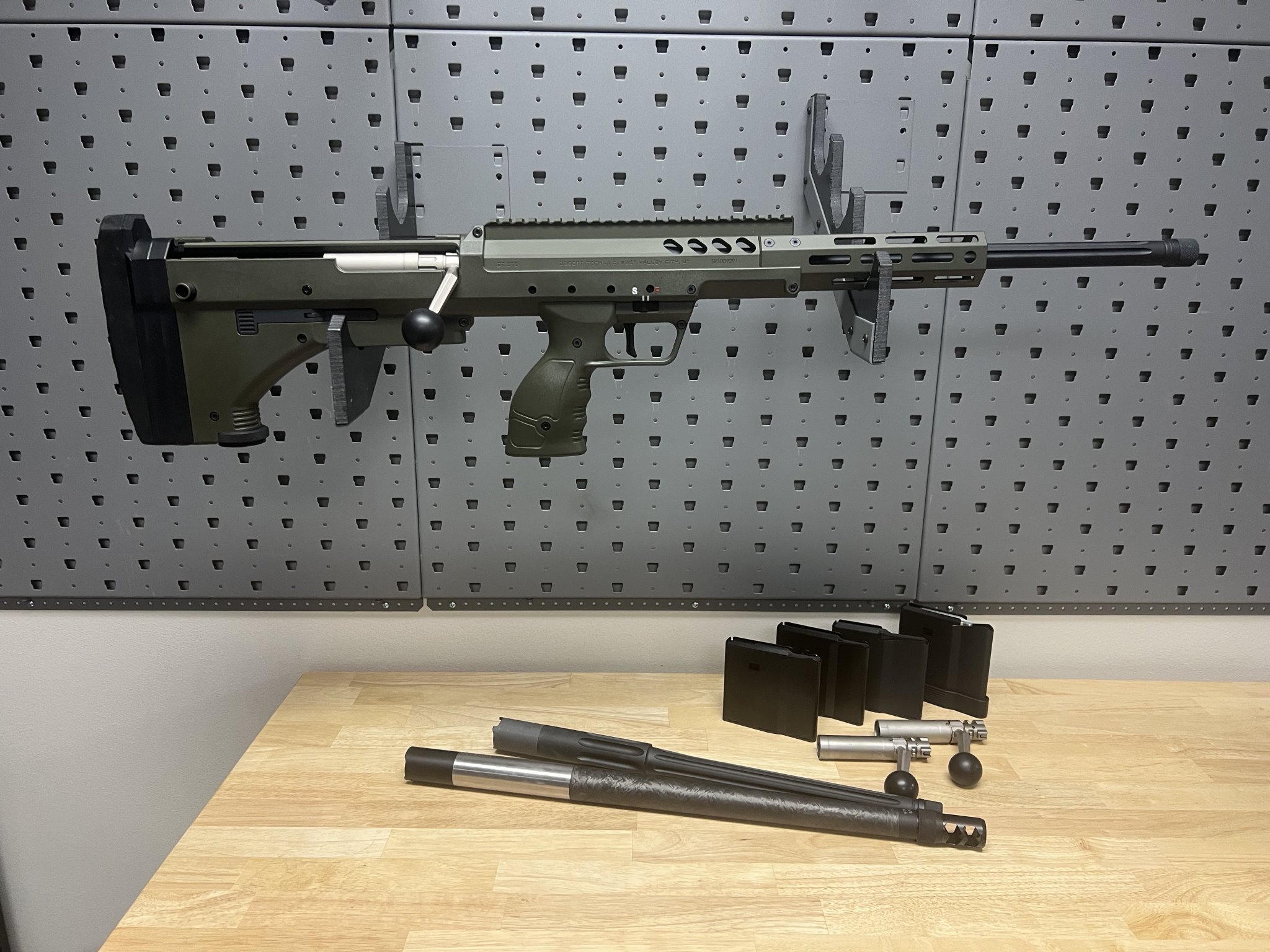

We have 18" Proof Carbon barrels in 6.5 CM, 6.5 PRC, 308, 300 PRC, and .338 LM in stock. For a youngster, I'd lean towards the 6.5 CM. I'd rather they have a pleasant shooting experience than get hit with too much recoil and develop a flinch or not enjoy shooting it. The SAC .223 kits are awesome. We have done them in 22.5" Proof carbon barrels and will be adding an 18" carbon option in the future.
