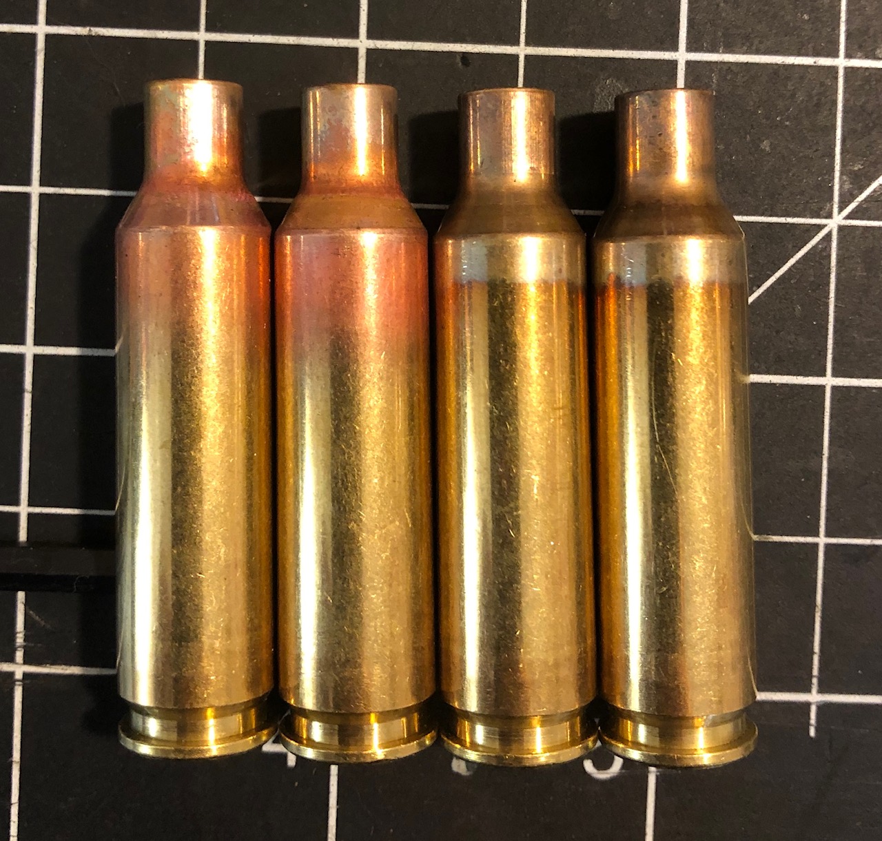

So I'm going through annealing (Annealeez) new to me once fired Prime 6.5cm brass. After getting setup with Tempilaq etc, about 100 or so pcs in, I had 4 come out looking like the two on the left. At first I thought they were getting too hot, so I turned the heat down real quick, brought it back up again and it stopped. Every other piece looks like the two on the right. I've never seen this before but I'm still new to annealing... any ideas? Thanks!!
EDIT: I just went to turn it back on and the nozzle started spraying liquid propane. There is not much left in the bottle. I'm guessing its not as consistent when the bottle is in the low end, but I would think it would look under annealed if anything.
