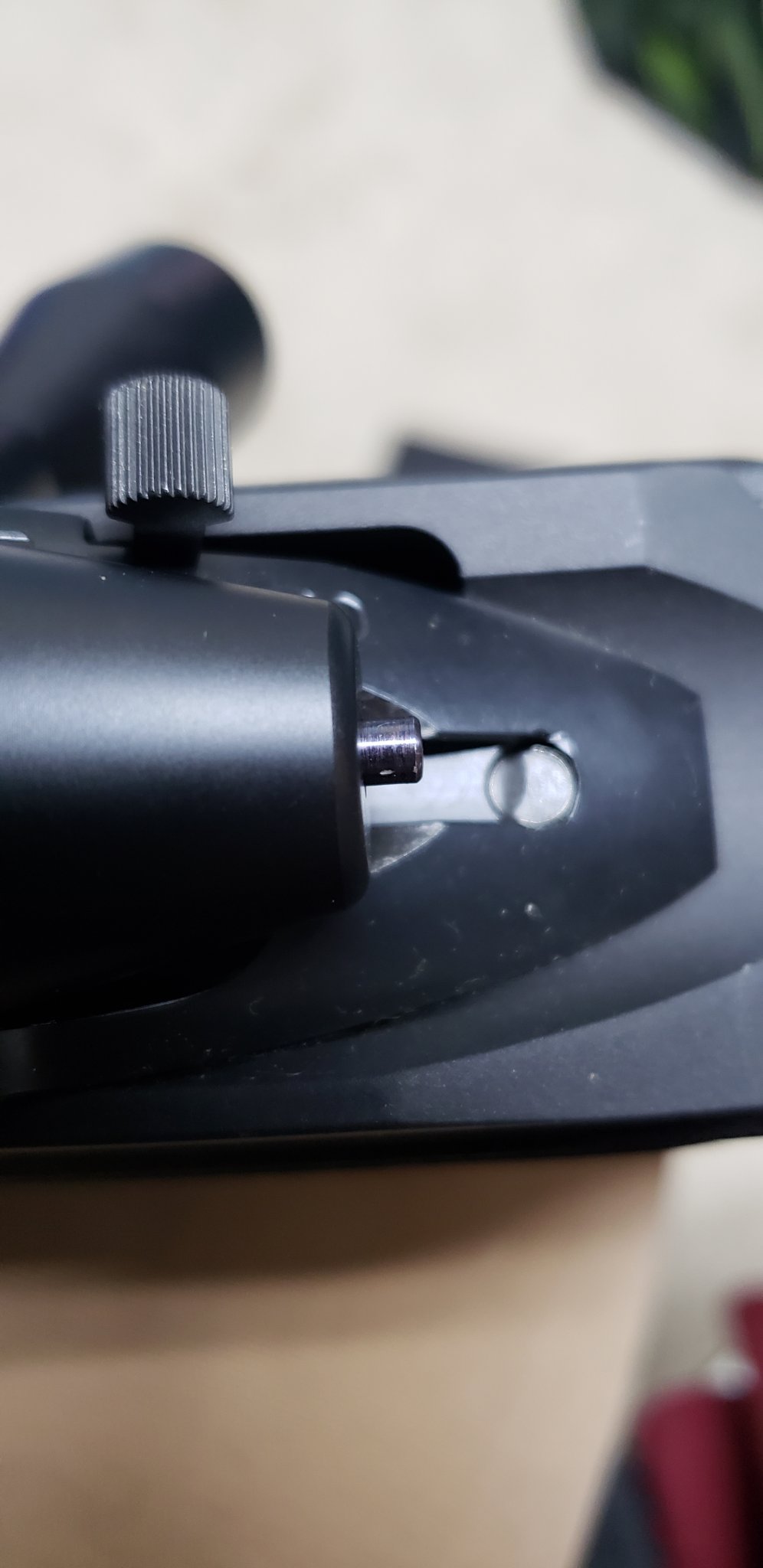

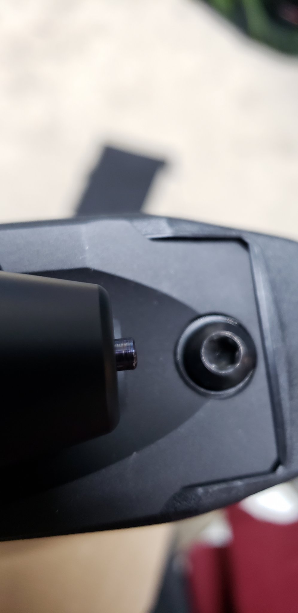

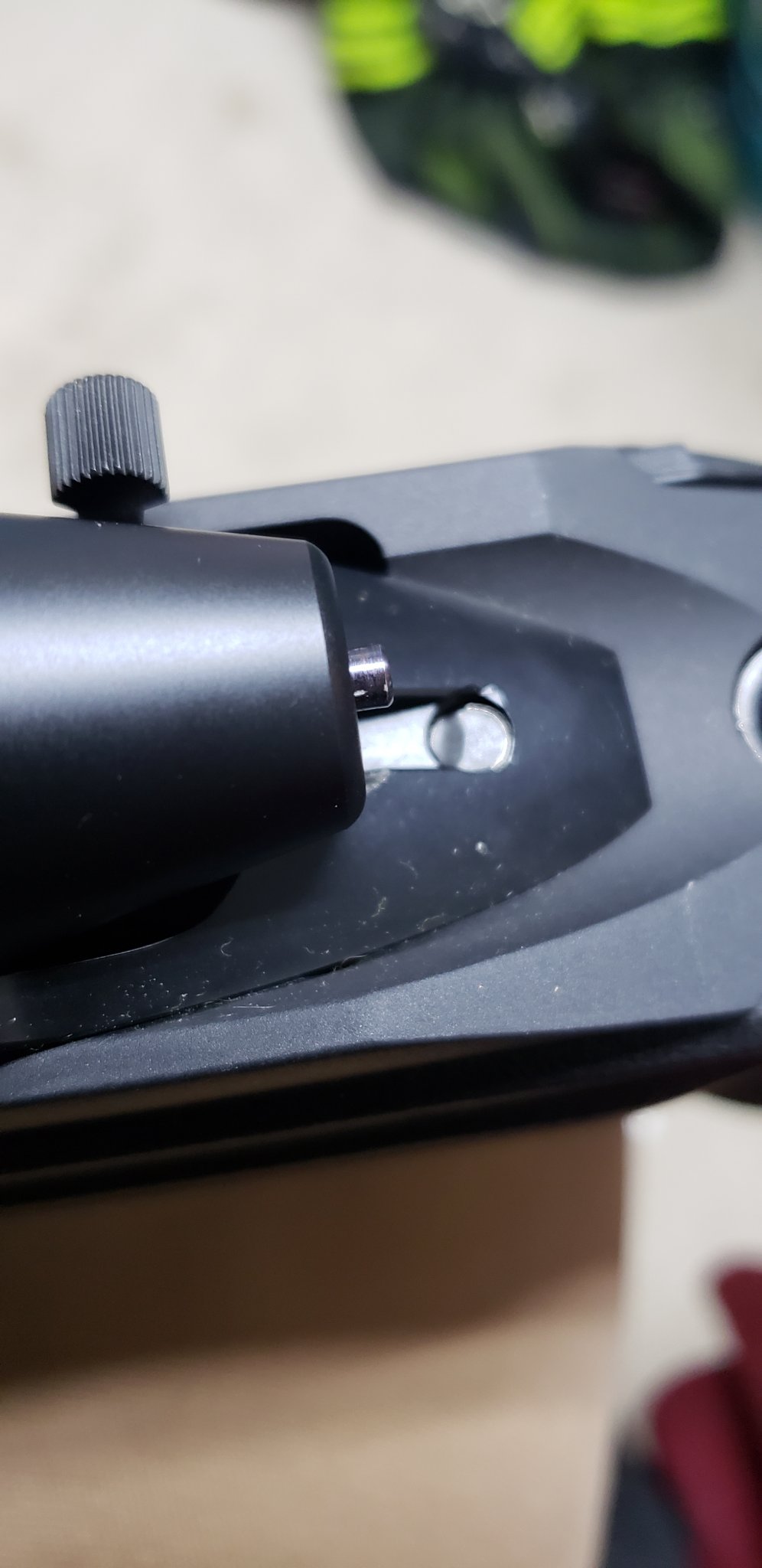

@BigHorn / ZAI Team Any chance you guys would consider selling different sized cocking pieces? My idea being instead of a trigger hanger etc one could use a cocking piece with different dimensions to time the trigger. Even increments of .010" or so. Could run a survey of what triggers people are using and how much cock on close they're getting to get an idea of what approximate sizes people may want. Not looking to get it custom fit perfect, just closer.
It seems like it is pretty easy to measure how much cock on close someone is getting. Measure the protrusion of the cocking indicator with the bolt open and then again with it closed with the sear holding the cocking piece. I'm getting 0.052" with my Super 700 on either of my Origins. Otherwise, I'll probably end up timing it myself or having someone do it.
Just a thought.
Some kind of standard for actions/triggers would be cool but seems unlikely this late in the 700 compatible game.
Just a thought.
We're a few steps ahead of you :)
BigHorn / ZAI Team
I just measured the bolt protrusion on my bolt and sitting at .1240 when it lock into battery , .09 when it's just cocked from the bolt lift and. 069 as the bolt shuts but don't begin to cock on close
Are you removeing material from the cocking peice where it contacts the cocking ramp? Looking at my action trying to figure out what you are doing
More times than not, that’s how it is performed. But, there is a significant difference between a finely tuned surface grinder versus a Dremel tool in your garage.
New York, guessing you have considered sending it out? Turnaround time is probably less than two weeks.
Edit; I just re-read your post, it is the cocking piece it’s self, usually the bolt body is not touched.
