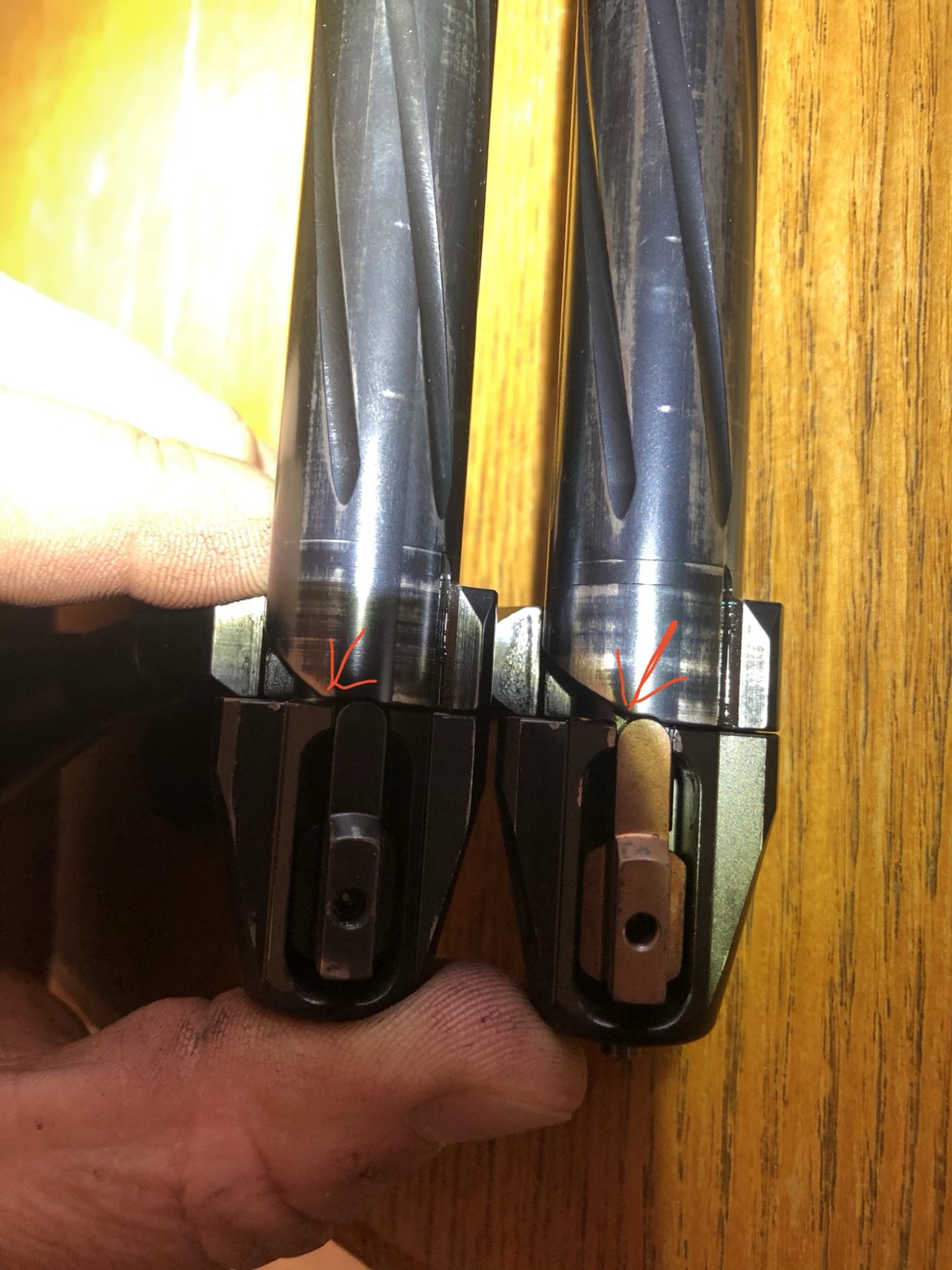

Rev1 Bolt on right.

Rev1 Bolt on right.
And just to be crystal clear, there is not a functionality problem with the Rev1 bolts. They work just fine, but they are much harder to time without taking out a bunch of firing pin travel. Also, the Rev2 bolts create a heavier bolt lift because the ramp angle is steeper.

Take a look at post #1478 above with Dirtbiker250's photo, you should be able to see the difference between rev1 and rev2 by referencing the red arrows.

just checked the serial number and it’s 238 so I’m guess it’s the rev1. Which now knowing it’s takes fair bit of pin travel to time makes sense after the modified cocking piece didn’t completely get rid of the over cocking.

If you believe you have a Rev1 bolt and are having actual issues with the function of your action, send me an email with a picture of the bottom of your bolt body where the cocking piece is held in relation to the cocking ramp and I'll advise what to do.

The Rev2 may make your problem worse if all you are concerned with is a smooth bolt, see post #1479 above. I take the risk of an even heavier bolt lift, but will have timing addressed for my chosen trigger, not Zermatt's chosen trigger. I had to send my entire bolt in for them to check out.
