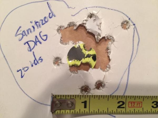

This is 20rds of the Sanitized MEN / DAG with the groove cut around the case head face ( German Surplus Import laws.. ) ...
AND don't buy a crap load if you aren't comfortable with that milled out groove... I haven't had any issues... BUT all my 308 AR's are setup with Heavy buffers, recoil springs, and an Adj.GB... and those parts make extraction occur at a lower chamber pressure
This was from a OEM PSA ? DC Machine SS 18" barrel... 20rds , 100yds, scoped, benched, bagged front and rear squeeze... rapid fire.. shoot get back on target, shoot... and this was after a ton of other various factory rounds fired that day.
