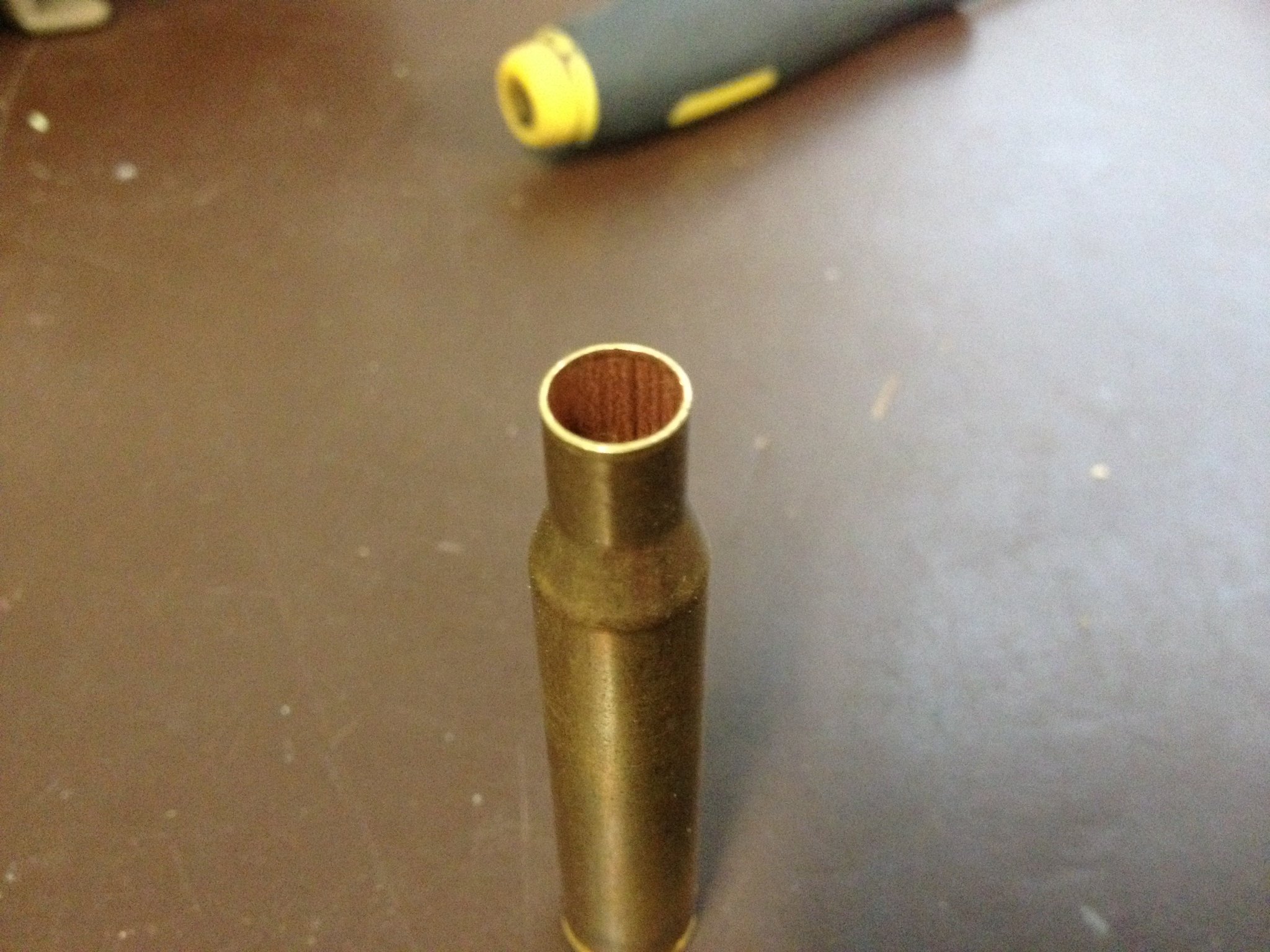

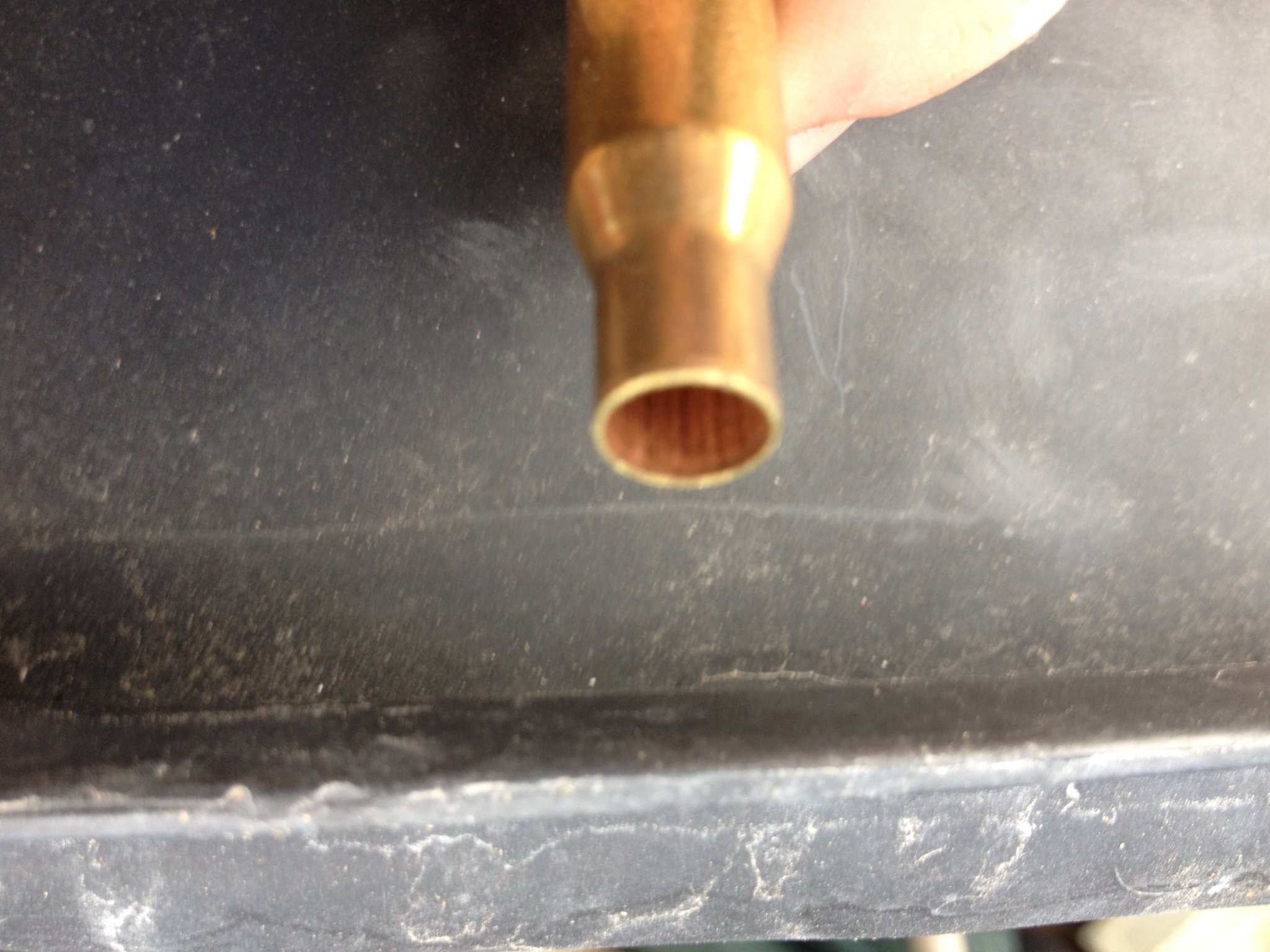

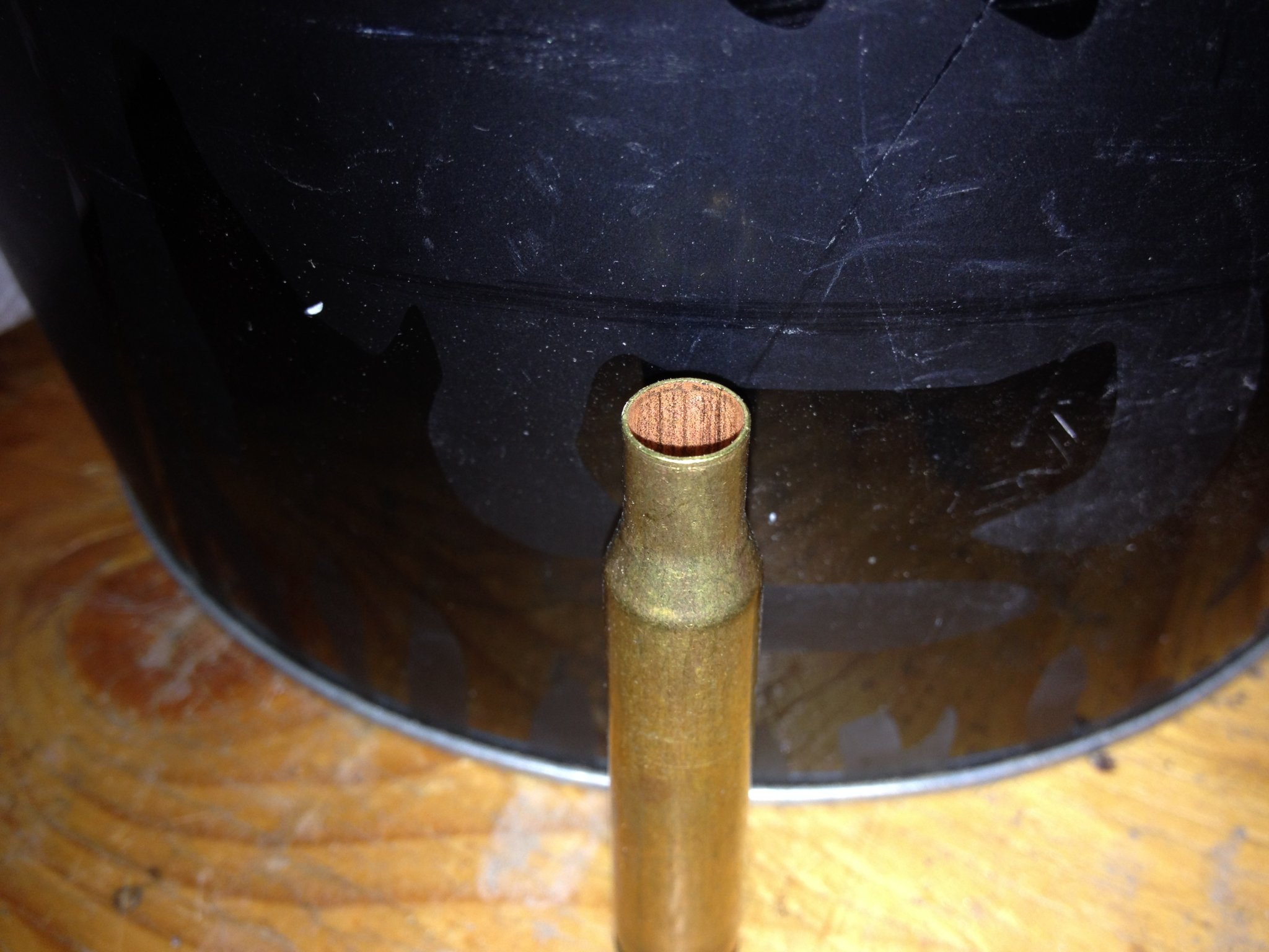

I never knew this, but rice is hollow. As you tumble the brass, the white rice slowly turns dark. It is all the crud from your brass filling up the hollow rice pieces. Same for the inside of your tumbler, no mess, it's in the rice! When the rice gets real dirty, feed it to your neighbors cat and get more!
As I said, the brass isn't shiny, but targets don't give a shit what your brass looks like. Neither does your rifle, your kids, and especially your wife. It's clean and smooth and that's what counts.

I think I have tried all the methods out there. Vibratory tumbler, but the dust really sucked. Tried rice in it but they got stuck in the cases. I tried the ground up rice and that worked ok but not great. I tried stainless pins, worked great but a big hassel and I worried about cold welding the bullets. I tried ultrasonic and it was ok. I also tried the porcelain and it also made a mess of my brass. I tried it in the vibratory tumbler and the rotory one with the procelain and same thing. Now what I do is I wet tumble for a half hour or so with dawn and lemishine, no pins, after I decap. Then I throw the brass in a cheap food dehydrator to get it dry. Then I anneal, while I am annealing I clean the pockets, you have time while using the AMP annealer to do this. I then hit the brass with Hornady one shot, then I size. After sizing I throw the cases in my vibratory tumbler with corn cob with some nufinish and a little mineral spirits. I let it go for a few hours to get the one shot off and to get rid of anything that the annealer left in it. Almost no dust with this since most of the cleaning is done with the wet tumble. There is still some carbon left in the cases so I don't get the cold welding and also with the nufinish it leaves a little wax on the inside of the case necks so the bullets seat nice and smoothly.

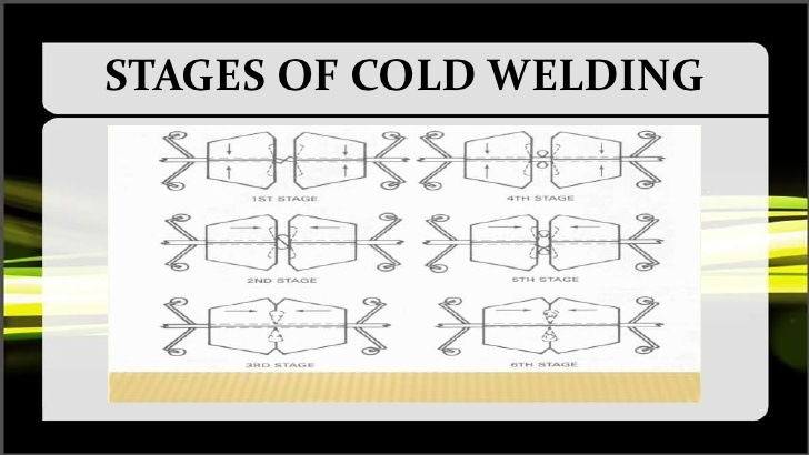

Cold welding - Wikipediahttps://en.wikipedia.org › wiki › Cold_welding
Cold welding or contact welding is a solid-state welding process in which joining takes place without fusion or heating at the interface of the two parts to be welded. Unlike in the fusion-welding processes, no liquid or molten phase is present in the joint.

Interesting. I still don't believe cold welding is a factor for three reasons:
The fusion mechanism is degraded by contamination between the two surfaces of the same metal. In order for cold welding to work, both surfaces need to be mechanically cleaned to the point where there are no impurities. Unless someone is sanding or polishing the inside of the necks and degreasing the bullets, there will be impurities in the joint
You need significant pressure. From my quick research I found that copper alloys need around 2000 N/mm2 or 290,000 psi to completely cold weld. There is absolutely no fucking way that an interference fit of a couple of thousands of an inch comes even remotely close to that kind of radial pressure between the neck and the bullet.
You need to exclude all air from the joint. Sorry, not happening. A bullet seated in a cartridge without neck sealant is not air tight.
On top of all that, IF any welding takes place, the joint will be subjected to massive shear forces which make welds fail much sooner than tension or compression.
I'm starting to think that what many think is cold welding is just very, very mild galling.

Galling is caused by cold welding.
What Is Galling? - Bortechttps://bortec.de › blog › what-is-galling
While cold welding is the merging of two parts, galling is the friction damage that follows cold welding. When two parts are cold welded and then moved by compressive forces, galling damage occurs on the surface of both materials.

Sorry, galling is the result of friction, which creates heat. The very opposite of cold welding. There is zero relative motion between two parts being cold welded.

What Is Galling? - Bortechttps://bortec.de › blog › what-is-galling\\
Your assessment of cold weld VS galling is 100% wrong. A minute ago you said you cold welding had never been scientifically explained, now you are the expert. :ROFLMAO: :ROFLMAO: :ROFLMAO: Oh yea, thats out 308buttpirate, the instant expert. :rolleyes::ROFLMAO::ROFLMAO::ROFLMAO::ROFLMAO::ROFLMAO::ROFLMAO::ROFLMAO:

You love quoting things out of context. I said that I hadn't seen an explanation of cold welding, not that it didn't exist.
Can galling happen when separating cold welded parts? I'm sure it can, sometimes. I've also experienced galling between two parts that have never been cold welded, such as when pressing a shaft into a rotor for an interference fit. That's friction related galling.
I took your link and dug further, quickly educating myself on cold welding and pointing out conditions needed for cold welding that are highly unlikely to be present when one presses a bullet into a case neck. How about you address those points? Or do you not have the intellectual horsepower to do so?
Sometimes we handloaders mislabel/appropriate terms from elsewhere to describe what we observe. Why? Because it fits.

Advantages of using cold welding
The most noteworthy advantage of cold welding is that the resultant welds have the same bond strength that of the parent material. This feat is very hard to recreate in metalworking.

Here is a piece of 280 brass i saved because i was surprised at the amount of jacket left in the neck. It is the same all the way around for the depth of the neck. It doesn't look like corrosion.
