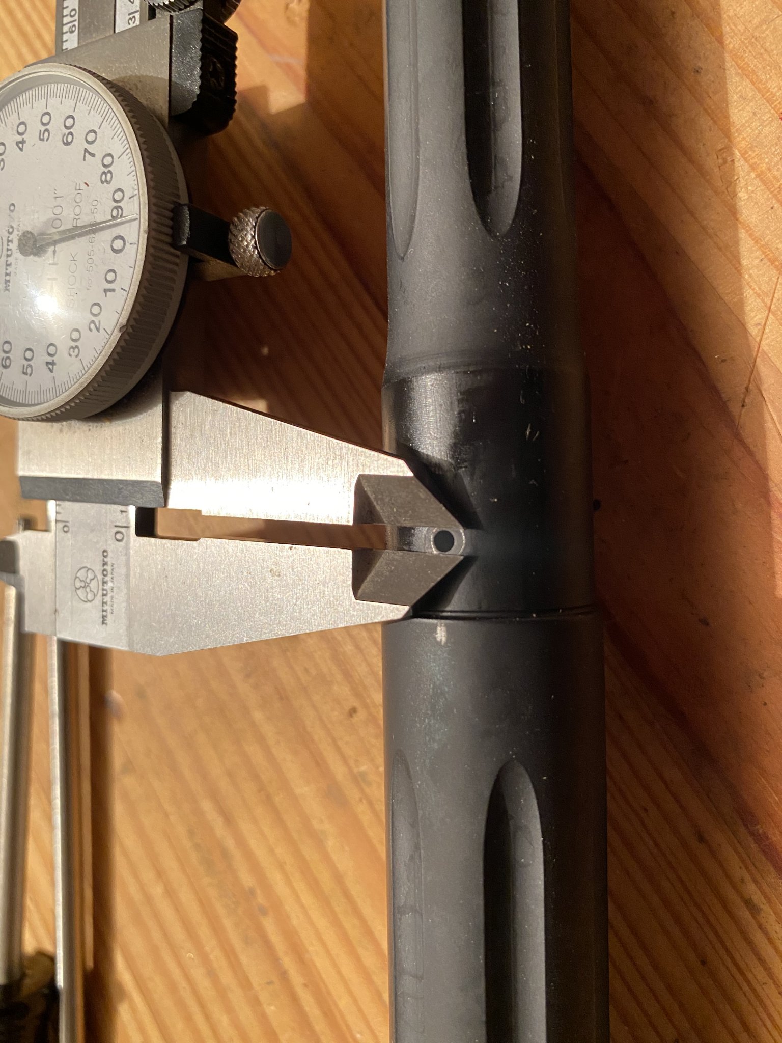

    Looking for input from people with more knowledge than mine.
    I thought an 18" rifle gas barrel in .308 should have somewhere in the neighborhood of a .096" gas port? I have a short stroking issue and while I lack the proper gauges, I can't get a piece of .078" hot wire through the gas port on the barrel. It will let a 1/16" allen key in with some room to spare (.065" max width).
    If it's off as I believe that means I got two defective parts in one order...

    The gas port on my 20” WC measures about 0.08” using the internal jaws on my dial caliper. I know that’s not the most precise method for measuring ID. The attached picture shows it is smaller than 0.096”. My calipers are set to 0.095” because they run about 0.001” small.

    Using a dial caliper to measure a gas port is NOT the proper way to do it.

    Cycling but not locking back is about 0.005” in diameter.

    Find someone with a proper pin gauge set... Gunsmith, or someone.
    Knowing what your gas port size truly is important in this case for sure.

    Use a drill bit to check the port hole?

    FWIW, I just checked my Criterion rifle length gassed, 18" 6.5 CM gas port... .080" ( uninstalled )
    I realize not truly helpful in context to your 308 RLGS gas port size.. but

    use drill bits, the shank end. fractional drill bits, wire gauge drill bits, and alphabet size drill bits. it's the next-best thing, short of acquiring a pin gauge set. Pin gauge set actually pretty reasonable on Amazon, chinese I'm sure, though.

    The solution is easy for a guy like me, just indicate the barrel in the mill and drill the port larger. If you don't have the equipment to do that though, be really careful, or find someone who does. I wouldn't step up more than .005" on the port size without re-testing, proceed slowly.

    I did cut the end of a q-tip off and jam the stick into the port, and then measured the stick with my calipers. It is going to be the fastest thing that I have available without spending additional money. It came to .073", again +/- a few thousandths because that is a less than ideal way to measure.
    I still am only finding info out there that says an 18" rifle length on a .308 should be in the .096 range. However I am not the authority on what it should measure, so I'll be hitting Criterion up in a few hours.

    I'd just widen the gas port... Don't go to big.
    I have a second spring, so I did cut four coils out of one for shits and grins. I didn't find that it really made a difference.
    The carbon deposit from the gas block on the barrel around the gas port is beautifully centered. The gas block sits a few thousandths off the shoulder, and it lines up perfectly with the dimple. I've had this gas block off five times now as of today.
    I inspected my gas block when my second gas tube came in, and there were no obstructions leading to the port in the gas tube.
    After ~20 rounds the bolt is dirty, but not nearly as dirty as my 6.8, 6.5G, or my .223s get after 20 rounds.
    .078 and .093 carbide bits were ordered and I received an email that they have already shipped.
    Make sure you tape the bit so you don't blow through and hit the rifling on the opposite side. Also, not sure, but I think you want to go slow to prevent burring as the bit goes through. Cutting oil wouldn't hurt either. Would help cut down on the heat either way doing both going slow with cutting oil.
    Reactions: diggler1833
    Definitely putting a cleaning rod in the barrel to prevent strikes on the opposite side.
    I recently may or may not have received 55 gallons of environmentally friendly gear oil off of a wind turbine jobsite. That stuff may or may not be some of the most awesome stuff I have or haven't used. LOL. Seriously, they let a buddy who worked on site have (4) 55 gallon drums of the stuff when they finished the project. It's like $3,750 a drum.
    Wrong thing to do as far as slow, going slow is more likely to bend metal into the bore. When drilling gas ports we aren't concerned with saving a $4 bit. Spin it fast (cordless drills aren't that fast anyway)and apply very little to no pressure. There is already a hole there, it isn't like we are trying to drill a hole through a piece of metal plate, the barrel will cut like butter. If the hole is already .80 he is only cutting .0065" on each side.
    ETA -stainless barrels are more likely to develop a burr since the material is so soft, it just bends out of the way of the bit. Criterion uses 410 ss so that will be better than 416.
    Everything that I've read, points to an undersized gas port. I can open it up if I dare. I do have at least a 3/32 bit and a 2.5mm bit... but that kind of brackets me around the .096" that I'm reading about and neither of them are carbide. I also have a drill press, but no way to truly indicate on it either so my likelihood of breaking a bit off goes up a little. I work on ranch equipment all the time, but I'm definitely not a professional gunsmith. I've seen guys do it with a hand drill on YouTube.. but looks half-assed at best, and I'd like to keep the accuracy of the barrel...If I wanted a barrel with a bunch of burs and a solid 2 MOA guarantee, I would have saved a few hundred bucks on this project. This will eventually be a hunting rifle, not a blaster.
    If you care about the rifle at all, do NOT just use whatever drill bits you already have that are close. You don't need carbide if the barrel isn't nitrided, but you do need sharp drill bits to avoid leaving a burr. This isn't ranch equipment, and requires a much more delicate touch and attention to detail if you're going to avoid butchering it.
    Also, you need to step up in sizes to get what you want, the difference between .080" and .096" is huge, even though it seems like small numbers. If you're right on the edge of function with ~.075" right now, just going up to ~.080" may be enough to make it cycle military ball ammo.
    Go to a local machine supply store like Fastenal, Tacoma Screw, etc, (not Ace hardware or Home Depot) and buy some good drill bits intended for steel. You want a 135° split point in a good grade of HSS like M42 or maybe cobalt. Not carbide, it's not sharper and you'll probably break it in the hole without using a mill. Jobber length drills are fine and the most common. I'd buy a few sizes, probably #47, 45, 43, and 41. Those will give you reasonable size steps between the .073-.075" where you are now and the .096" number you found (which is a #41 and probably way overgassed IMO). Drill bits like these are only a few bucks each, so we're not talking about big money here. Also, stepping up in small sizes and using a sharp new drill bit each time will keep the burr down to little or nothing if you do a good job. You do NOT want to power through the hole, let the drill bit cut but on the slow side for feed rate is better. I'm speaking as a machinist here.
    Personally I wouldn't do this job without at least a solid vise in the drill press to hold the barrel. You can chuck a #48 or 49 drill bit (whatever fits your gas port) backwards in the drill so just a bit of the shank is poking out, and use that to locate the barrel so the hole is aligned under the spindle. Then insert the correct drill in the chuck without moving the setup.
    Also - put a cleaning rod or 1/4" steel dowel down the barrel so the drill bit hits that and not the other side of the bore.
    with the drill bit diameter, use your high-school math, the pi-R-squared thing, to calculate the cross-sectional area of the gas port hole. I usually go up in increments of 10% to 20% in CSA, depending on how-badly-undergassed symptoms. For instance, for a current gas port dia of 0.075, a new diameter of .0804 is 15% more gas.
    agree with everything Yondering said. very slow feed rate to keep the cut very clean.
    Yup. You can do the math, but the easy way is to just go up one or two number sizes on the drill bit at a time (the number sizes are not a consistent change from one to the next, but I like to jump .003-.005" at a time for tuning a gas system once I see some sort of function). I avoid jumping more than that if the rifle functions at all; it's easy to go too far then you've got an overgassed rifle just like every other 308 out there, instead of a precisely sized custom port that matches your rifle.
    I actually made that mistake on my last barrel just a few days ago; a #51 (.067") was too small and only cycling the heaviest ammo with no lock back, much like the OP's rifle, so I stepped up to a #49 (.073") and it ended up being too much; it runs well but slightly overgassed, with ejection at about 2:00. (This is on a 12.5" 243 LBC, different cartridge, barrel length, and gas system, so the numbers don't apply to the OP but the principle is the same.) I'll end up using an adjustable gas block on that one, and feel kind of bad about missing the goal there. Fortunately it's just my own barrel and not a job for somebody else.
    OP - as you can see, drill charts are a necessity for this stuff, but you can download them free online, just google search for "number drill chart". I like the Starrett chart: http://img-cache.oppcdn.com/img/v1....782x1220/6135660bf0eabdfa5a121ba102305911.jpg
    I appreciate the input. Yeah, I went ahead and ordered new bits for the job already...hope that they're here within the next day or two.
    Definitely using a cleaning rod down the bore. I've got an excessive amount of old aluminum shotgun rods that aren't doing anything but collecting dust.
    My neighbor across the highway has a vice for his drill press, so I'll be doing it at his shop.
    This is why I always buy generously ported barrels over uh...those gassed conservatively. I know the preference on forums is for soft shooting, but I'd rather mess with buffer weights & springs than have to re-drill a gas port. YMMV
