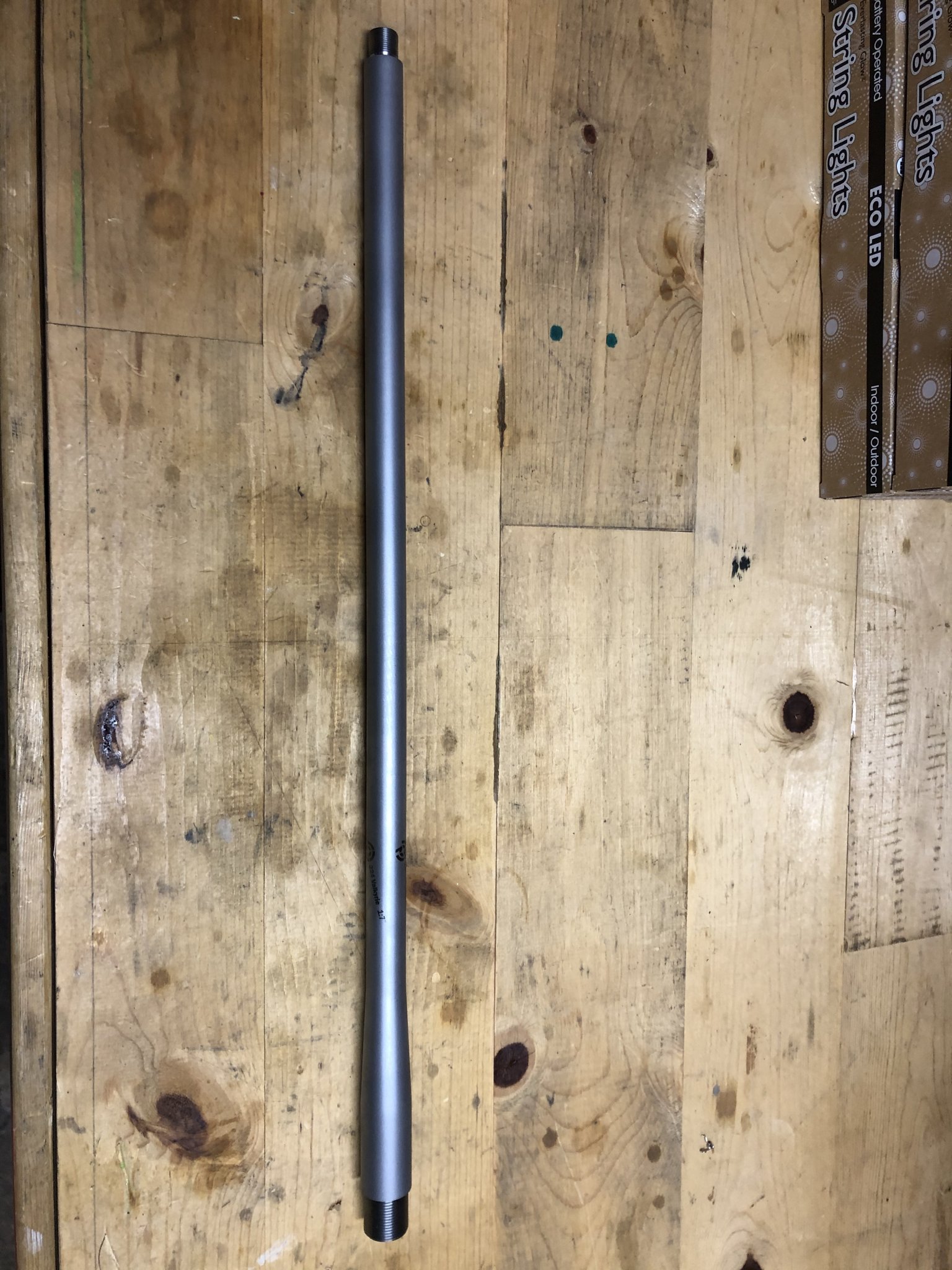

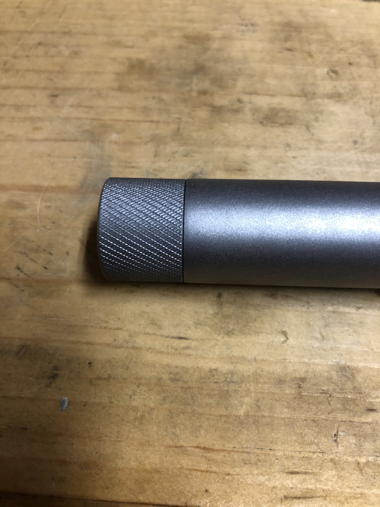

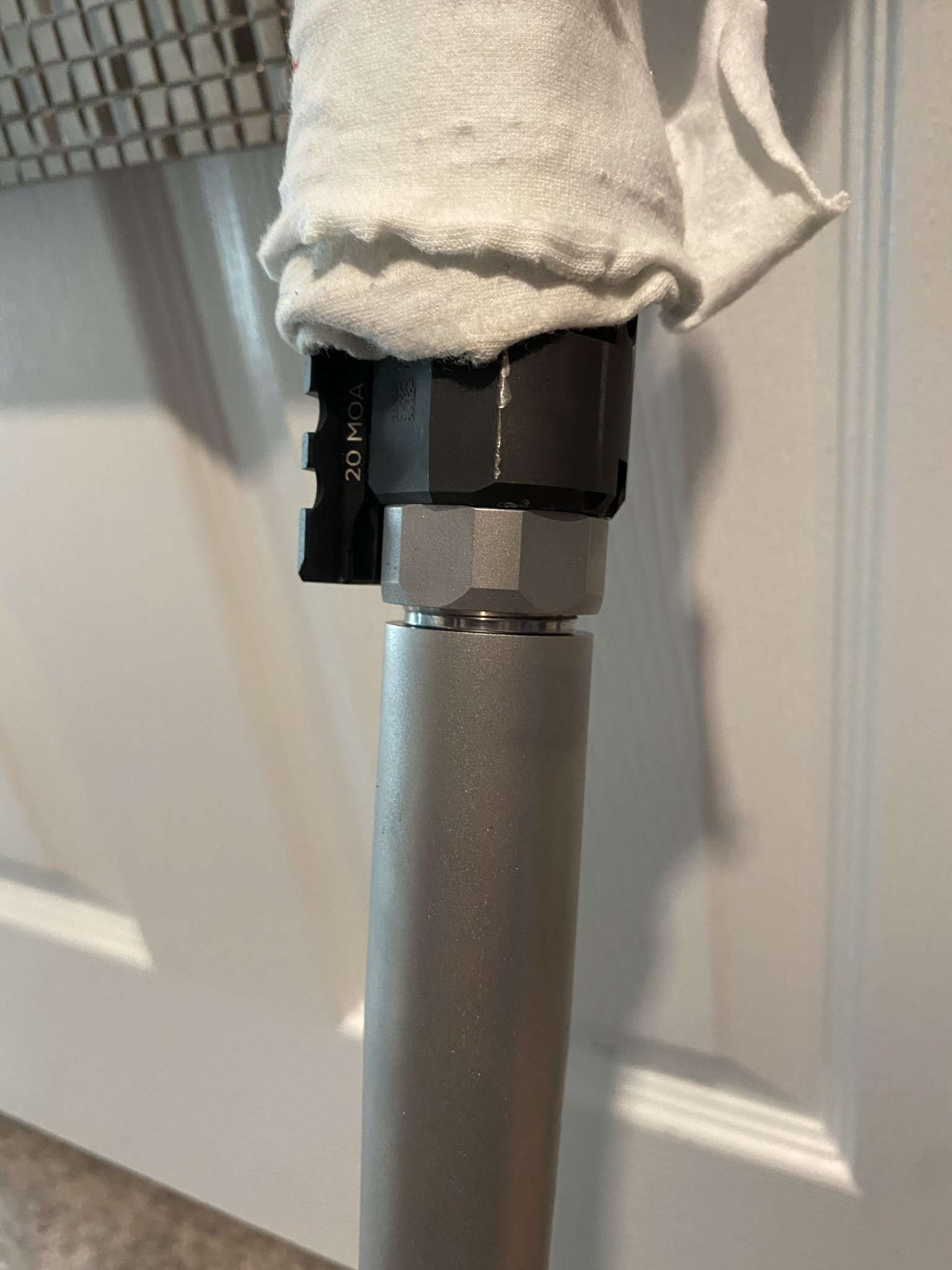

The one that was spun up for my Origin was snug, but was able to spin on by hand.
Did you apply a bit of anti-seize?
I did not but this is extremely tight do you think it’ll help? It goes in fine then builds up resistance till it gets stuck and it’s difficult to even unscrew. Theres a very noticeable gap on the nut as well thats as far as it goes (see pictures)
I screwed the old barrel back in just in case there was damage done when I removed it but it screws in easily. I also took the barrel nut that came with the new barrel and screwed it on the old barrel to see if it’ll fit fine and it did.
I screwed the old barrel back in just in case there was damage done when I removed it but it screws in easily. I also took the barrel nut that came with the new barrel and screwed it on the old barrel to see if it’ll fit fine and it did. View attachment 7296208View attachment 7296207
It’s not going help that much, if that’s where you’re at...
Mine was a shouldered, I’d give them a call.

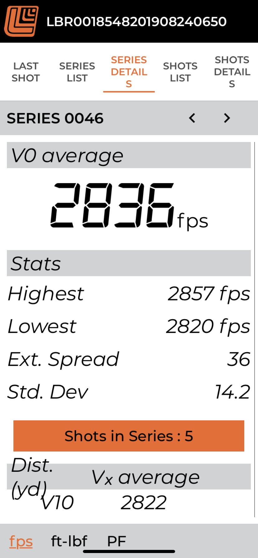

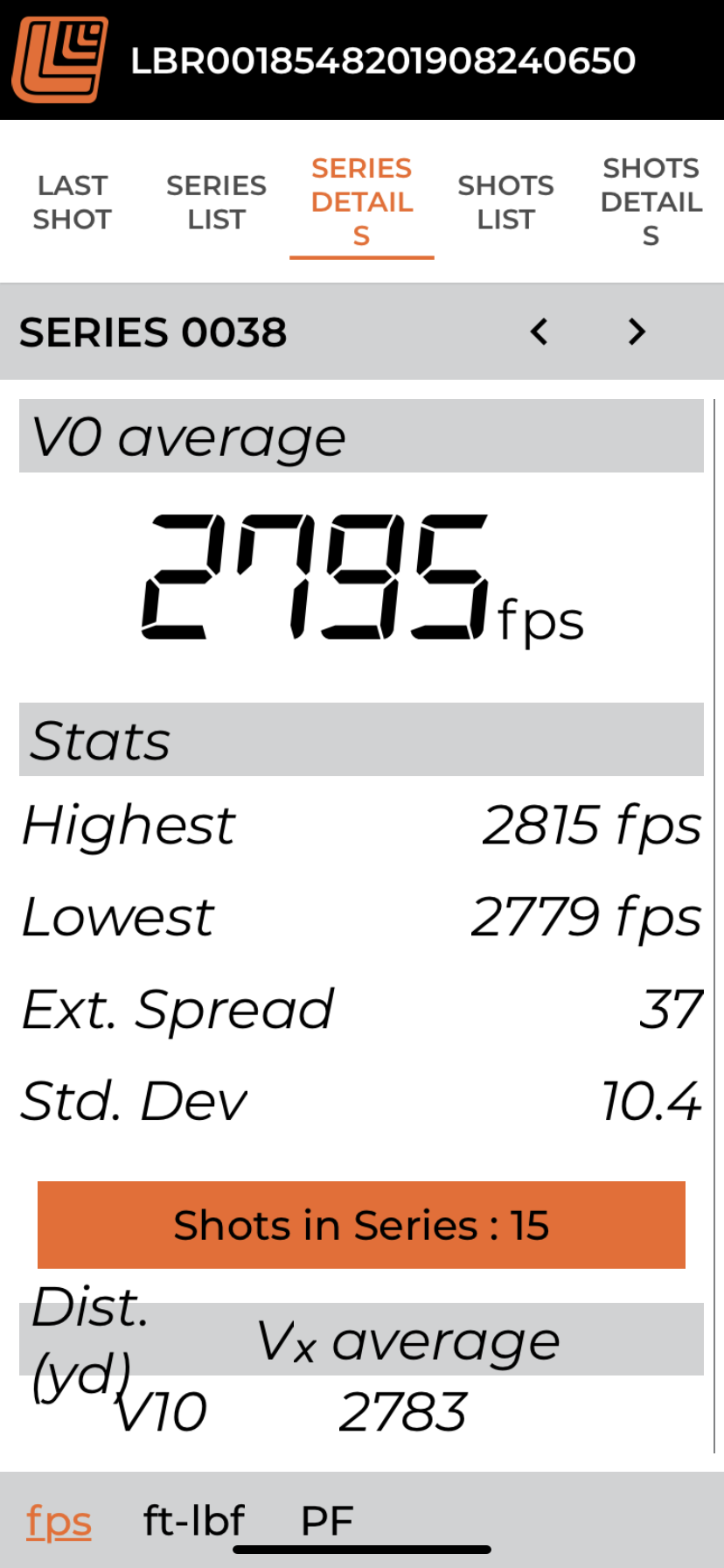

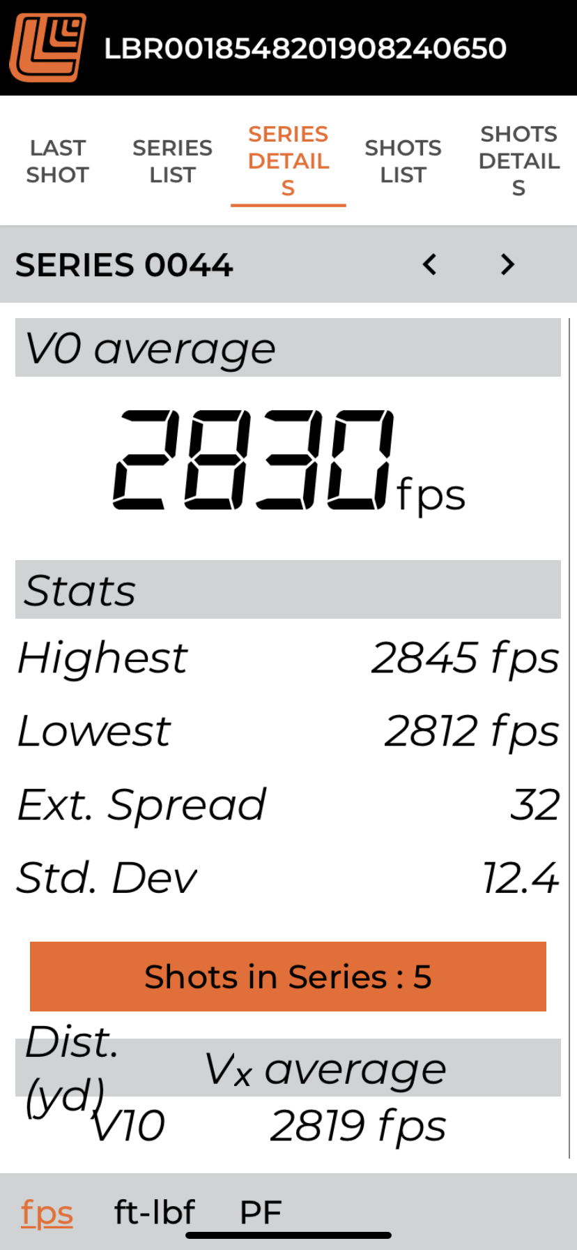

Shot my 260 a bit more, just some info for everyone. I have the velocity for the first 15 rds, shots 70-75, and 96-100 all same load. I also went up .8 in charge for shots 102-105 and gained quite a bit. 149 rds total and now I will start load developement with the “new” saterlee way which is to test wide range of seating depth first and then do his ladder test. Will let you all know how it goes. 2795 was first 15, then 2830 was 70-75 then 2836 was 96-100. Shots with new charge was 2901 102-105 and then the shots 148 and 149 went back down to 2879. I think it is stabilized now.

Ok barrel and action have been shipped to PBB. contacted Logan this morning and he said to send them in and they’ll sort it out. They’re calling it their fault and will adjust threads to fit my action. Guess I have to wait just a bit longer.
You’re in the middle of marginally stable, have your shot these at distance? how are they doing? I’ve never had anything that was marginally stable actually shoot well.

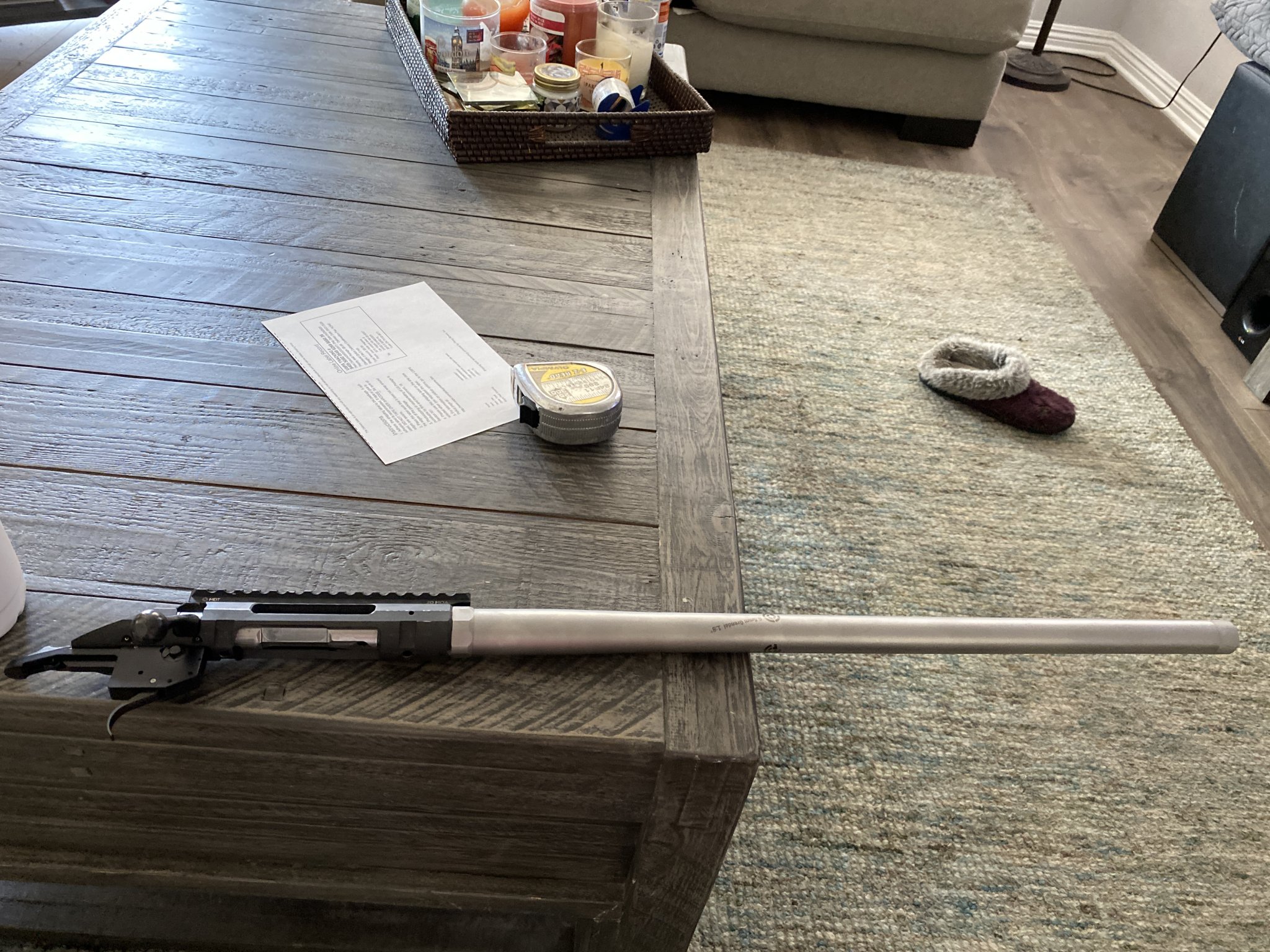

Well problem solved, it was in fact a 1/8 twist not a 1/7, they offered to replace the barrel or refund. I chose refund since I have one of their 1/6.5 twist barrels for a Bighorn that my buddy originally ordered through me but decided he didn’t want to go that route anymore. In the 1/6.5 twist I’m doing very well with 88gr ELD and 90gr SMK.

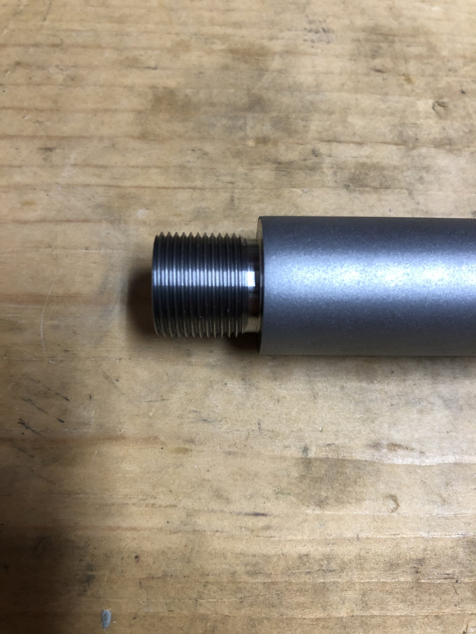

I had the same problem with a nucleus barrel but mine wouldnt even go a whole thread into the action. Measured the threads and the minor diameter is over sized. Had it also checked on an optical comparator at the aerospace shop I work at to confirm it which it did. Talked to preferred and they said they never have problems with barrels not screwing into the action and theres something wrong probably with my nucleus. Which is bs cause I have another barrel from them that fits perfectly and 2 savage prefits that fit great to. But they only way they said it can be fixed is to send my action to them so the barrel can be fitted to it which defeats the purpose of prefits.
Basically what I had to do as well.
I didn’t send my action in. MHSA confirmed threads on the barrel were too shallow and talked to PBB and they took the barrel back and cut the threads properly. Seems to be pretty common unfortunately.
From what I'm seeing on this thread seems so even though they said they've never had this issue on any of there barrels. Probably the last barrel I'll order from them after this. They dont seem to want to admit it's there fault that it's bad even though pictures were sent to show that the threads weren't cut deep enough.
I had one of their first nucleus barrels. Like a lot of other people here, minor diameter of threads was oversized. Sent it back and they fixed it no questions asked. Figured it was normal startup hiccups but it seems to be very common.

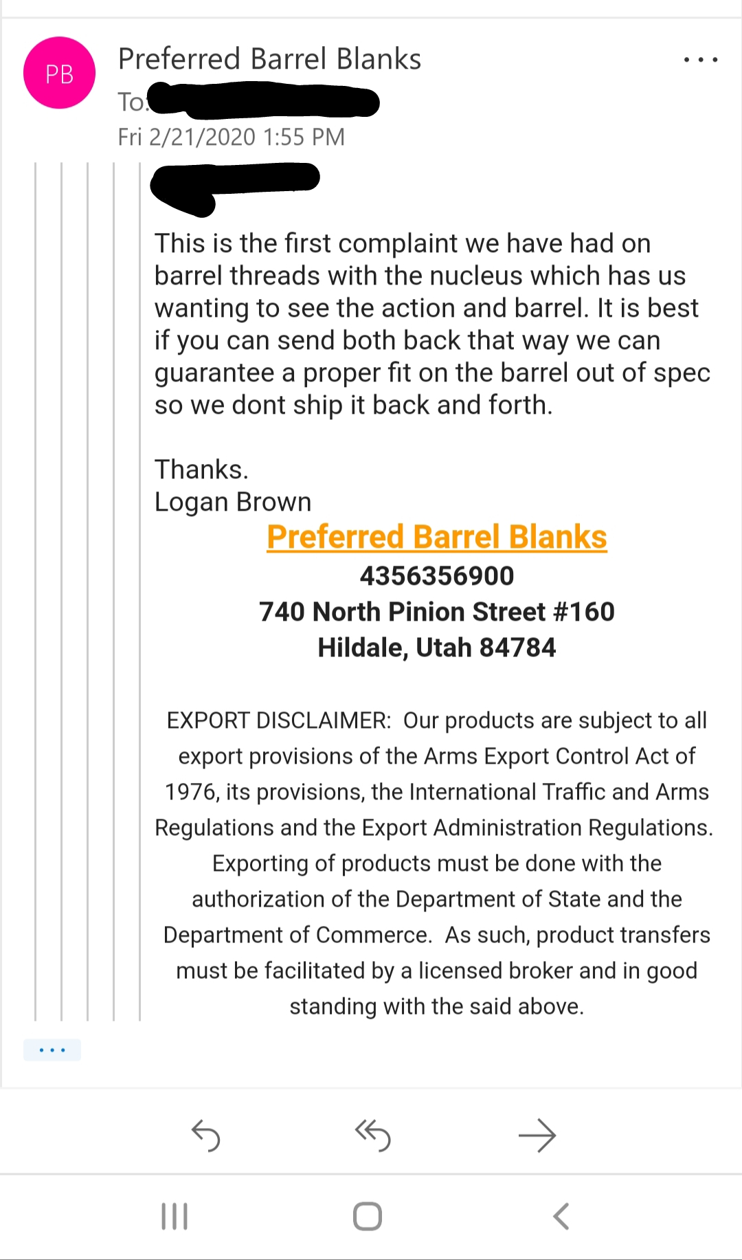

Got a call from them saying without me sending my action to them they cant guarantee the barrel will fit. Pretty much tired of there bs definitely wont be ordering another barrel from them after this. Especially after being lied to that they have never heard of that being a problem and it's probably my action that's not to spec. If that was the case then the other barrel I had from them and the savage prefits wouldnt fit either in theory. The point of the prefits is so I dont have to have my rifle sent away for a barrel to be put on. I mean how fucking hard is it to check the threads with a go / no go thread gauge. All the threads have a tolerance spec to them it's not that damn hard to spend the 30 seconds to check the threads. I'm an machinist and quality control Inspector by trade and do that shit all day every day.
Heres the email that sent saying this is the first time they've heard of it.

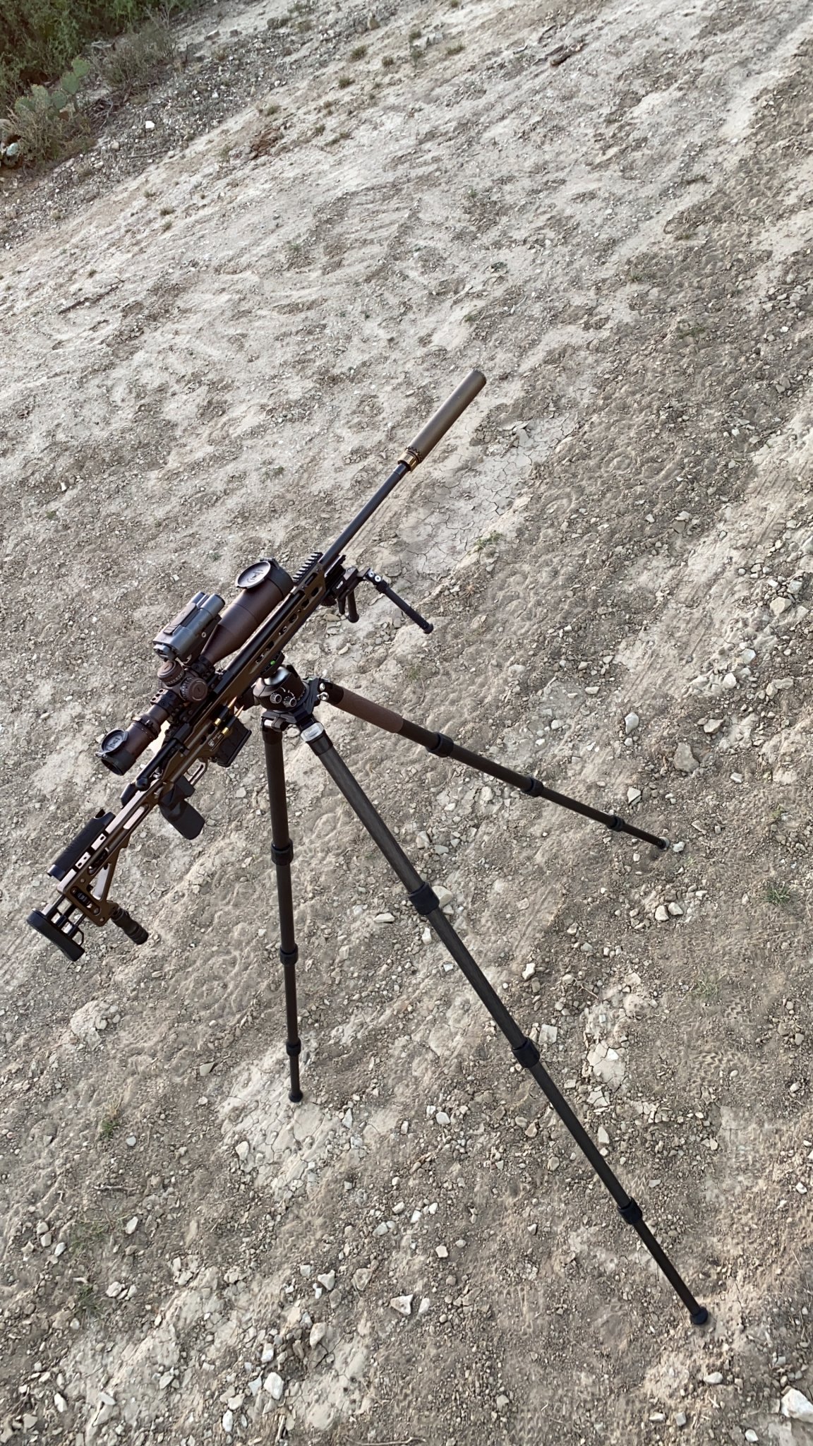

I have 3 of their barrels: 6XC, 300NM and a .458 Wildcat Chambered myself. Only have 50-60 rounds(XC&NM) down range but I'm not disappointed in their performance at distance. Wish I could shoot on paper at a range, but have to wait until the Covid thing runs it's course. Here's a pic of the 300NM being put on:

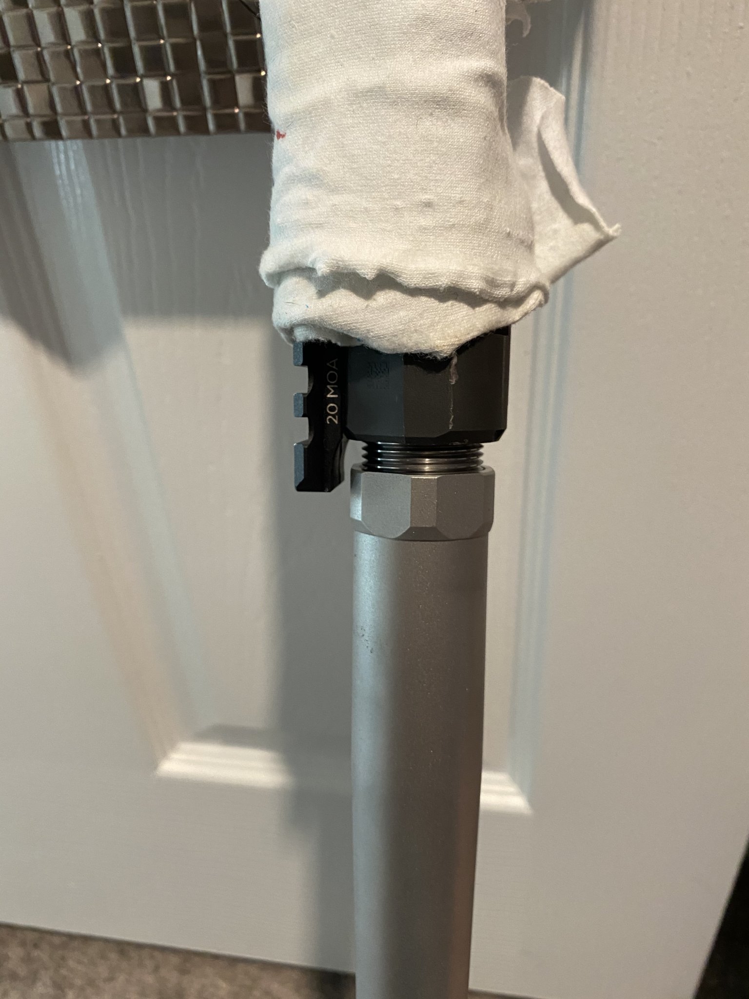

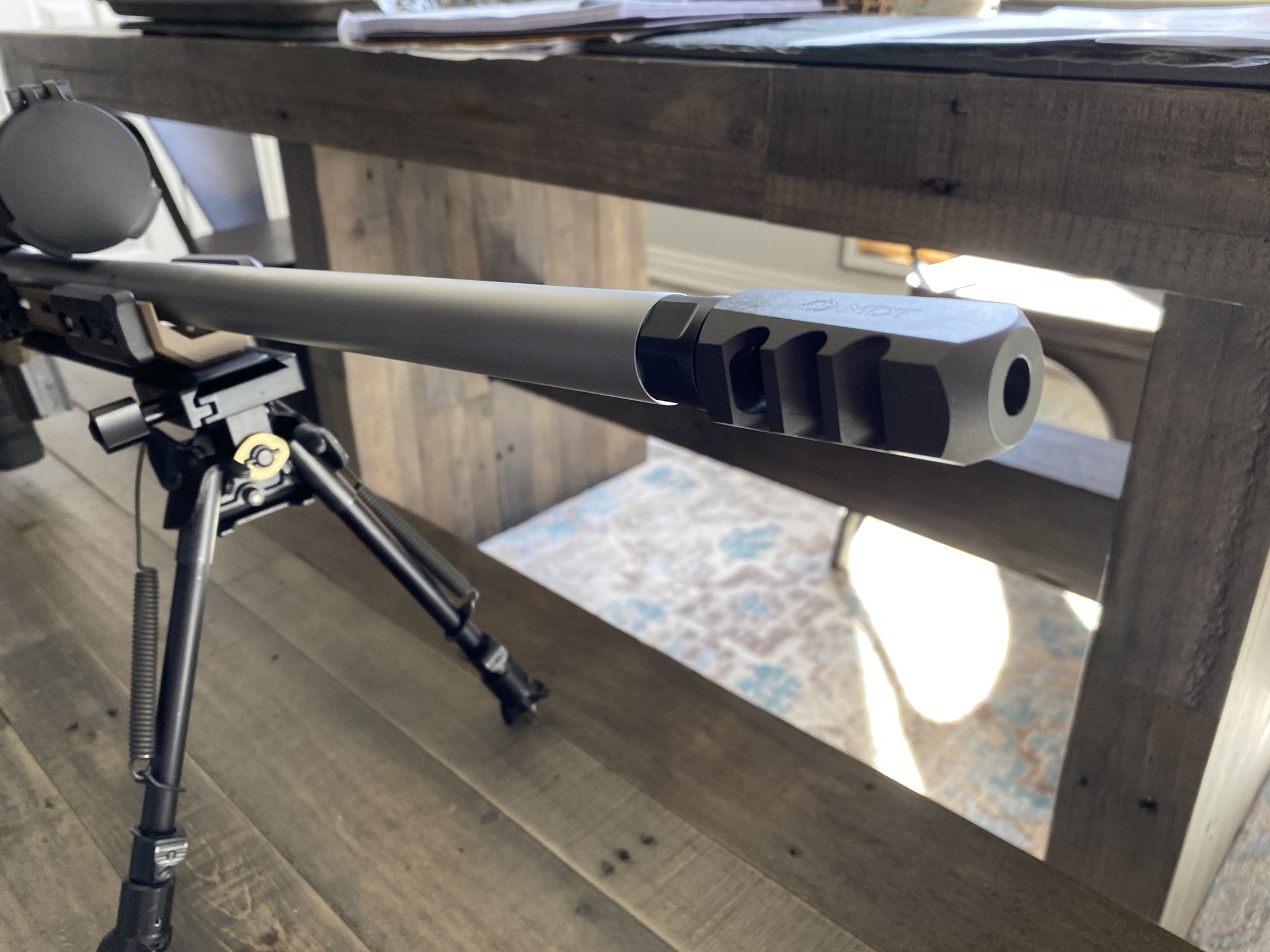

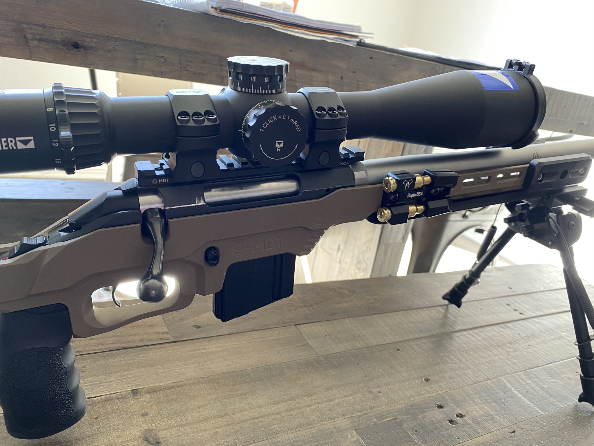

Ok got the the action and barrel back! It looks good from what I can see, cant wait to see how it performs, hopefully it was worth the wait. I would say my only complaint was the packaging, wish they would of done a better job but nothing seems to have gotten banged around. Next week should be range day, Ill post what I see.
Your action already had that "damage", right? lol

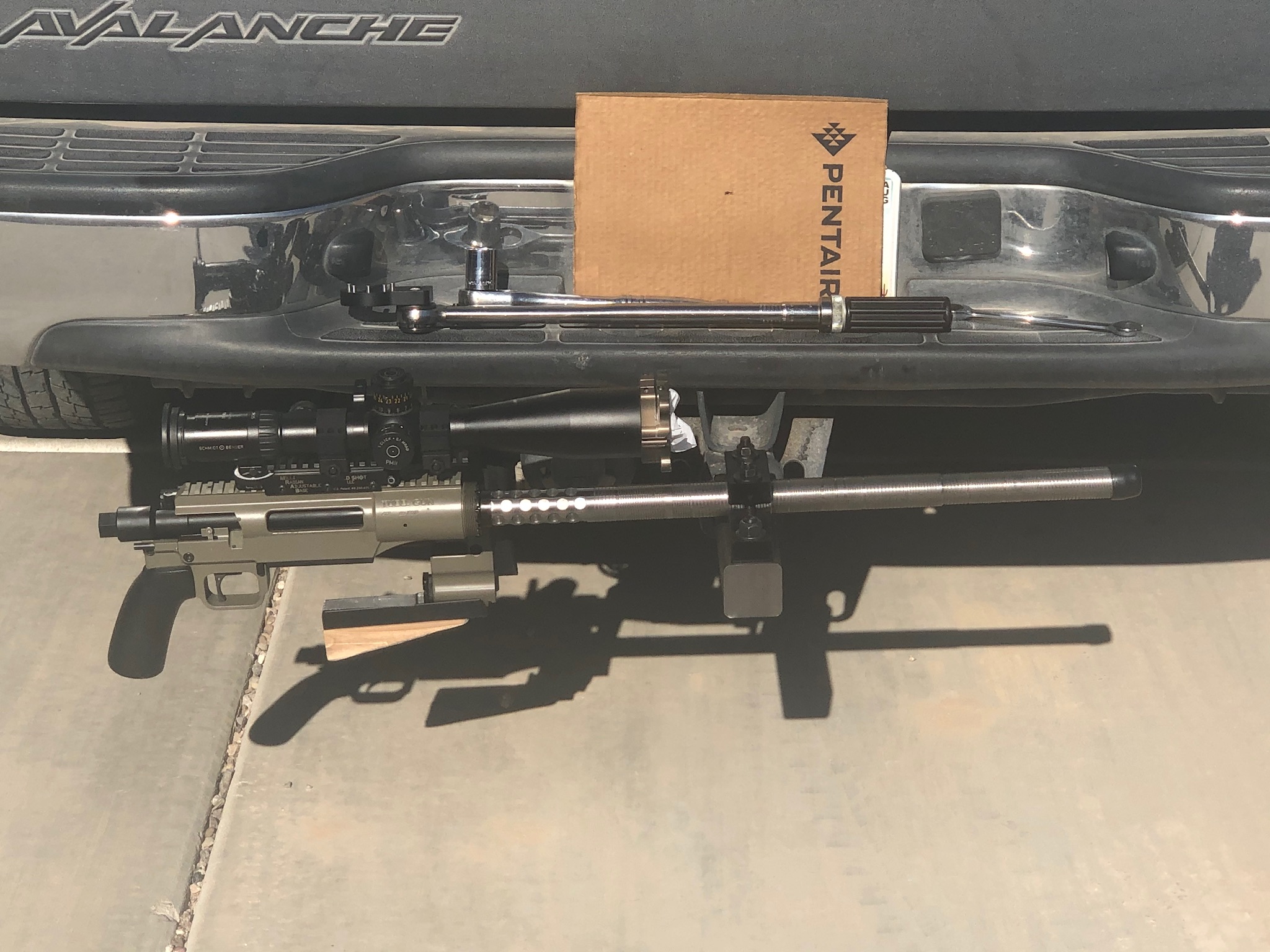

I’m planing ordering one soon, I have a tikka t3x .308 1:11 24” factory barrel, I got curious about swapping it for a lower twist rate and length, and based on your experience ill be thankful to get all the info you can provide. My first question should i go fixed shoulder or variable shoulder? Second I was planing on trying 1:8 twist 16” so I can stabilize heavy subs and 178-208 supersonics. I’m i gonna get pressure signs or waist long range accuracy by not achieving high speeds? I usually hunt Small game up to 300yrd with subs and 600-1000 yards with SuperSonics For the medium to large game. So the reason to go with a short barrel is to be able to walk as compact as posible trough trees to reach the blind. Once in the blind I rest the rifle tripod or barricade so i don’t worry about a heavy barrel, also both supers and subs I always shoot suppressed. Thanks for your help.

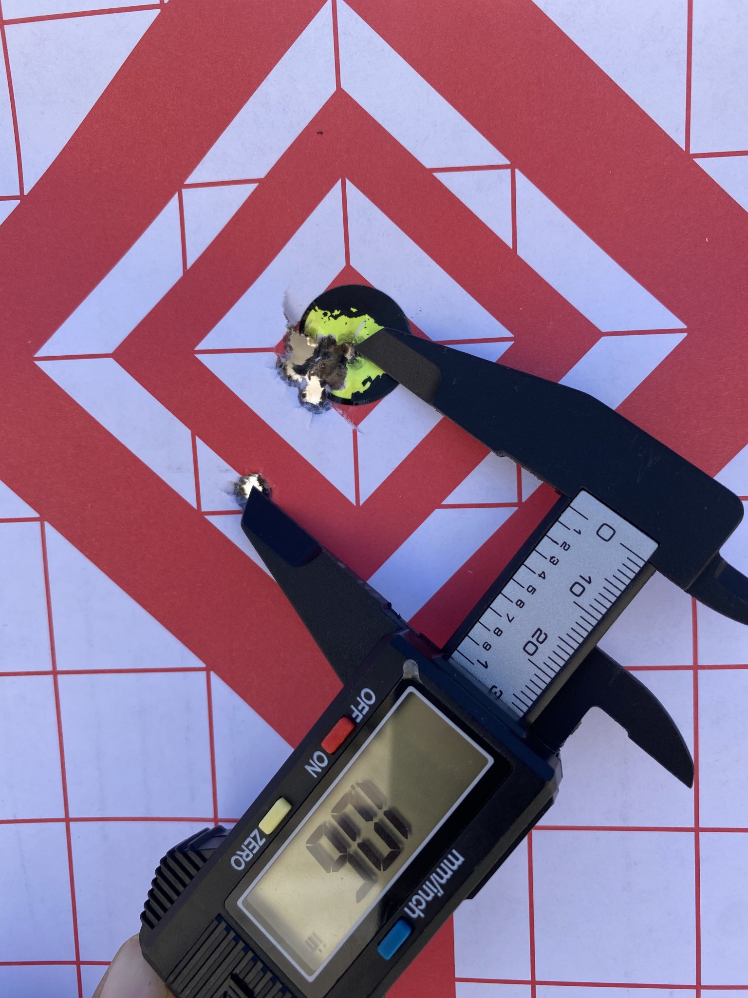

Ok took the barrel out today. I was pleased by the results and shows promise after the first 20 rounds.
first 2 groups are factory 6.5 grendel Hornady american gunner 123 gr BTHP average was 2492fps
second 2 groups were factory 6.5 grendel Hornady black 123gr ELD average was 2531fps
5 shot groups shot at 100yrd, was very happy that the cheaper ammo shot tighter, first group would of been great but I pulled one shot (3rd) wind was gusting 6-12 mph or so.

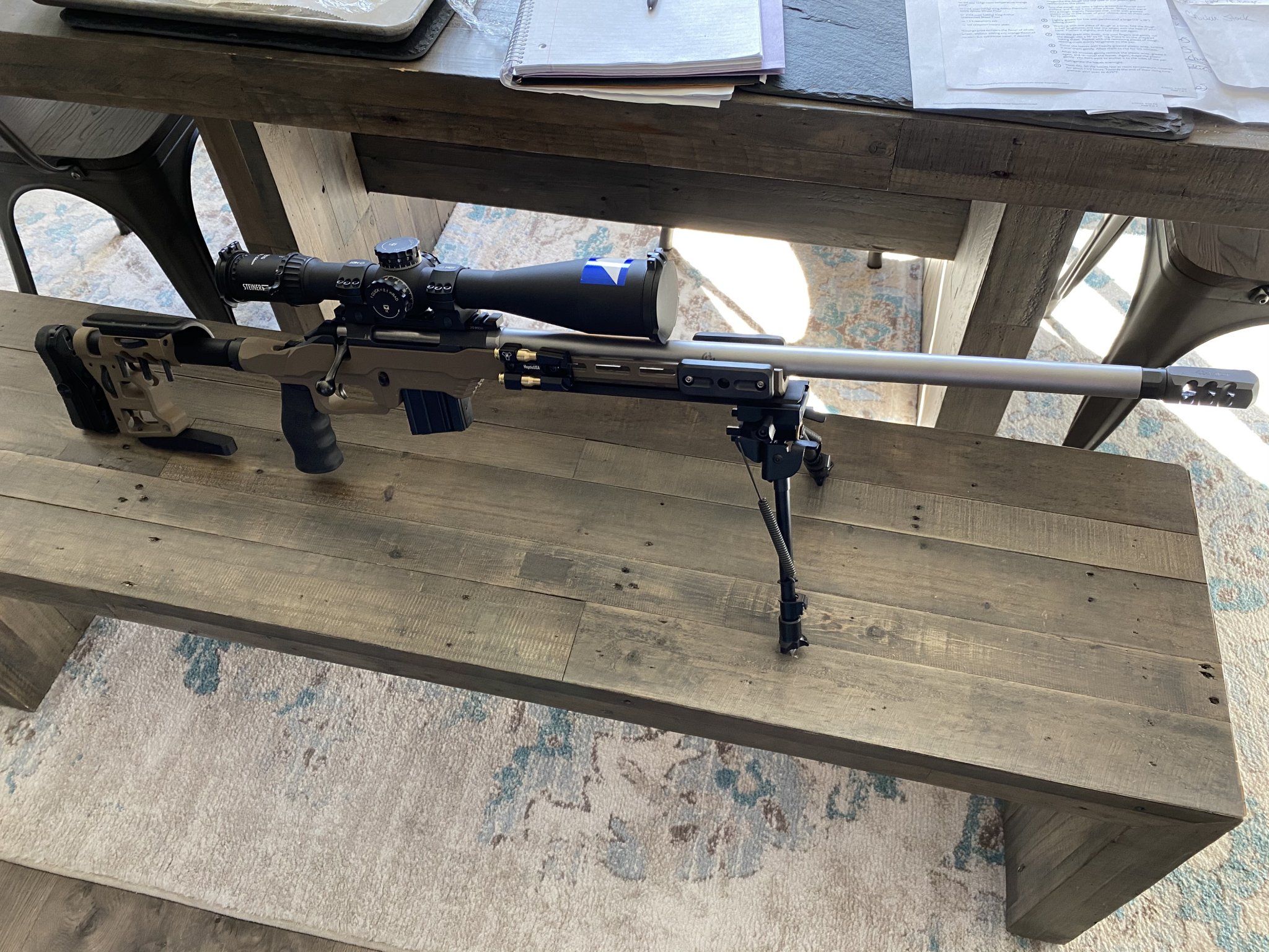

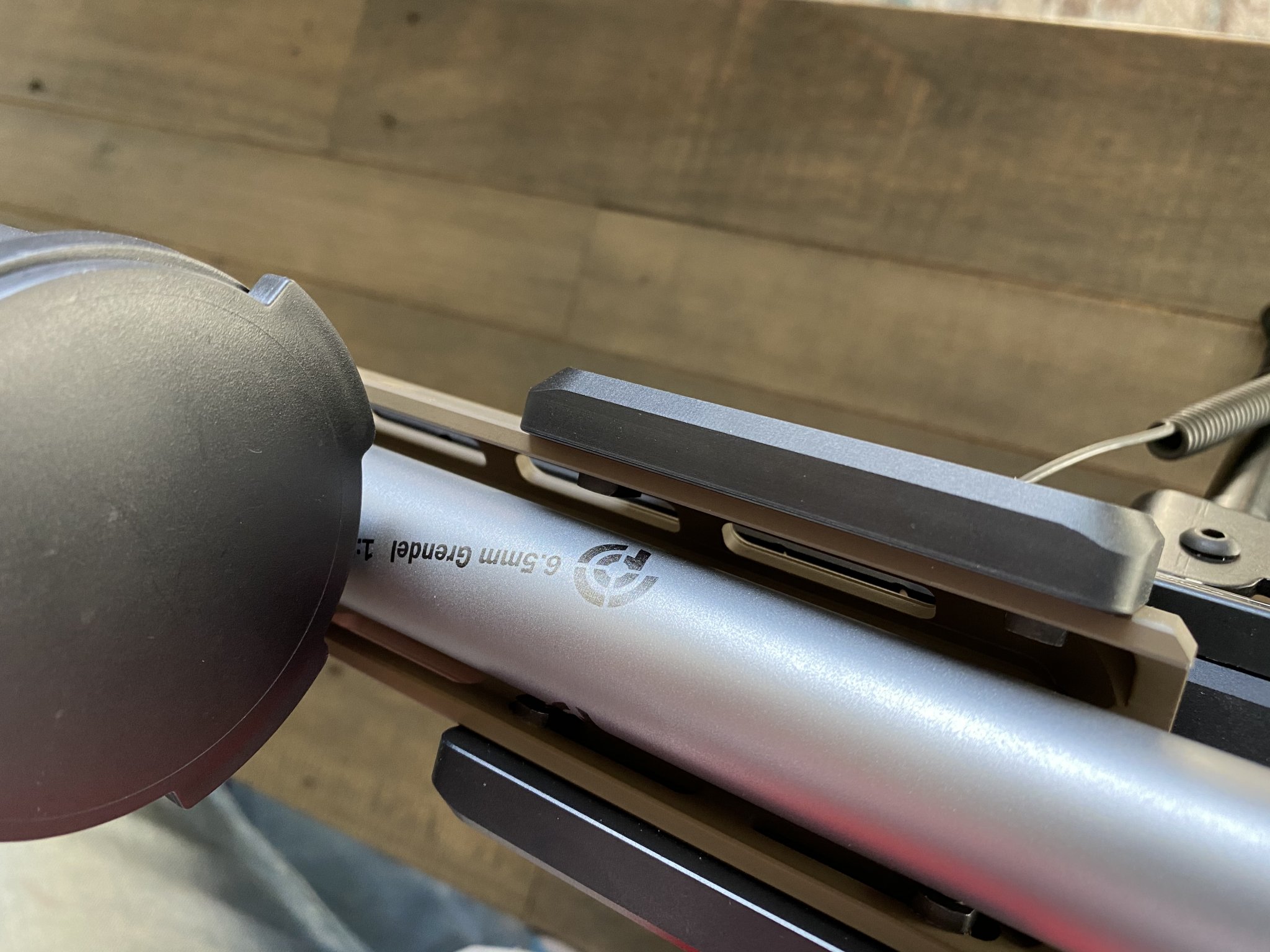

Got my barreled action in on Friday and took it out today. I was pleased by the results and shows promise after the first 20 rounds.

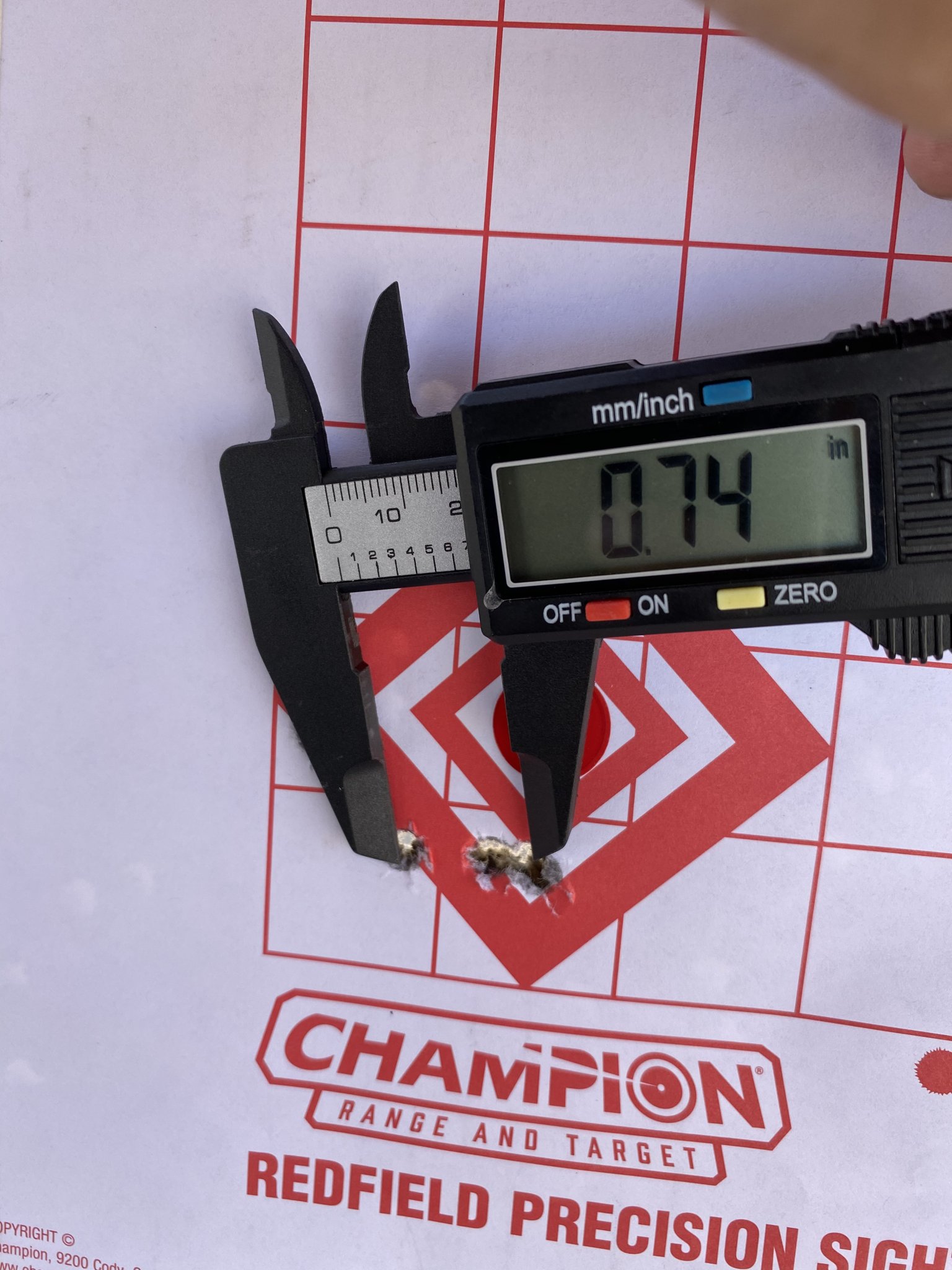

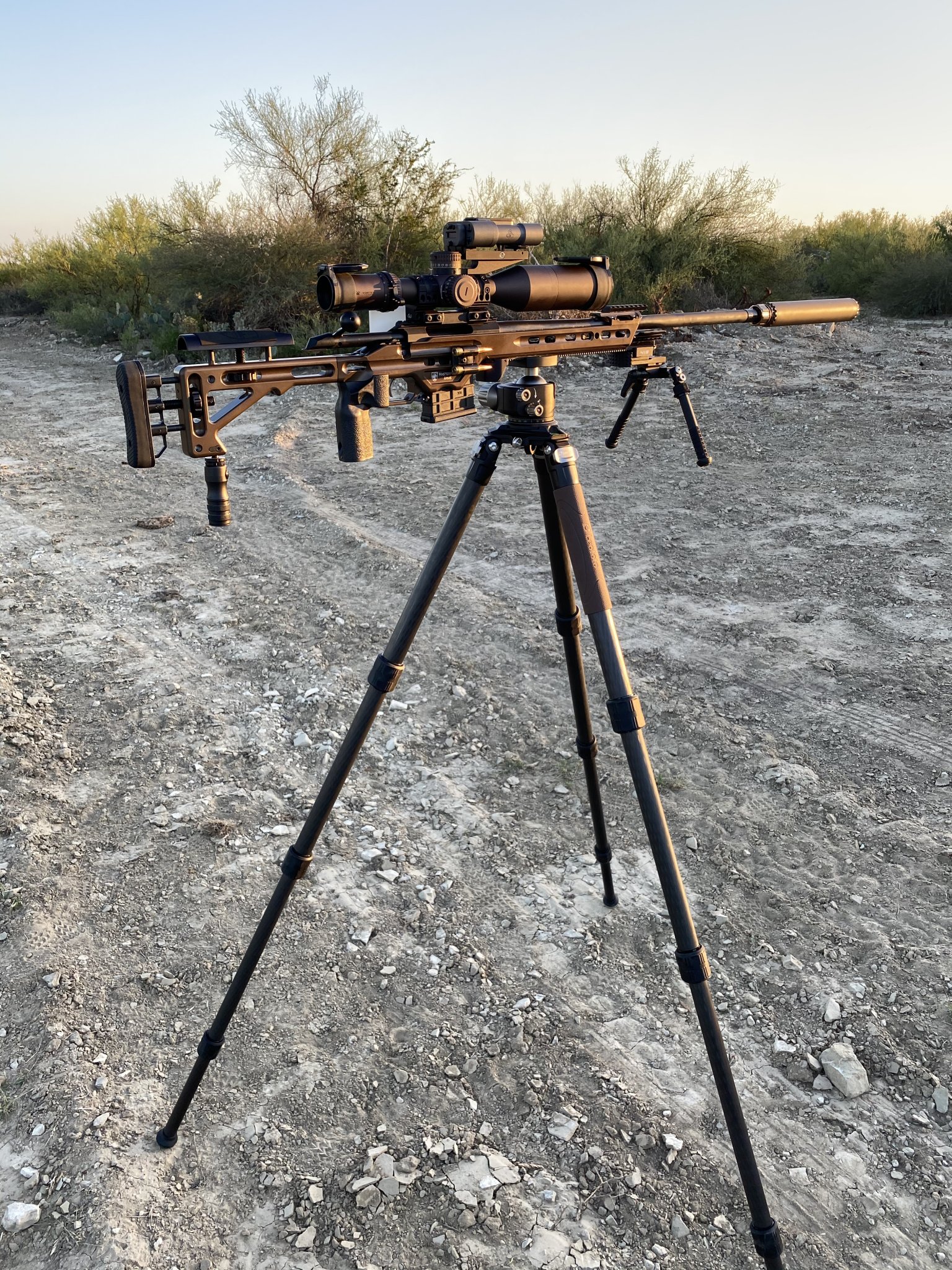

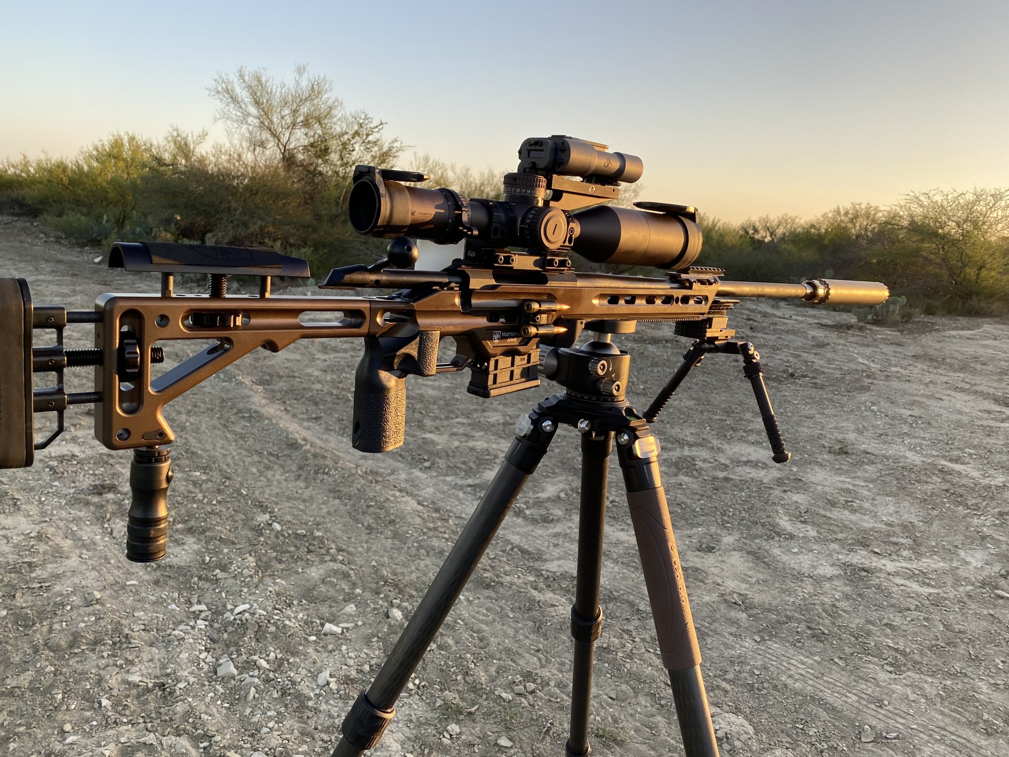

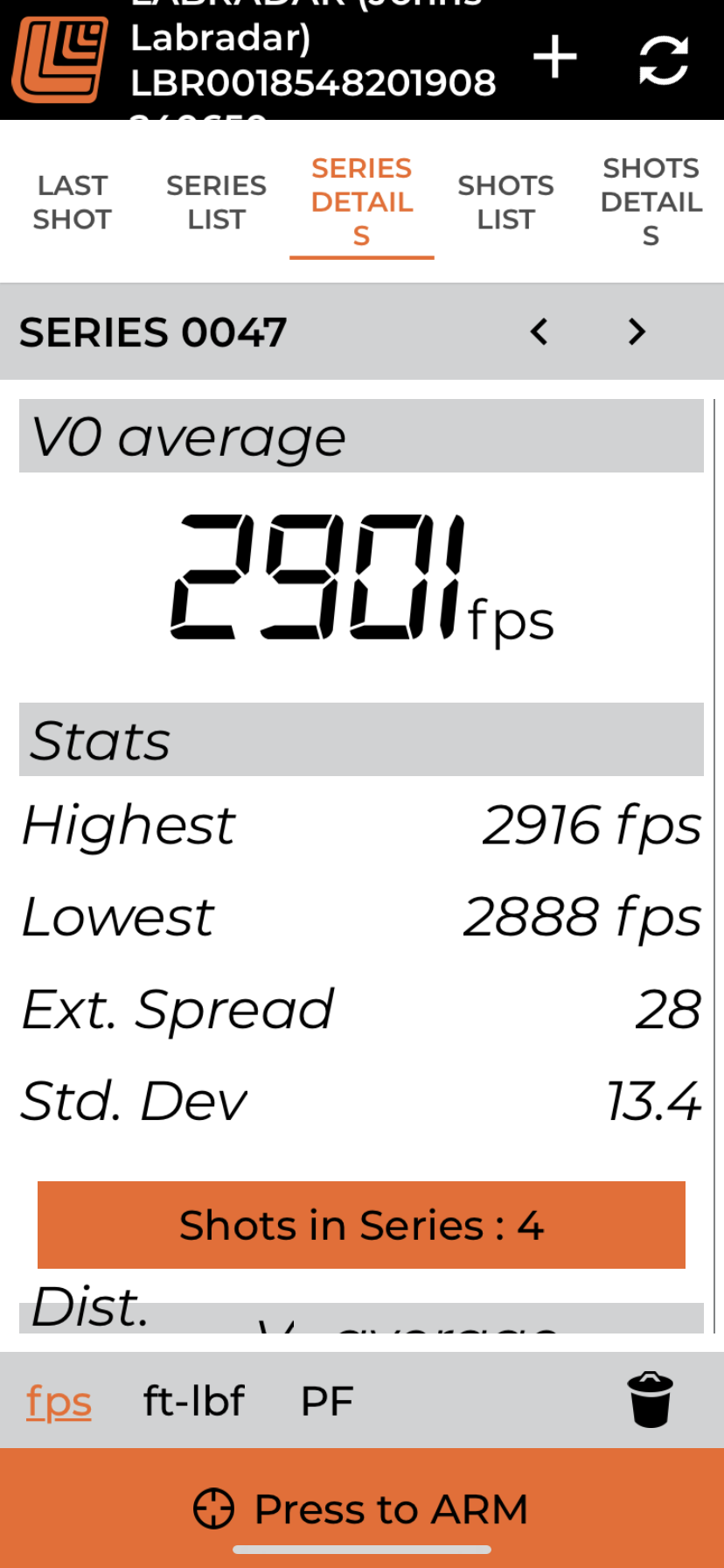

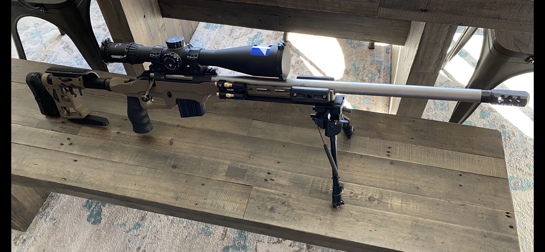

Just threw some rounds together to try the barrel out.
17" barrel 6.5 creedmoor
Thunderbeast CB7
Howa 1500
Vortex PST-2
72° fairly sunny
15-20 mph winds coming from the 2:00 direction
