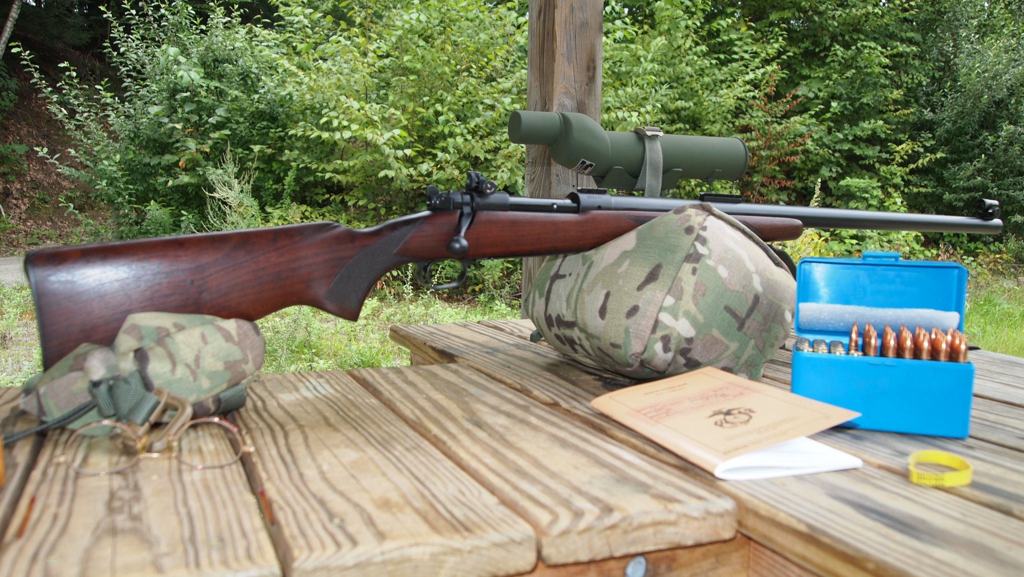

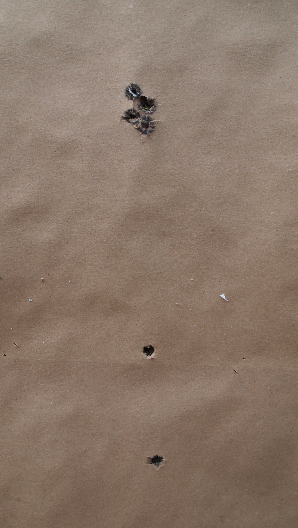

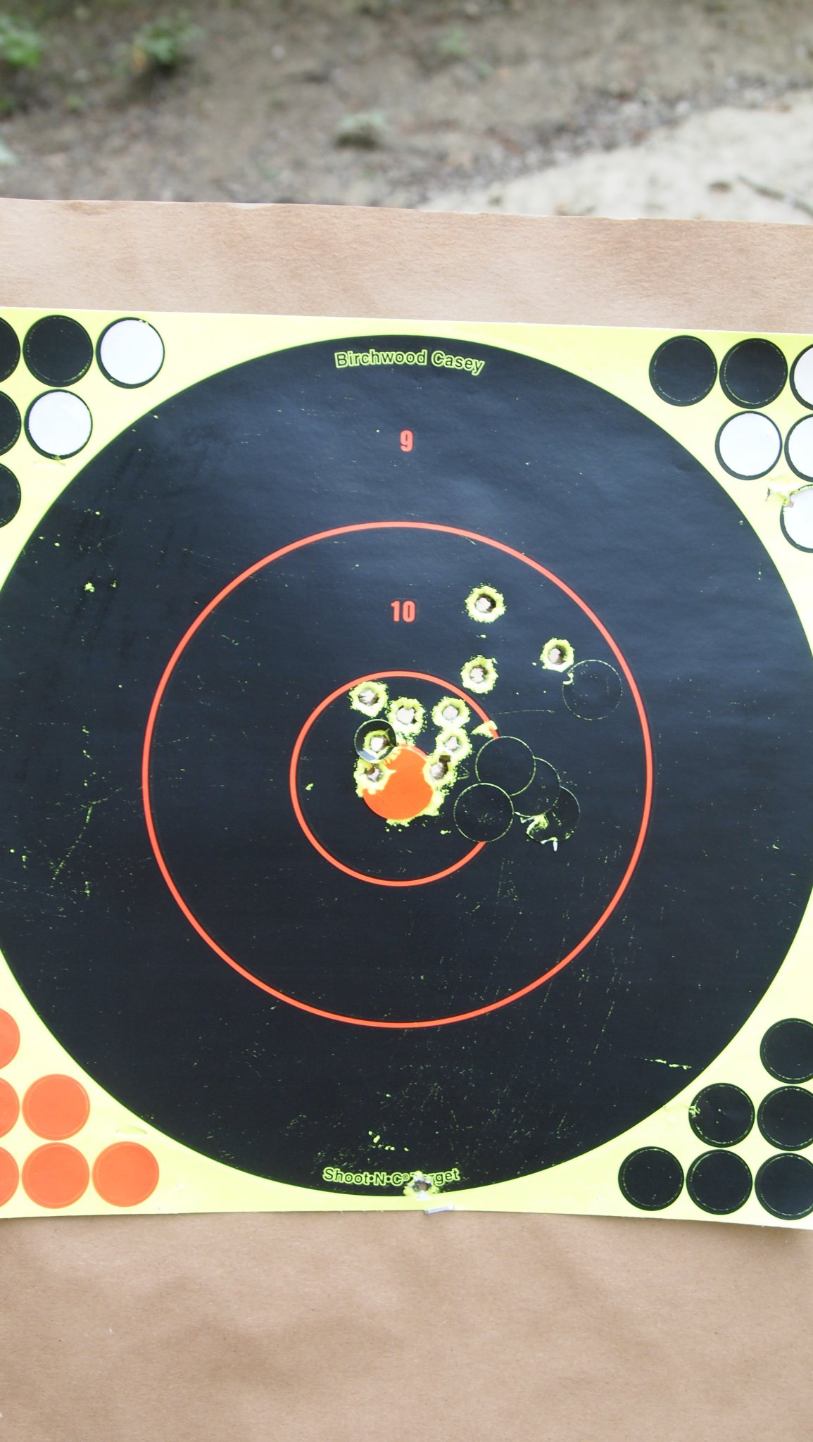

Recent Model 70 (30-06) zero at 25 yards you can see where I walked them up.
Moved to 100 yards. You are absolutely right. I walked them down/left.

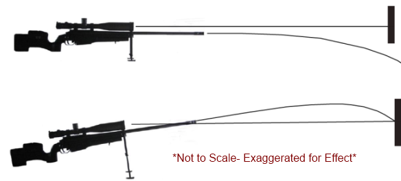

This kind of ties into my F - up regarding "a couple inches low" comment. So lets explain that so you know what that was about.
First know in your mind that it is a fact that from a perfectly level muzzle the elevation of the bullet in flight can only decrease from the point of the muzzle. The only "rise" of the bullet will result from the angle you input on your bore.
So I suggest a 25 yard initial sight in. Why 25 yards?
A. The amount of error is 1/4 what it would be at 100 yards. So if your scope is off 4 inches at 25 yards you should still be "on" a target 12"x12" wide but at 100 yards you would be off 16" and not see the shot on your paper to adjust from. Usually with a new scope the error is greater and at 100 yards unless someone is spotting the berm for you you have no idea where to adjust to.
B. A 25 yard zero has a correlation with a 200 yard zero with the cartridges I am familiar with - 5.56, .308, 30-06 - and I assume others. A "zero" represents the point where the flight of the bullet determined by the angle of elevation on your barrel and the line of your sighting device intersect.
So your sight system looks on a straight line to your point of aim while your muzzle is pointed in the direction of the target at some angle necessary to get the bullet to travel the desired distance. Where the straight sight line and the angled muzzle line intersect is ideally your desired point of impact but no it never is when you put a new scope on a new rifle as you are doing until you adjust the scope reticle to align with the bore/bullet path of flight.
So you take your first 25 yard shot and you see your shot is 2 inches higher than your point of aim and 3.5 inches right.
You tried holding the rifle steady and moving your reticle cross hair over onto the shot hole. I do this with scopes that have turrets that really have no reference or the crosshairs are standard crosshairs. It works great but during a solo session its kind of a pain holding the rifle steady and manipulating what are typically coin slot adjusters in that type of scope.
You have a NightForce with I assume some sort of MOA or MilDot reticle so you can measure the correction using your reticle reference.
If you are using a Milliradian based scope measure how many mils are represented by 2 inches high and 3.5 inches right. Looking through your scope you can measure approximately +/-.4 mil high and .9 mil right. Adjust your turrets - down .4 mil and left +/-.9 mil - than take your next shot hopefully showing POA/POI agree after doing so.
So now why does this help at 100 yards and what happens to the bullet after it passes through the paper at 25 yards.
At 25 yards the bullet intersects across line of sight and due to the angle you have imparted on your muzzle the bullet is now above your line of sight. Gravity is acting upon the bullet fighting velocity and angle of departure forcing that bullet to come back to earth. At some point gravity defeats velocity/angle and it reaches its Apex/Max ordinate and begins to return to earth.
At some point the bullet will again cross your straight line of sight. That point for my cartridges is 200 yards down range.
Getting in the weeds here you may not want to read this paragraph- Im not sure, smarter guys will hopefully chime in, but I think this is a constant of sorts. Projectiles may have different velocities and require different angles of departure to reach certain distances but the effect of gravity is constant and rates of fall are consistent. I dont totally understand it what relation makes this little snippet true but there is a proof of this exhibited by showing that if you drop a bullet from your hand and fire a bullet from a rifle, the time in the air from drop and time in flight from muzzle to return to earth are equal. Im guessing the timing of the two falls would need to occur at max ordinate. I also recall the exhibit in my local science museum I saw as a kid of a feather in one tall vacuum tube and a bowling ball in an adjacent tall vacuum tube both being dropped and landing at the same time - gravity always wins and effects everything equally assuming environmental variances are removed.
Back on track...
So your bullet departed over your line of sight at 25 yards and it returns to your line of sight at 200 yards.
The typical change in zero from 100 yards to 200 yards is +/- 2 MOA. So at 100 yards your 25 yard initial zero will equate to using a 200 yard zero at 100 yards which should provide impacts on target 2 inches HIGHER than your point of aim (remember bullets always fall and you have to impart angle on the muzzle to reach 200 yards). If you measure it with your Mil reticle it will show about +/-.4 mil higher.
So using a suitable sized sight in target and with the ability to hit POA at 25 yards you should be within two inches HIGHER of where you want to be at 100 yards.

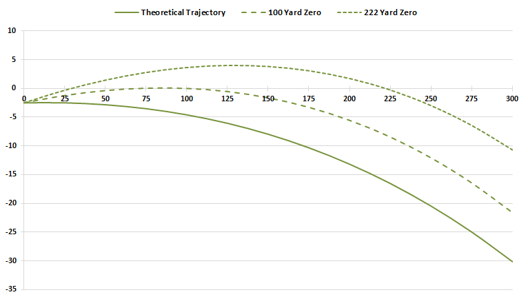

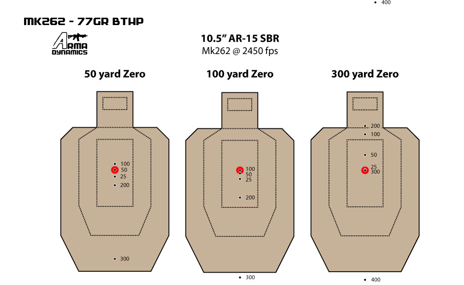

A useful counter point graphic would be to show the actual bullet path if the barrel is pointed exactly level horizontally (relative to the ground.)
That helps to demonstrate why for close range targets that you are trying to get really small groups with, to a certain extent speed really helps.

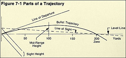

Like this graphic.

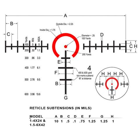

I just put a TA33 ACOG on my 16 inch AR carbine and if I understand this right a 300 yard zero, center hold will get me hits on a torso out to some distance beyond 300 yards and for 400 yards I have from center mass to top edge of plate holds to increase my hits.
I did the standard 100 yard zero despite experiencing a BZO of 300 while in .mil.
My reticle is the dot surrounded by horseshoe. With 3X mag its not like Im going much beyond 300 yards....Im thinking I should toss the Trijicon directions to zero at 100 and go with the @spife7980 graphic.

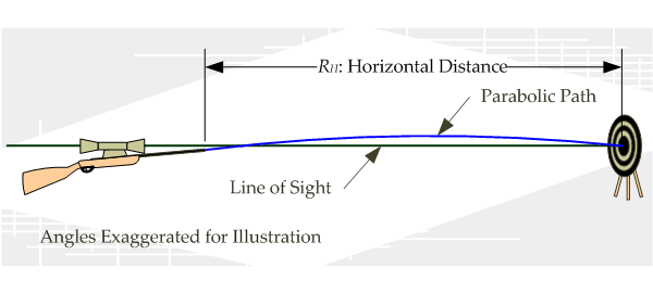

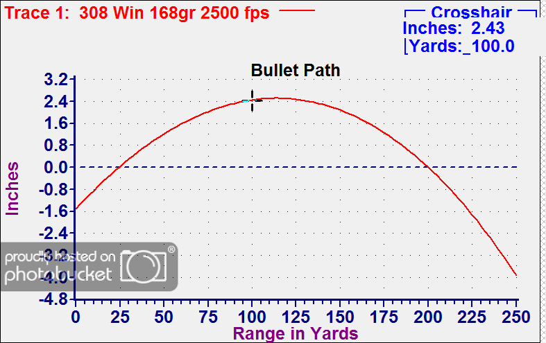

That would be the "theoretical trajectory" in this image in this image if the muzzle was level, aka zeroed at zero yards.
And crudely here
And more eloquently here
You'll find bullet speed affects the Theoretical trajectory greatly as it's distance traveled in x amount of time vs. the pull of gravity downwards at the same time speed.
That is why you have "flatter shooting" cartridges, because due to speed and/or aerodynamics they travel further in a given time period and as such you don't need to launch them into as much of a parabolic curve as others to reach the same spot.
Like this graphic.
I liked it too, notice that the 300 yard zero is also the same as a 25 yard zero.
Other bullets and powder weights scope heights over bore etc Ive heard that its a 25/225 yards zero. The main thing is that it keeps all of the distances in between essentially just an inch or two outside of the actual reticle center. Great for simple cross hairs or single dots.
That said I have a burris rt6 and I zero for what the reticle is calibrated around, a 100 yards zero and then just use my nice lines. Havent shot it enough to say exactly how well they align but the correct notch got 2 out of 2 hits on my 500 yards on my steel pig plate with some shit 55gr frontier shit after load development last weekend. Good enough for something I wont ever shoot all that much.

Thats similar to my TA33 horseshoe save no windage lines.
Makes sense to zero as directions state than hold as marked.
