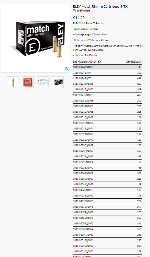

I like to order my eley from killough shooting sports as they show you how much of what lot# they have left. Ill buy and test many different lots that are in ample supply so its still available when Im ready to buy again, when I find the winner I order several bricks to last me a year or two.
