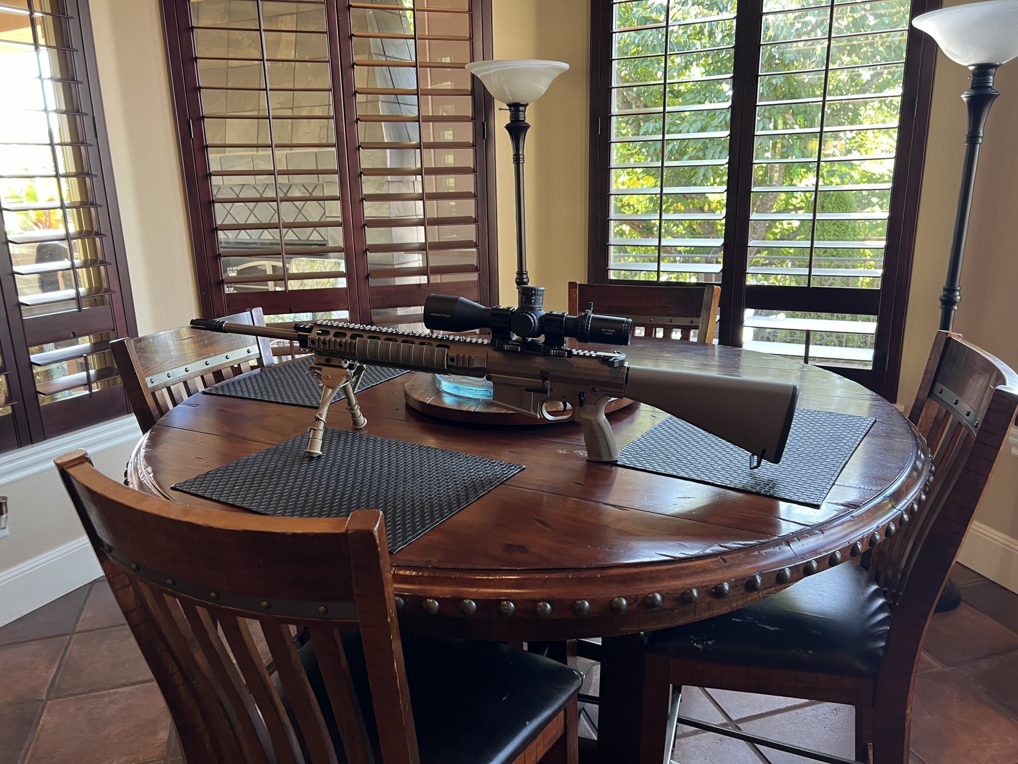

PSA M110 clonish rifle

Did the 2 lamps double the value of that shanty? Those chairs look like they were stolen from a Love's truck stop waiting area. Might as well just have that rifle be a paperweight for your phone book size wad of food stamps. Why you no have koi pond??
I can't quite place is, but it looks like there's something off about their lower in the trigger/magwell area. Not sure if its the grip or what. It's their lower too right? Who makes the rail?

A couple things kinda stand out at me compared to an actual M110. The reinforcing rib is pretty chunky and makes the lower look a bit squished; the integrated trigger guard looks like it has a funky radius cut, especially without the ambi-release.
Tripled it actually. Took it from $10 to $33/ month. And Shhhhh Loves hasn’t figured it out yet, they still let me in their showers every second Tuesday of the month out of pitty 🤪 And what the hell is a Koi? It sounds like a fish that doesn’t come in sticks. 🤨
The lower does look a bit off. I’ve seen a pic of someone who replaced the pistol grip with a standard A2 and it looked much better. Other than that, I agree that the integrated trigger guard has a weird shape.

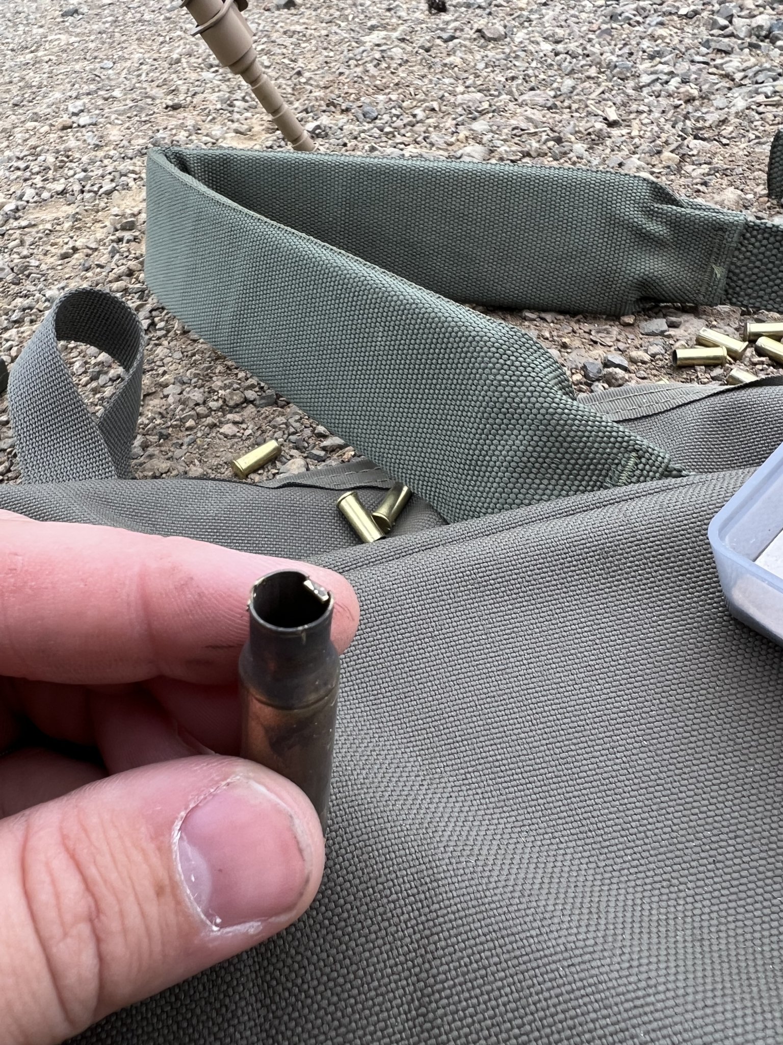

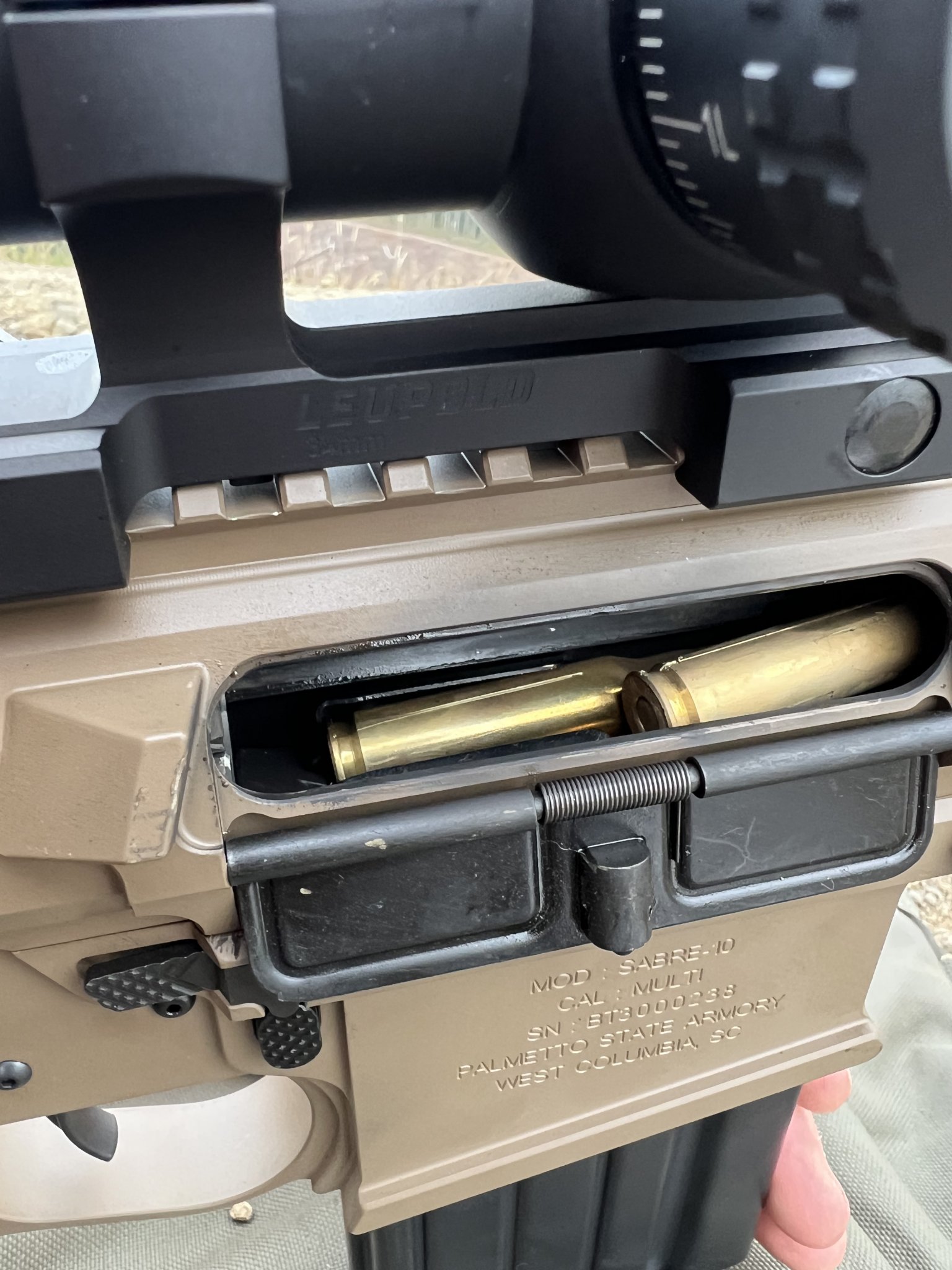

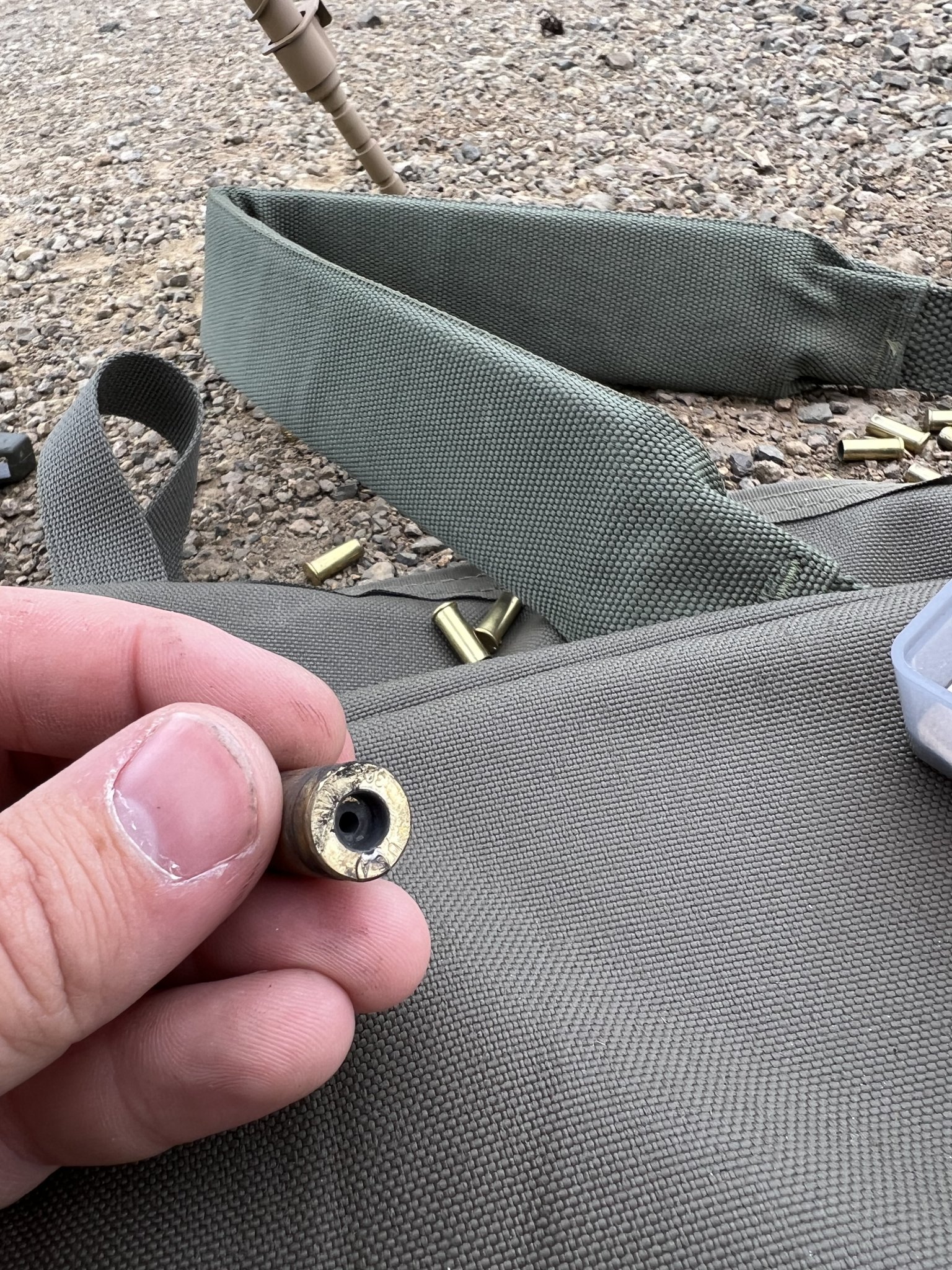

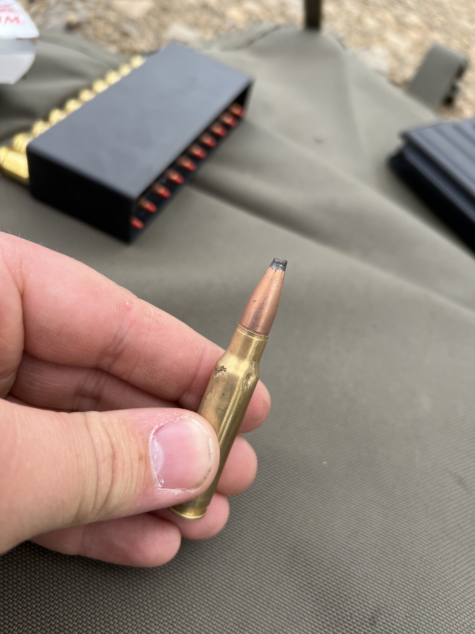

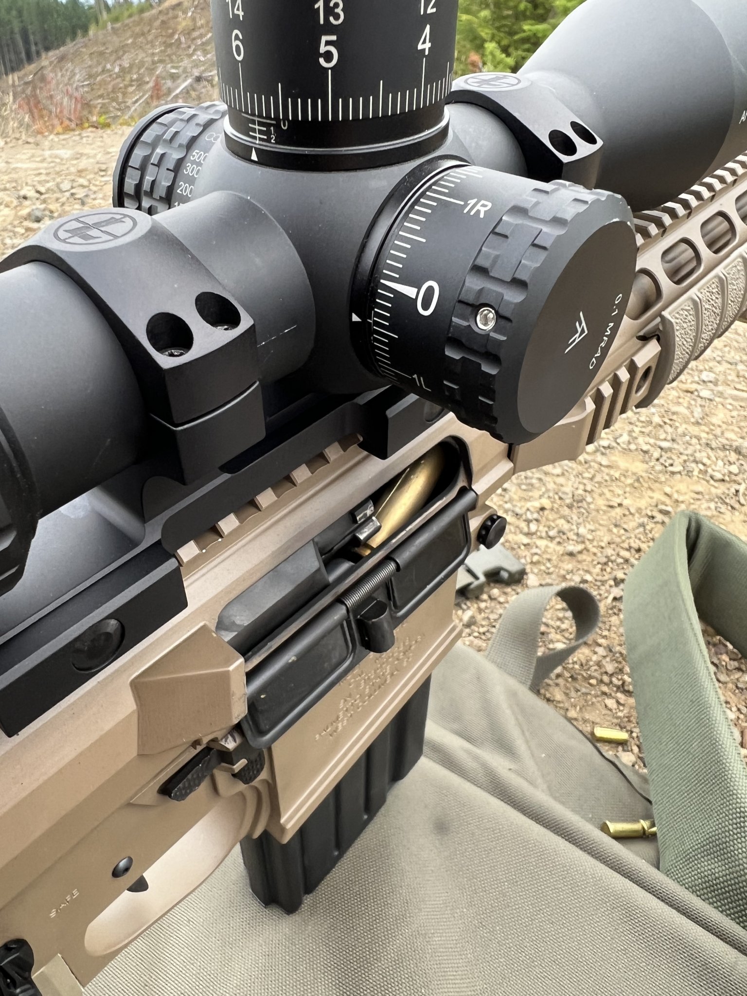

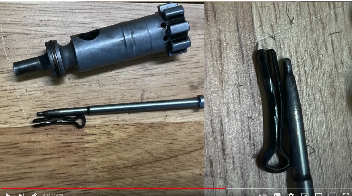

Firing pin broke, Firing Pin Retaining Pin bent, dropped-in his KAC 14.5” 6.5CM BCG and tried to get it to work but it continued to have malfs and spit out a 3rd burst.

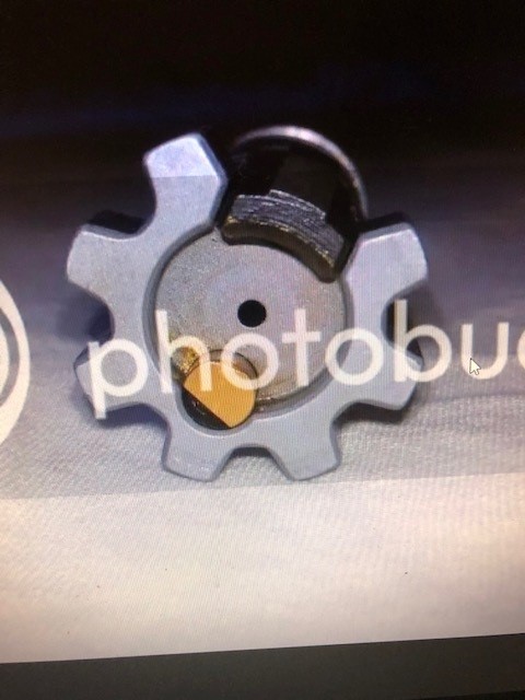

I thought maybe it had headspace/pressure issues since they likely do not use a high pressure bolt and then who knows how good they are at headspacing all of their rifles.
What would bend the retaining pin like that?
Shame the image cuts off the entire firing pin.
The tail of the bolt fitment to the carrier is a gas seal. If it's out of spec, gas can leak though and push on the collar of the firing pin, then the collar bends the pin. It can also be an over-speed BCG when it slams against the rear of the RE.
The bore pressure duration of longer .308 Win (think 175gr SMK) and anything 6.5CM place a lot of stress on primers and the firing pin tip.
If the firing pin aperture on the bolt is in the .086” region like most large frame guns, you can get a lot of blanking that looks like cratering, and significant firing pin backlash that will show up as bent Firing Pin Retaining Pins.
I went through this with my .260 Rem gasser when chasing the upper end of loads even with 123gr and 130gr bullets. I bent at least 3 FPRPs. 60,000-63,000psi peak pressure is trying to escape by any path available to it, so primers can act like little pistons against the firing pin and its aperture. Due to gas gun slop, especially with factory ammunition that has very generous shoulder locations well away from the shoulder in the chamber, you will experience a lot of primer piston effect too without crimped primers.
You might even see dropped primers.
Especially with large frame guns, you start to see how important the ammunition specs are for timing so peak chamber pressure, residual bore pressure pre-gas port, port pressure, and plug-dwell time are. It’s unrealistic to expect reliable performance with a wide range of ammunition.
For the VISMOD-10 companies who only chase price point with the false appearance of value, they haven’t even done pyramid-testing with a known spec ammunition using 100,000 rounds across 10 prototype rifles to explore all their failure points and correcting them.
They also will never see equivalent data by beta-testing on the customers because customers will experience their failures within the 1st mag up through 1500 rounds, and almost none of the customers know how to correctly diagnose their malfunctions.
At best, you have a conversation piece that might go bang occasionally.

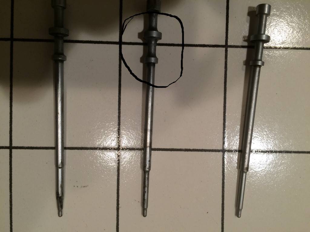

FWIW... the center pin is the out of spec one from one of mine... note the curved part at the collar, instead of the sharp are on the right hand one.

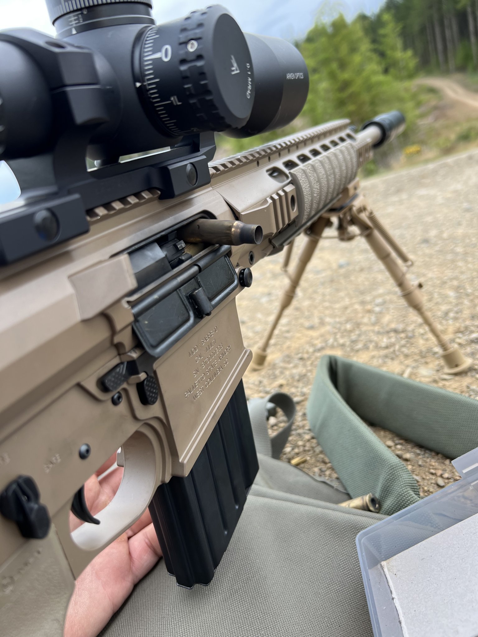

Unfortunately I was unable to make it out on Monday to test the rifle out. I am planning to take it out Friday or Saturday and put it through its paces. I will also get the measurements as promised either tomorrow or Friday.

KAC 308 bolt face.
I can only hope us average folk could get one like MAC's ... at a bargain price
Early KAC 308 Bolt face photo ? ..
If so they might not play well with the "typical" AR squared locking lugs used by PSA ( and others. )
Anyway... seems odd a KAC 308 BCG was having issues.
I would like to see the review again with a PSA 308 BCG.

Well, I’m freshly back from the range with an update on my Sabre.
I’ll just come right out and say it. I’m fairly disappointed in the rifle. The magazines that the rifle comes with cause failures to feed on almost every round. Almost like the rifle is under-gassed. I used Dura Mags both 5 and 10 round with no issues aside from my next discovery.
The rifle absolutely hated almost all of the ammo I cycled through it today. The best group I got was with S&B 168gr HPBT. It was grouping almost in the same hole until two consecutive fliers opened the 5 shot group to just over 1moa.
Aside from that single group, every single other group was well over 2moa. The second best group was 2.5moa with PMC Bronze of all ammo. The rifle despised the Hornady 155gr AMAX, and would not group better than 3 moa in over 50 rounds. The PMC Bronze was also all over the place and would give 2.5” groups then 4” groups. I’m not sure what is up with this rifle but the accuracy is complete shit. All shooting was completed while prone from a very stable position with almost no wind today.
The next issue I ran into occured when I attempted to run soft point Winchester ammo through the rifle. I wish I hat gotten a picture of the failure, but the very first round recoiled so hard that the shell casing got jammed as the bold cycled forward and trapped the casing 180° in the opposite direction. This destroyed the casing and caused a double feed at the same time. I cleared the malfunction and lowered the gas setting before firing a second round. The second round blew the primer into the magazine and double fed causing another failure. The bolt did not return home completely and when I pulled the bolt back, the round was not grabbed by the extractor and left the round in the chamber. I sent the bolt home hard and fired the round which once again sent the primer flying. All three casings had lost primers and the extractor had made a dent in the case head. Photos below.
This issue was not experienced with any other ammunition, and the rounds that remained in the magazine during each failure were badly dented and gouged. I ceased any further firing with that ammunition and disposed of the damaged rounds.
Overall guys, the function of the rifle is a non-issue in my case. But the accuracy is absolutely unacceptable. I did not clean or lubricate the rifle prior to my testing, I just took the rifle out of the box and began shooting.
I am in a pickle about how to proceed. I’m wondering if the specific ammo I chose is just not what this rifle likes, or if there is an internal or spec issue that is causing this horrendous accuracy. If the gun would group well, I’d be more than pleased. It cycled well and worked great (aside from he soft-points) and looks hella cool too. I’m hoping I can find a solution. At this point however, I would wait to purchase one until all of the kinks have been worked out by PSA. 🫤
