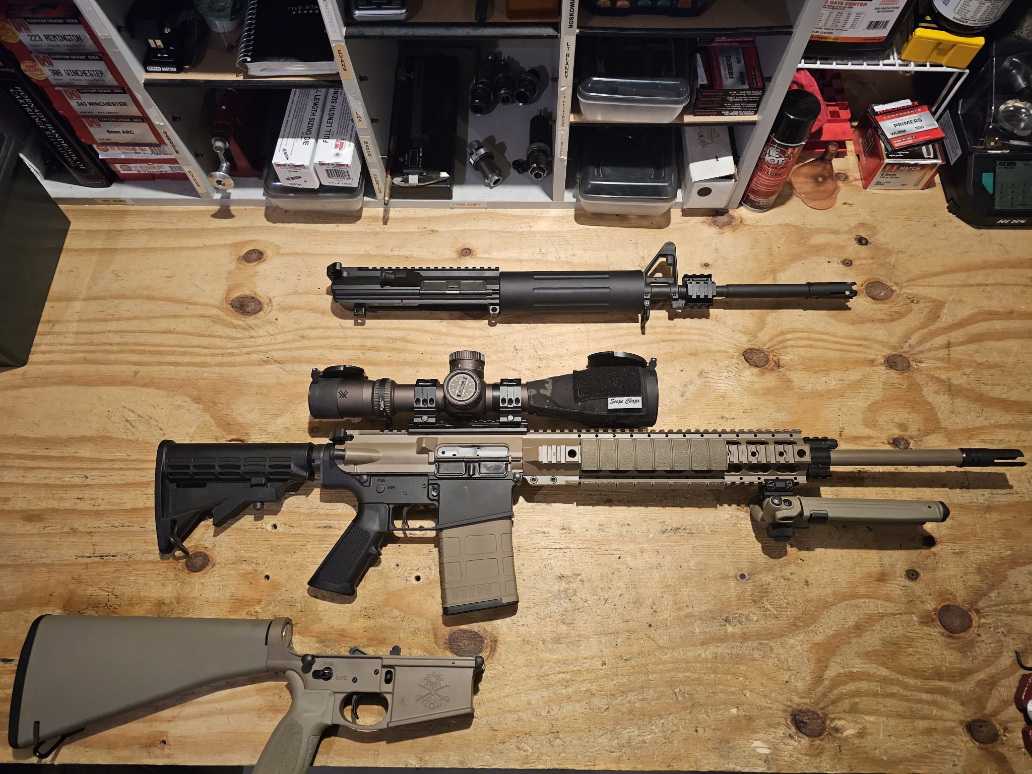

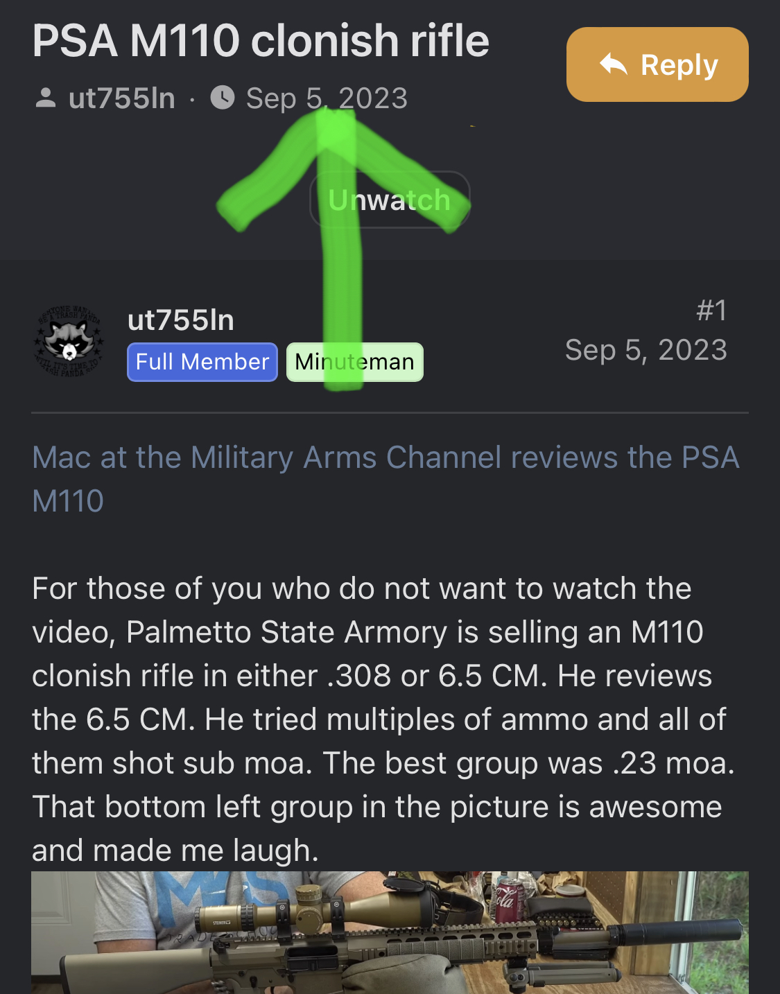

PSA M110 clonish rifle
I will say it looks good! I'll chance the barrel shooting mediocre. It ran my reloads great but was only a few rounds. I'll shoot groups and check function tomorrow with 100 rounds. It pairs fine with a DPMS lower in case anyone was wondering.

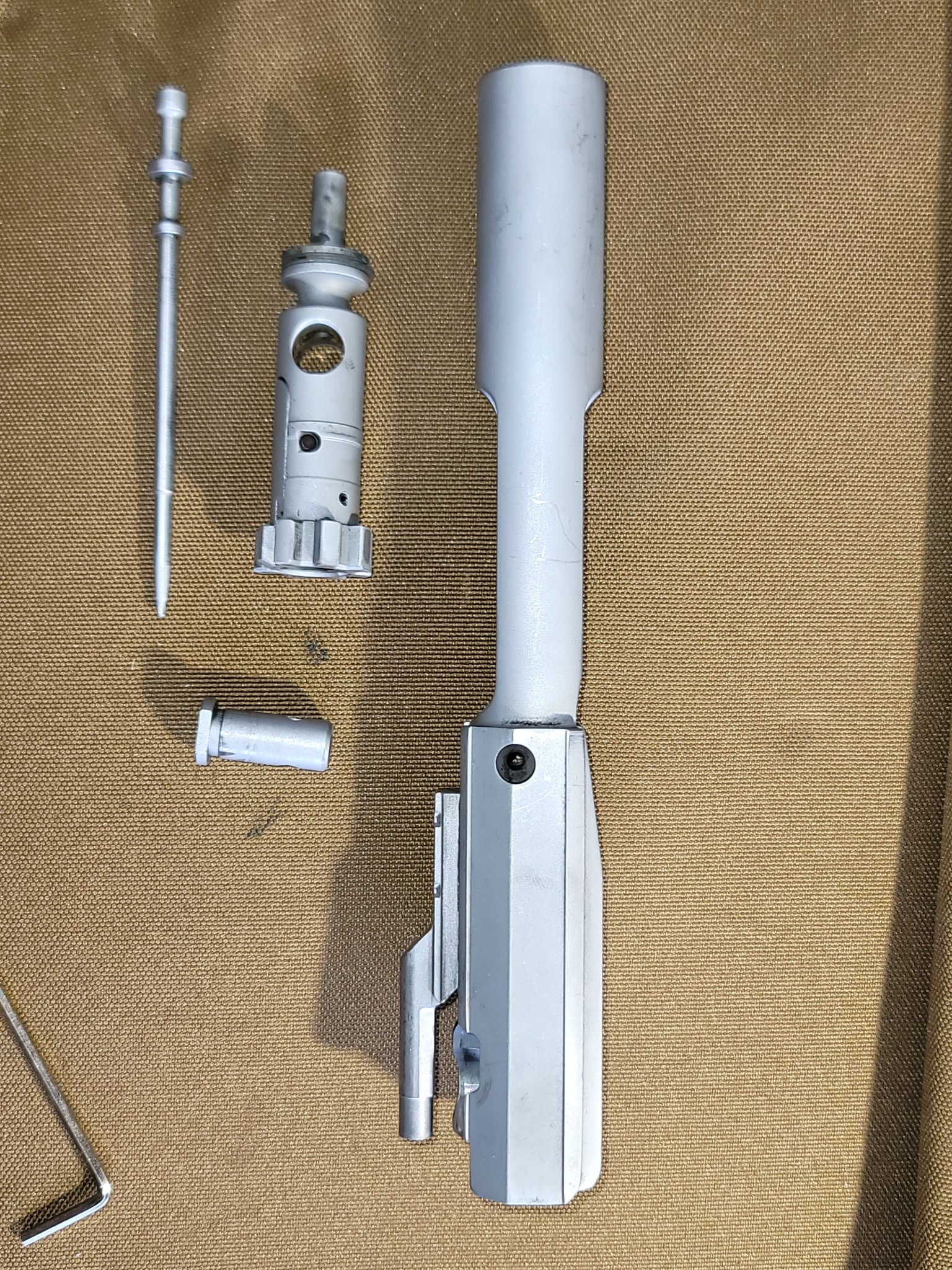

and in case if you don’t know the bolts for the A and zB models are the same, the only differences between the two are the receivers and bolt catch.
I must be blind! Not sure how I didn't see it under the parts section.
Well that's something at least. I have a LaRue big block lower kicking around I need to do something with. A cheap Armalite upper might be the ticket. Is there any different in barrel compatibility between the Armalite AR10 and most of the other large frames? I know I've read that supposedly the DPMS spec barrels do not work properly with some of the SR25 pattern guns like LaRue or Knights uppers and BCGs.
No real difference, I have a DPMS Lothar Walther barrel on one of my Armalites. I checked the headspace with my Armalite bolts and all were G2G. I sold the DPMS bolt that came with the barrel.

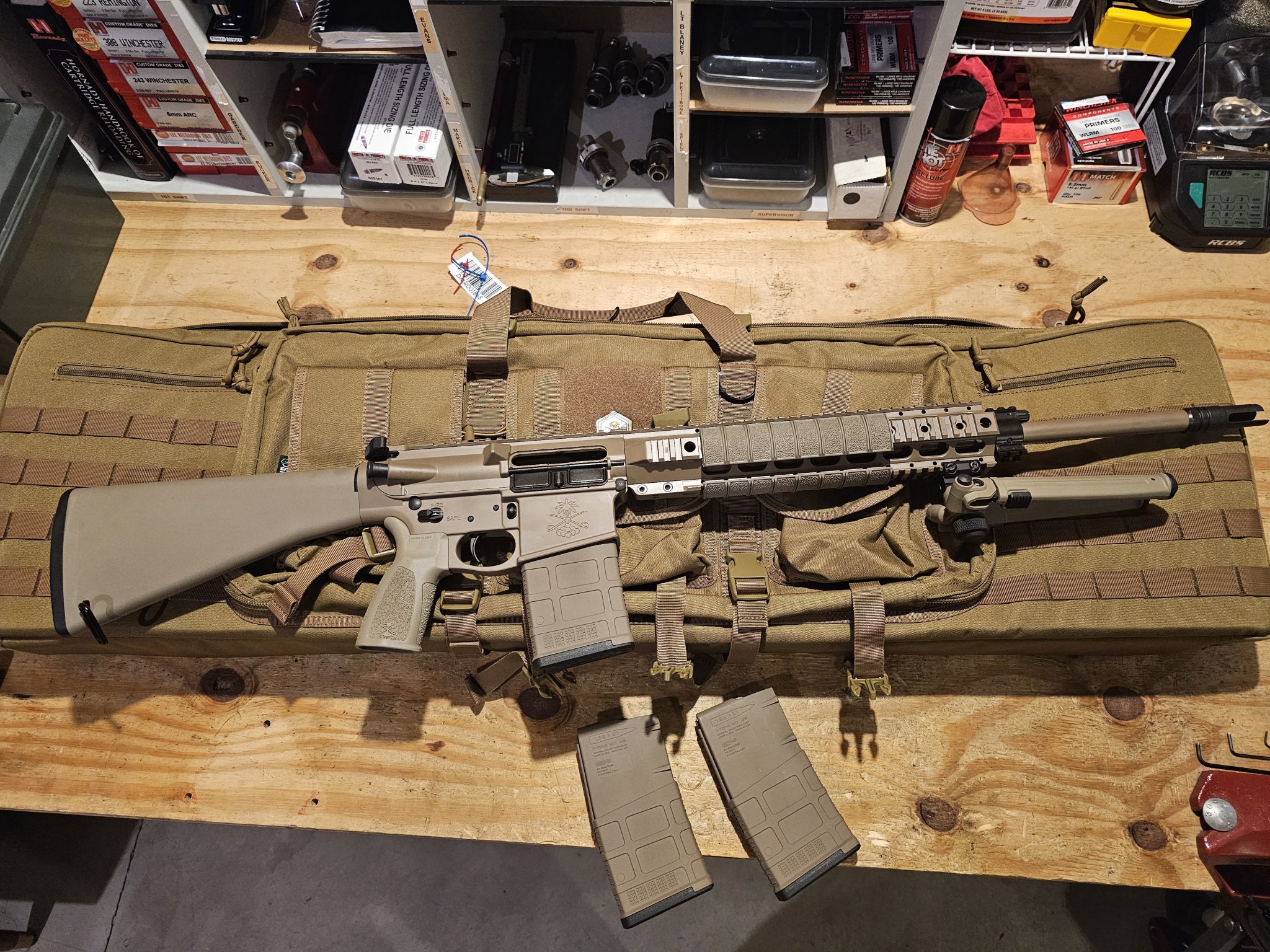

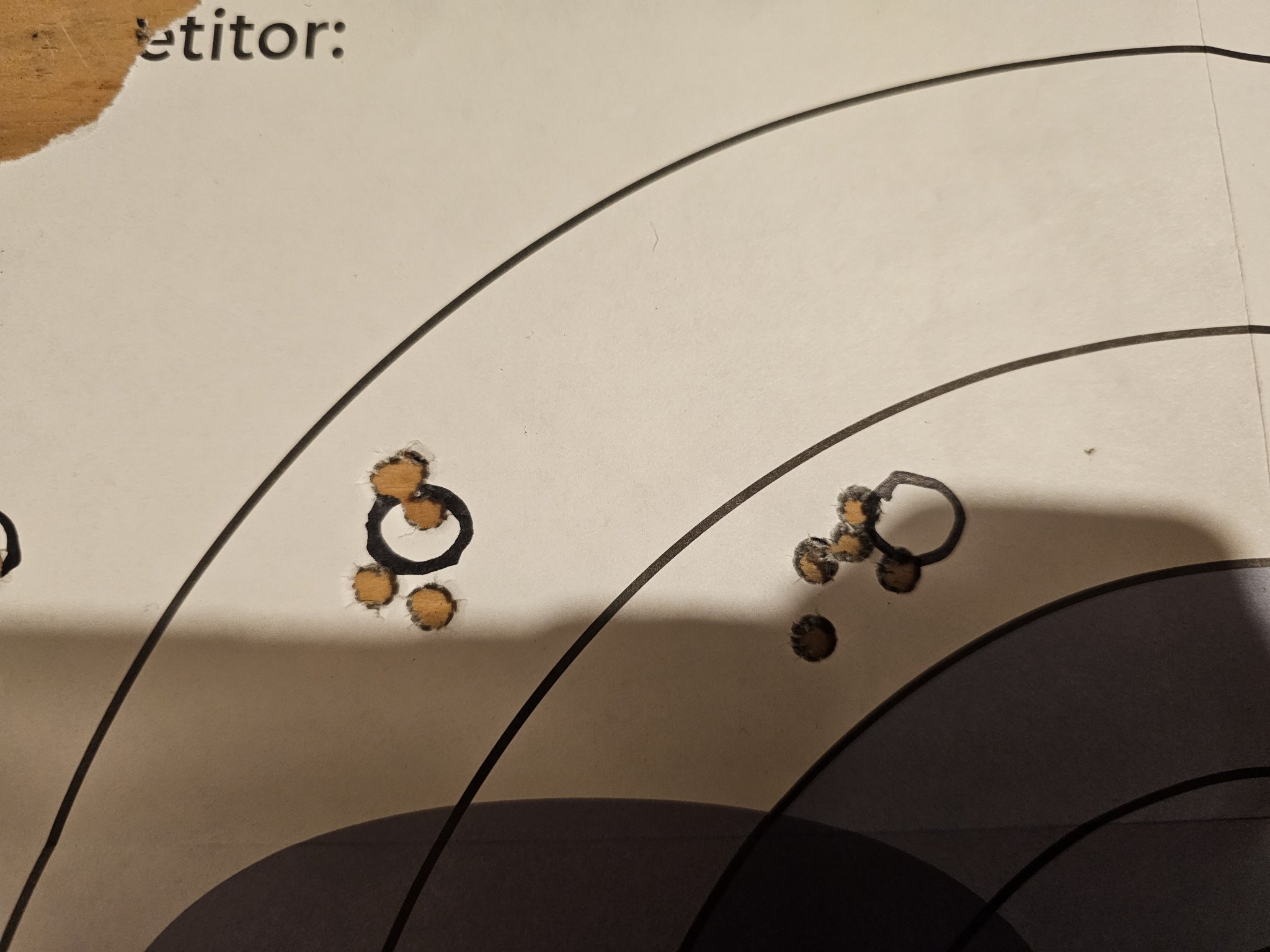

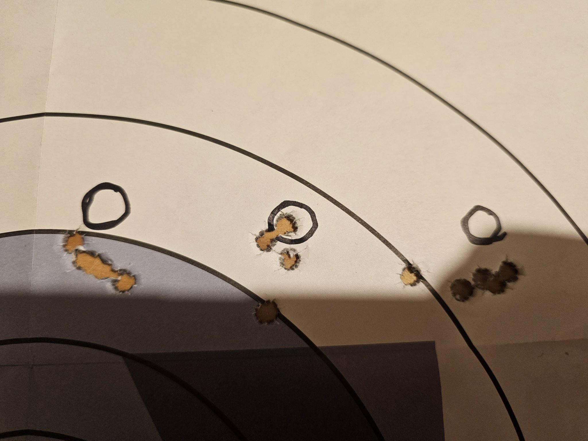

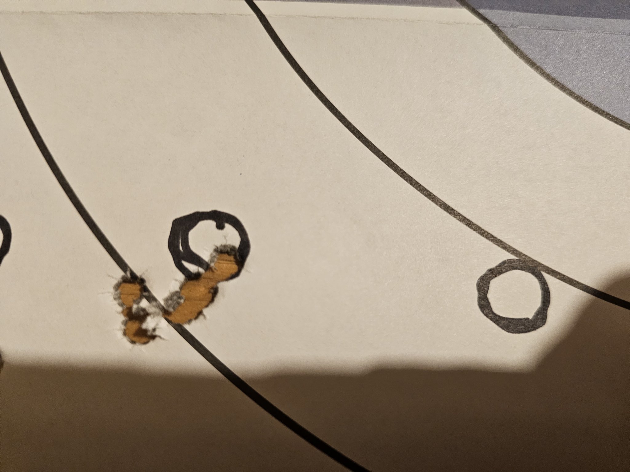

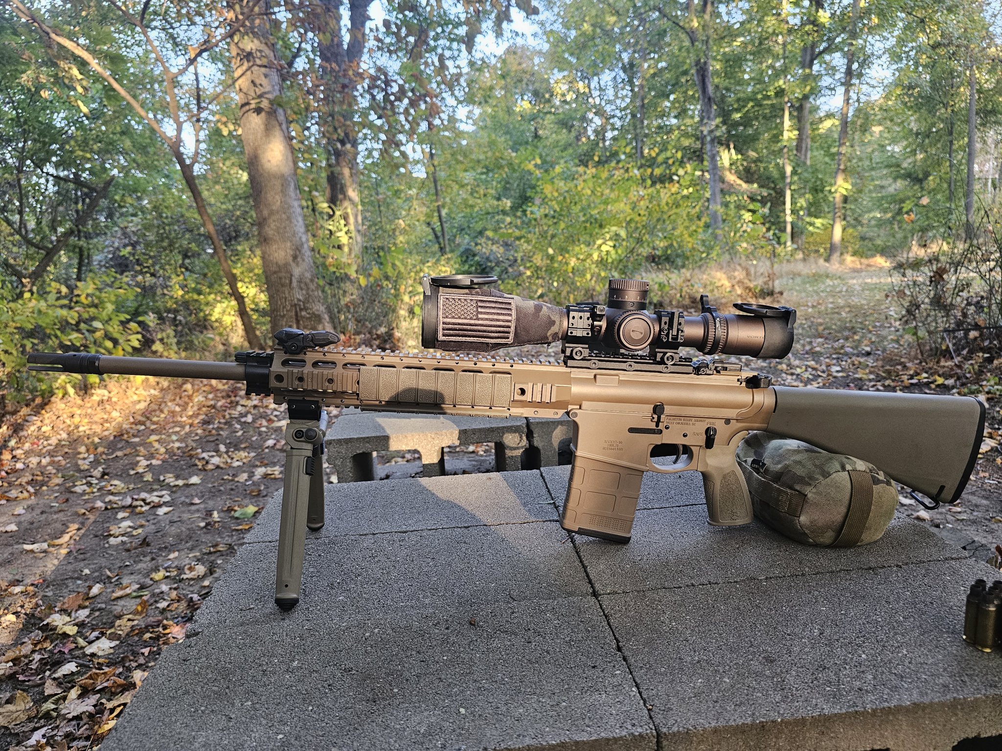

Ran about 80 rounds through it so far with just a quick load I threw together (41.4 h4350, 140 bthp, and used old Hornady brass) and it functions perfectly so far. These loads also were for quantity, so they were within a tenth of a grain and not .02 like my precision reloads. No failures, it locks back after last round, and ejects at 3-5 o'clock. I'll do more precise load development after 100 rounds of break in. Here are some 5 shot groups, all about .5 to .75. This is much different than shooting a bolt gun! Some of these flyers were me for sure, but if it keeps showing promise, I'll lock tight the barrel to help tighten things up. I'll buy some match factory ammo (Berger 130s, Federal gmm 130/140, and maybe Hornady) and see how they do as well.
Love this thing.

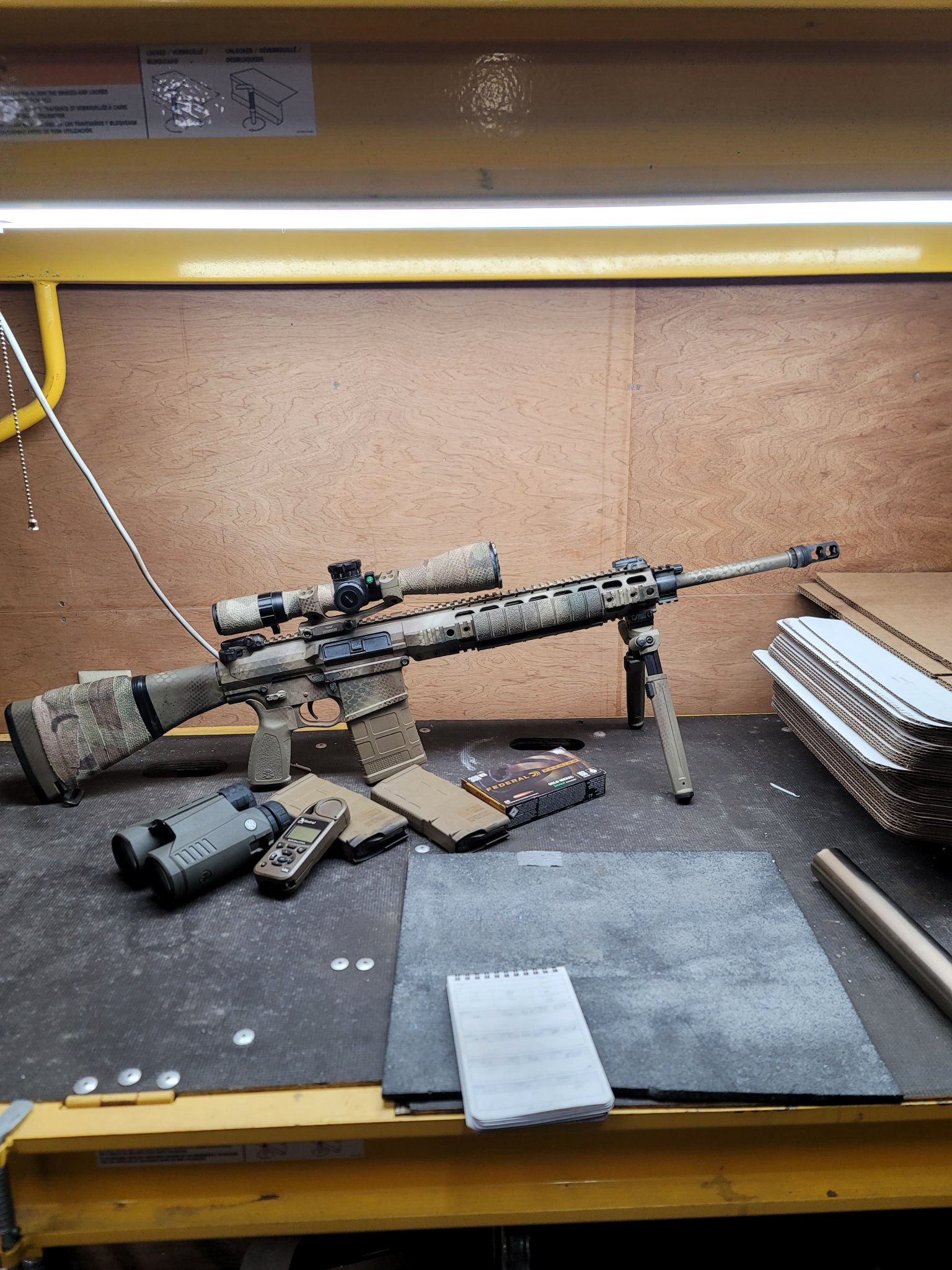

Love this thing.
Hey that's not too shabby!
I worked up a load with the 123 ELDs and Varget and took them out to 600 yards yesterday. At 39.60 grains they were moving at about 2900 with an SD of about 7, and grouped pretty well at around .5" at 100 (flyers still occurring so I need to get this barrel glued in).
At 450 yards I was able to smack the 30 point target which is a sledge hammer head 3 out of 5 times. Out of another 70 rounds, no failures of any kind and locked back every time. It's running great at a total of about 150 rounds.
The Federal GMM 130s wasn't great with 24 SD and can't remember the ES, but wasn't good. I'll buy Berger factory ammo to try next.
This rifle still doesn't feel like a bad purchase by any stretch. Probably going to buy another one and make it a 6 Creed. The fit and finish is fantastic, and the BCG is quality as it is probably a Toolkraft.

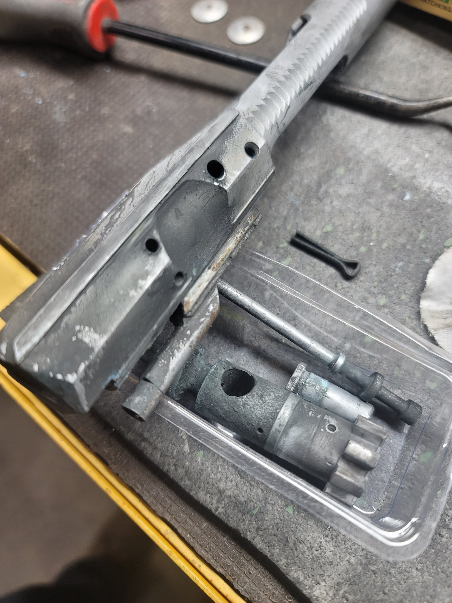

I picked one of these up about a month ago. I loved the initial fit and feel. I opted for the 20" 308 billet version. I already had an ASR muzzle device, scope and mount waiting for this thing before it shipped. Once received I felt really impressed with the controls and look. I immediately took the 3 prong flash hider off and clocked the brake. I mounted up a Bushnell LRTSi 3-12 and was ready to go. After a good cleaning and lube, I set out for initial shots.
I loaded up some 152gr controlled chaos loads and proceeded to try a few out of each mag, making note of election and hold open. It was sporadic and I ended up running the gas system wide open to get function, even suppressed. I would consistently get good shots until about 4 left in the metal mags. Little depressed.
I emailed PSA with a claim and they got right back with a return label. I asked if they would mind sending over what they would like me to do as I do machine work up here in Maine. They were comfortable with sending me parts as I sent them pictures and descriptions. They had me hone the chamber lightly with 800 grit to remove any burrs, inspect the bolt and send close up photos. Measure the barrel and gas port as well as show the side of the magazines empty as the springs have been installed backwards.
I found the barrel port to be .098" and the gas block to be 0.120". They had me open up the barrel port to 0.100" in which I ended up at 0.101" due to it being the closest numerical bit I had.
This upon reassembly put my gas settings perfect. I was nearly closed off running my form 1 10" baffle type can and about 2 more clicks open for no can.
I told them I'm still getting failure to feed routinely on the last couple rounds and insisted that the mags are the cause. They sent a new extractor spring and o ring. I told them I would buy the mags if they had tan PMAGs in stock.
Well, they send me 3 for free. Problem totally fixed.
I did my first long range day today with this gun and upon sighting in, I found the groups to be approx 1 moa. This was routinely validated over greater distances as the day progressed.
I shot at 100, 300, 418 yards with great effect and 100 percent reliability. From there I moved out to 495, 770 and 846 yards. All were easily 100% hit rate with a 2-5 mph variable wind in a 168DA.
We then went to a 1046 yard target with 14.8 mils of elevation and were getting roughly 50 percent (4 out of 7 hits as I observed my friend taking shots to try it) hit rate on ipsc 18x30 steel. We were impressed as the wind was picking up and the gun was piping hot with over 80 rounds through it in approx 35 minutes.
I brought the rifle home and completely lost that buyer's remorse and am proud we worked through it. Continued to shoot with my brother for two hours.
In review, it was under gassed - now is perfect, the metal mags are paper weights, PSA made it right, PMAGs work, 168fgmm is consistently good and the 165 fusion hunting loads aren't much over 1moa, the trigger is completely fine, however, quite light and will double without a good shoulder weld and if you elbow is resting stationary (think bump fire). Stock grip is grippy like a m&p9, ambi bolt release is very nice, controls are crisp, nice pins and good internal parts, 100 percent reliability across 4 shooters and hundreds of rounds with no extra cleaning or lubing cycles.
PSA did good, and is now incorporating these findings that I reported into the new orders and any returns. Glad to have helped and learned this thing inside and out in the process. Oh and the bipod catches a lot of hate but it worked, it's light and it came with it. It was fine past the rifles capable distance with proper preload and technique. The lockup on the rotation and tilt is a little weak but usable with a small rear bag shoring up the rear. It is what it is, but I am happy with the money I spent and what I received. Thanks guys.

In all honesty, I think this may be the most helpful post in this whole thread.
I had similar experiences with the metal mags, and found DuraMags to run flawlessly. From what most have said, the early models all seemed to be under gassed. Mine is in the 400’s and the issue seems to have been rectified.

Thank you for all your info.
I keep reading about these are under gassed. I will have to look at my 308 / 6.5CM 20" gas port list ( various brands, including PSA ) and see what they are.
I am fairly sure mine are all a round .089- .093, and those all run fine. I will check tonight.
Super odd ( to me ) that these Tan PSA's seem to need a larger gas port.
What could cause the need for more gas ?...Tighter chamber ? Stouter recoil spring ?

I will say it looks good! I'll chance the barrel shooting mediocre. It ran my reloads great but was only a few rounds. I'll shoot groups and check function tomorrow with 100 rounds. It pairs fine with a DPMS lower in case anyone was wondering. View attachment 8245457 View attachment 8245454
That is very interesting, the pairing with a DPMS lower, as rpol98 has mentioned before.. make sure the BCG axis mates with the buffer tube axis.
I think he has said it is off center.
And the side effects can be ammo being fed slightly off and the bolt catch being slightly off height wise.
When I tried mounting a DPMS bare upper to my PSA lower, you could see it was not centered very well at all. The BCG would cycle, but the tail end was very "high" in the buffer tube.
Enough so, that had I been using a BCG with "flared boss at the tail"... it would have been rubbing.
Love this thing.
Respectable groups, Thanks for sharing.
