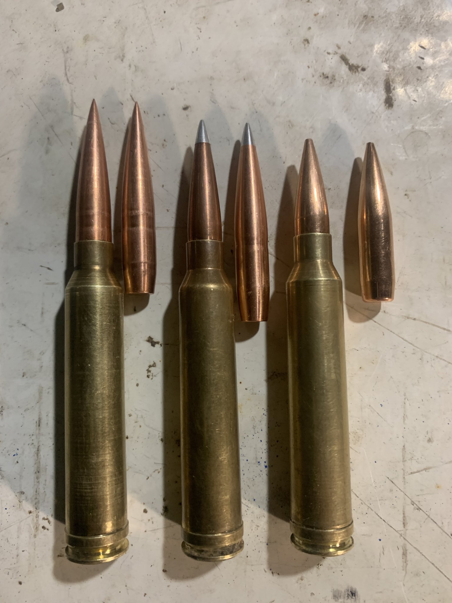

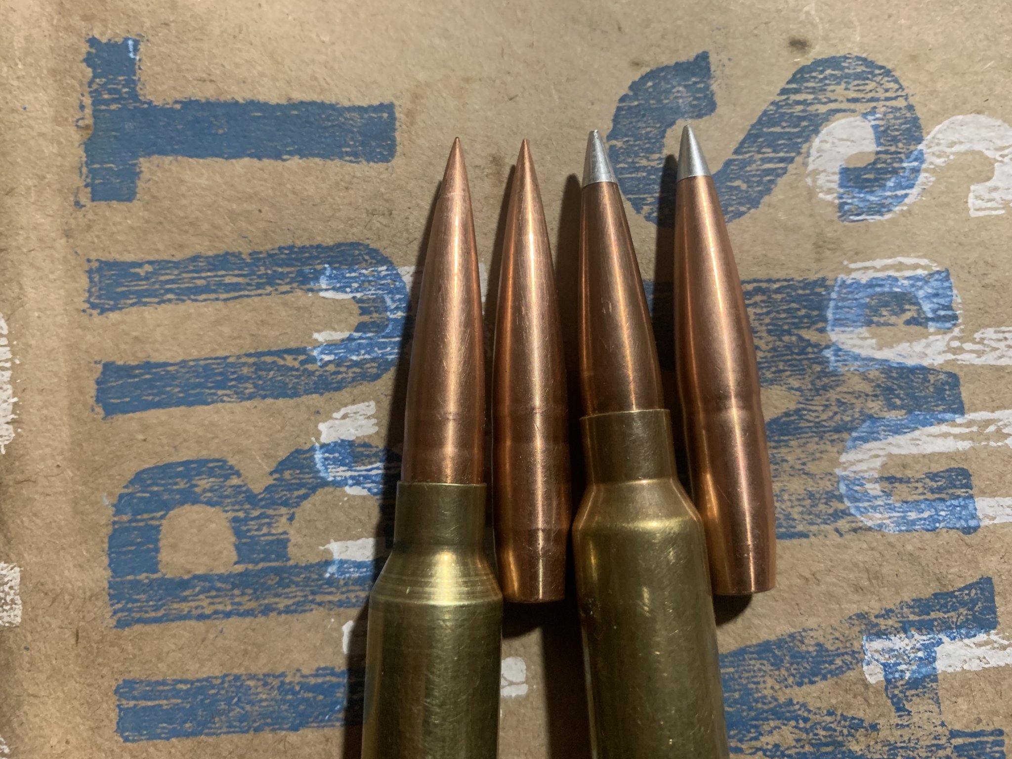

Standard chamber - nothing custom.
COAL is 3.91"
I have a normal throat (~0.250" freebore), and couldn't seat the bullets out far enough to even touch the lands. Basically the profile of the bullet just prevents it, so a long throat would be even worse I would imagine. So I'm jumping about 0.1" which seems nuts to me.
The important thing I've found with this combo is that I needed a tight neck tension. I'm using a pretty tight bushing to size the neck, then expanding it with a 0.3045" mandrel. The first round of load dev I used a common default neck tension, but groups/consistency weren't great. It also seemed like the bullets seated a bit too easily for my comfort, so I re-ran the same round of charges, but with the tighter neck and got dramatically better results.

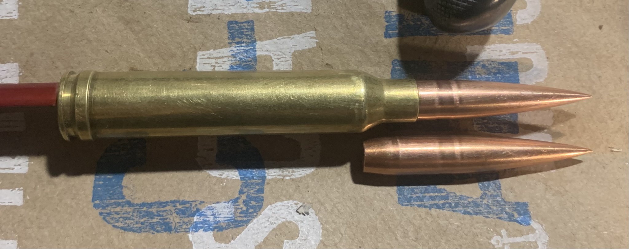

Yea

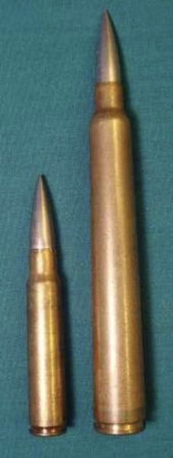

The Norma magnums freebore(300 & 338) isn’t optimal for modern solids.
The solids experiments years ago had a lot more body and a shorter front section similar in shape to a SMK
Second from right is a 285 solid seated 10 thou off in a standard 338NM
Not much left for the neck to grip onto.

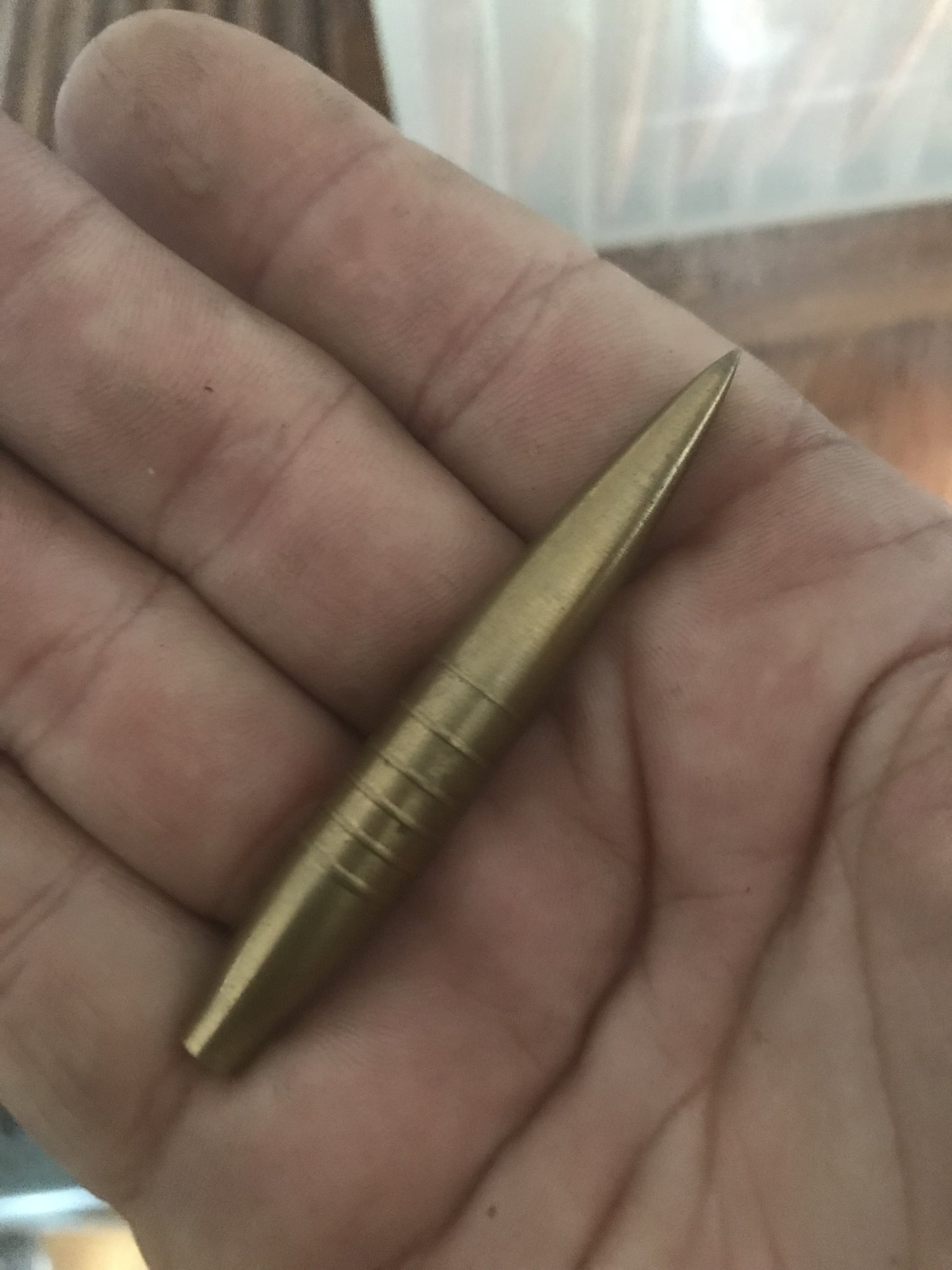

That solid in the first pic looks oddly familiar to me. Zenith experimental circa 2009?
I’m pretty sure that’s what it is.
Really small diameter with driving bands.
A buddy was involved in a few solids tests when he was still active military.
None really panned out but some interesting history.
Would be interesting to try those now as things are a bit different since then.
Reactions: jasent

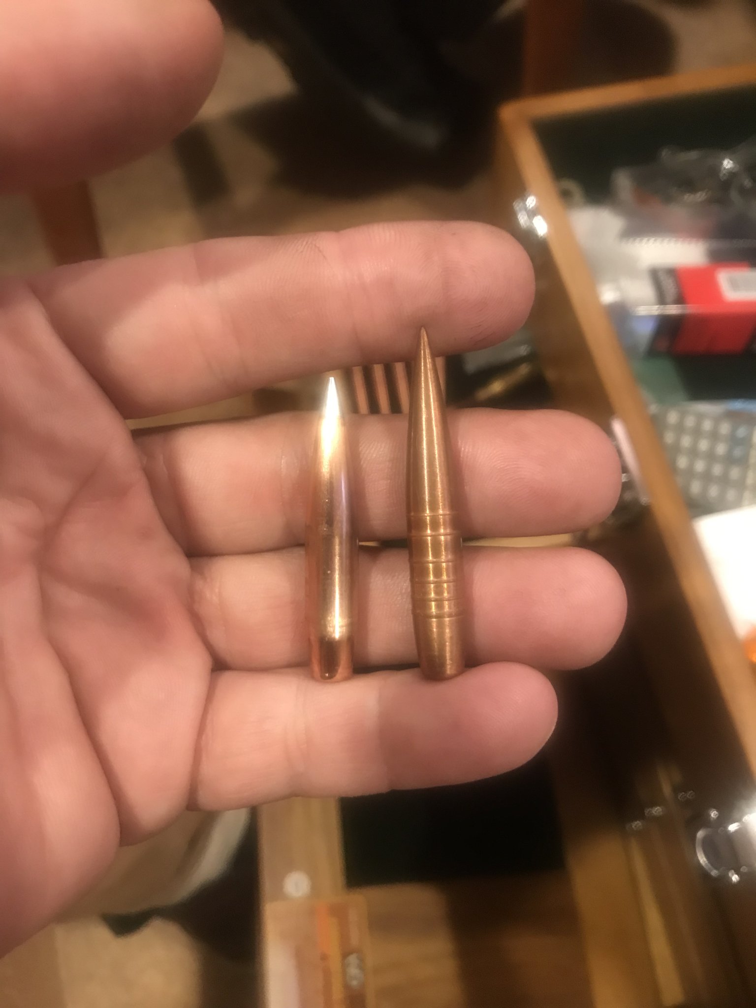

On second thought, the rear of that solid reminds me of the bullets Lutz Moeller was making in Germany about 10+ years ago?
I just went digging through my stuff and found the batch of Zenith test bullets I had leftover:
245gr .338 cal and 413gr .408. I still can't remember where the hell I got these but it must have been between 2008-2010

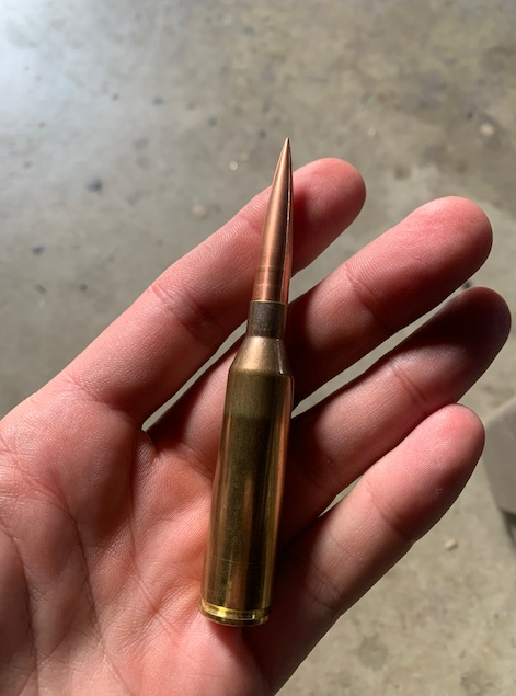

Pretty excited about my new Christmas present!

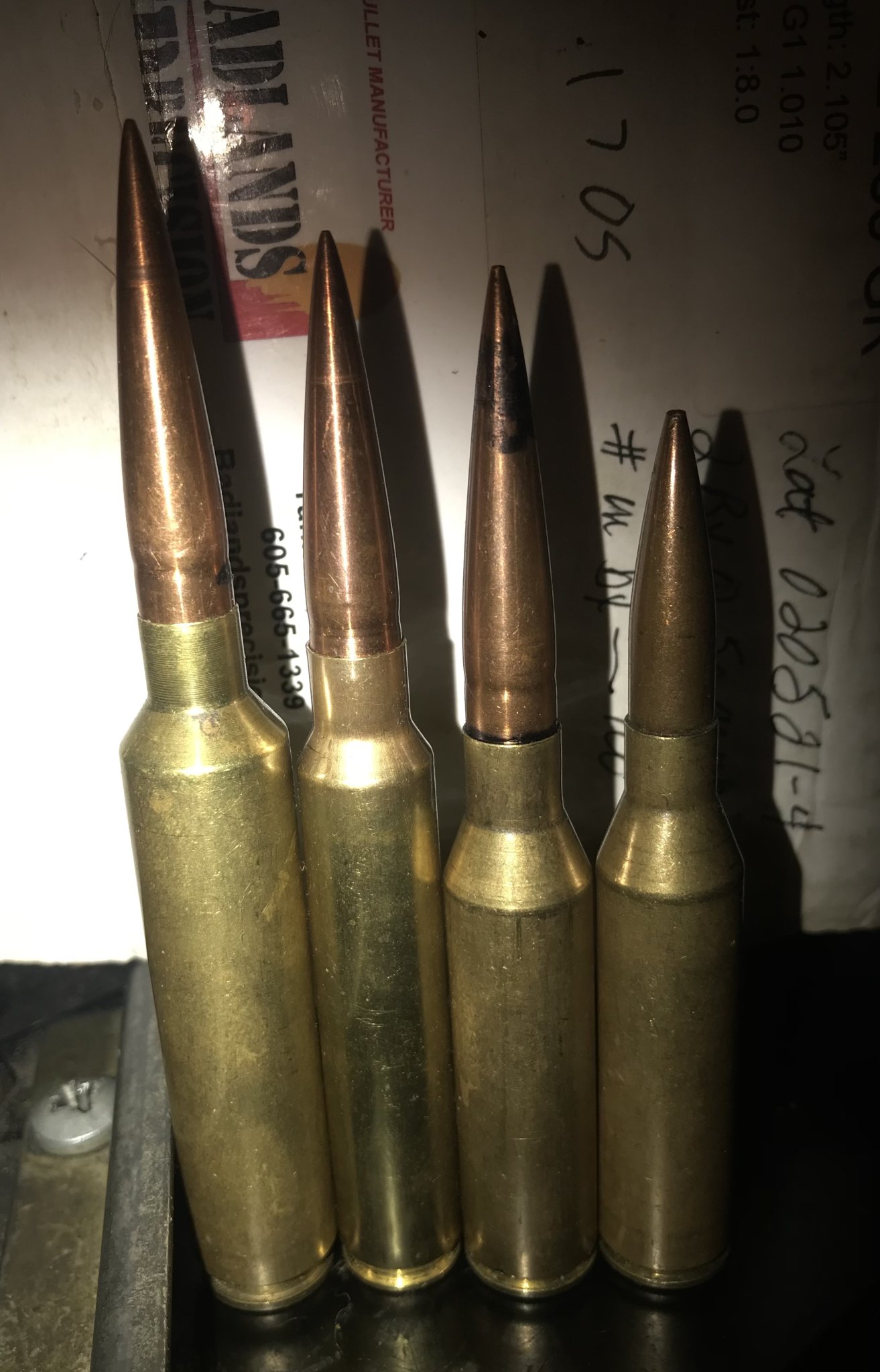

Bullet on far right is 210 gr. I can get it to 3090fps. Middle is 205gr. Shoot those at 2960fps. Left is 198gr. Hopefully be around 3100fps

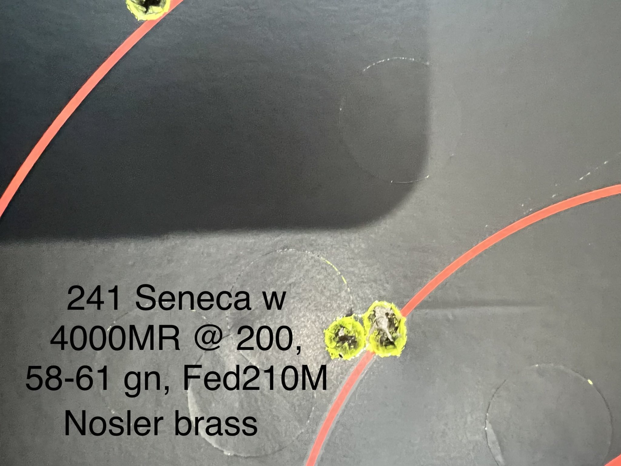

241 Seneca bullet is dead stable out of the 7 twist Spencer/MPA barrel: Perfectly round 0.3” holes at 200. Not a single oblong shaped hole. Have not tried them in the 8 twist but expect that to be a failure. SF is at 1.52 in the 7 twist and Strelok predicts 1.17 in an 8 twist.
Got to 2778 fps in the 28” barrel with 4000MR driving the 241 Seneca, but the web diameter on the overpriced Nosler brass opened up too much. Still holds a primer, but far too easy to seat a new primer. Will probably back off 1.0 grain. Should leave me around 2730 or so. I can live with that.
Strelok predicts supersonic to 2150 yards with a 2730 fps bullet, BUT that is assuming the published 0.555 G7 BC holds at this lower speed, which it obviously will not. I stubbornly holds out hope for 2000 yards.
Got one 0.3” accidental group at 200 during load development, for a set of 3 pressure test rounds (58, 60, and 61 grains). Probably just luck and might never repeat.
Have not shot the 241 Seneca at distance yet. Hope to confirm the drop and BC in January.
I realize one amazing three shot group is meaningless. Will see if that happy accident repeats - or not. Would be very happy with 0.5” groups at 100. Wind was from 7 o’clock and varied between 9-12 mph.
That next shot peeking through at the edge of the incompetently cropped photo is the 63 grain round. Total vertical spread from 2400 to 2780 fps was close to 4”.

Repeated the test at 200 with this load range (58-61 gn) in 0.5 grain increments, using a Caldwell rest and a front bag rider installed, and i did NOT get a good result: Formed two groups about 2.5” apart (vertically), for an overall group size of 1.2 MOA x 1.2 MOA. Each cluster is about half that size, but shots landed randomly in either group. That is not going to work. I guess “if it looks too good to be true, it probably is”….
Will try the tuner, and them on to other powders.

212’s showed up today. Just touching coal is 4.055”. Sure like this extra capacity these allow. Bt junction is just above neck shoulder doughnut area. Like this chamber was made for these Seneca’s
A lot of solids fit standard freebore chambers/cases quite well unlike modern cup/core heavies which in kinda neat.
I think PVA recommends .090-.150 which is quite common on a lot of older popular cartridges.
