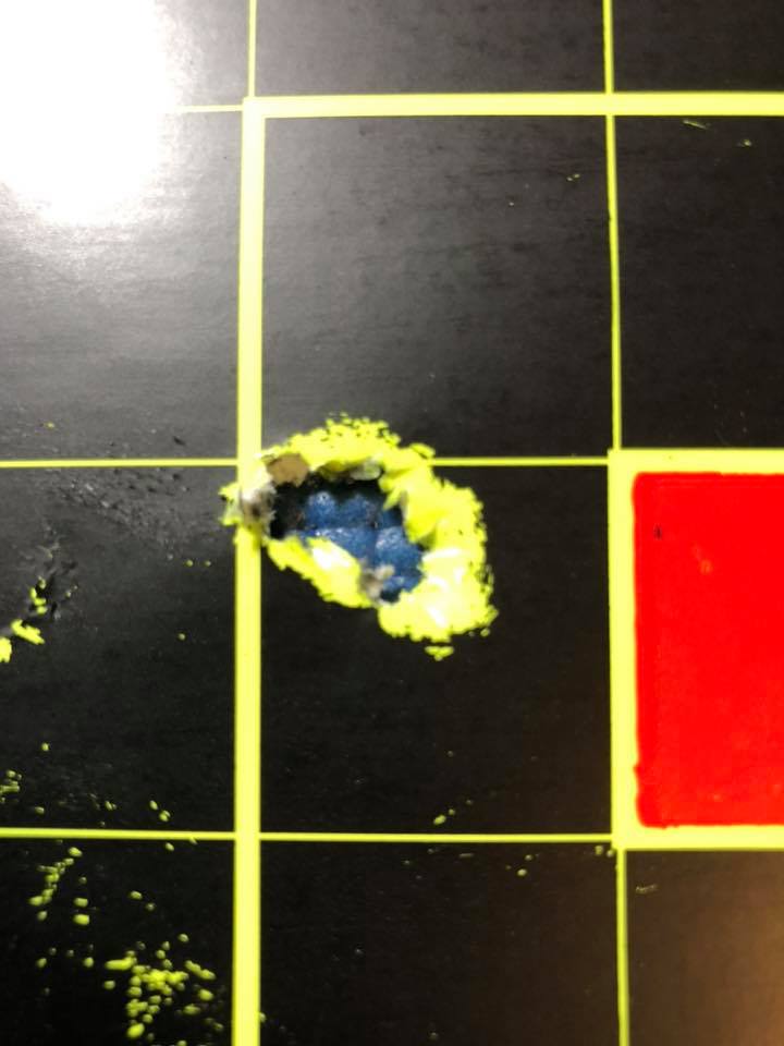

Test loads were 123gr Nosler CC (Stinker bullets but I have a lot of them) in Lapua SP over IMR 4451:
The bottom five shot here was my best of the day:
the feel of the rifle is fantastic. I love the Nucleus action.
Keep in mind that I am not anywhere near as good at smashing tiny groups as most of you, but I think it looks promising.

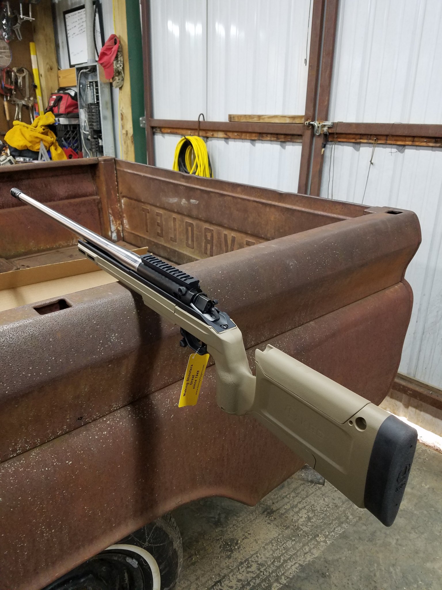

Hey Folks! I am back at work and now have plenty of time to post. I received my JHR on 08FEB19. I could not be happier. I have only shot one type of factory ammo out of it so far (Prime) and it has be a tack driver since about round 20. It may have been that good out of the box, but it took me a few rounds to get comfortable on the stock. I now have 91 rounds through it.
Pic 1: Balance might be questionable....
Pic 03: Ready for break-in
Pic 02: My buddy shooting from my stand.
Pic 04: My son shooting the same target as the guys on the stand. We went to the ATV to make hitting a 500 yard 8" plate more of a challenge.....
This is my first post of a picture, hope I did it correctly.

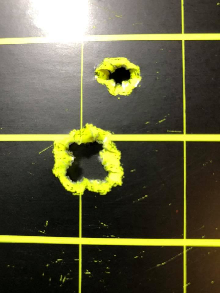

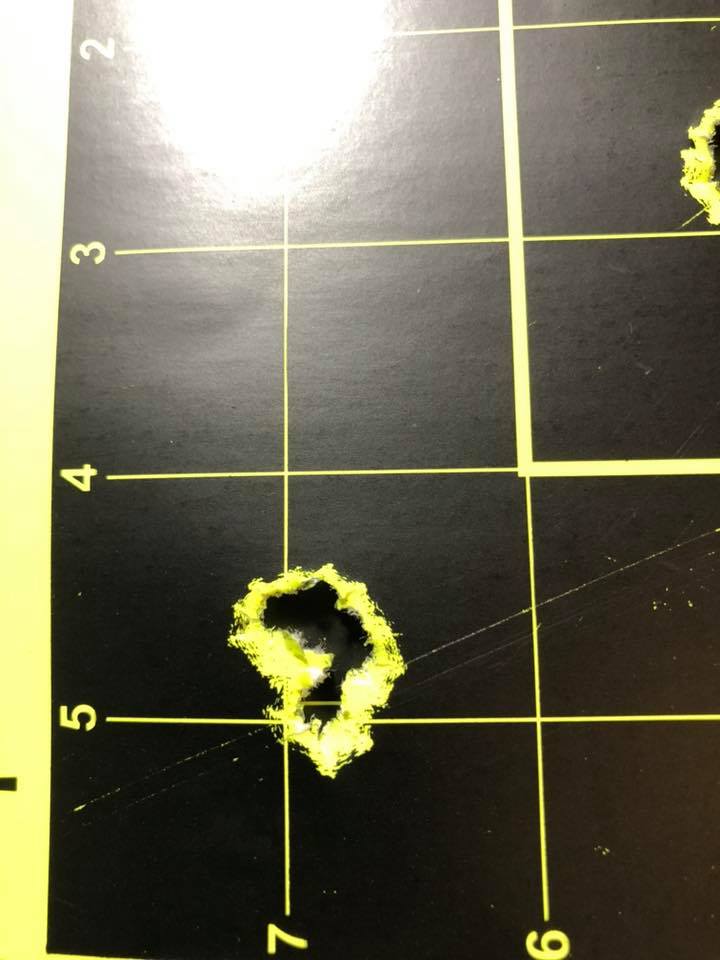

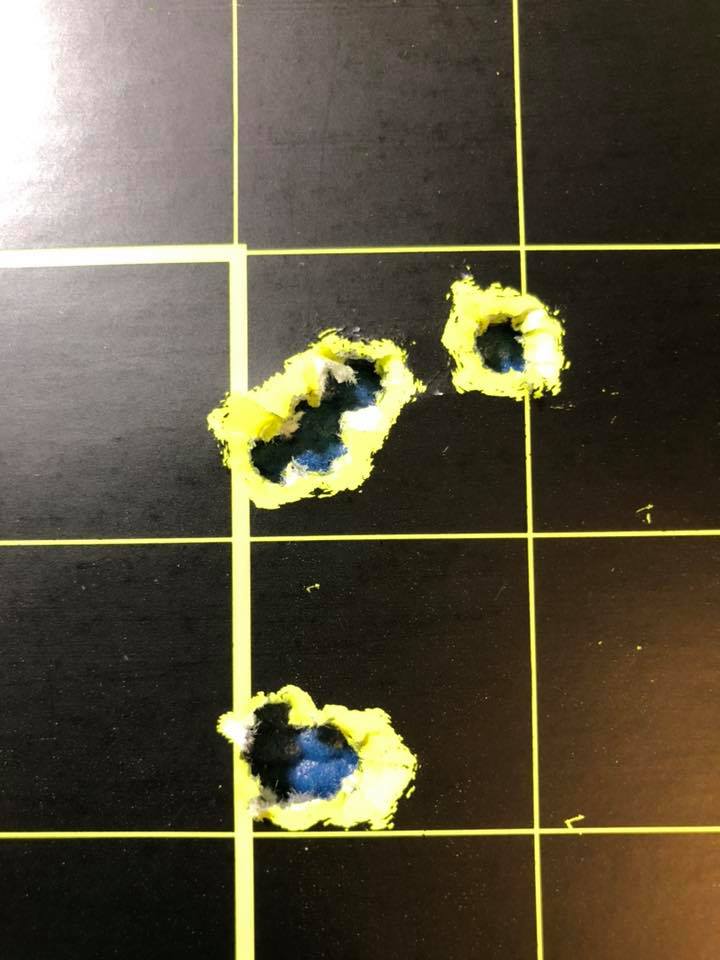

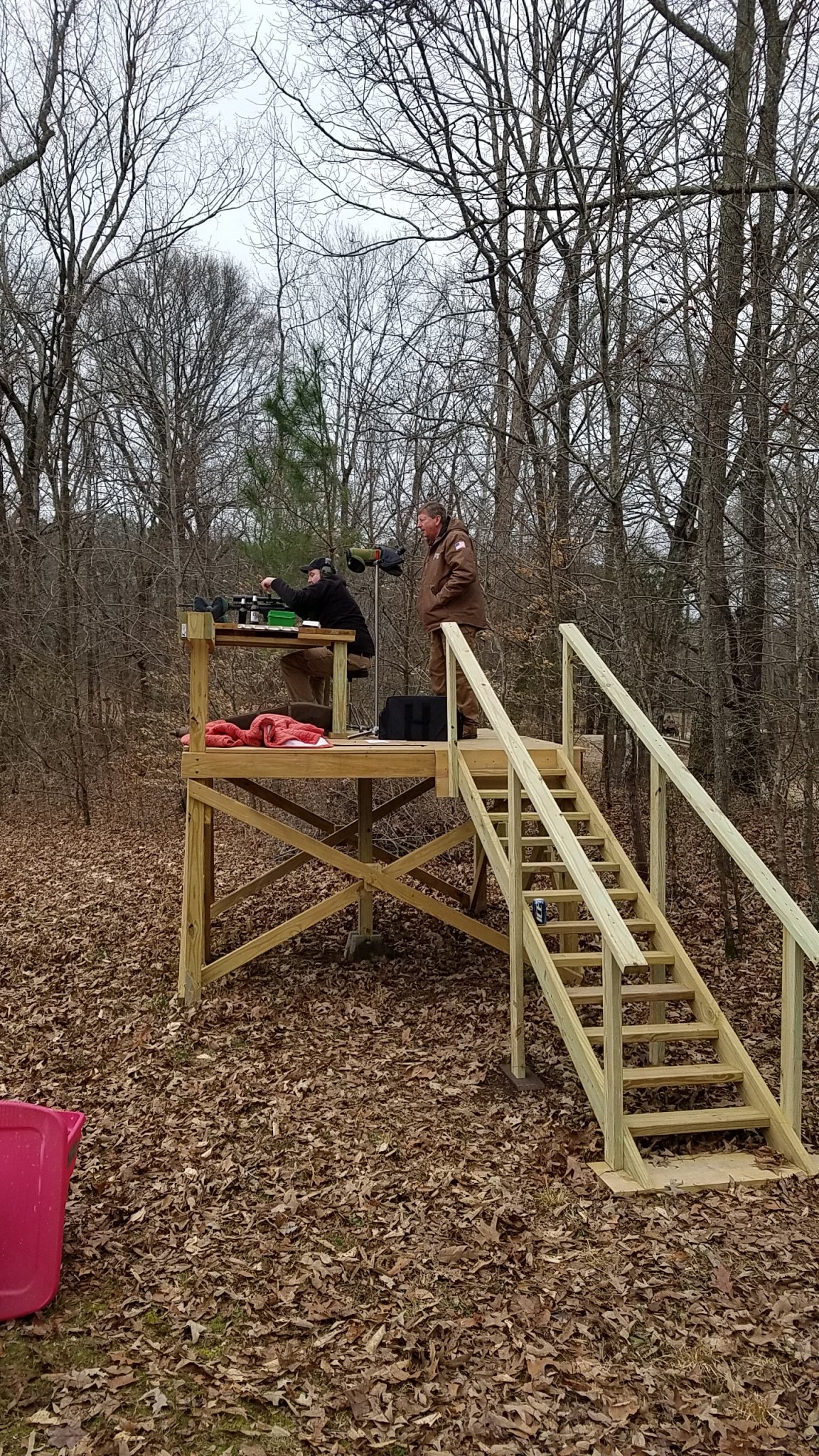

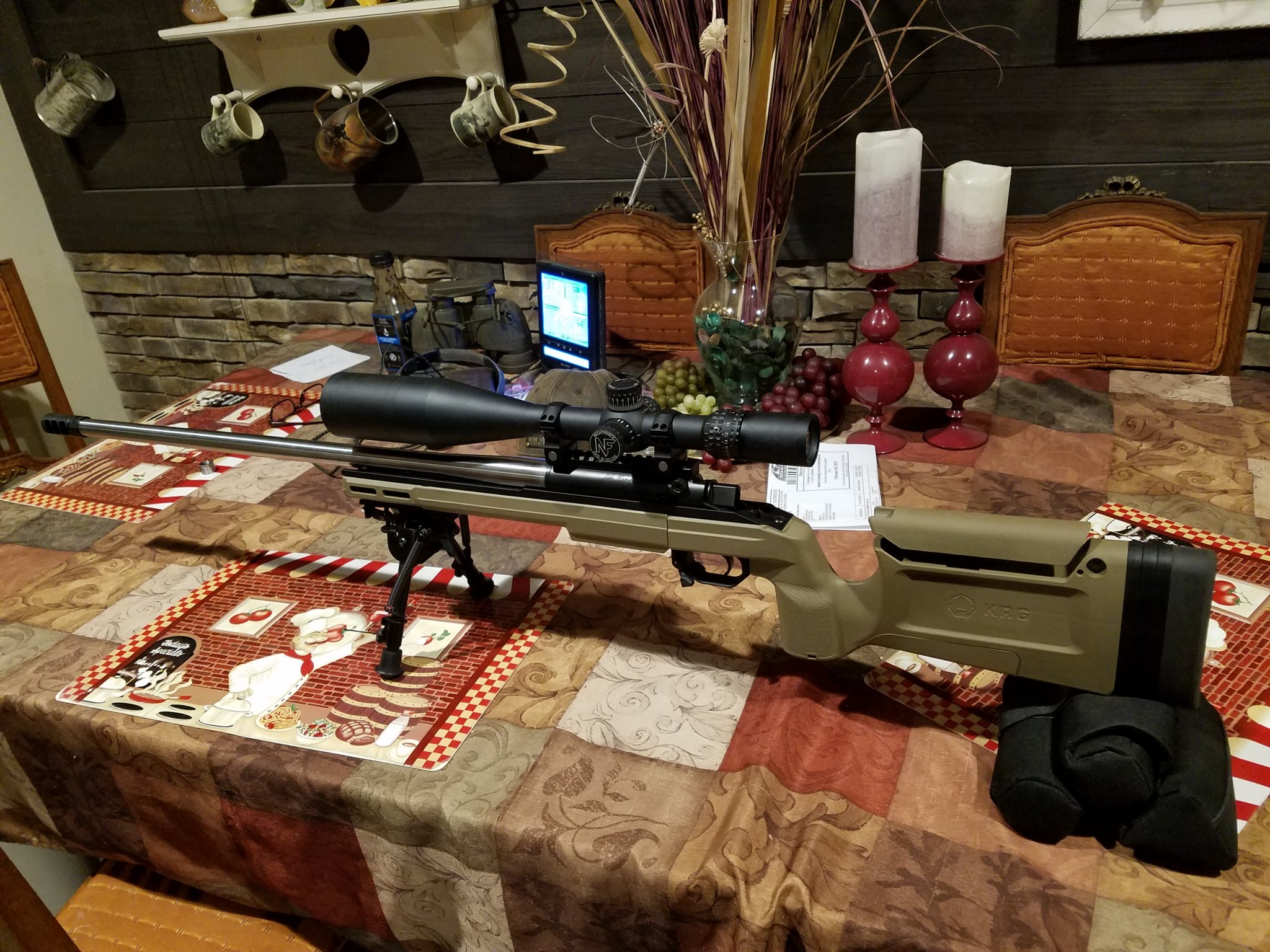

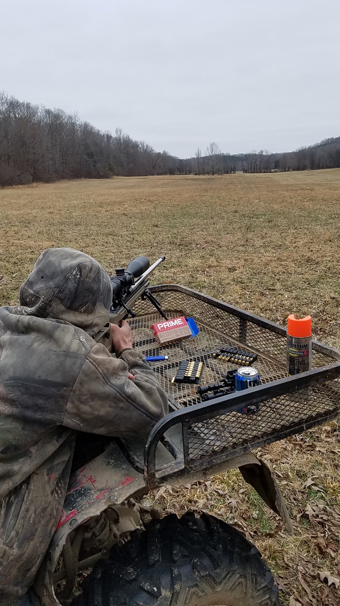

Nice looking place to shoot!
With a scope and loaded magazine on the rifle the balance should move aft considerably. On the rifles we put together and assembled here with a Steiner T5Xi and a Khales K624i a loaded mag with 5 rds (average full vs empty of a 10rd) and the scopes mounted the rifles balanced on the recoil lug, give or take 3/4". Unless something changed in the stock that I'm not aware of you should be on the recoil lug with a decked out rifle. A heavy bipod would move it forward obviously.

Awesome Tim, nice pictures. Like that AO you have there... all sorts of cool FPs. Are you making hay on those fields? And love the old Chevy truck.
Thanks & thanks!!
The ole '66 Chevy was my Grandfather's farm truck. I just got it from behind my Dad's barn. After a few bucks and several hours, it runs like a top. My wife loves the old 3 on a tree.
Yes the entire hollow is a hay field. The first fence row (the one you can see in the pic) is 460 yds. The next fence row is 1250 yds. And the back of the hollow is roughly 1800 yds.
bohem/Josh.....
Duuude, I guess I should have put a smiley face emoji thingy in there. The balance was and is freakin wonderful!!! I could not be happier with the rifle!!
And something I forgot to mention....the Jet Blast muzzle brake. There were 5 other guys shooting last Saturday. The brake was put on each of their rifles. It outperformed their brakes. One was whatever comes on a RPR and another one was a Little Bastard. No idea what the other three were. Pretty sure you will receive 4 or 5 orders. I tested it on & off my JHR and on a Savage 12FV. The recoil reduction was incredible.
That is great to hear, thank you! I'm glad your rifle and brake are treating you so well.
